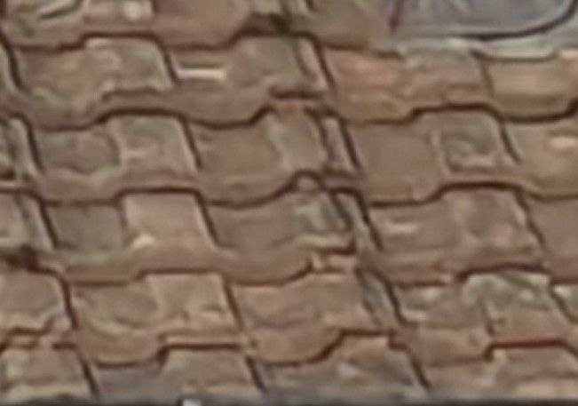

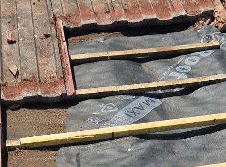

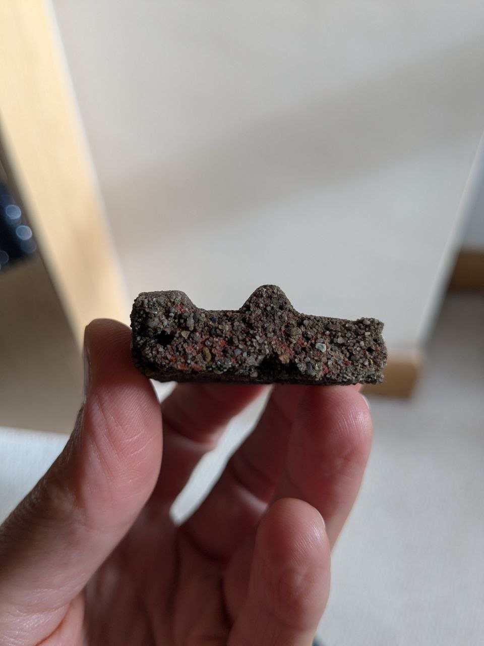

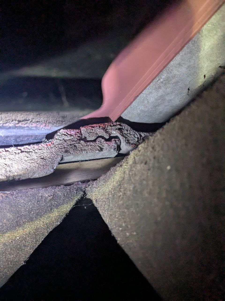

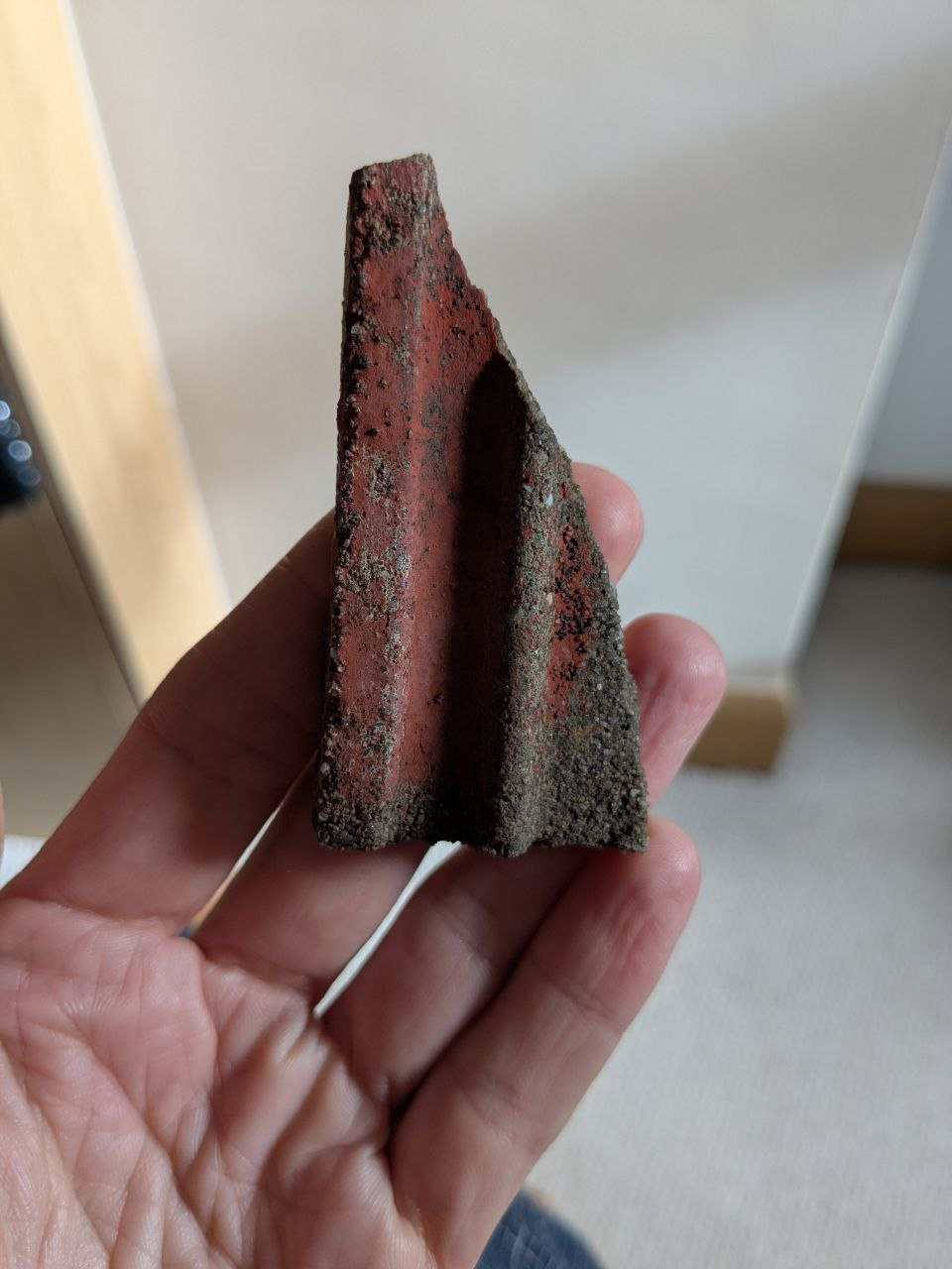

Nat_ Posted Tuesday at 10:25 Posted Tuesday at 10:25 (edited) Hello. I need to replace a couple of broken concrete tiles on my roof. The problem is that there is no make's stamp on their backs. They look like Marley ludlow, Redland renown and Sandtoft lindum, but all of those have their stamps. Shall I then just measure the size and look for the identical profile and measurements? Thanks Edited Tuesday at 10:44 by Nat_ photos added

Mr Punter Posted Tuesday at 11:43 Posted Tuesday at 11:43 Are they Redland 49? Take one off and along to a roofing supplier to match.
kandgmitchell Posted Tuesday at 16:43 Posted Tuesday at 16:43 They certainly have a Redland 49 look about them. but as @Mr Punter says, find a roofing supplier and take a sample along to match up.
MikeGrahamT21 Posted 16 hours ago Posted 16 hours ago From memory the Redland 49's are slightly curved, they look like Marley Ludlow Plus to me, which are flat from top to bottom
Nat_ Posted 10 hours ago Author Posted 10 hours ago 6 hours ago, MikeGrahamT21 said: From memory the Redland 49's are slightly curved, they look like Marley Ludlow Plus to me, which are flat from top to bottom That is exactly what I thought: Redlands are bit curved and mine are not. Thank you.
