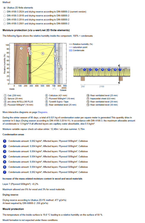

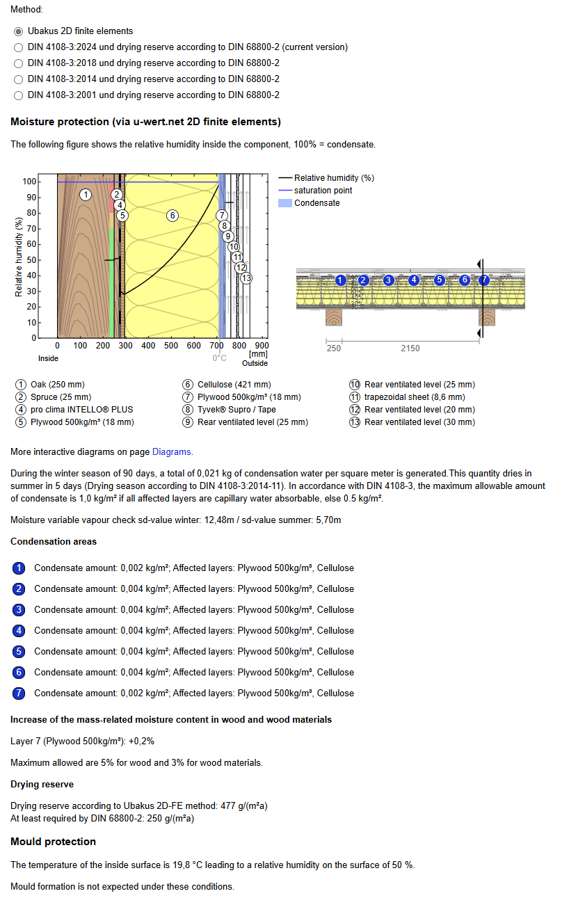

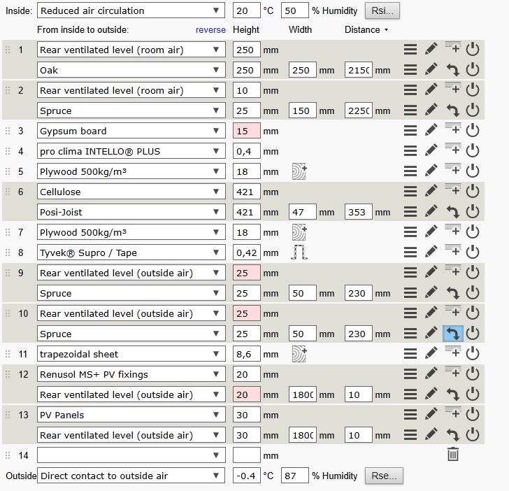

Alan Ambrose Posted Tuesday at 10:10 Posted Tuesday at 10:10 Anyone have any thoughts on this? Ubakhus seems to have found a moisture problem beneath the outer ply. Is this a real problem? Seems to me that whatever the most outside skin is, it would throw up this problem, no? Is the internal membrane doing anything useful given that it's backing some fairly air-impermeable ply? Is this the key sentence? During the winter season of 90 days, a total of 0,021 kg of condensation water per square meter is generated. This quantity dries in summer in 5 days (Drying season according to DIN 4108-3:2014-11). In accordance with DIN 4108-3, the maximum allowable amount of condensate is 1,0 kg/m² if all affected layers are capillary water absorbable, else 0.5 kg/m². That implies it's fine? 1
ADLIan Posted Tuesday at 13:13 Posted Tuesday at 13:13 A few comments: The DIN standard is specifically for Germany and perhaps linked with compliance with their Building Standards so may not be relevant here You need to use BS 5250 Above BS does not accurately model ventilated airspaces. Convention is to do 2 calcs, one including the ‘ventilated’ airspace and another ignoring all elements external to the ventilated airspace (zero moisture vapour resistance). Actual performance is somewhere between these extremes. Allows a comparison to be made to select safest option 1

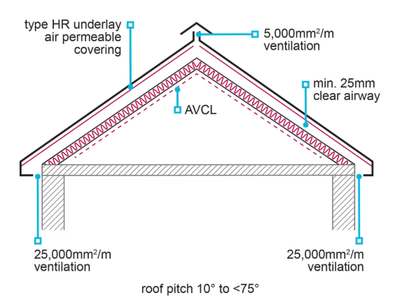

Alan Ambrose Posted Tuesday at 17:14 Author Posted Tuesday at 17:14 Thanks, but both BS 5250 and NHBC seem to just have prescriptions for the common stack-ups. Go, slightly off-piste...and you're on your own. And I was trying to understand the building physics rather than find a somewhat-relevant cookbook in the relevant standard. For instance NHBC says: NHBC: 7.2.15 Ventilation, vapour control and insulation - NHBC Standards 2025 NHBC Standards 2025 Where a Type LR underlay is fully supported on sarking sheets or boards which offer a high resistance to the passage of air or water vapour, such as plywood, OSB, chipboard, or tongue and grooved sarking boards, the Type LR underlay and sarking should be treated as a Type HR underlay, for roof ventilation purposes. ... and that's kind of what I've got.
