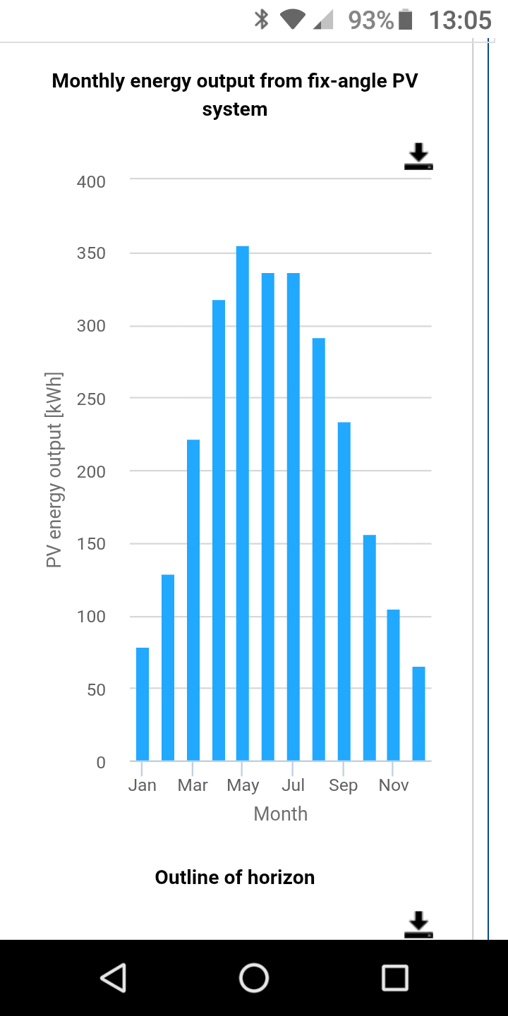

Go to PVGIS here and see what sort of output you can expect.
You should get something similar to this.
As for best usage, that is probably best to divert excess to a heat pump and store some as hot water.

1 hour ago, SteamyTea said:
Going to take a guess it is around 3 kWp capacity.
That would probably cost about the same as some batteries.
It all really depends on how and where you use your energy most, DHW, Space Heating, General Usage i.e. cooking, clothes washing, lighting, entertainment systems.

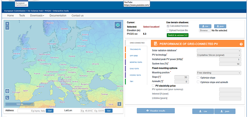

Posted
18 minutes ago, Robbrosky said:
could not make heads nor tails of it and could not get anything like your image from it
Get yourself on a laptop or desktop and try this link.  Mobile phones are useless on their site.
https://re.jrc.ec.europa.eu/pvg_tools/en/
You should get a screen like this.
Zoom in on the map and put a click/pin where you live, choose any of the solar radiation databases, they are all similar (at this stage).
Change any angles if you need to, as well as the size of the system.  Then click on Visualise Results.

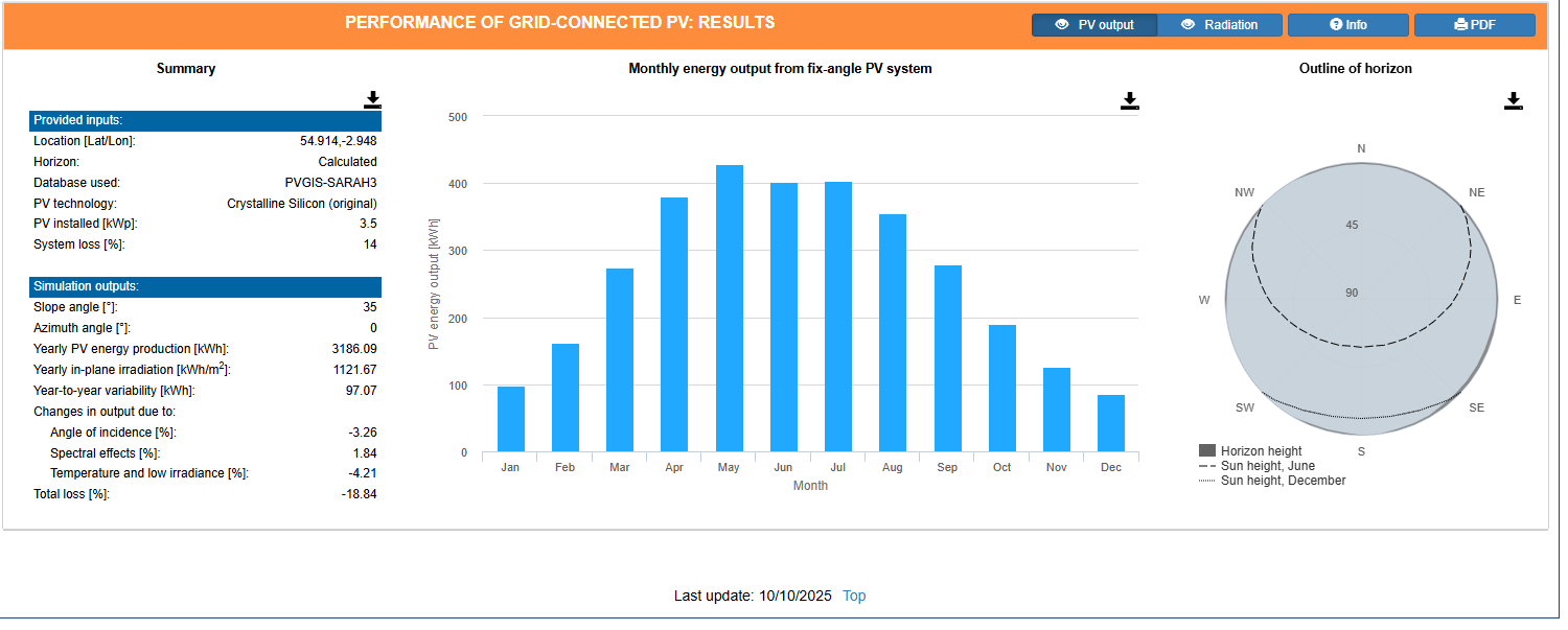

Posted
This is what I get when I change the output to 3.5KwH.
Is that OK?
What does it actually mean in terms of my thoughts as it just looks like a lot of pretty blue bars to me?
Ive 'fag packet' calculated my average KwH usage is around 16 Kwh. This is just the mean average so obviously a lot more in the winter than summer.....although to be fair the monthly electricity bills range from £188 in Dec to £136 in September so not a HUGE difference.

Posted (edited)
Is that OK?
Right, the important times are October, November, December, January, February and March, with the really problematic months being December and January.
So October you will get a mean generation, the kWh (not Kwh), of 191 kWh, November 126 kWh, December (the worst month) 85 kWh, January 98 kWh, February 162 kWh and finally March 274 kWh.
Starting with heating hot water, it takes 4.2 kJ (kilojoules) or 0.00117 kWh, to heat 1 litre of water by 1 K (kelvin, which uses the capital K).  One kelvin (uses lowercase first letter when used in science, except at the start of a sentence) is, in this case, the same as 1 °C.
So in October, you have enough energy from the PV, on average, to heat up 4310 litres of water from 12 °C to 50 °C, which is 139 litres a day.   Quite a useful amount.
November would be 95 litres/day, December 62 litres/day (not much), January 71 litres/day, February 131 litres/day and March 199/day litres.
Now I have no idea how much hot water you use, you will have to work this out (a measuring jug, thermometer and a stop watch).
This does assume that all your PV production goes solely to heating hot water.  In reality, with a diverter, you may only get 2/3rd diverted (depends what else is going on in the house at the time).
If you diverted to a heat pump, when it is running, you may, with careful timing i.e. run it from 10 AM to 2 PM utilise half your production, but you will get about 3 times that electrical energy converted to thermal energy.
So October you will get 208 litres/day, November 142 litres/day, December 93 litres/day, January 107 litres/day, February 196 litres/day and March 299 litres/day.
Now as you will be importing energy at the day rate from your supplier, you may find that during these months there is not much difference in running costs, but from about mid March to Mid October, you will be saving, but you will have to have bought a heat pump and possibly a domestic hot water cylinder depending on what you have installed already.
Now let us consider battery storage.  There are energy losses during the charge/discharge cycle.  These vary depending on the rate of charging and the amount of charge that is already in the battery.  The fuller they are, the harder it is to charge them the final bit.
10% losses would be a reasonable starting point.
So rather than look at what can be done heating water, we will look at how much PV energy can be stored and extracted per day.
October 5.5 kWh/day, November 3.8 kWh/day, December 2.5 kWh/day, January 2.8 kWh/day, February 5.2 kWh/day and March 8  kWh/day.
Now it should be possible to store most of your PV production into the batteries with some clever diversion, though it may be more sensible to work on 80% utilisation.
So October 4.4 kWh/day, November 3 kWh/day, December 2 kWh/day, January 2.3 kWh/day, February 4.2  kWh/day and March 6.4 kWh/day.
If we convert that to amounts of hot water.
October 100 litres/day, November 68 litres/day, December 45 litres/day, January 51 litres/day, February 94 litres/day and March 144 litres/day.
So less energy is directly put into the hot water than heating directly from the PV.
Any shortfalls will need to be made up by imported energy at whatever rate you pay.  But remember that if you fully charge your batteries during a cheap period, there may not be any spare capacity to store excess PV generation.
You may find that doing some simple and cheap improvements to the fabric of your house will give a better saving overall.  There are also behavioural changes that can make a huge difference (why half the time my house uses no energy at all).
