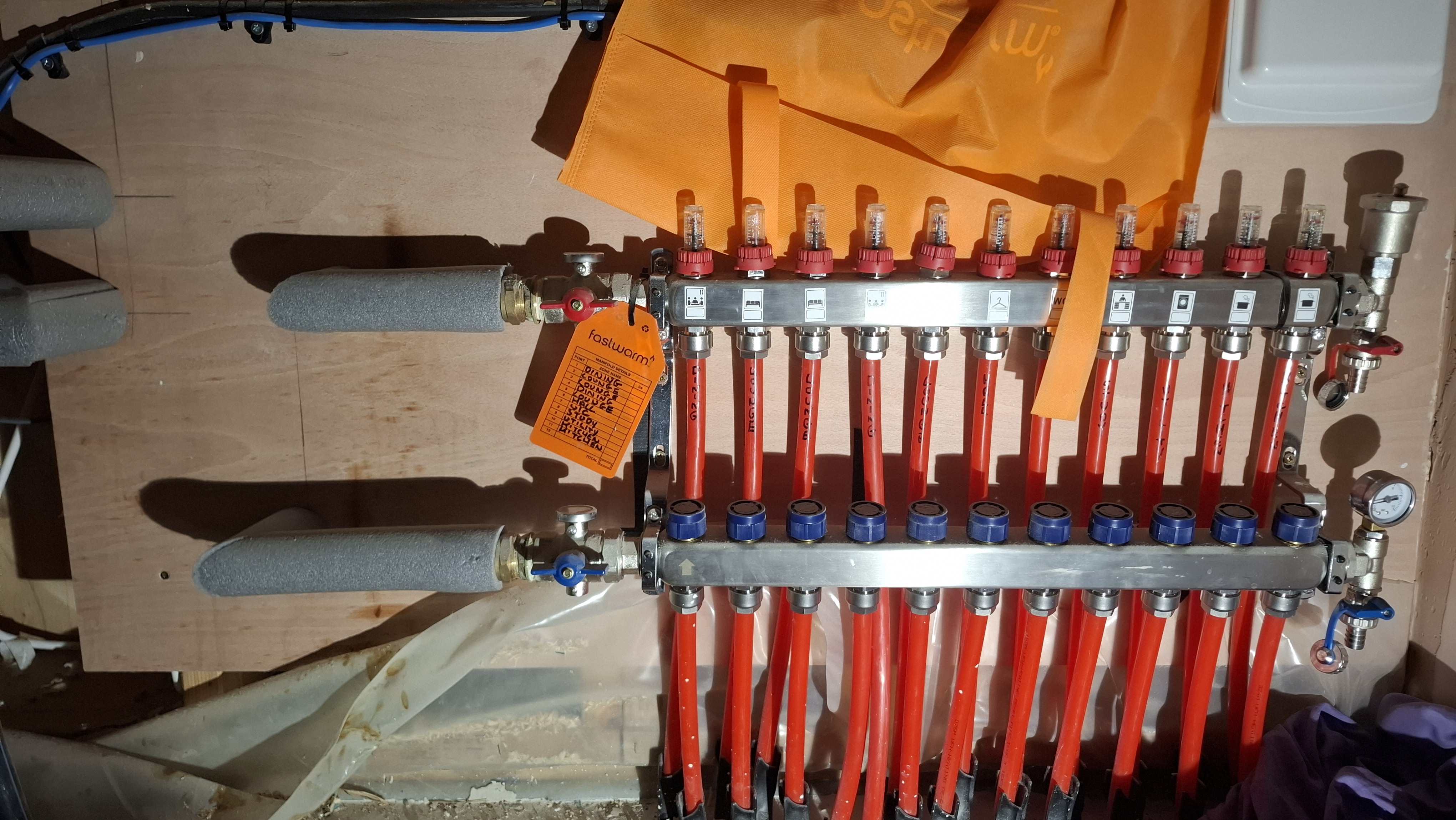

post pictures of your UFH manifold, please.
Will do once i get home

Temperature Modulating Valve. It will be a valve with 3 pipes near the manifold/pump for the UFH, and probably have a coloured top - to adjust the URHF feed temp to a lower value than the rads need.

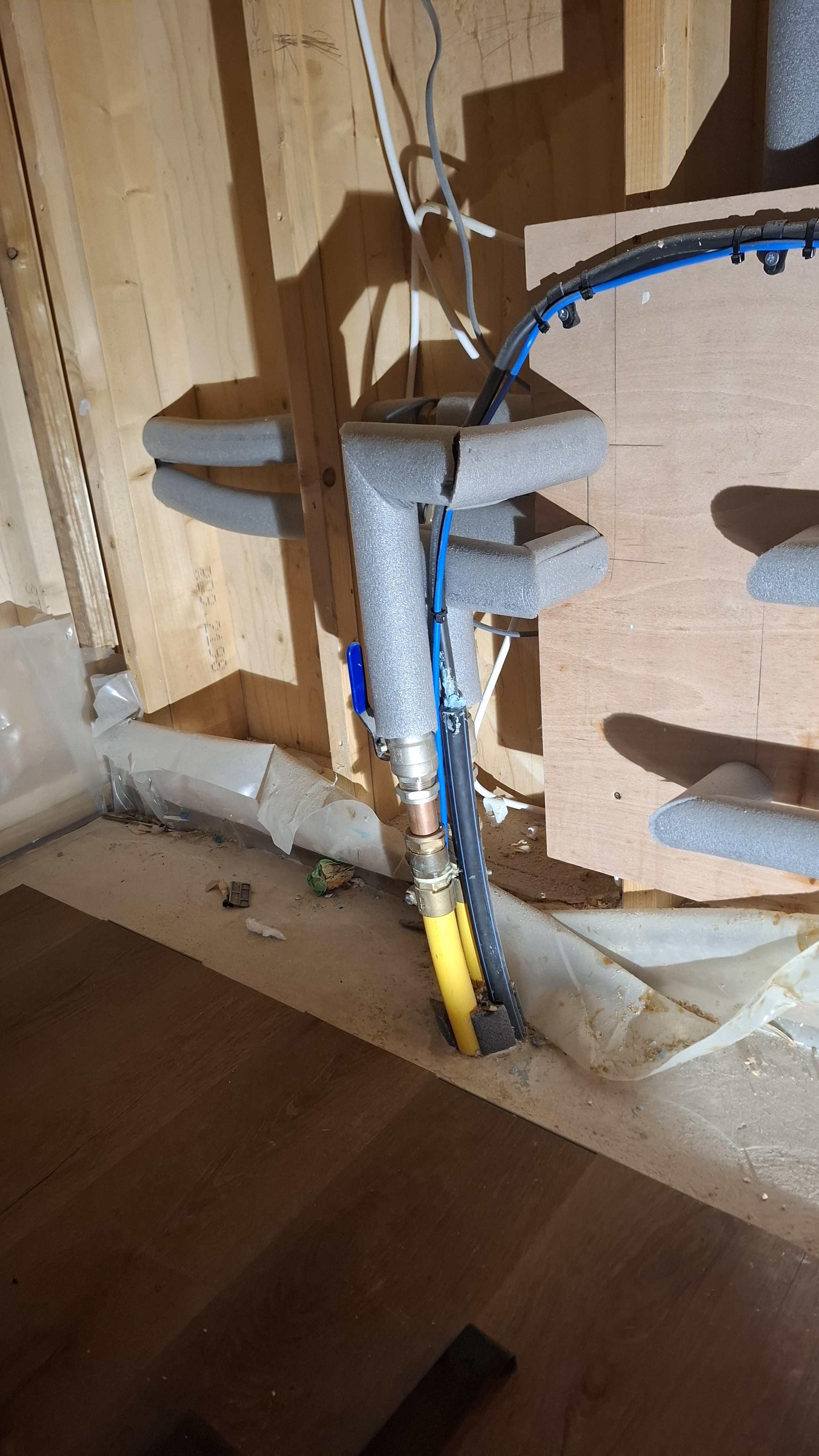

The yellow vertical pipes come from the Ashp up through the slab and go left and up to the UVC. They are 28mm. On the manifold picture the 2 pipes come from the UVC area upstairs, they are 22mm. No TMV .
Thanks for the pics.
So you have a single CH flow temp, and no differentiation between UFH requirements and those of the rads.
Not a great setup afaic, so I’m not surprised it’s not ‘doing exactly as it says on the tin’.

The quickest route is to just add a TMV and pump to the UFH manifold, and raise the CH flow temp of the ASHP.
I doubt you have enough wiggle room to just slow the UFH flow rates down, but it is a possibility; but then you’d need to dial the CH flow temp up by max 2-3° to see if the rads perk up a bit.
This will be quite coarse, and as TRV’s operate the balance will shift as it’s all hydraulically interconnected; water flow will just go to the path of least resistance, so that’ll prob be the shortest UFH loop or the first rad that it ‘sees’.
Ultimately, I think it’s time you called the installers back, sit them down, and lay all this out in front of them, as atm you’ve not got a system fit for purpose and a wedge missing from your bank account for the (dis)pleasure.
