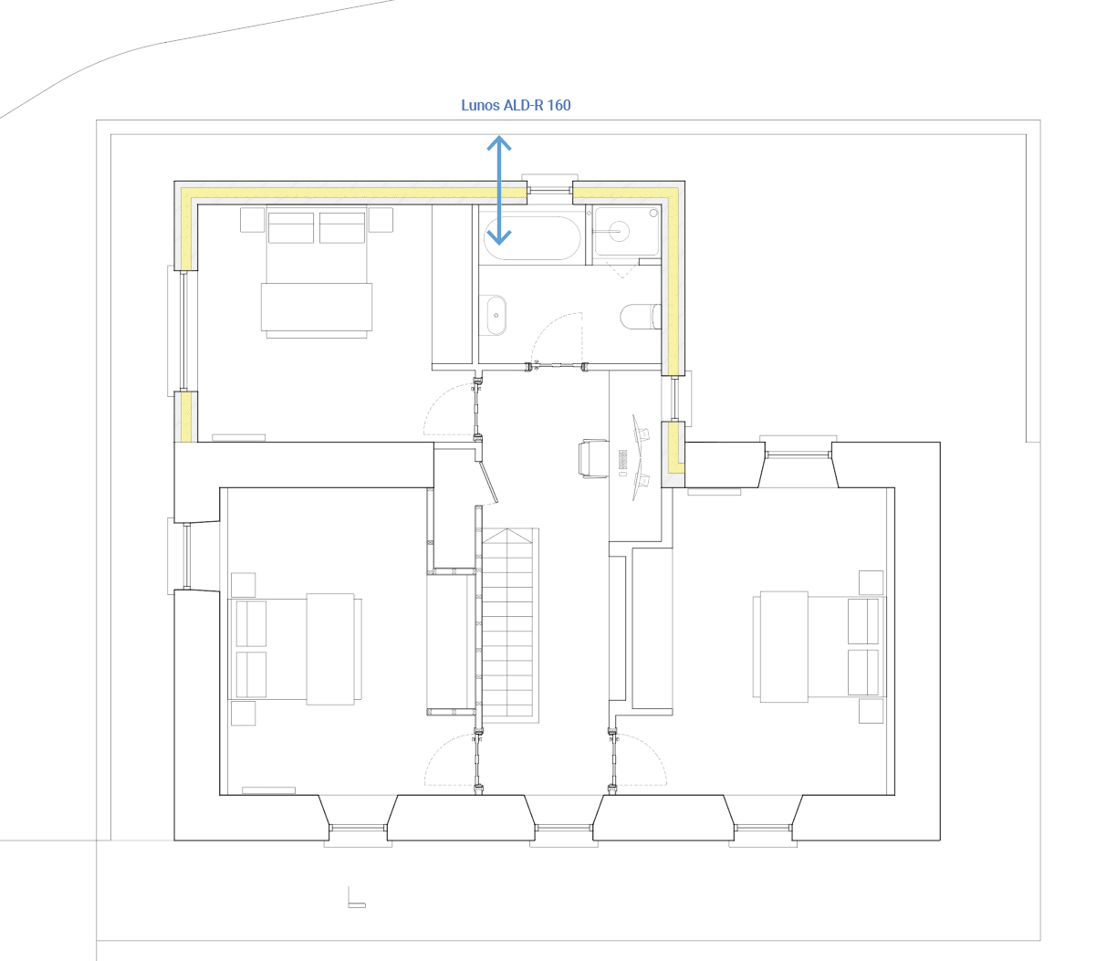

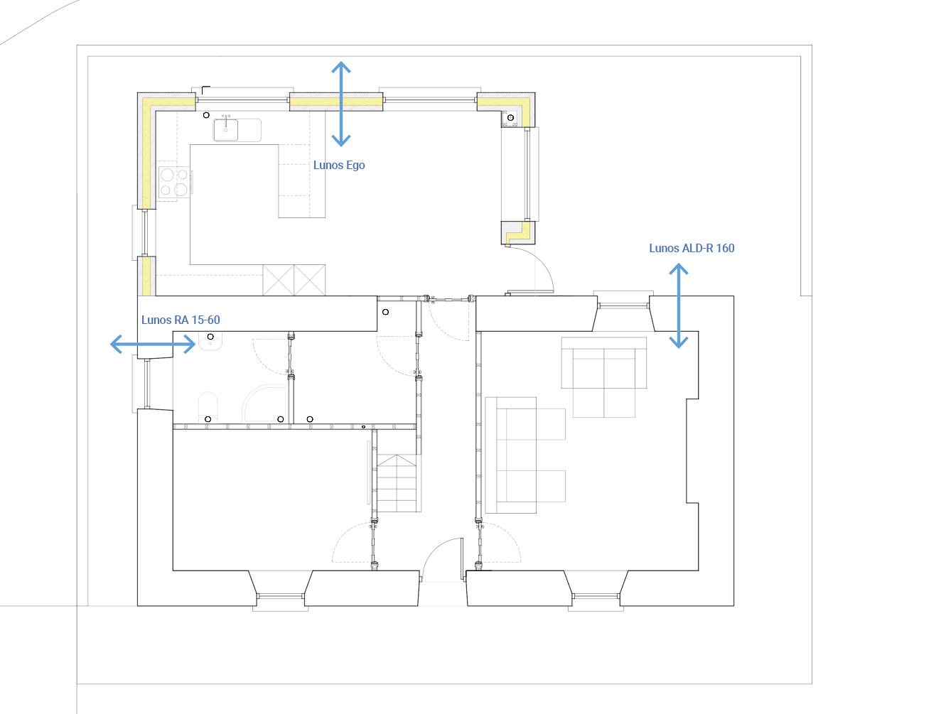

Bemak Posted October 14 Posted October 14 Looking to bottom out the ventilation strategy for a farmhouse I'm renovating at the moment. Had originally thought I'd go for a MEV system but I've since started to lean towards a dMEV system instead. The house is gutted at the moment so I'm thinking it would be a good time to start coring vents in the stone walls and get the mess over and done with. At the moment this is my thinking (based on the Lunos system. doesn't have to be Lunos). Note all windows will have trickle vents.: GROUND FLOOR passive vent in sitting room for stove extract wall vent in WC - which would also help vent the small utility adjacent (washing machine only, no dryer) another vent in the kitchen dining - the Ego is a new exhaust fan with heat recovery from Lunos kitchen will also have a separate extractor over hob. just not shown below. FIRST FLOOR extract vent in bathroom (Lunos ALD-R or Silvento). while all windows will have trickle vents, my feeling is I probably need another passive vent in the landing to balance pressure? I could core a vent in the wall at the bottom, to the left of the window but I would rather not have a vent here on the elevation. Could I provide a passive vent serving the landing via the attic/slate vent instead? if I need one? I originally had planned to duct a MEV system all around the house but I'm leaning towards the above because it seems a lot more straightforward? Appreciate any thoughts and advice.
JohnMo Posted October 14 Posted October 14 The units you are looking at are dMVHR, not dMEV. So they work in pairs one sucks for 20 secs and the other blows and then they reverse. You need them in every room and it gets super expensive. dMEV I would look at Greenwood CV2 or CV3 fans, cheap on eBay normally. Silent in normal operation and have smart humidity activated boost. Have one in each wet room. If wet rooms have a trickle vents close and seal closed. Dry rooms, need an air inlet. If a dry room has a window trickle vent upgrade to humidity activated ones. If not do a through wall humidity activated vent. You will not be able to modify the stove vent so that would stay as is. All internal doors need a 10mm or so undercut so you get ventilation even with doors closed. You shouldn't need anything for the halls as they will get through flow ventilation. 1
