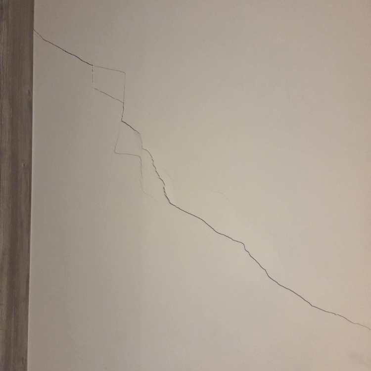

Hitesh Posted October 6, 2025 Posted October 6, 2025 Hi - we live in a detached house in Harrow (NW London) which has a solid concrete floor. We have subsidence showing in various internal walls but nothing can be seen on the external walls. My insurance company had declined the claim as we have a solid concrete floor which was davastating. My questions are 1)Has anyone heard of claim declined due to solid floor? If yes, what are the reasons for this? (I am waiting to hear from my insurer on this) 2)I am looking for a good structural engineer to help me with the whole project - any recommendations? Thanks in advance Harish

saveasteading Posted October 7, 2025 Posted October 7, 2025 Can we see photos of the walls where the damage is? Do you think the walls are loadbearing (supporting upstairs rooms) ? Were they there when you moved in? Generally 100 years ago it would be brick construction on concrete trench footings. and would have moved before now if it was going to. Also for the internal walls to subside but not the externals is unusual. Any big trees nearby? Does the floor appear to have moved?
Redbeard Posted October 7, 2025 Posted October 7, 2025 On 06/10/2025 at 16:00, Hitesh said: We have subsidence showing in various internal walls but nothing can be seen on the external walls Have you had a structural engineer's report? 22 hours ago, Hitesh said: "we wont pay claims for Damage to solid floors, or damage caused by solid floors moving. We’ll pay these claims if the foundations underneath the outside walls are damaged at the same time and by the same cause" You could argue that this quote means that you are not covered., but this covers damage to floors, and refers to external walls. You have an issue with *walls*, not floors! If you have not had an SE report do get one, and ask the insurers to tell you why they *won't* pay out.

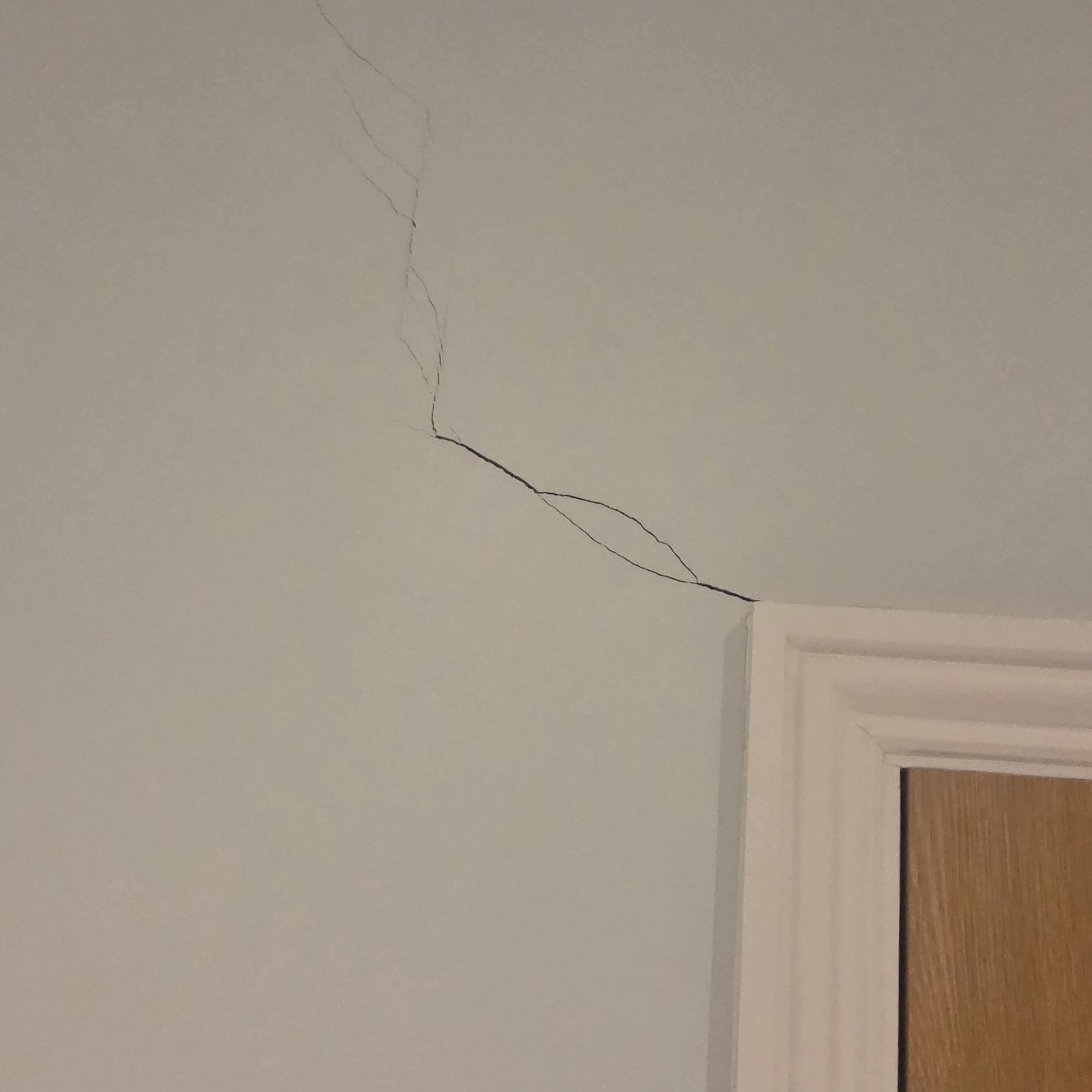

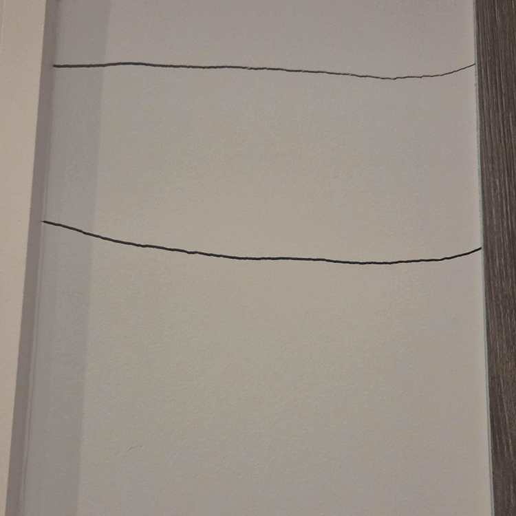

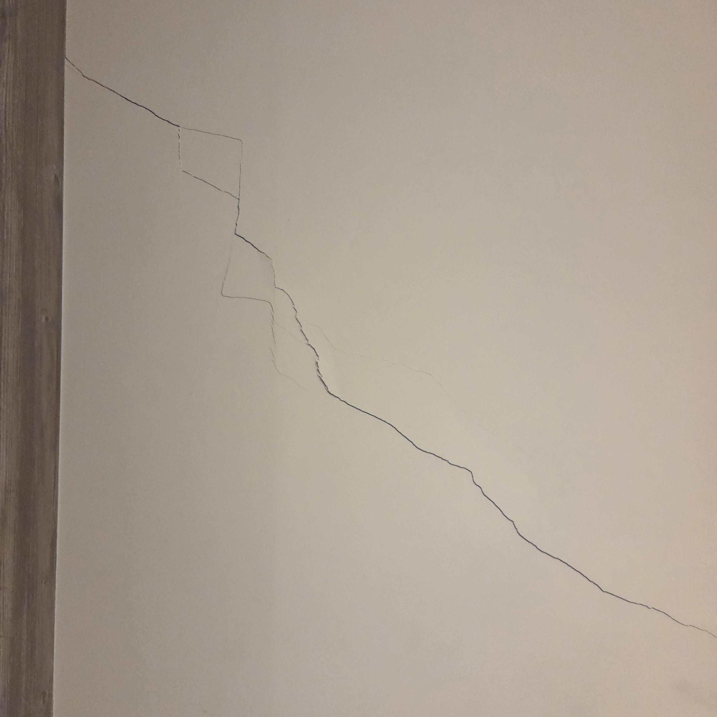

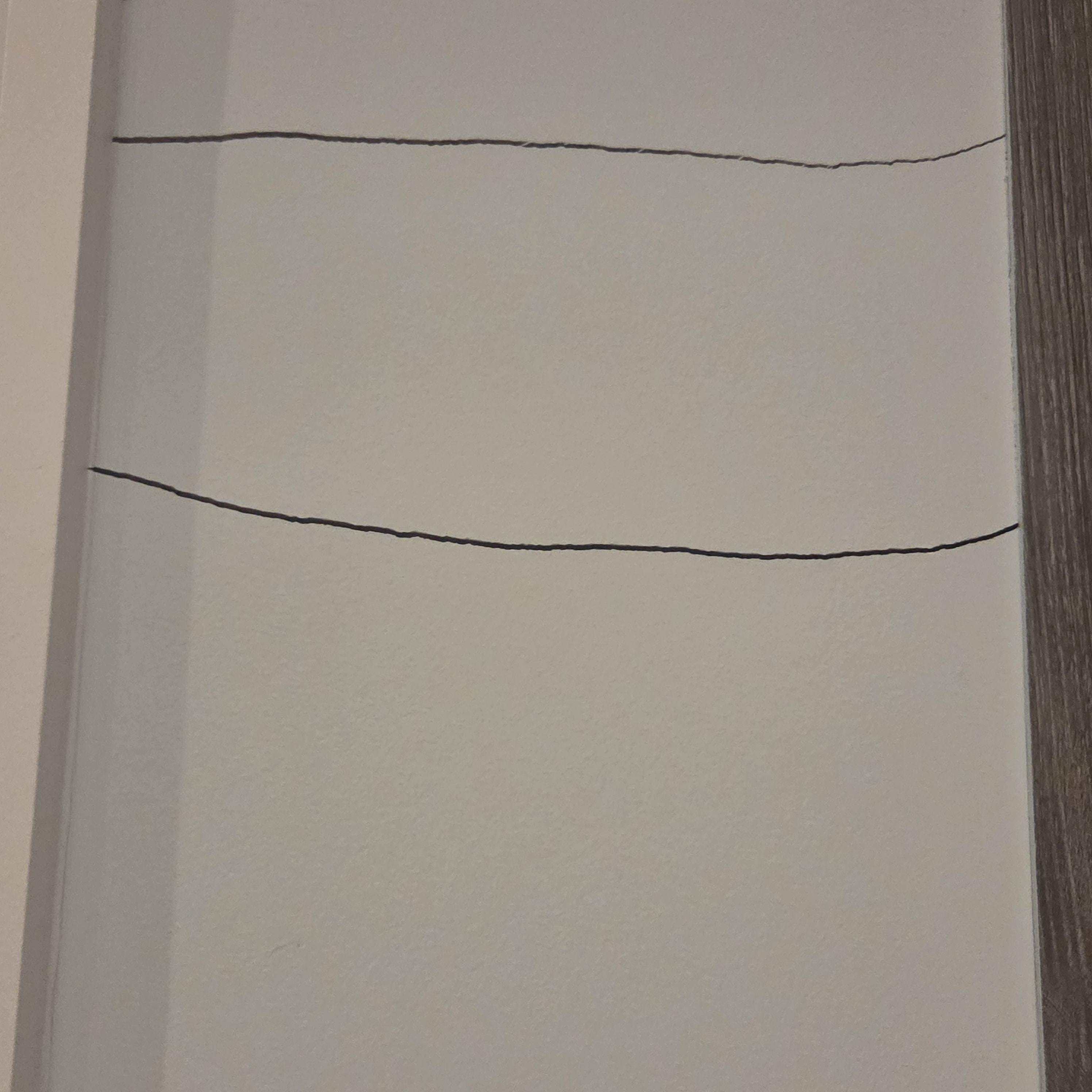

Hitesh Posted October 7, 2025 Author Posted October 7, 2025 Photos attached - the cracks are around 1mm wide. The wall where most of the cracks exist was the original external wall before an extension was built about 35 - 40 years ago. So it goes all the way up. There is a bay tree about 3 meters away and an ash tree about 12 meters away. Yes the floor (of the extension) seems to be sinking. I am waiting for the formal letter from the insurer - once I have this, I will show this to SE and get their report. Thanks for taking the time to read and respond.
saveasteading Posted October 7, 2025 Posted October 7, 2025 How big are the trees? I think the ground is usually clay round your way but you or someone else local may know. Big trees on clay can be a problem. This sounds like subsidence from trees sucking water from clay ground and the hot summer combined, which shrinks the clay. But it's odd that external walls are not affected. Maybe they are but you can't see it. Are they brick? I'm pretty sure this is not because the slab has failed, so insurance should cover it. You must get this looked at by an SE.
