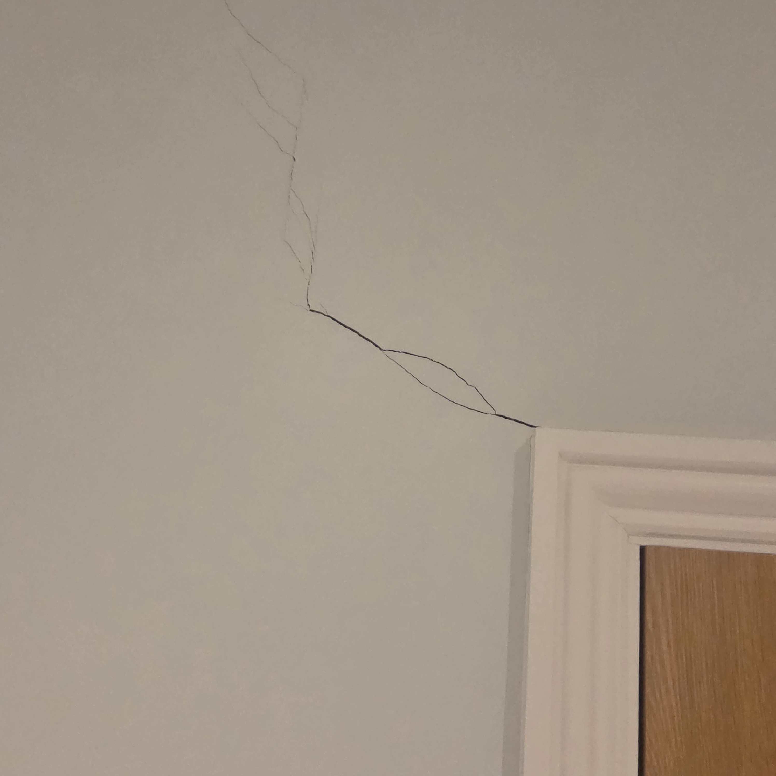

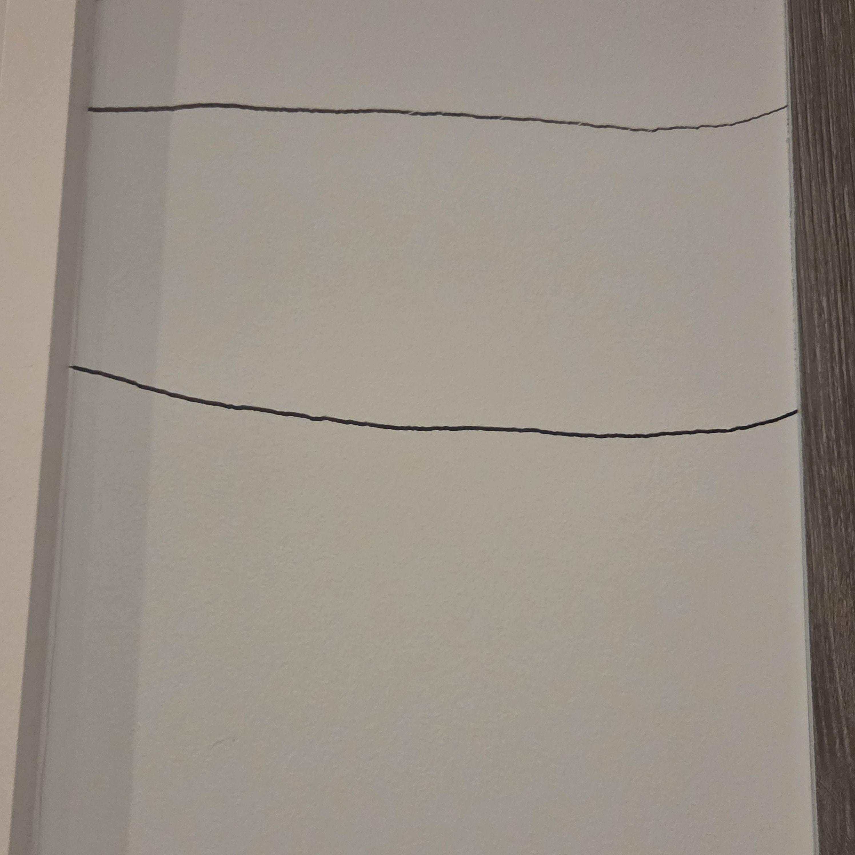

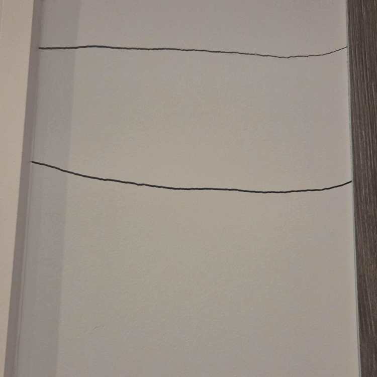

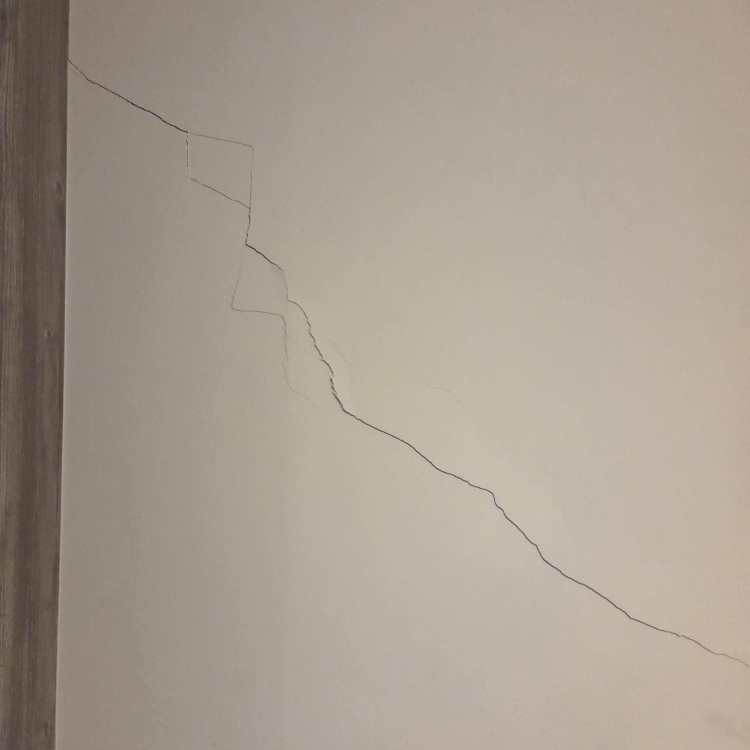

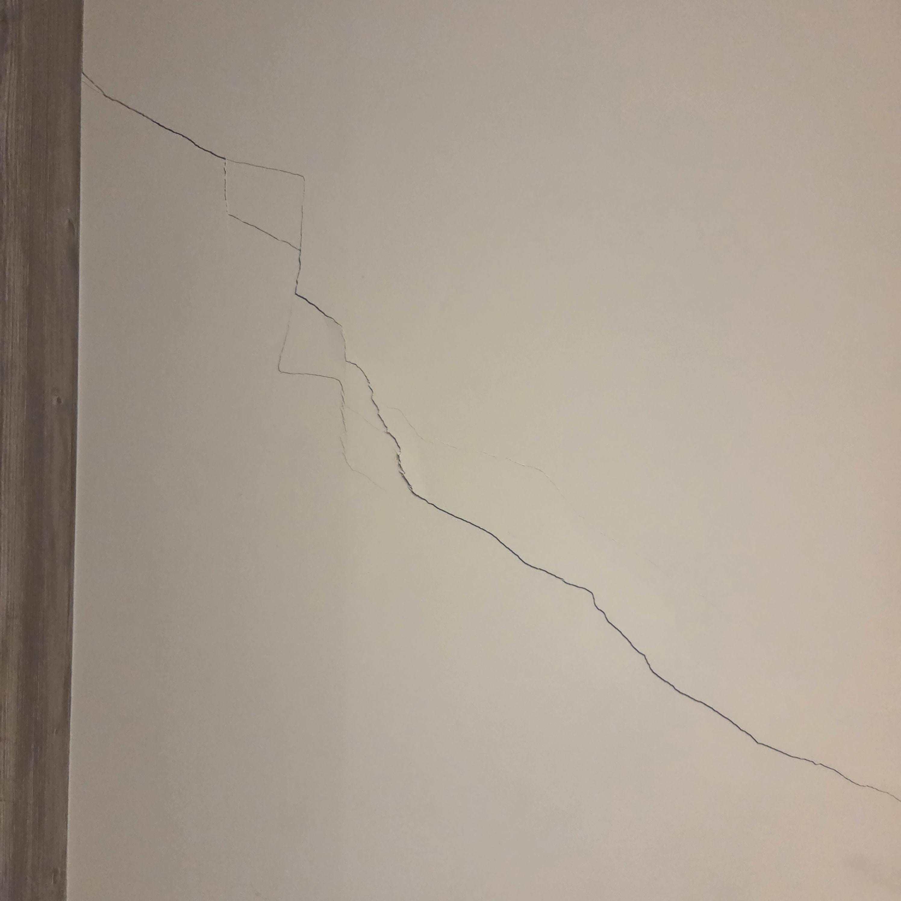

  3. Photos attached - the cracks are around 1mm wide. The wall where most of the cracks exist was the original external wall before an extension was built about 35 - 40 years ago. So it goes all the way up. There is a bay tree about 3 meters away and an ash tree about 12 meters away. Yes the floor (of the extension) seems to be sinking. I am waiting for the formal letter from the insurer - once I have this, I will show this to SE and get their report. Thanks for taking the time to read and respond.
