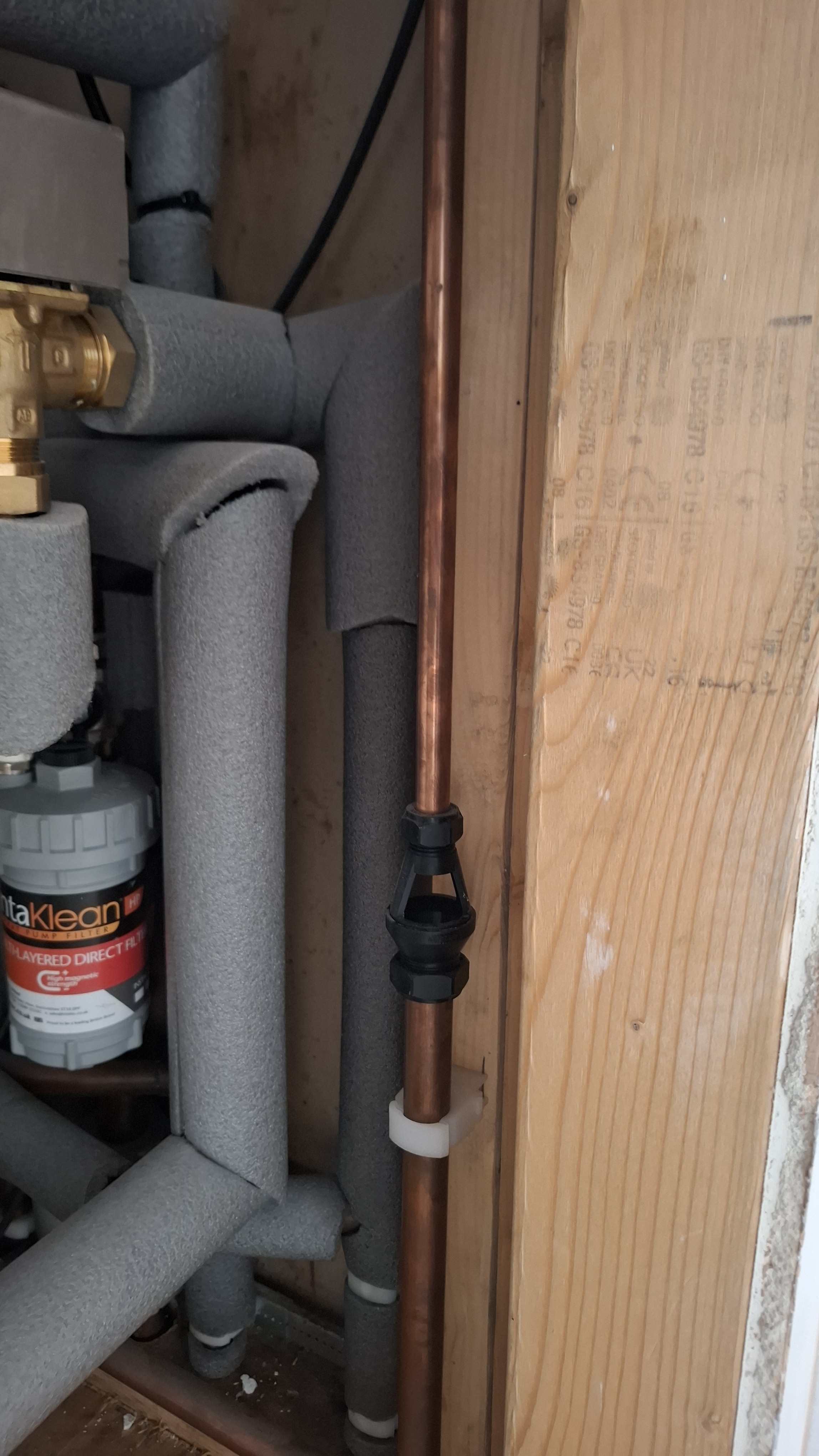

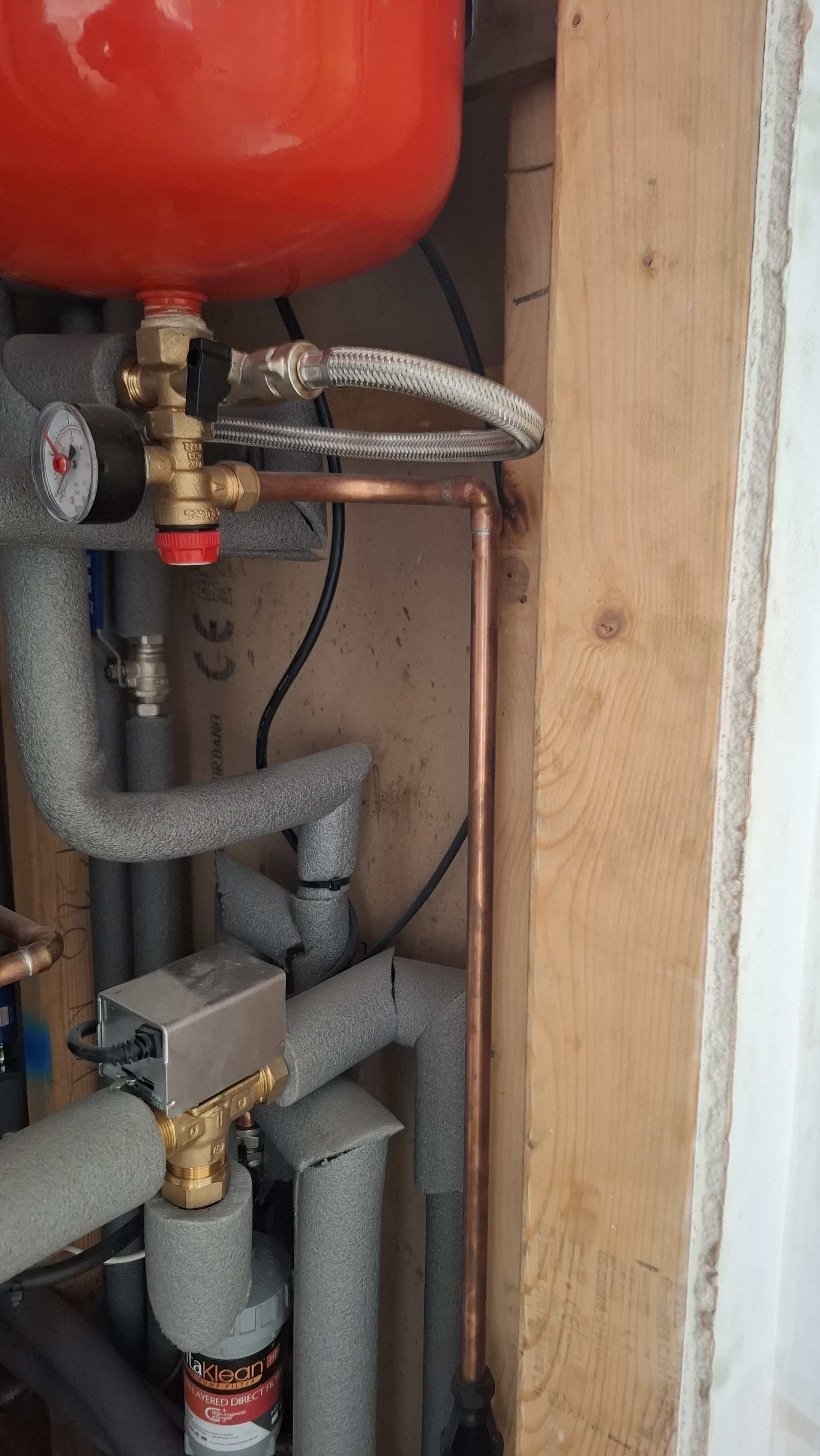

Post and beam Posted October 6, 2025 Posted October 6, 2025 A tundish in our Cylinder cupboard is dripping enough water to splash out onto the floor. It is downstream of the Red pressure vessel. I have not moved in yet and filled the water system to check for leaks on my second fix radiator installations. No heating is on.
Nickfromwales Posted October 6, 2025 Posted October 6, 2025 Odd. Well, the waters coming from somewhere, so the question is; if the heating system’s not been filed why is the heating expansion vessel letting water out?! The gauge appears to be on zero, and I can’t see another feed teed into the pipe? Is that correct?
Temp Posted October 6, 2025 Posted October 6, 2025 12 minutes ago, Post and beam said: I have not moved in yet and filled the water system to check for leaks on my second fix radiator installations. Did you mean you have or haven't filled it with water? Pressure Relief Valves can be temperamental. Possibly just got a faulty one. If they are ever required to open (eg due to over pressure) they are prone to leaking even after the cause of the over pressure is removed.
Post and beam Posted October 6, 2025 Author Posted October 6, 2025 Water system was filled but no heat switched on. Pressure reading on the red vessel was just over 3 bar. Now drained down again until i can get a professional to sort out my poor copper technique.
Nickfromwales Posted October 6, 2025 Posted October 6, 2025 4 minutes ago, Post and beam said: Water system was filled but no heat switched on. Pressure reading on the red vessel was just over 3 bar. Now drained down again until i can get a professional to sort out my poor copper technique. Ah. It’s supposed to be 1.5bar max as that’s the heating circuit. At >3bar the valve is doing what it’s supposed to have done, eg open to relieve the excess pressure, so no problem there. Just refill to 1.5bar and check again. 1

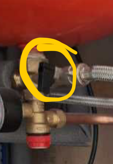

Post and beam Posted October 6, 2025 Author Posted October 6, 2025 2 hours ago, Nickfromwales said: Just refill to 1.5bar and check again. Hi Nick, Do i open the isolator valve and just shut it off at 1.5 bar and let the rest of the system fill with water to whatever pressure it ends up at ? If i shut its isolator what purpose is it serving . 1
Nickfromwales Posted October 6, 2025 Posted October 6, 2025 1 minute ago, Post and beam said: Hi Nick, Do i open the isolator valve and just shut it off at 1.5 bar and let the rest of the system fill with water to whatever pressure it ends up at ? If i shut its isolator what purpose is it serving . If this is the ‘isolator’ then we’re referring to the “filling loop”. The black tap is a 1/4 turn which introduces cold mains water into your sealed heating system. You open that part way, and watch the gauge rise to 1.5bar, and then shut FIRMLY off. Then you’d usually go around venting any air out, this would see the pressure drop to reflect the air (pressure) being let out. Then you’d top back up to 1.5 bar and then check the tundish 24hrs later.
Post and beam Posted October 6, 2025 Author Posted October 6, 2025 Thanks for confirming Nick, understood. The poor technique i refer to is not what you see in the cylinder cupboard pictures here, i meant my poor compression fittings to the radiators and elsewhere. some of which leak slightly. Mind you, reflecting on what you explained just now, if i filled the radiators to just over 3 bar i am less surprised that they show signs of leaks.
