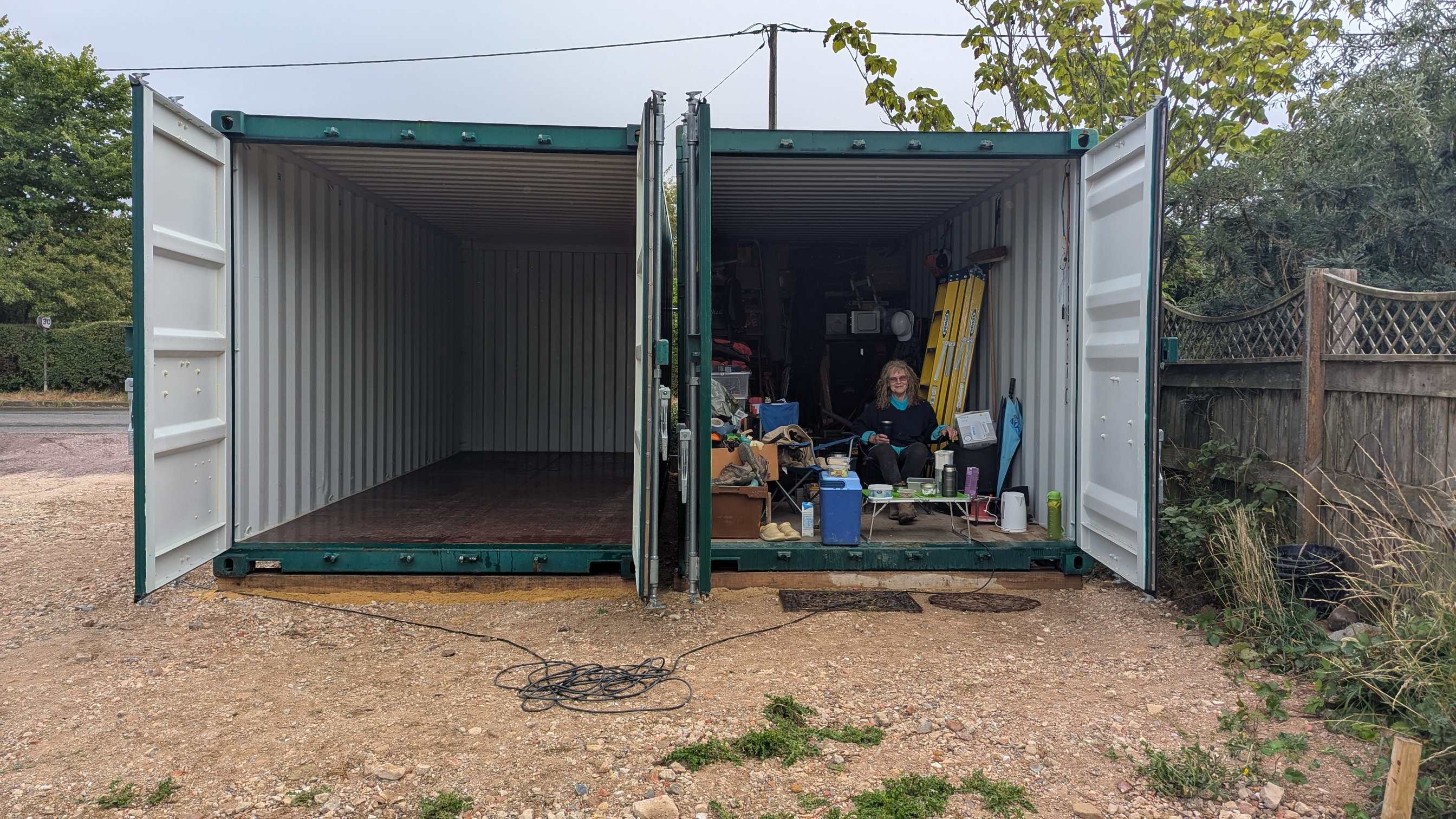

mjc55 Posted September 30, 2025 Posted September 30, 2025 We have two containers on site. 1 for tools etc and one for clothes, furniture and books. I was wondering if anyone with containers have come up with a solution to condensation issues. No problems so far but that is because of the warmer temperatures I guess. I am assuming that issues with condensation can occur over winter. I have seen one option of venting on two opposite sides but can only get to the back and one side of the container as it is too close to the other one to get to the side. Thanks

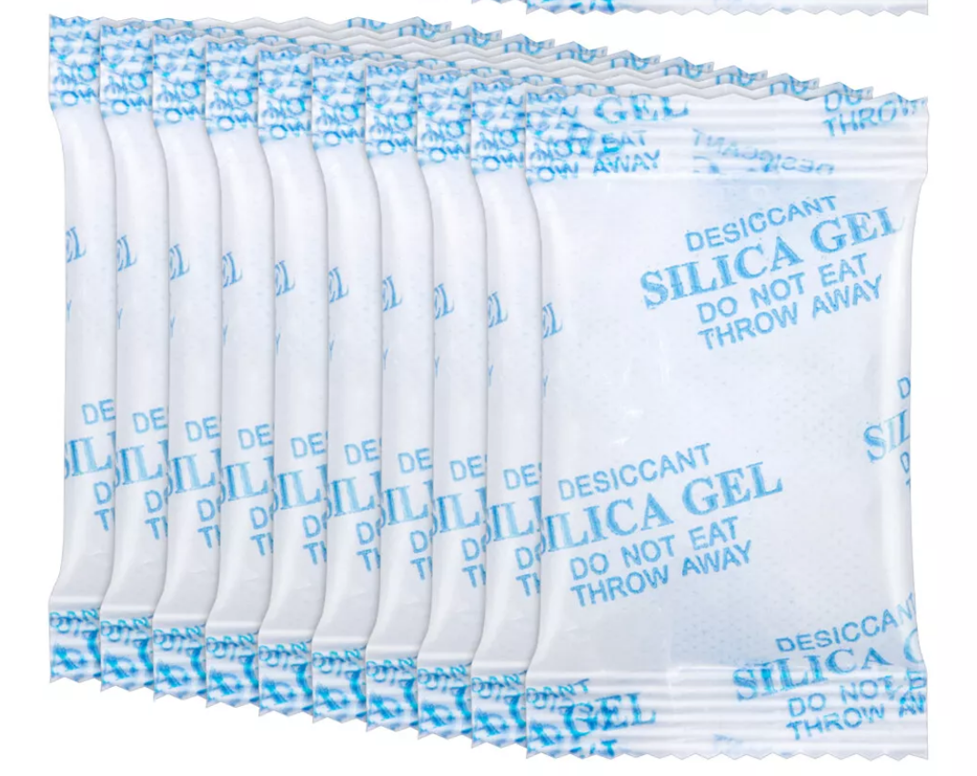

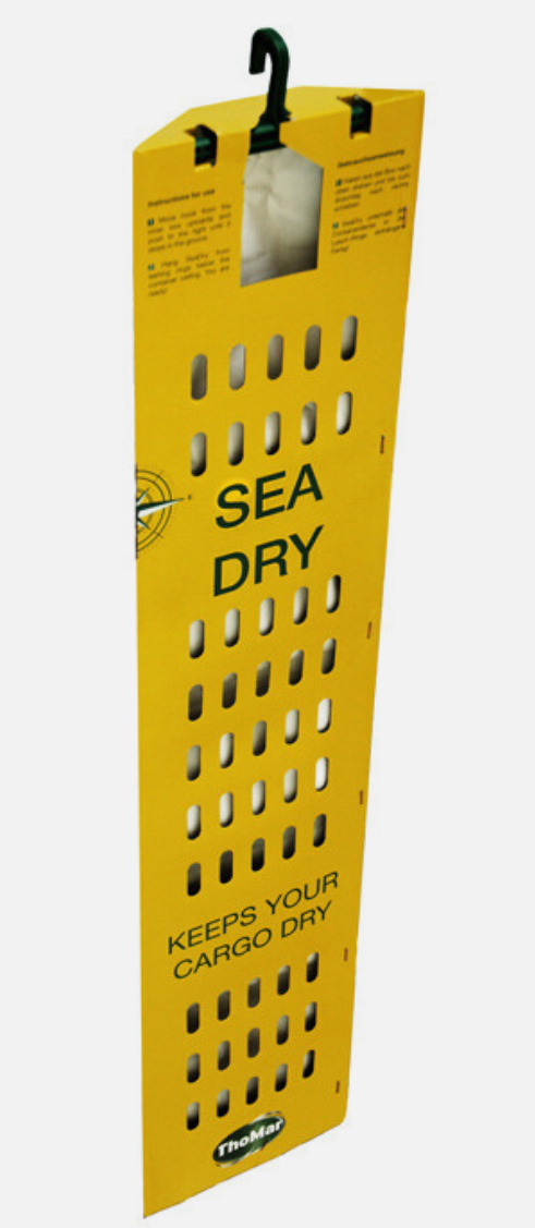

Nick Laslett Posted September 30, 2025 Posted September 30, 2025 (edited) I use these for my storage container. https://www.ebay.co.uk/itm/264424304680#:~:text=They will not leak or,-lasting%2C effective moisture protection. They have a few different sizes. The container has very tiny vents at the top on both sides at either end. As long as you don’t add any moisture, they will stabilise with the outside humidity levels. The worst thing you can do is spend a lot of time in the container, adding moisture through your breathing. Also put plenty of 20g silica packets in all the boxes. Edited September 30, 2025 by Nick Laslett
