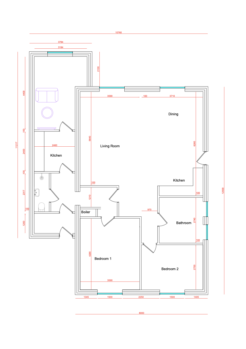

Hi all, we are in the process of looking to rennovate a 2 bedroom bungalow to incorporate an annex/granny flat plus a roof lift. We have just started with very rough sketching prior to appointing an architect and this is what we have so far (we need to add a staircase). We are considering having a vaulted ceiling over the end of the living/dining room but this would depend on cost and if we can accomodate a bedroom, dressing room and house bathroom upstairs plus the steps.
The annex would be self contained to the left. The first rough draft of the downstairs floor plan is below (measurements are approximate at the moment but the gist of it is hopefully clear). Does anybody have any input on what we have done so far please and any comments on how to design the upstairs including steps?
We're hoping to give the architect as much to go on as possible.
Thanks.

Presumably the annexe is intended to be self contained but you've not shown a bed? If the annexe will be all on one storey I'd consider juggling proportions and/or bringing the front forward so there's a small snug/lounge at the front and bedroom at the rear. (Guessing a bit based on limited info)
Sorry, to be clear bedroom 1 would be part of the annex and the annex us planned to be downstairs only. We are planning on an increase in the roof height of around 2m using attic trusses in the new roof to enable a bedroom, bathroom + whatever in the upstairs, effectivly 1.5 storey as you say.

I'd pull the shower room forward and also add a new doorway next to the annex front entrance straight into bed 1. That would bring its kitchen wall forward for more living space and also free up that corridor/lobby space in the main house by the boiler (but still have a door between annex and main)
If losing bed 1 is your main motivation for the roof lift then a much cheaper compromise option would be to make the front of the annex open plan sitting room + kitchen then the shower room and the bedroom at the back. Keep bed 1 for the main house.
There's a chance with a large side extension plugs a roof lift that you spend an awful lot for limited gains, versus finding a property already better suited or doing the minimum to be workable, but I appreciate when you need the annex for family decisions aren't easy
