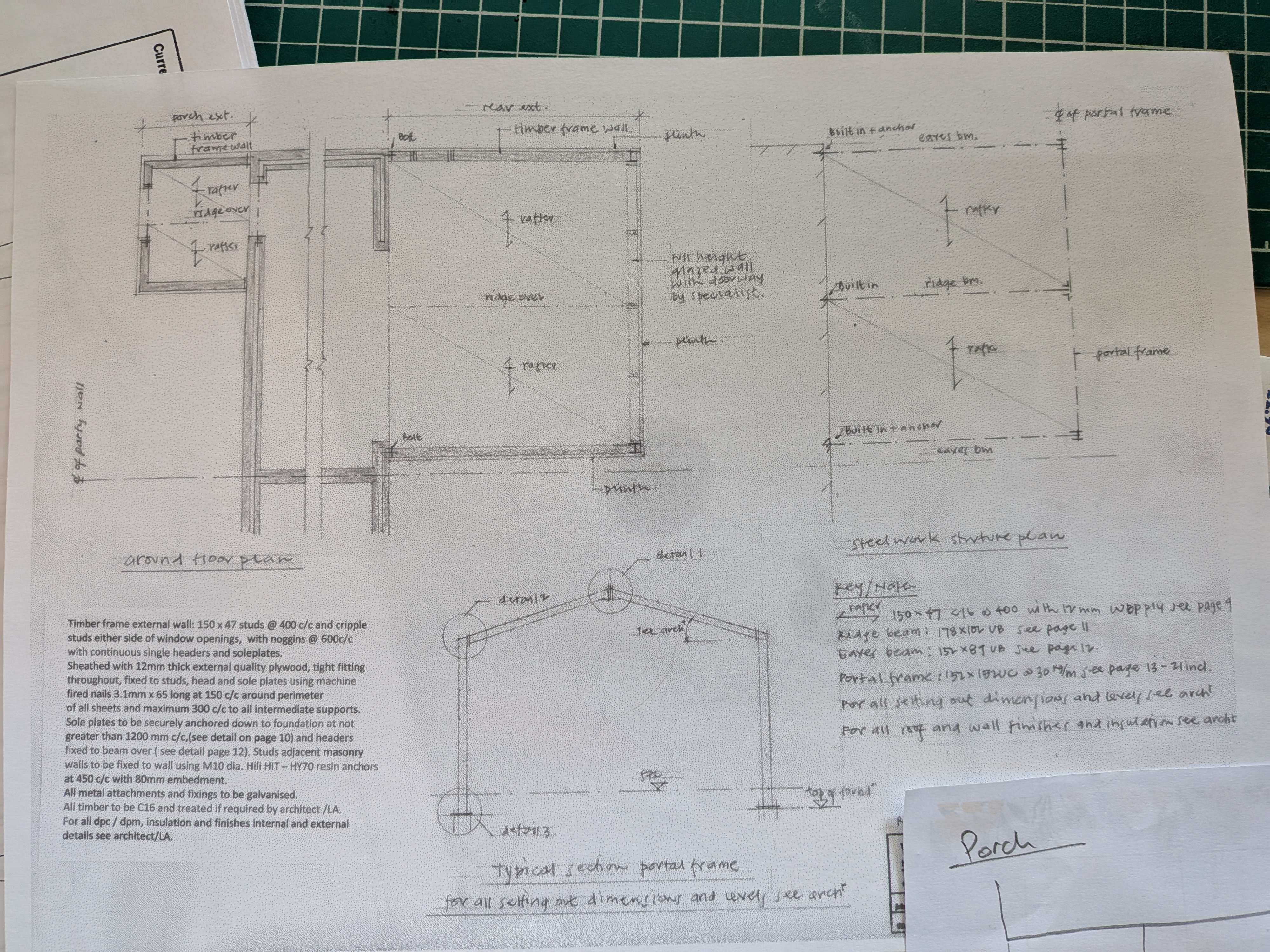

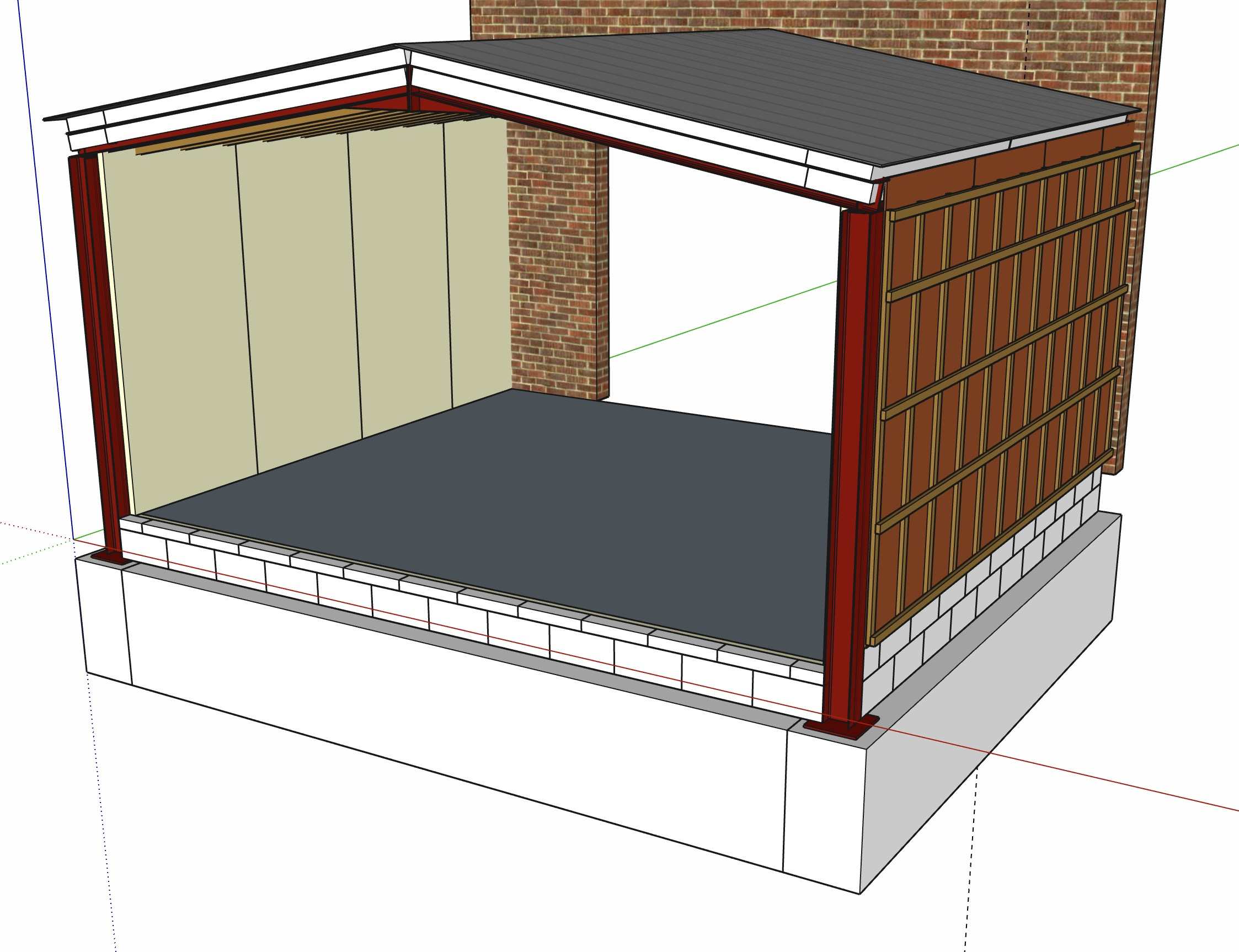

Im planning a single story extension, with a pitched roof that will be built of a steel portal frame with steel ridge leading back to the existing house. so I can have open vaulted ceilings in the extension.
The walls and roof will be timber frame stick built onsite.
I would like to have a warm roof if I can as this sounds like the best option but maybe I am making it more complex for my self than it needs to be for the benefits. I will be doing nearly all of the construction myself.
I have had the structural engineers drawings done, but I would like some advice on the best construction details to minimise cold bridging and making my extension as warm as I can.
I have been reading through various forum posts and watching youtube videos but think I might have confused myself a little bit.

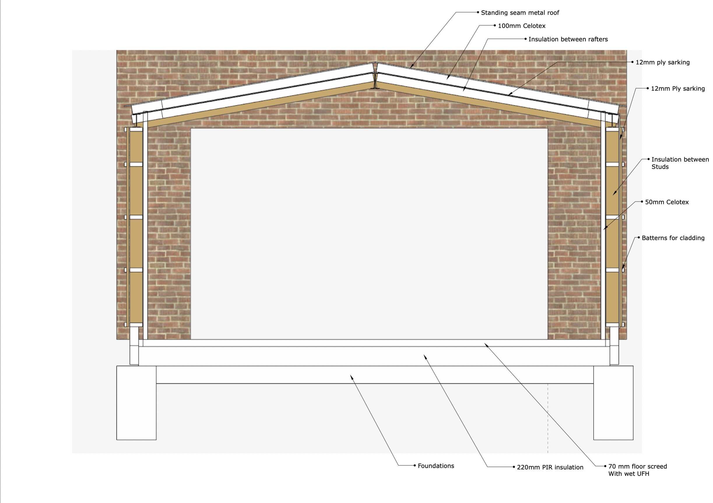

I have attached the plans from the engineer and where I have got to so far with my model. At the moment I am not sure the best way to clad the steel pillars and wether the roof details are correct for a warm roof with standing seam roof. Any advice on this would be really appreciated.

Off-topic, but out of interest, is the v shallow roof pitch as a result of using PD rules?
... or is there a window in the main elev  just above ext'n ridge height?

My ext'n was post-and-beam, EWI'd with 160mm rigid wood-fibre, and a further 100 (or maybe 80 - can't remember) between posts. Thus the majority of the insulation outboard of the structure. Could you do that?
Yes I could put some insulation on the outside of the structure.
What's the proposed wall cladding going to be?
I would encourage ensuring the steels are completely insulated. If they are outside the insulation and get they will be a magnet for condensation and the timber will rot where it was attached.

How about something like this.
You could keep the steel inside the external layer of insulation which would stop any condensation and rot issues at the metal timer connection in future.

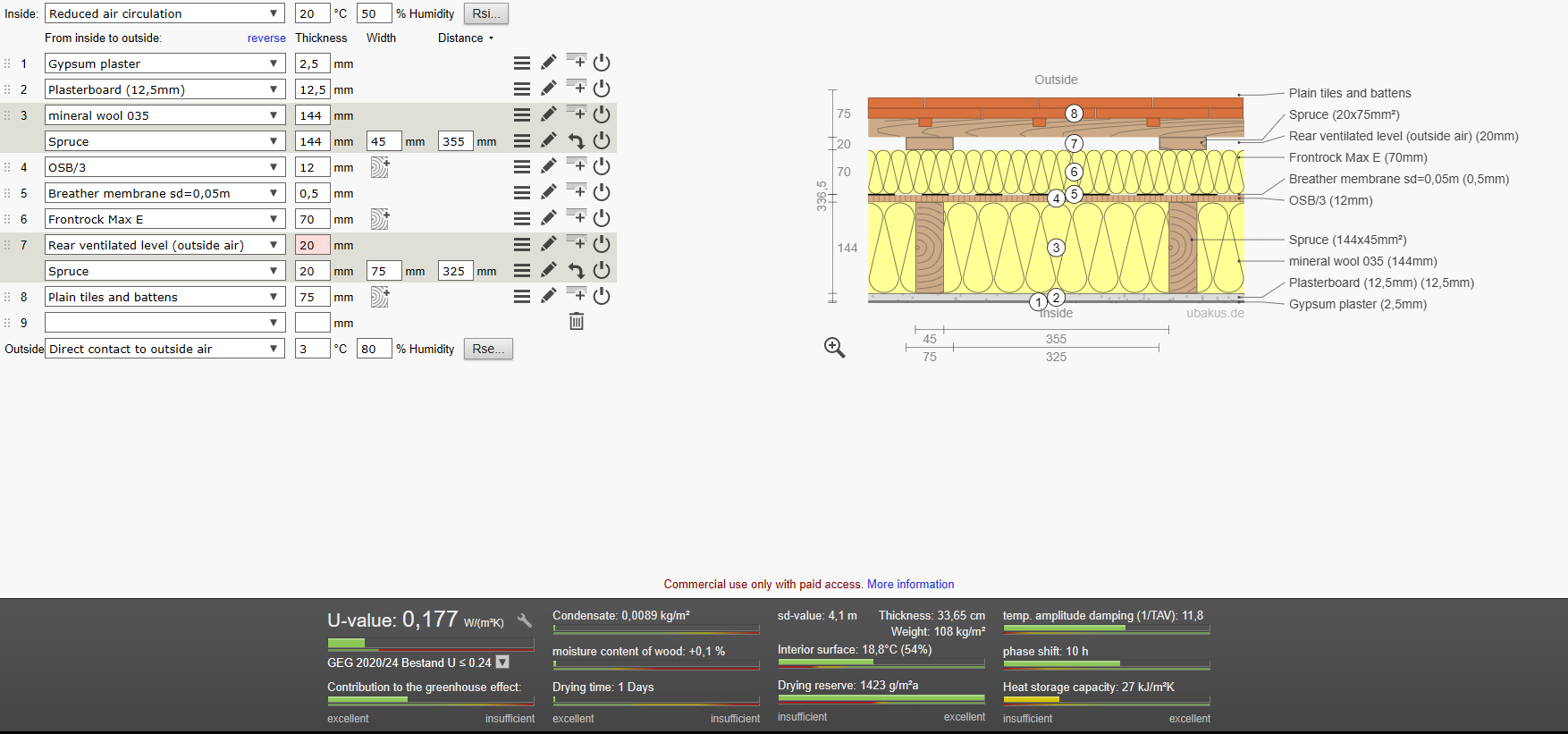

I have been playing with the make up but with PIR boards and mineral wool. but it seems like mixing pir and mineral wool gives me a big condensation risk. Unless Ive just set it up wrong.
Mineral wool in between rafters and PIR over the top is what I was thinking of doing for the warm roof insulation, after reading other threads on here it sounds easier than getting the pir in between the rafters.
Membrane behind plasterboard should be an AVCL, not a breather membrane. Also the OSB may be too vapour resistant. Be careful with balance of thermal resistance of insulation between and above rafters. Too little above may create condensation problem within rafters.
Ahh yes @ADLIan thank you, good spot, my mistake on the drop down menus there! thanks
Ubakus isn't perfect. It just takes a snapshot and isn't representative of reality.
It uses -5 Deg and 80% relative humidity externally which would not be representative of long periods of time in the UK.
Depending on where you are I would happily adjust this up to what might be a more lightly medium term winter average.
