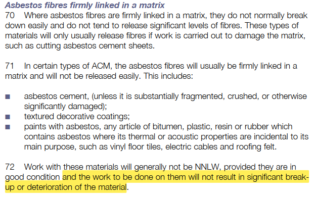

Mike Posted September 6, 2025 Posted September 6, 2025 (edited) 1 hour ago, gaz_moose said: some bits have white asbestos floor tile stuck down ( these bits are 2mm higher than the rest and the tiles are basically welded on) It's not ethical and probably illegal to leave any behind encased in something else that a future builder won't expect to contain asbestos. Bring in a licensed asbestos removal company to remove them and any remaining adhesive, and to decontaminate the space. Also check out the Control of Asbestos Regulations 2012 & the associated guide, which contains this: NNLW = Notifiable Non-Licensed Work Edited September 6, 2025 by Mike

BadgerBodger Posted September 8, 2025 Posted September 8, 2025 Encapsulation is an acceptable strategy so long as there is an adequate record maintained of its location, encapsulation, asbestos type etc. This record would then need disclosing to any future buyers etc. Read up on it, and make your own discussion. This came up a couple of months ago and the general consensus was that work falling outside NNLW was pretty affordable and discharging the ongoing risk/responsibility was worth the squeeze. Just one note, if the asbestos tiles were bonded with bitumen there is a good chance that if tested, that bitumen would test positive for chrysotile too. It was also bound within the bitumen around that time too.
