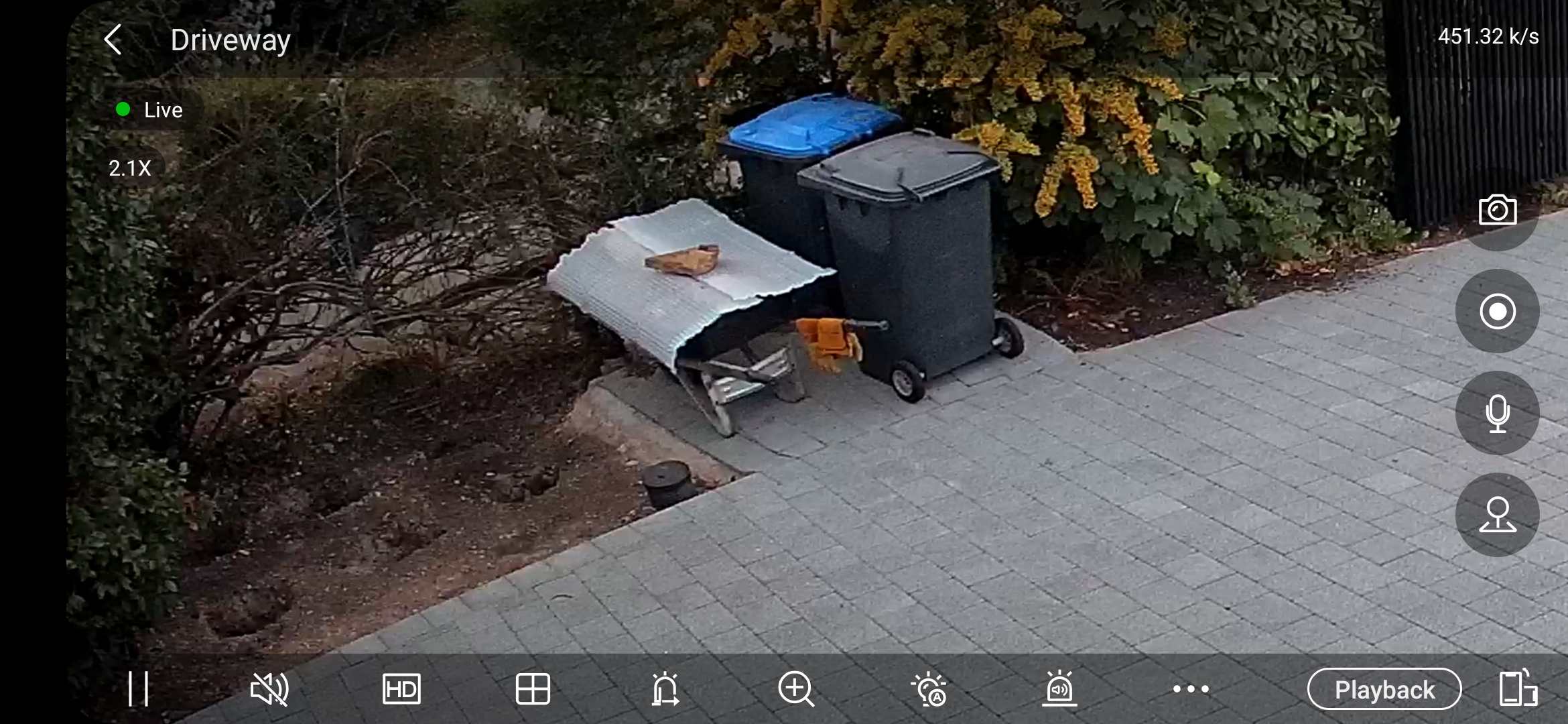

The original bungalow had the stop cock in the bathroom nearest the point where the pipe entered the house.
 Builder has disconnected It as part of the demolition, and reinstated it at the edge of our driveway, near our boundary. Image attached, you can see it in the corner of driveway/bin store paving area.
You can also see where I want to put the shed!
I'm curious as to where the official stopcock is, and where our inbound blue pipe originates from. Wasn't an area of the build I kept an eye on, but I think there is a reasonable chance the builder just tapped into the pipe that existed from when original bungalow was built in the 70s. We then have a further isolation valve inside our utility room.
From the image the inbound supply runs directly under our bin store to the road beyond the bushes on the right hand side... But there is nothing in the road for several metres that's any sign of a meter or further junction.
I don't want a water meter, so prefer not to go down the official loop yet. For now more asking out of curiosity.
