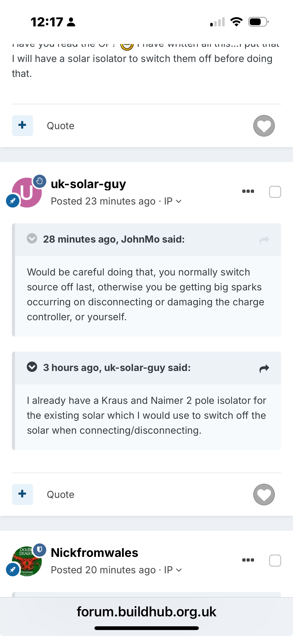

JohnMo Posted August 25, 2025 Posted August 25, 2025 3 minutes ago, uk-solar-guy said: quick connect/disconnect for when I drive off and back Would be careful doing that, you normally switch source off last, otherwise you be getting big sparks occurring on disconnecting or damaging the charge controller, or yourself.
uk-solar-guy Posted August 25, 2025 Author Posted August 25, 2025 1 minute ago, JohnMo said: Would be careful doing that, you normally switch source off last, otherwise you be getting big sparks occurring on disconnecting or damaging the charge controller, or yourself. Have you read the OP? I have written all this...I put that I will have a solar isolator to switch them off before doing that.
uk-solar-guy Posted August 25, 2025 Author Posted August 25, 2025 4 minutes ago, JohnMo said: Would be careful doing that, you normally switch source off last, otherwise you be getting big sparks occurring on disconnecting or damaging the charge controller, or yourself. 3 hours ago, uk-solar-guy said: I already have a Kraus and Naimer 2 pole isolator for the existing solar which I would use to switch off the solar when connecting/disconnecting.
Nickfromwales Posted August 25, 2025 Posted August 25, 2025 2 minutes ago, uk-solar-guy said: That sounds great on paper, not so great when you go and do so in any kind of daylight. You need to cover the panels to go full blackout if not doing this when dark. Needs to be sequenced to protect all equipment, and you!

uk-solar-guy Posted August 25, 2025 Author Posted August 25, 2025 3 minutes ago, Nickfromwales said: That sounds great on paper, not so great when you go and do so in any kind of daylight. You need to cover the panels to go full blackout if not doing this when dark. Needs to be sequenced to protect all equipment, and you! What are you quoting? It is empty. What is the issue if there is a solar isolator? That is what they are for no? I have used the isolator I have already to isolate the solar circuit of my existing panels, so what is different?
Nickfromwales Posted August 25, 2025 Posted August 25, 2025 9 minutes ago, uk-solar-guy said: What are you quoting? It is empty. What is the issue if there is a solar isolator? That is what they are for no? I have used the isolator I have already to isolate the solar circuit of my existing panels, so what is different? Knowledge. Experience. Information. The things you will find here to be plentiful. Is it better to know a risk and be informed, or come back here asking how to fix it after it broke through misadventure? Buildhub is a place where people discuss things, providing reason and rationale; some other forums are more like boxing rings which is great for exchanging blows. I am simply stating something because what you said raised a red flag, eg ‘simply’ disconnecting the DC side to go scoot off to the shops. There are strict guidelines for decommissioning a PV system, regardless of size or location, so as to avoid damage to equipment or personal injury. No matter what DC isolator you say you’re buying, the rules are the same eg never disconnect panel strings in sunlight or under any load, and they need to be the last thing shut down.
uk-solar-guy Posted August 25, 2025 Author Posted August 25, 2025 3 minutes ago, Nickfromwales said: Knowledge. Experience. Information. The things you will find here to be plentiful. Is it better to know a risk and be informed, or come back here asking how to fix it after it broke through misadventure? Buildhub is a place where people discuss things, providing reason and rationale; some other forums are more like boxing rings which is great for exchanging blows. I am simply stating something because what you said raised a red flag, eg ‘simply’ disconnecting the DC side to go scoot off to the shops. There are strict guidelines for decommissioning a PV system, regardless of size or location, so as to avoid damage to equipment or personal injury. No matter what DC isolator you say you’re buying, the rules are the same eg never disconnect panel strings in sunlight or under any load, and they need to be the last thing shut down. I was not being snarky I was stating that your above post the quote is empty. So I was asking what you were quoting so I could know what you were responding to:
