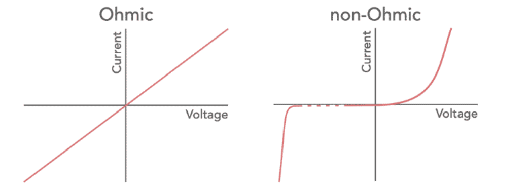

Alan Ambrose Posted October 31, 2025 Posted October 31, 2025 LEDs are current-driven devices (they’re diodes, of course, so ohm’s law doesn’t apply) - so as long as you have enough voltage greater than the forward voltage of the LED (string?), the voltage drop should be irrelevant.

-rick- Posted November 2, 2025 Posted November 2, 2025 18 minutes ago, NBW said: Not having solar, too concerned with efficiency, I am leaning to @MortarThePoint approach The 48V approach? I thought @MortarThePoint was making a more theoretical argument. Not sure there is much 48V lighting available to buy. 18 minutes ago, NBW said: I am worried that 24v LED lighting won't be as bright or easier to source as typical 230 lighting. Voltage doesn't really relate to brightness. All white LEDs need about 3.3V. The difference between a bulb needing 12v 24v and 240v is the number of LEDs run in series vs number in parallel. Brightness is just dependent on the specific layout within the bulb/strip. Bulbs/strips are sold on the basis of a brightness output often in lumen. The only case where voltage matters, is if you have undersized your supply cables which is to be avoided in all cases (even if you don't care about efficiency) because an undersized cable will heat up.
