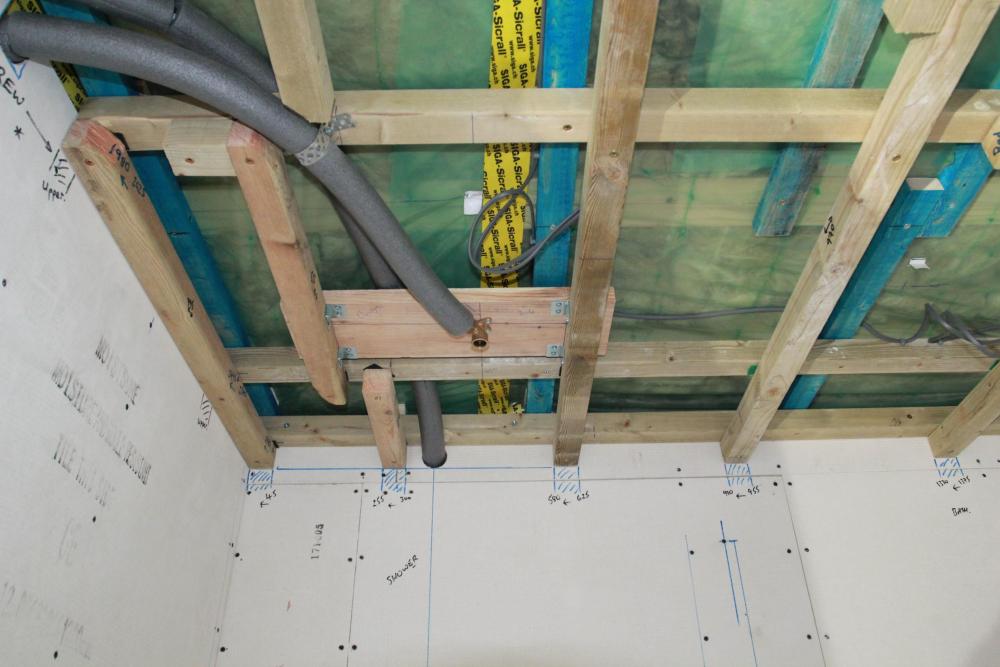

Onoff Posted May 20, 2018 Author Share Posted May 20, 2018 (edited) 3 hours ago, Nickfromwales said: PS. Bloody hell. Do I post here about general plumbing or back on the mother thread ? General plumbing's good! As you know the original plumbing here is a point-to-point f***fest! So gradually it'll all come out. The shower pump is nom 10m from those flexis above. From the ensuite shower it jumps from 15 as you can see then goes across the top of the dormer (7m) in 22. It drops back down to the shower pump in the eaves the other end where it's 15 for say the last meter. The supply to the pump is; hot in 15 all the way to the pump from a Surrey flange atop the cylinder. Cold comes from the 25gal cws in 22 then 15 for the last metre. The pump was shagged when we bought the place so replaced with the only one that said it could cope with a 25gal fed...most said 50gal min. Where I'm working now, above the new bathroom I've already done it in 15mm in the walls and then just left them poking up into the loft. I was hoping to do 15 across the loft as I've got the pipe. Something like this: Edited May 20, 2018 by Onoff Link to comment Share on other sites More sharing options...
Nickfromwales Posted May 20, 2018 Share Posted May 20, 2018 If the upstairs shower is teed into the hot and cold run, then it should be with 22mm tees with 15mm centres and then 22mm pipe onward to the cylinder & cold main. Maybe look at setting this up for an UVC and keep your old copper tank as a heating buffer ? Or are you happy to go one cylinder and make it a TS? I think we should keep the plumbing on the other thread and just dedicate this one to your latest beer-fuelled invention ? Link to comment Share on other sites More sharing options...
Onoff Posted May 20, 2018 Author Share Posted May 20, 2018 Hmmm... Got to re think the route of the shower feed pipes: Just move them to the left I guess...or rethink the lift! I reckon get the lift going as a "bolt between joists" unit then see how things feel. Link to comment Share on other sites More sharing options...

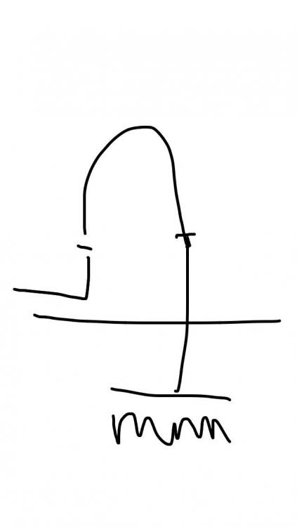

PeterW Posted May 20, 2018 Share Posted May 20, 2018 Isn’t the movement going to cause a problem ..?? There is no vertical rise other than the rise at the fixed point which would then need either the motor at right angles or the motor moving on the frame. I still think a vertical rise with the motor at the top and a threaded bar would be quicker and easier. Link to comment Share on other sites More sharing options...
Onoff Posted May 20, 2018 Author Share Posted May 20, 2018 1 hour ago, PeterW said: Isn’t the movement going to cause a problem ..?? There is no vertical rise other than the rise at the fixed point which would then need either the motor at right angles or the motor moving on the frame. I still think a vertical rise with the motor at the top and a threaded bar would be quicker and easier. Like this? Link to comment Share on other sites More sharing options...
PeterW Posted May 20, 2018 Share Posted May 20, 2018 Yep... quick simple and easy and means the head moves plumb Link to comment Share on other sites More sharing options...
