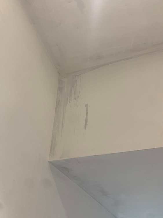

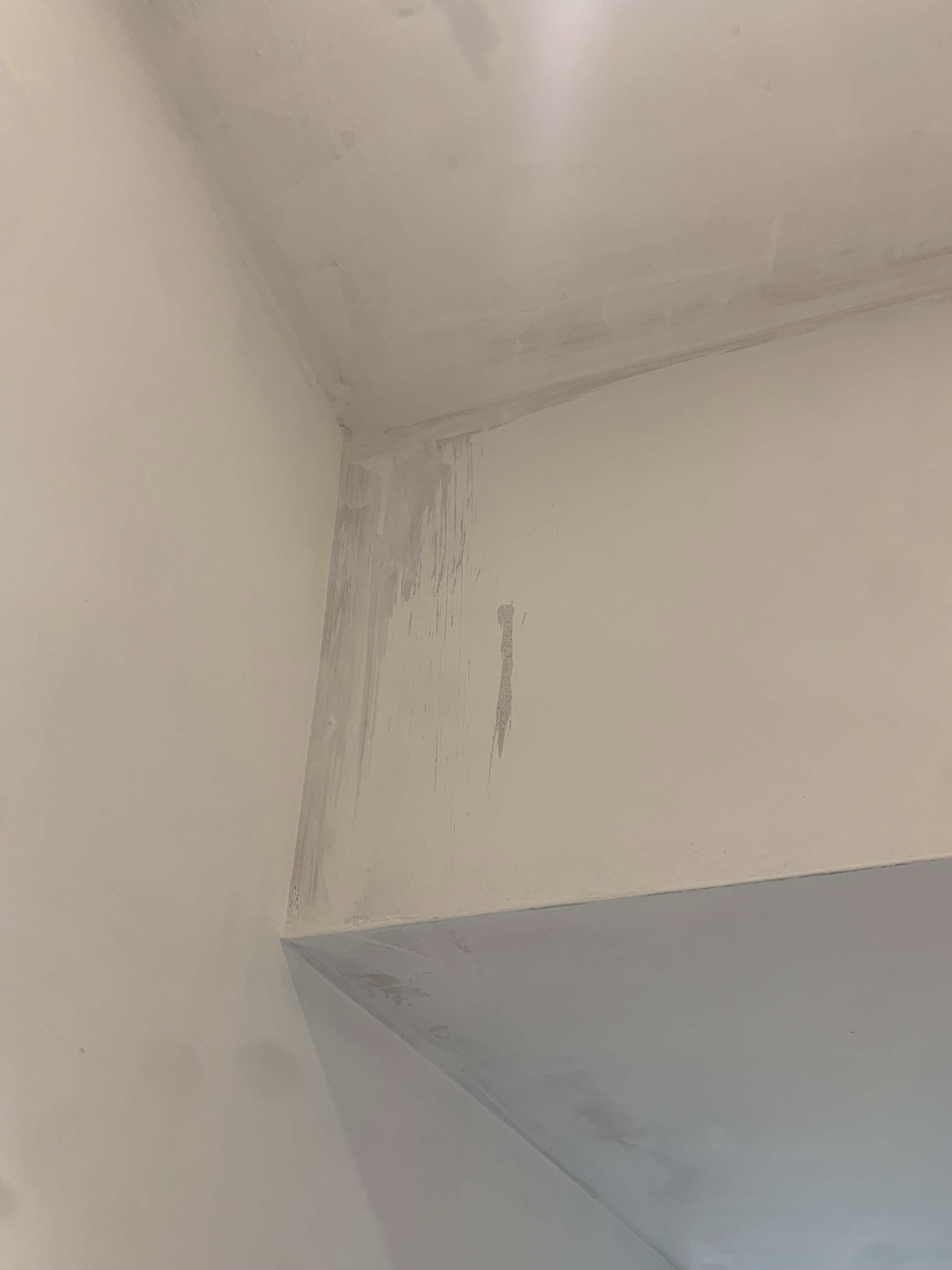

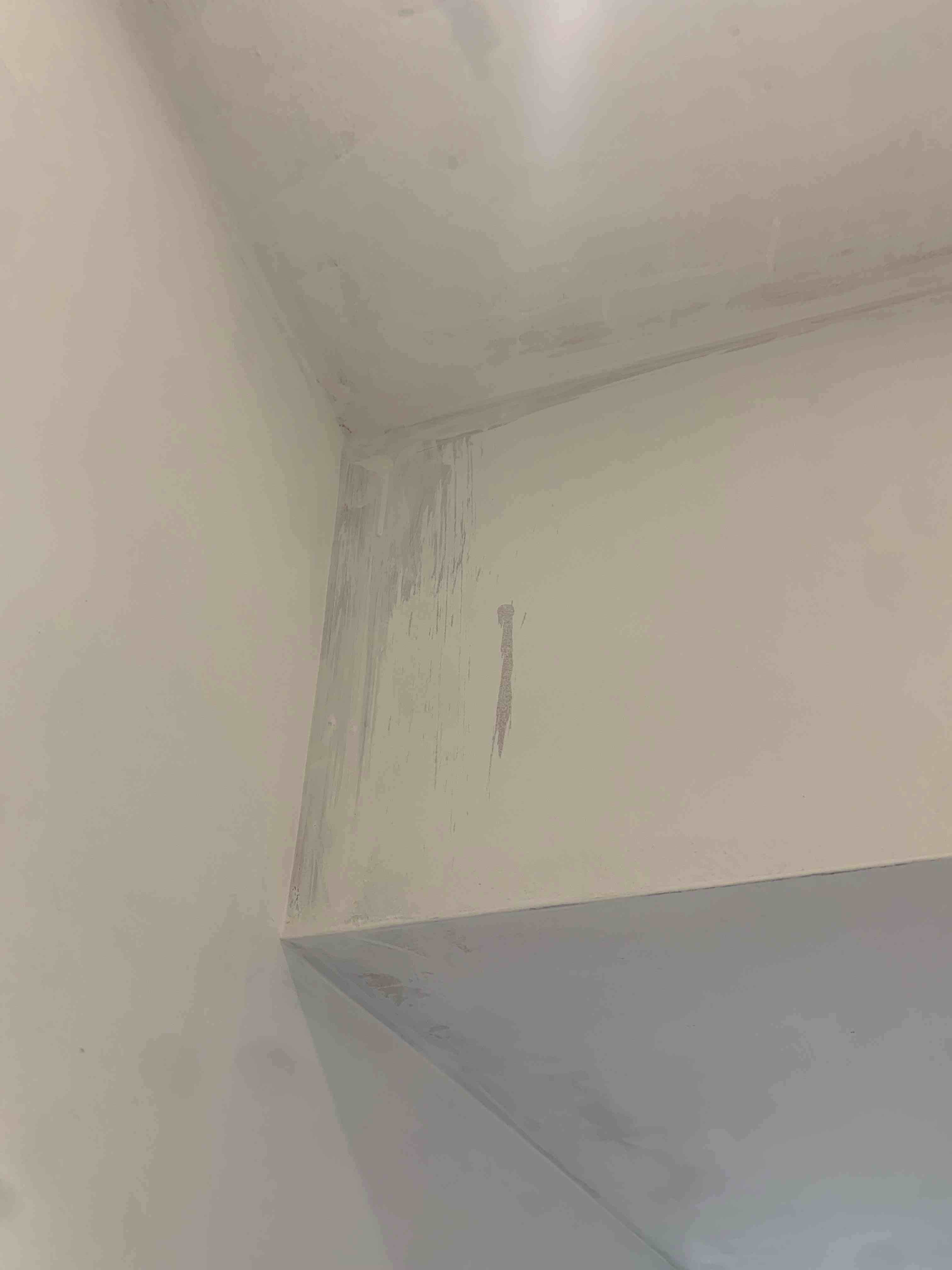

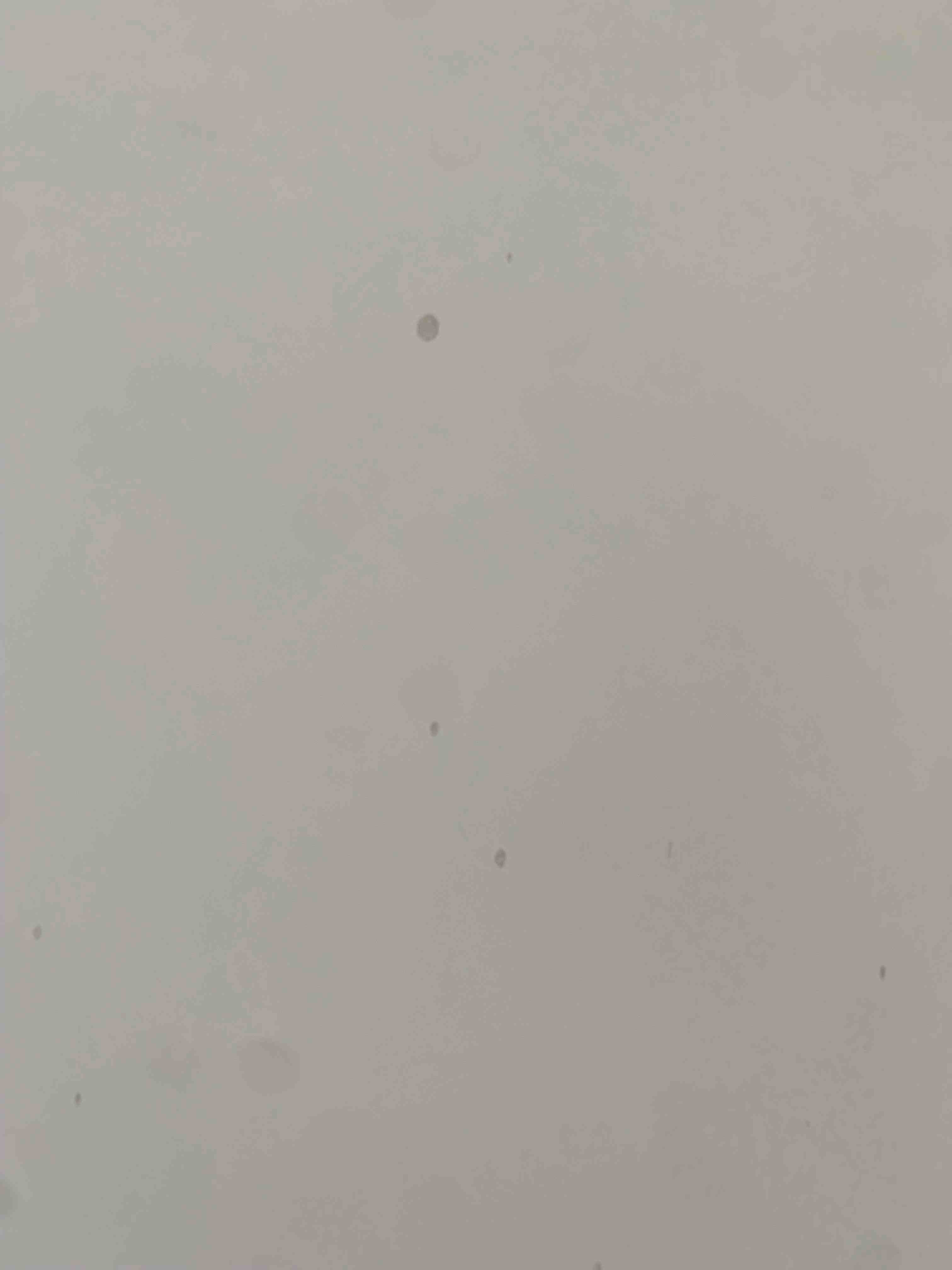

After allowing our new plaster to dry out thoroughly we have mist coated using watered down trade emulsion. One coat watered down to 50/50 then a second coat watered down to 70/30.
Mostly fine but...

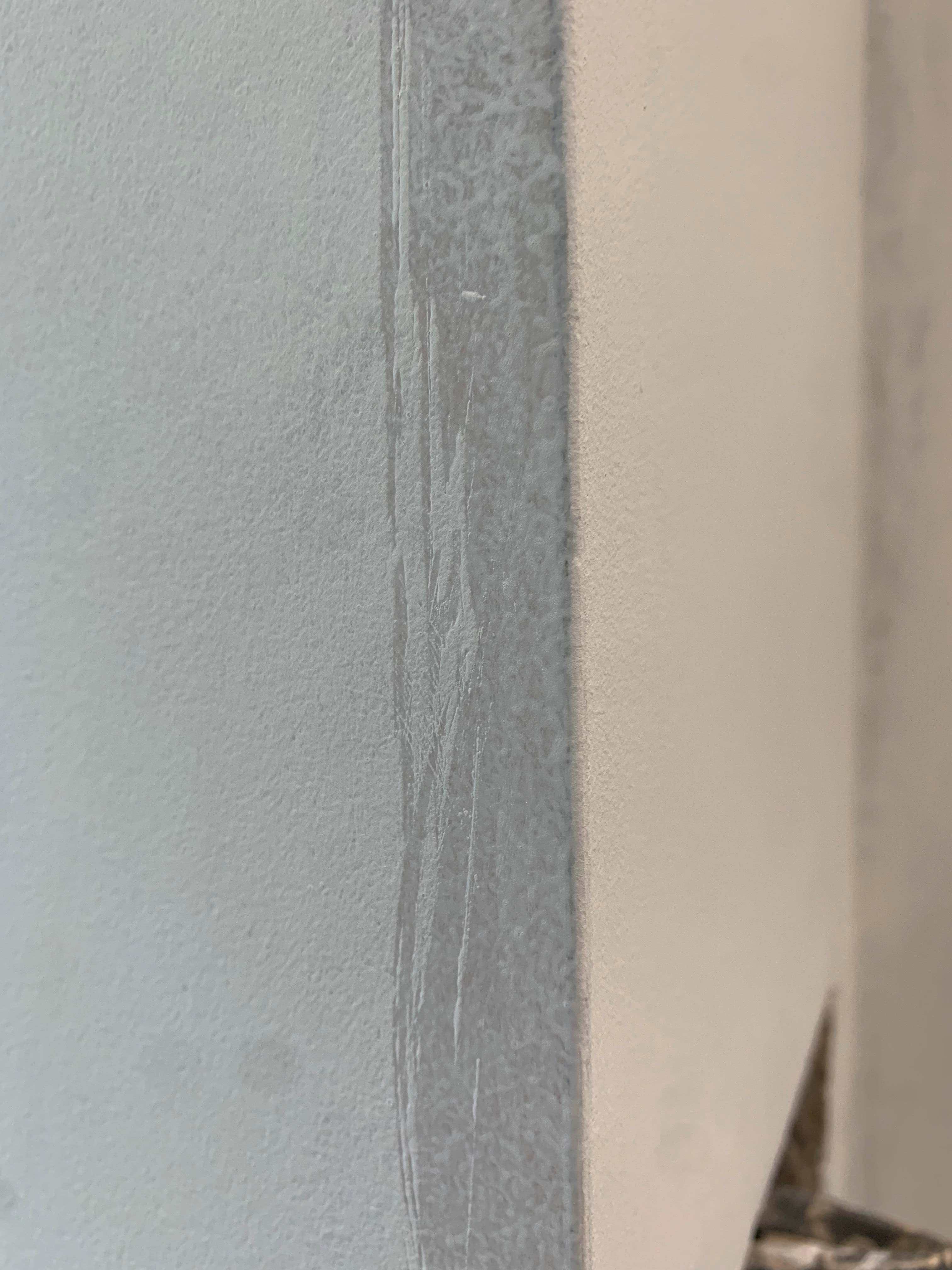

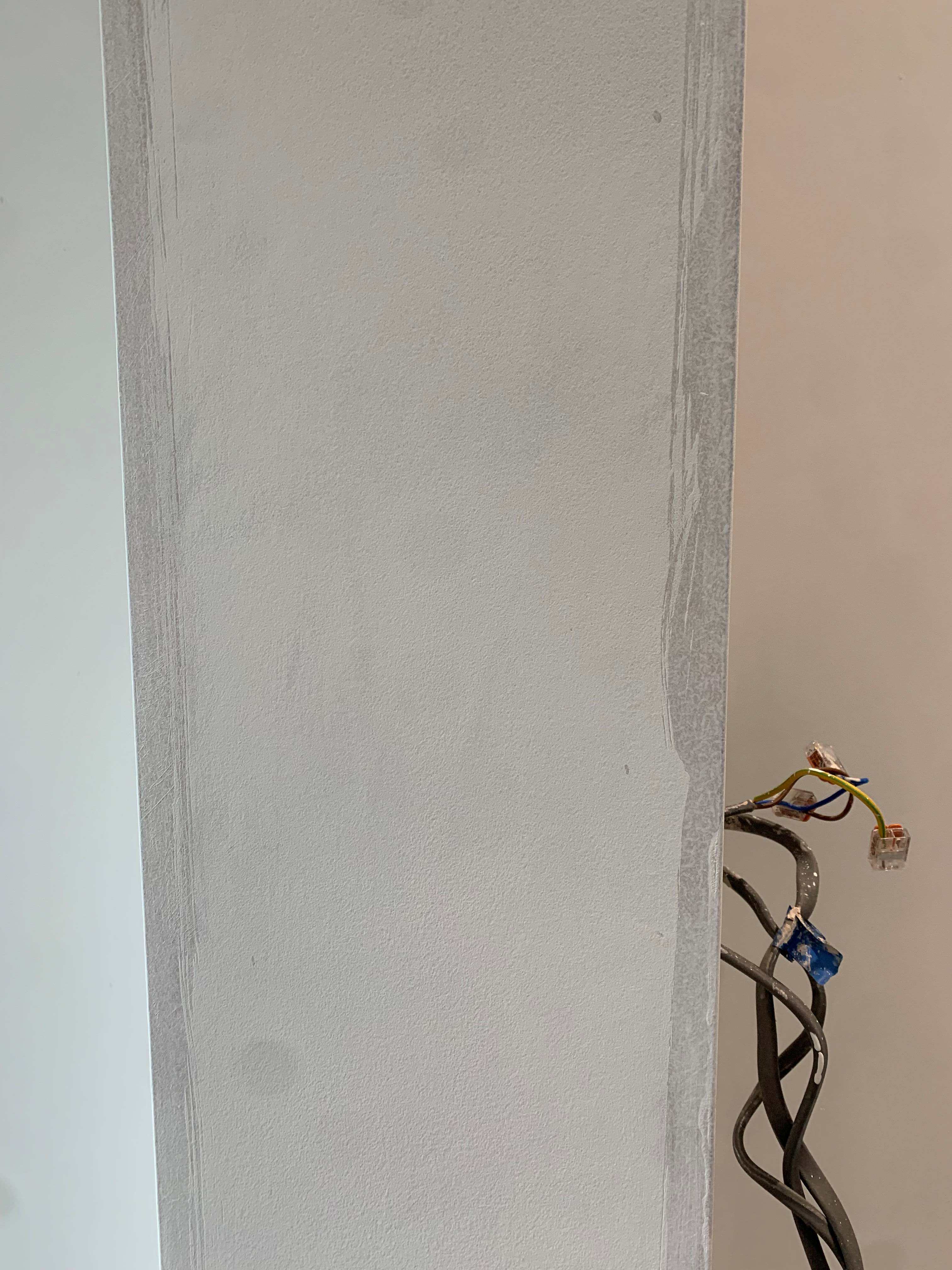

As the photos show we have some areas where very little paint seems to have taken - notably in corners where the roller wouldn't reach and a brush had to be used. I noticed myself when trying to paint these corner areas with a brush (spouse did most of it) that the paint didn't seem to want to stay on the wall, almost as though it was being repelled, trying to brush more on only seemed to brush out remove paint already applied.

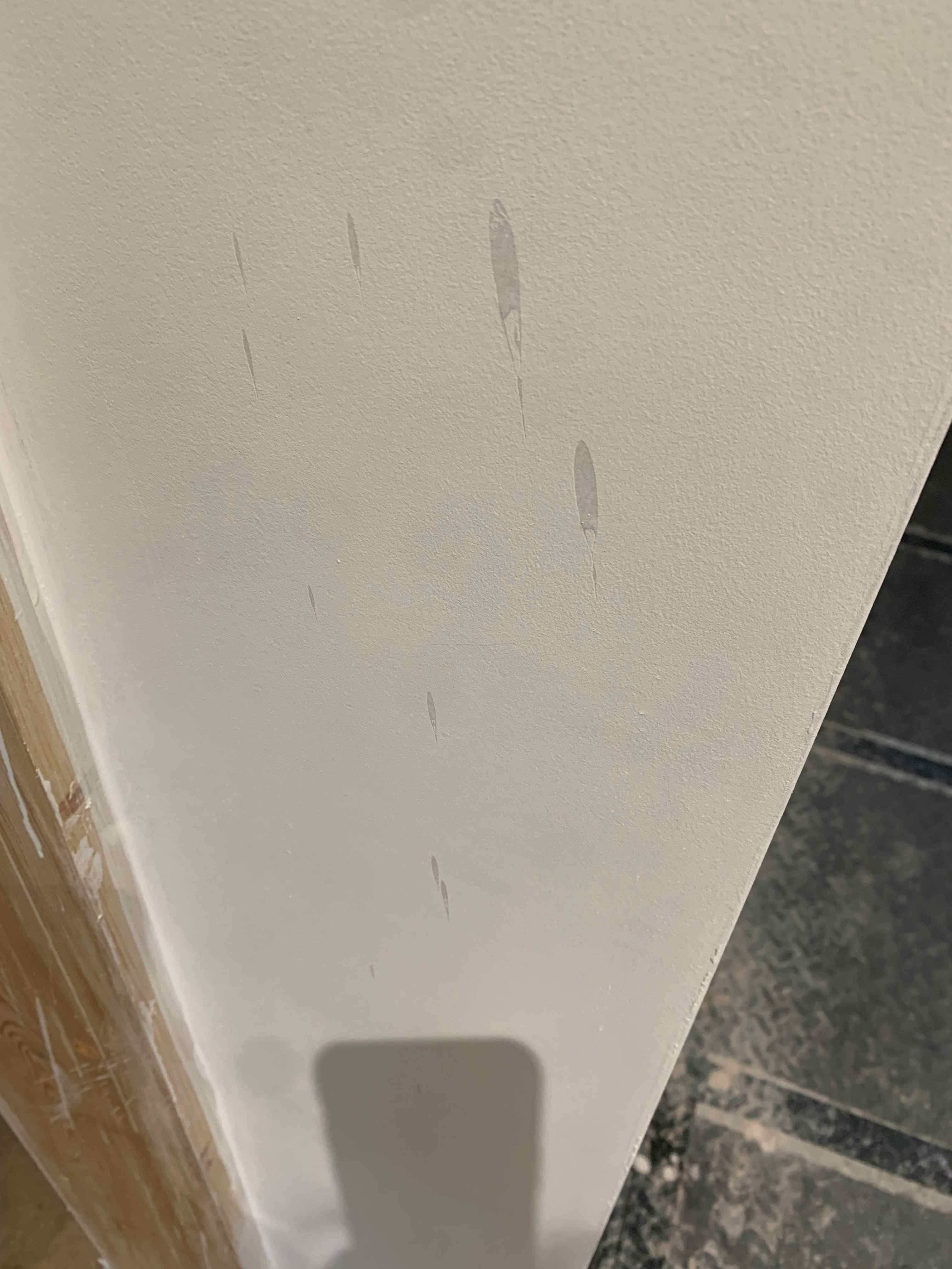

We also have some areas where there are visible splash marks showing - something maybe splashed on the wall when the ceiling was plastered ? PVA ?
What should we do ? Do we need to sand these areas and re-mist ?

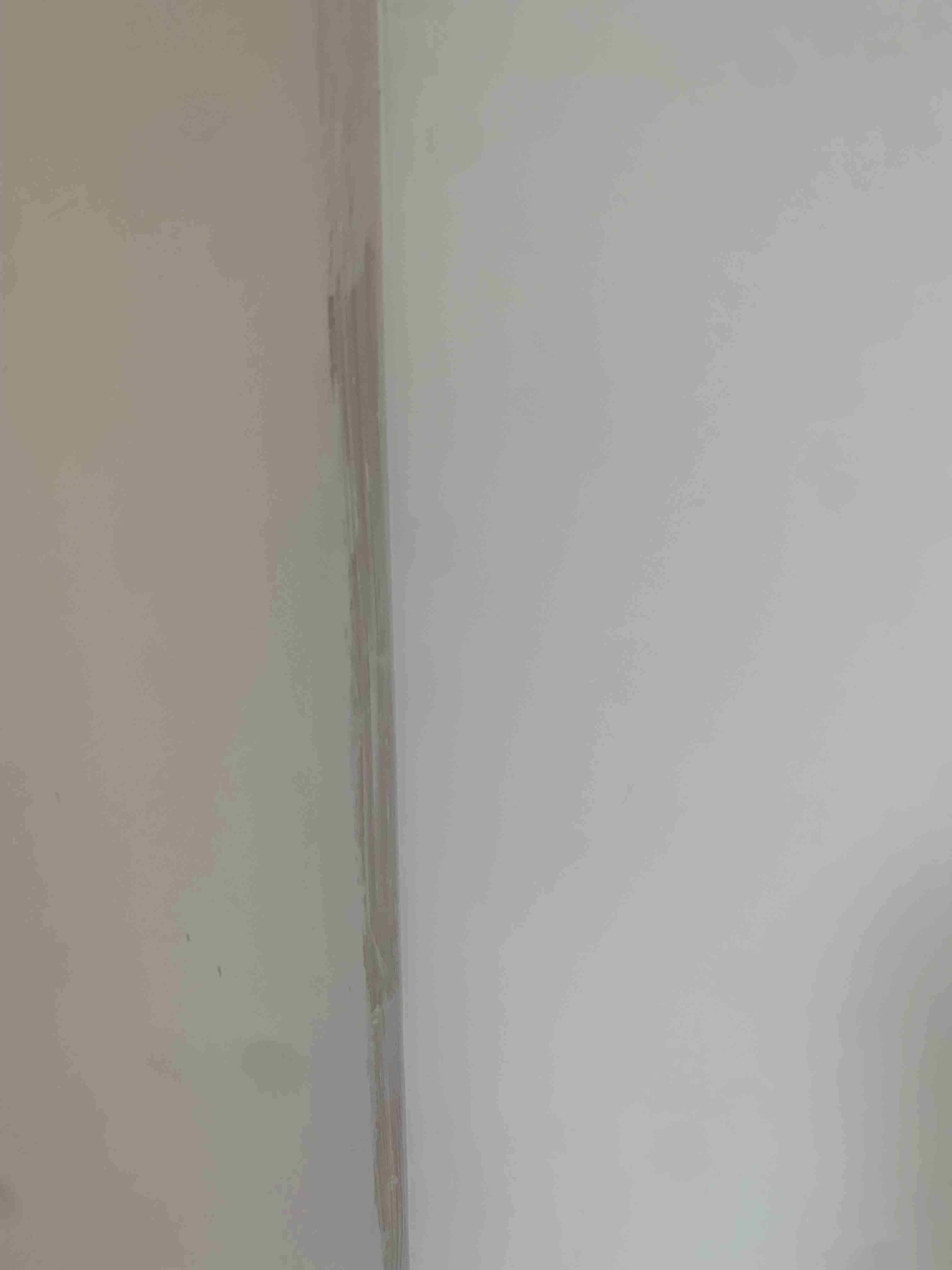

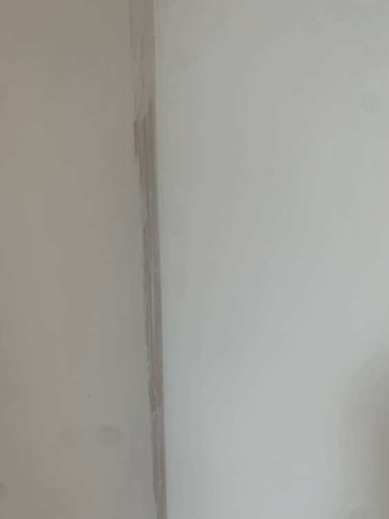

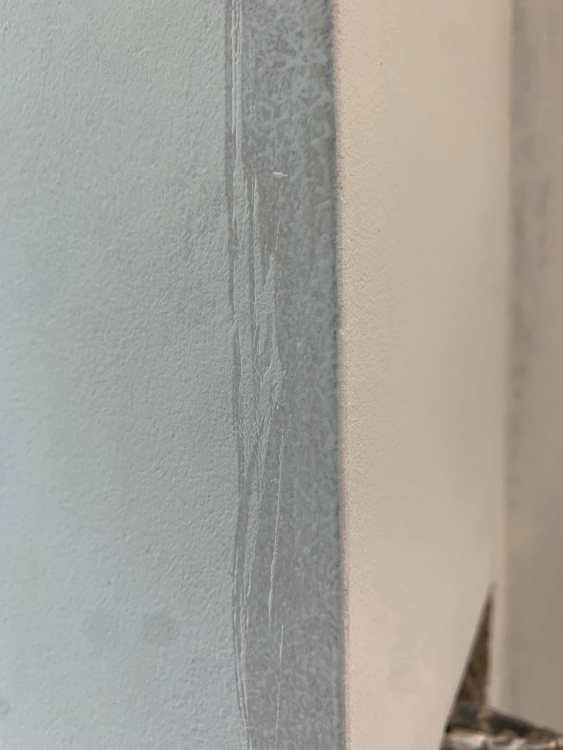

Attach some more photos - seem to have over compressed the earlier ones.

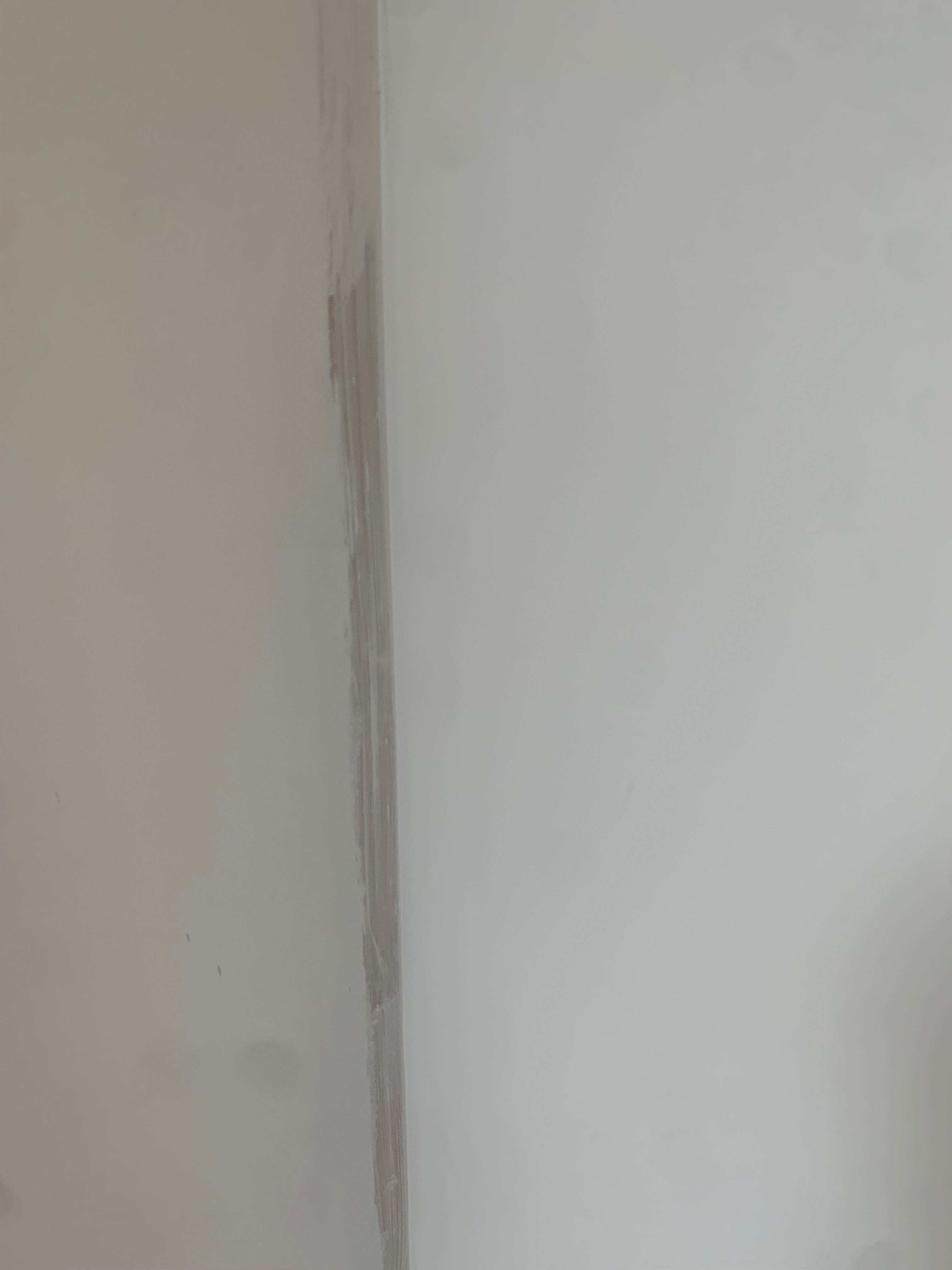

I note on the external corner one side is fine, the other side if affected (see photo). Suggestion is that external corners are affected by which way the plasterboard is running/whether there is a cut end ?
Spoke briefly to plasterer. He said yes he had had this happen before and said it would need to be sanded down gently and re-misted. It was because he sometimes used a bit of PVA in corners and drip marks also likely PVA from doing the ceiling second rather than first.
