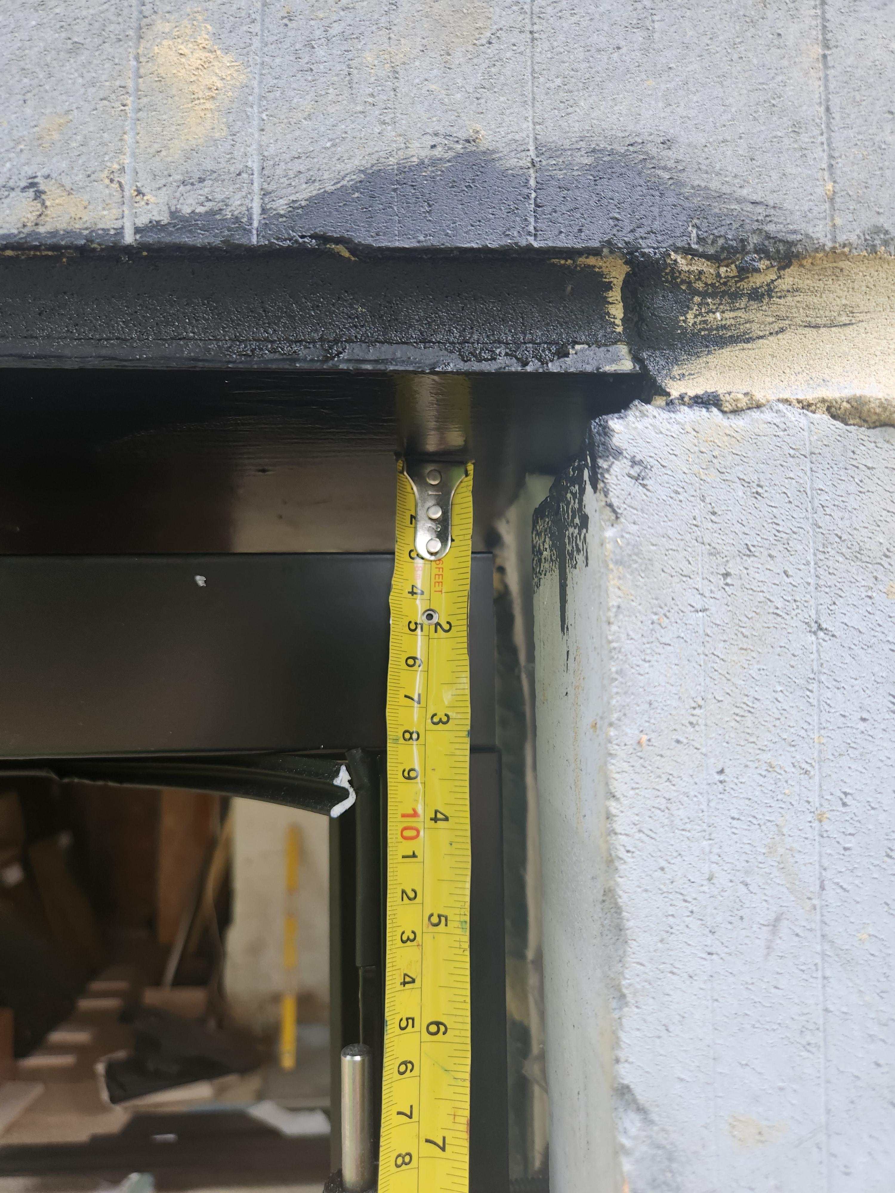

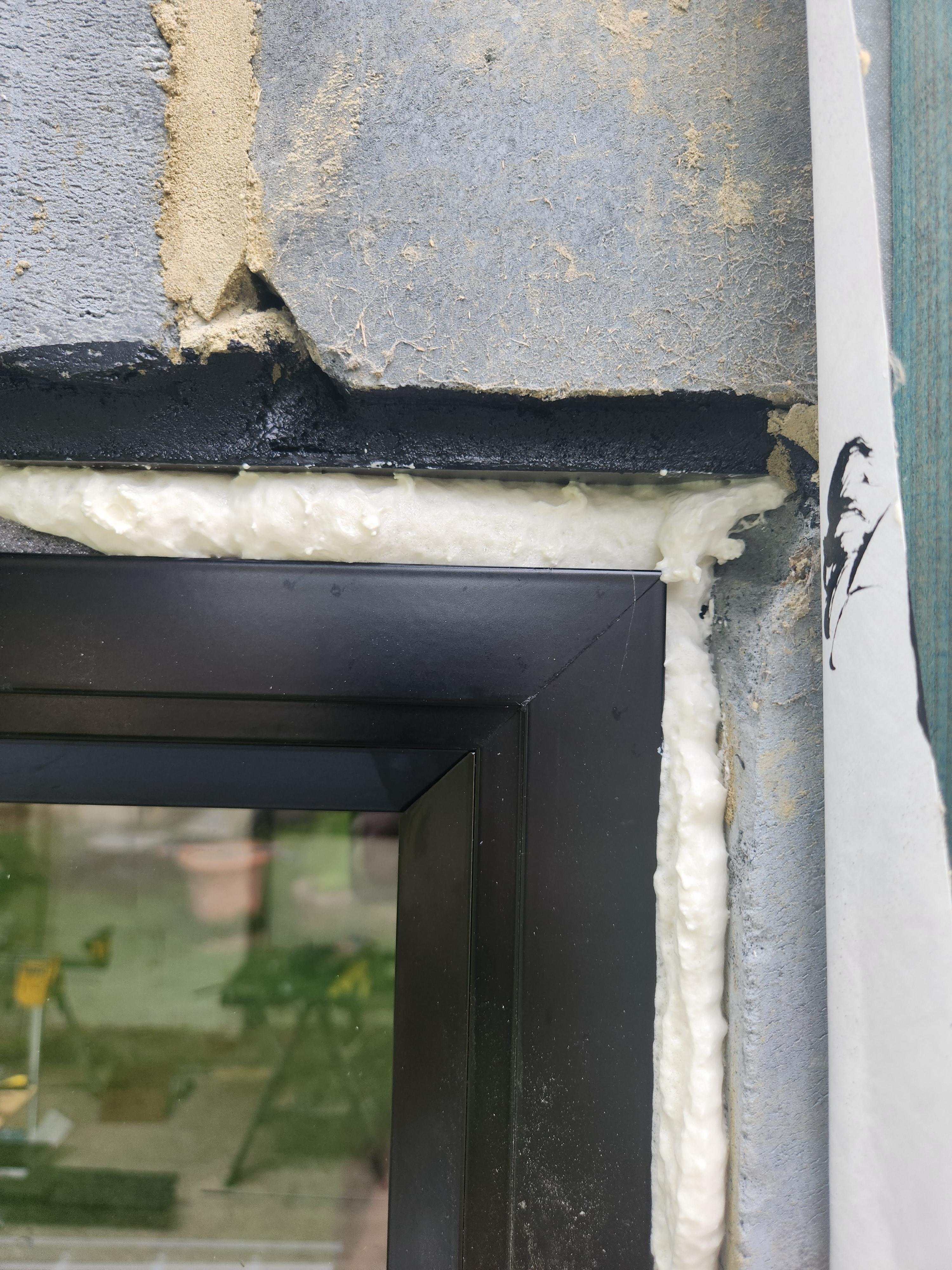

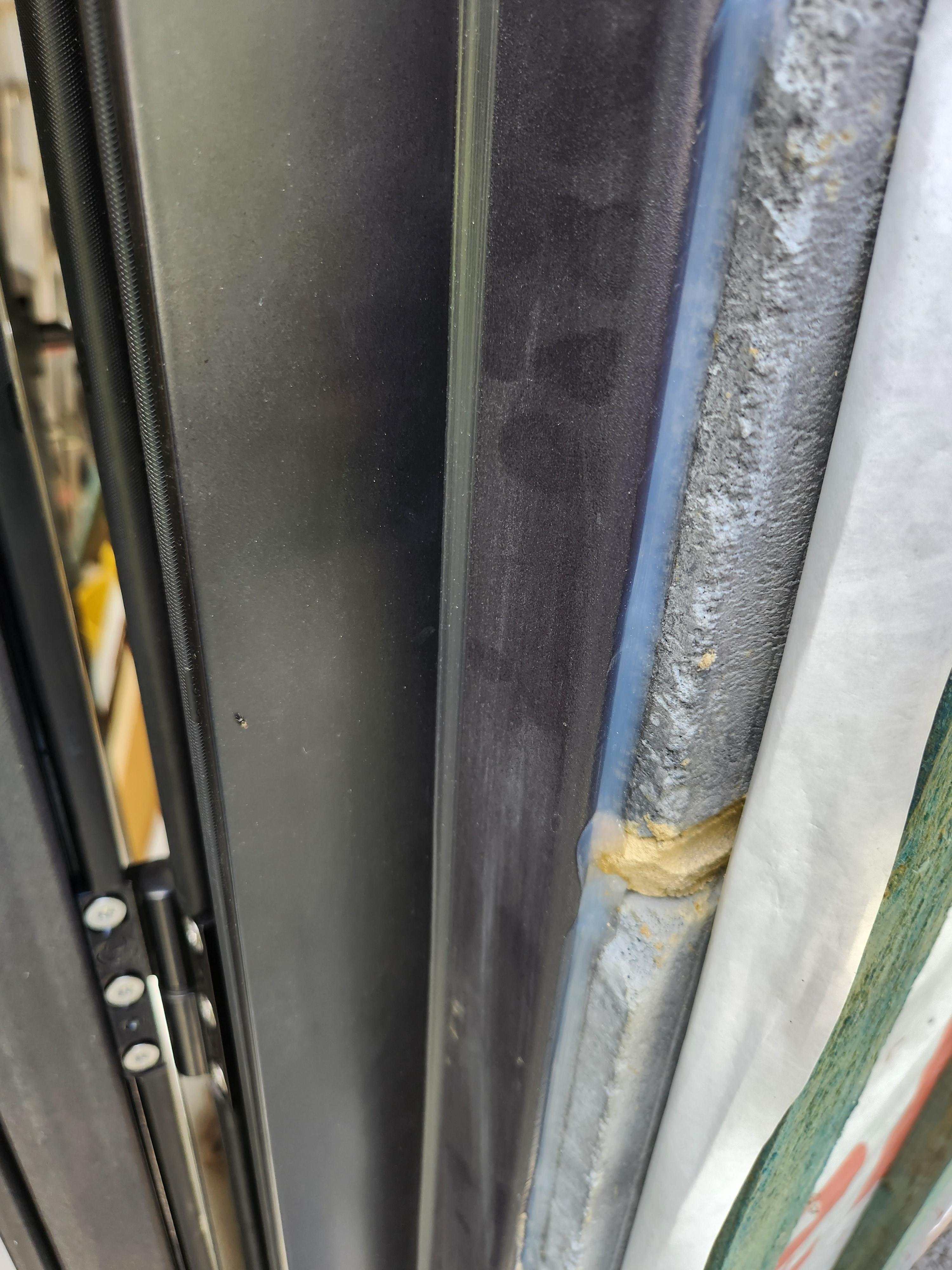

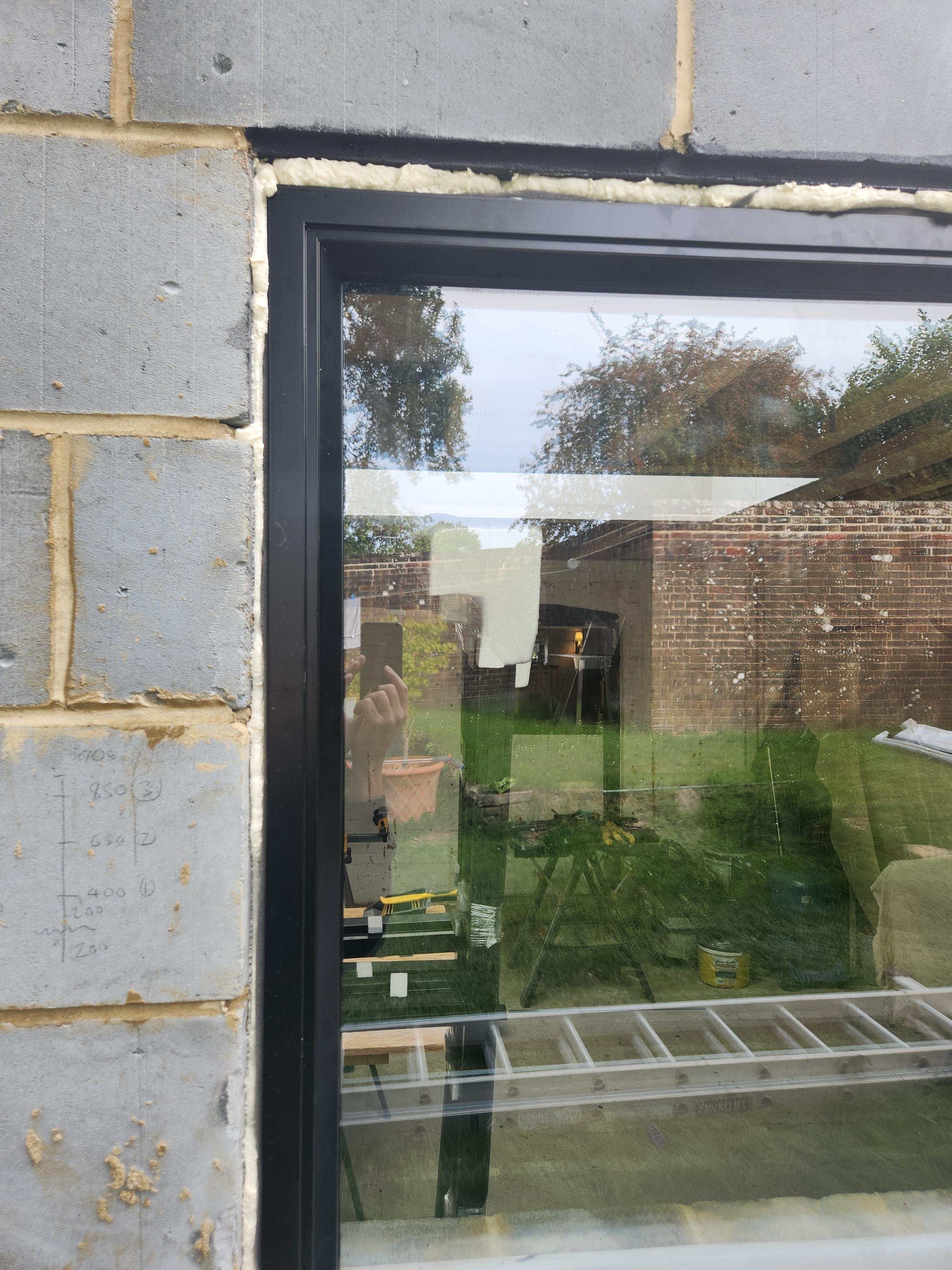

So they agreed to provide a better finish for everything which they have now done (pics below).

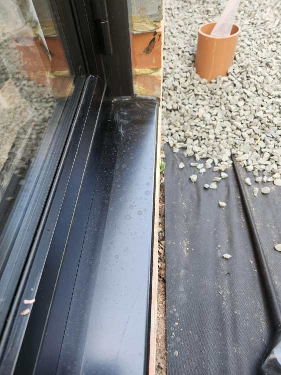

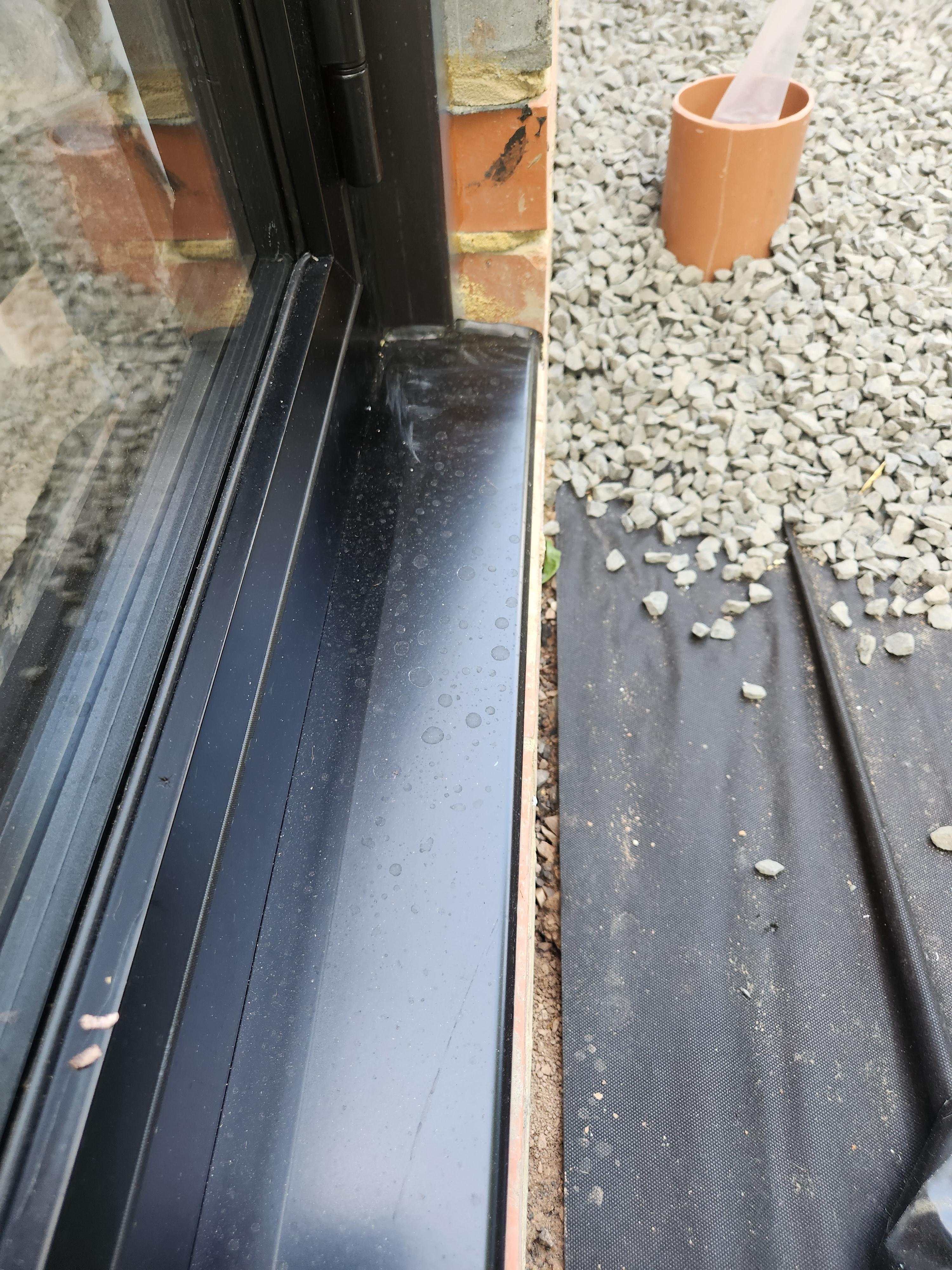

However, -- and I didn't realise they had changed it until the last day of fitting -- because my retaining wall is in the way of the doors opening at the original position they moved the whole frame and cill further back into the aperture. The result of this is that the cill and drainage slot no longer projects beyond the outer leaf.
From what I am told the only water that will exit through this cill drip is what gets inside the frame through the gaskets which should be very little. I am planning a weathered threshold so the entire cill will be completely covered anyway with an aco slot drain. That said I was still expecting the drainage from the cill to have to go beyond the wall.
The company have told they really don't think its an issue, that the frame is sealed and there is a dpm on the inside. I am not sure that is really the point, I don't think I want any water getting in at all if it can be helped. It just feels like building in a flaw. The BI had no interest whatsoever and I am struggling to find something to push back at them to say it has to be done or not.  They had a surveyor come out to measure so I would argue this is on them and they should have proposed a wider cill or more smaller doors.
If anyone has a view on why this is or isn't acceptable I would appreciate it.
Thanks, Paul
I think it’s a zero issue tbh. What water, if any amount, that gets in there will just drop into the cavity and find its way south.
Good to see they came to put this right, as some just won’t.
