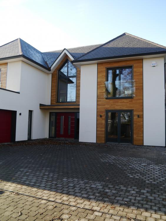

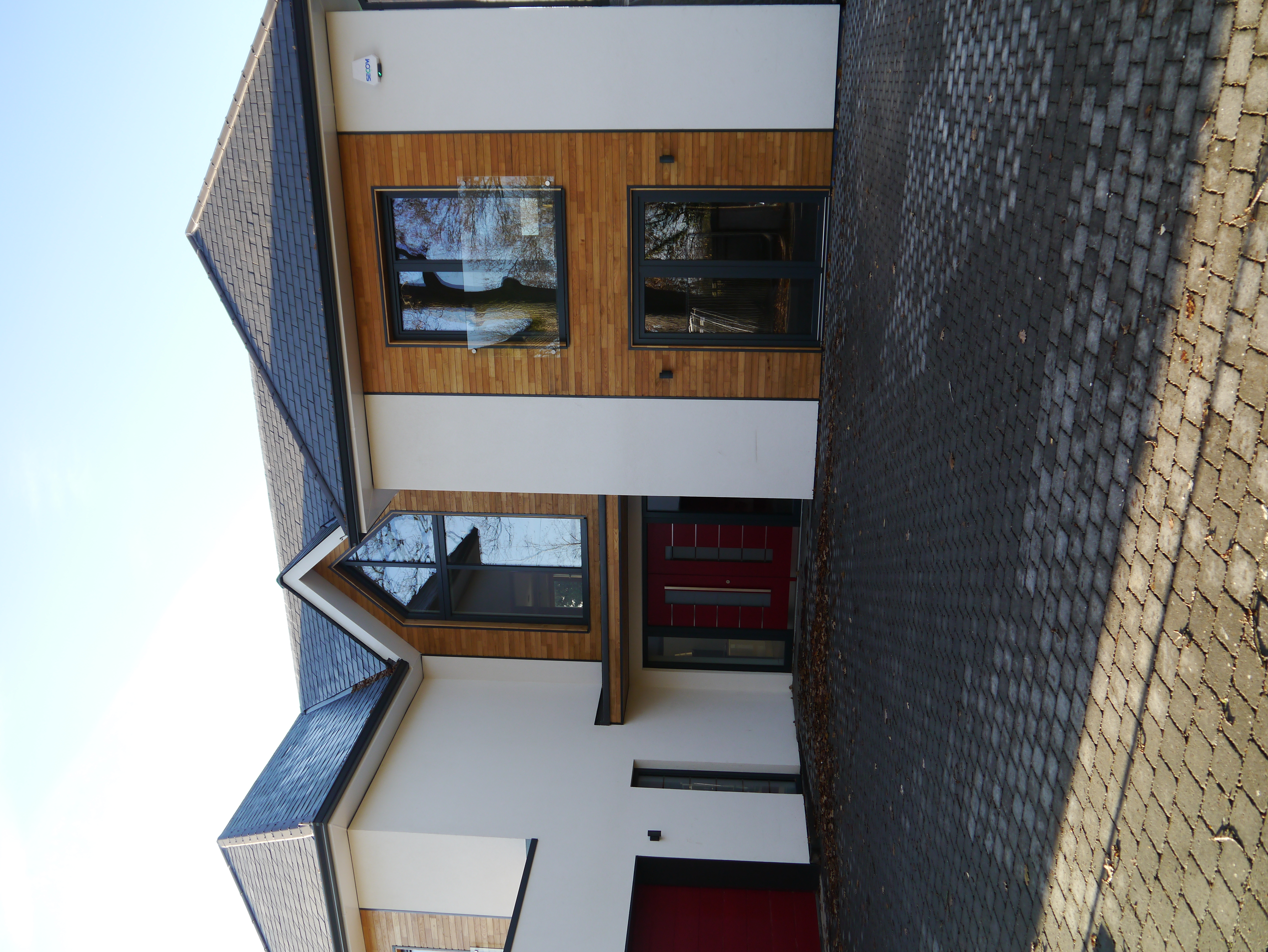

HerbJ Posted January 3, 2018 Posted January 3, 2018 (edited) We have been very happy with the windows and doors to date. We had a couple of issues on supply which were resolved and the installation was completed efficiently. They are very high quality windows and were relatively expensive. That said, they were priced competitively against all the main competitors and we completed a full commercial and technical evaluation, including flying to Scotland to look at an installation of similar specification by Gaulhofer, before we finalised the contract. We had real problems geting interest from some company's to quote We finalised the contract in May 2015 at 1.4 euros to £ . @bitpipe also installed Gaulhofer windows in his new build house. The UK Agents are ECOWIN Edited January 3, 2018 by HerbJ 1
