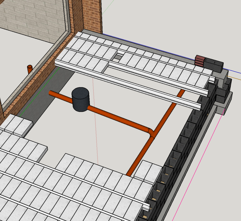

building extension over existing access chamber sitting just outside kitchen window
In digging out for block and beam for new extension to kitchen just found an 30cm wide ish chamber hidden under the existing paving. It's not on the public sewer.
Could I add a rodding point to the incoming 110mm piper under the kitchen sink or do I have to install a new rodding point from outside the new extension ?

A diagram with some idea of layout etc would really help folk to comment further. Just pen and paper is fine.

this is as is :
so could simply remove chamber (black cylinder) and add double sealed inspection hole under kitchen sink
or
remove chamber and replace with the below - of course with a rodding eye fitted on the external end of the pipe. All 200mm radius bends

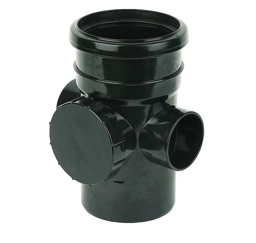

How about remove chamber and link straight through.
Fit rodding point riser in kitchen. There is another kind with a screwed on cap on the side.
If you go to a merchant (ie not TS/SF) you can handle them.
Splendid - spoke to BCO and Rodding point riser in the kitchen is the way to go - thanks all for your input. Onwards to the next obstruction.
