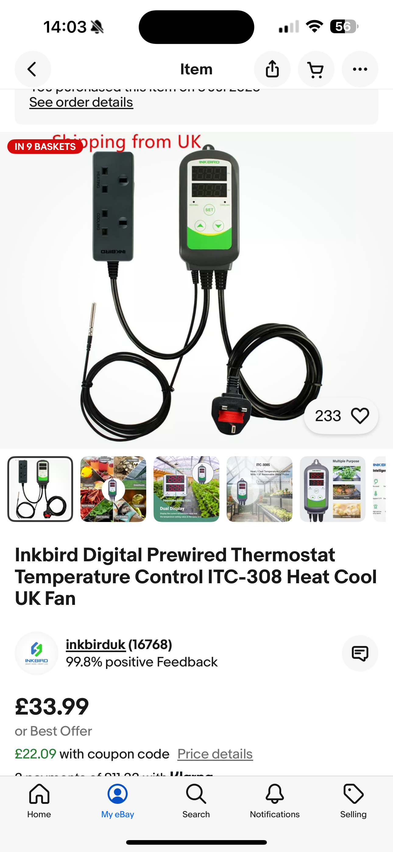

Pocster Posted July 12, 2025 Posted July 12, 2025 A few weeks ago I noticed my IT cupboard getting rather warm . So logically thought I’d be installing a fan in there and maybe a Shelly and zigbee temp sensor . Not a fan of Shelly based on my experience. Anyway link it all up to HA , easy !! Then I can across this - which I got on eBay for £17 . Chatgpt suggested this device which I’ve not heard of before ; inkbird ( funny name for a temp control unit ) It’s awesome ! . Dual plug outlets so one for a heating device and one for cooling . Temp sensor on a long flex . I think my expectation was “ typical Chinese shite “ - but it’s a cheaper solution not relying on HA . I use to trigger my fan 1

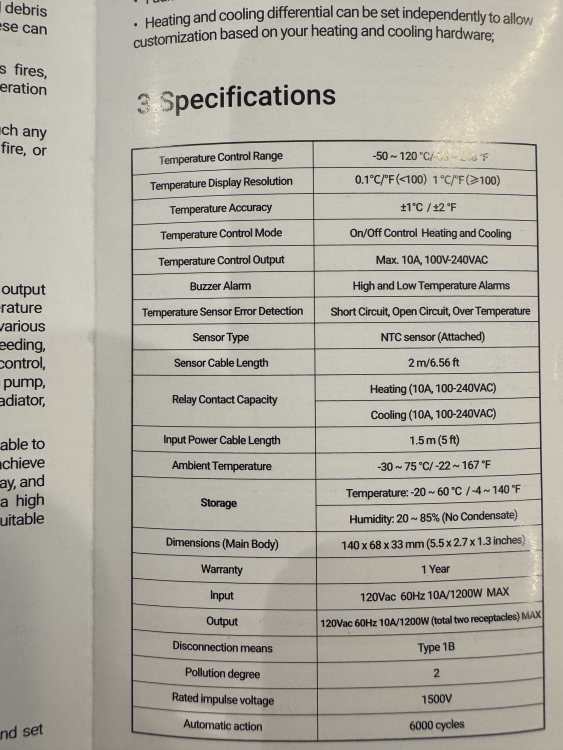

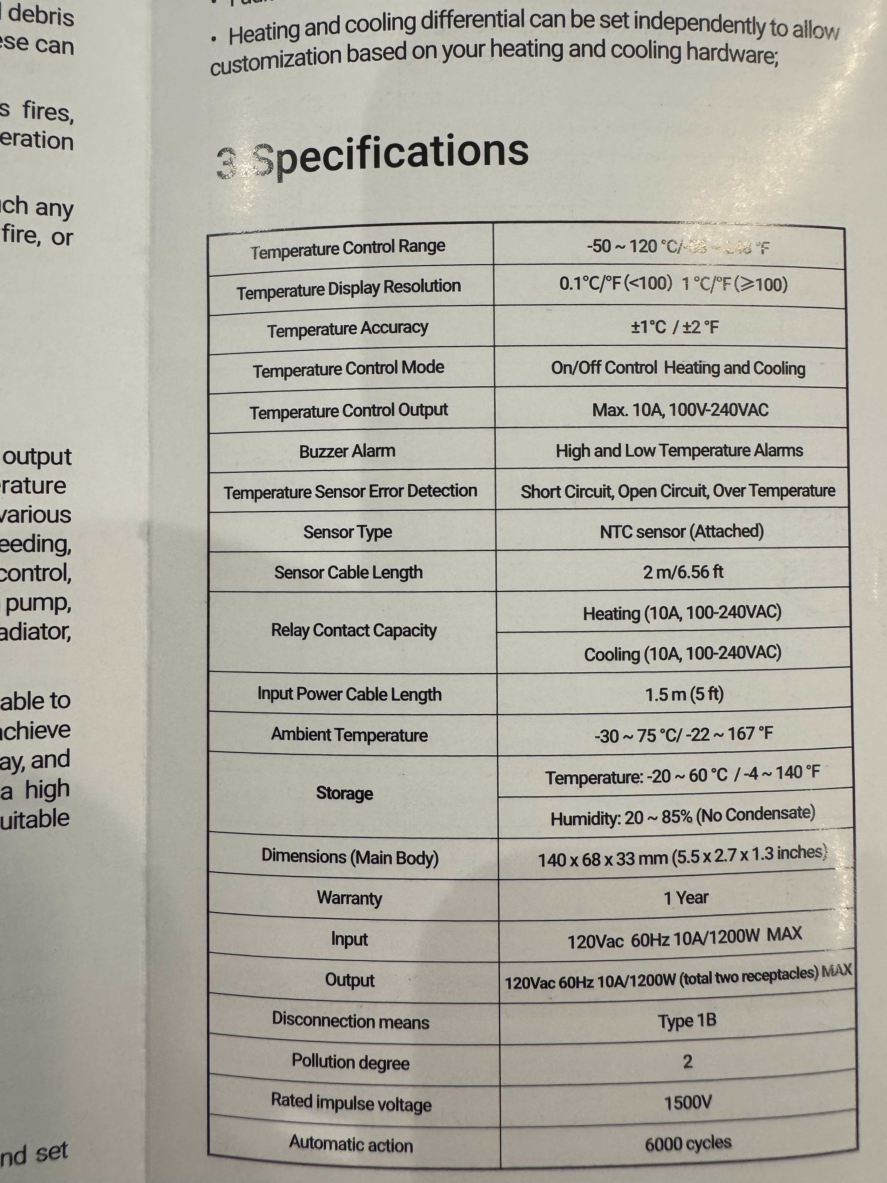

SteamyTea Posted July 12, 2025 Posted July 12, 2025 What load can each individual outlet take? Is the total constant load 10A?

Pocster Posted July 12, 2025 Author Posted July 12, 2025 31 minutes ago, SteamyTea said: What load can each individual outlet take? Is the total constant load 10A? 10A per plug I.e 10A for heating and 10A for cooling

SteamyTea Posted July 12, 2025 Posted July 12, 2025 (edited) 2 minutes ago, Pocster said: 10A per plug I.e 10A for heating and 10A for cooling I don't think so. But give it a go to prove me wrong. Or is it as case of one or the other but never bothered together. Edited July 12, 2025 by SteamyTea

SteamyTea Posted July 12, 2025 Posted July 12, 2025 27 minutes ago, Pocster said: What kind of bollock answer is that Says total output 1200W MAX. Bur it also says things for the USA market.
