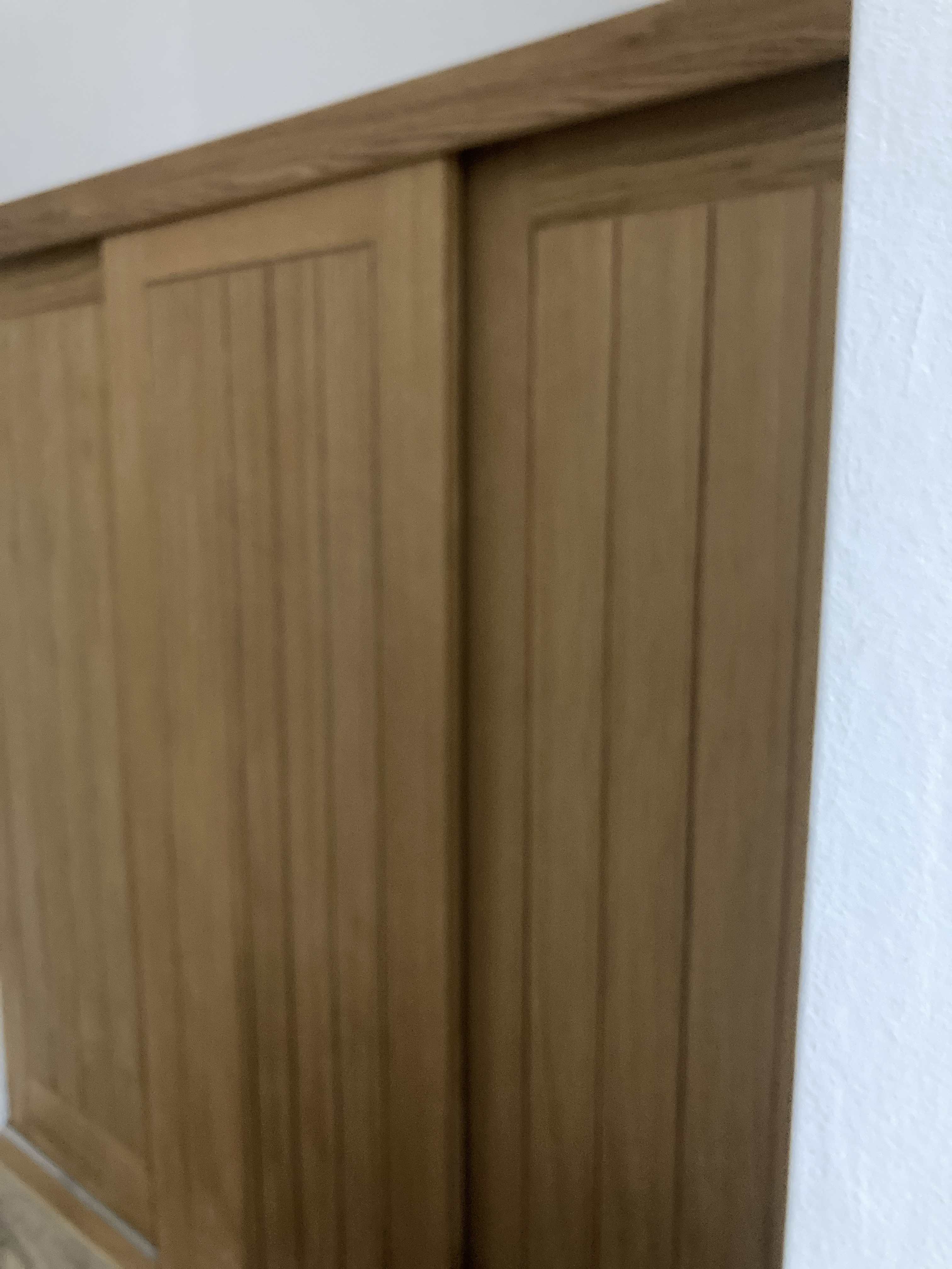

MoDo Posted October 12, 2025 Posted October 12, 2025 On 08/07/2025 at 16:25, nod said: ...I’d built 6 fitted wardrobes also Same again there Photos showing them fixed in place Were these the basic, single shelf in the middle affairs? Having looked into this recently I had decided the only wardrobes for which VAT could be reclaimed were more or less pointless. Ie bare plaster behind, (the rules mention wall must be visible behind), must be a single shelf and or rail (multiple shelves disqualify it) and it has to be between two walls so an end panel would also disqualify it. At that point, I figured that unless the house had been designed with the express intention of forming wardrobes like these then no VAT claim would be possible. Have I got this wrong?!
nod Posted October 13, 2025 Author Posted October 13, 2025 6 hours ago, MoDo said: Were these the basic, single shelf in the middle affairs? Having looked into this recently I had decided the only wardrobes for which VAT could be reclaimed were more or less pointless. Ie bare plaster behind, (the rules mention wall must be visible behind), must be a single shelf and or rail (multiple shelves disqualify it) and it has to be between two walls so an end panel would also disqualify it. At that point, I figured that unless the house had been designed with the express intention of forming wardrobes like these then no VAT claim would be possible. Have I got this wrong?! 1

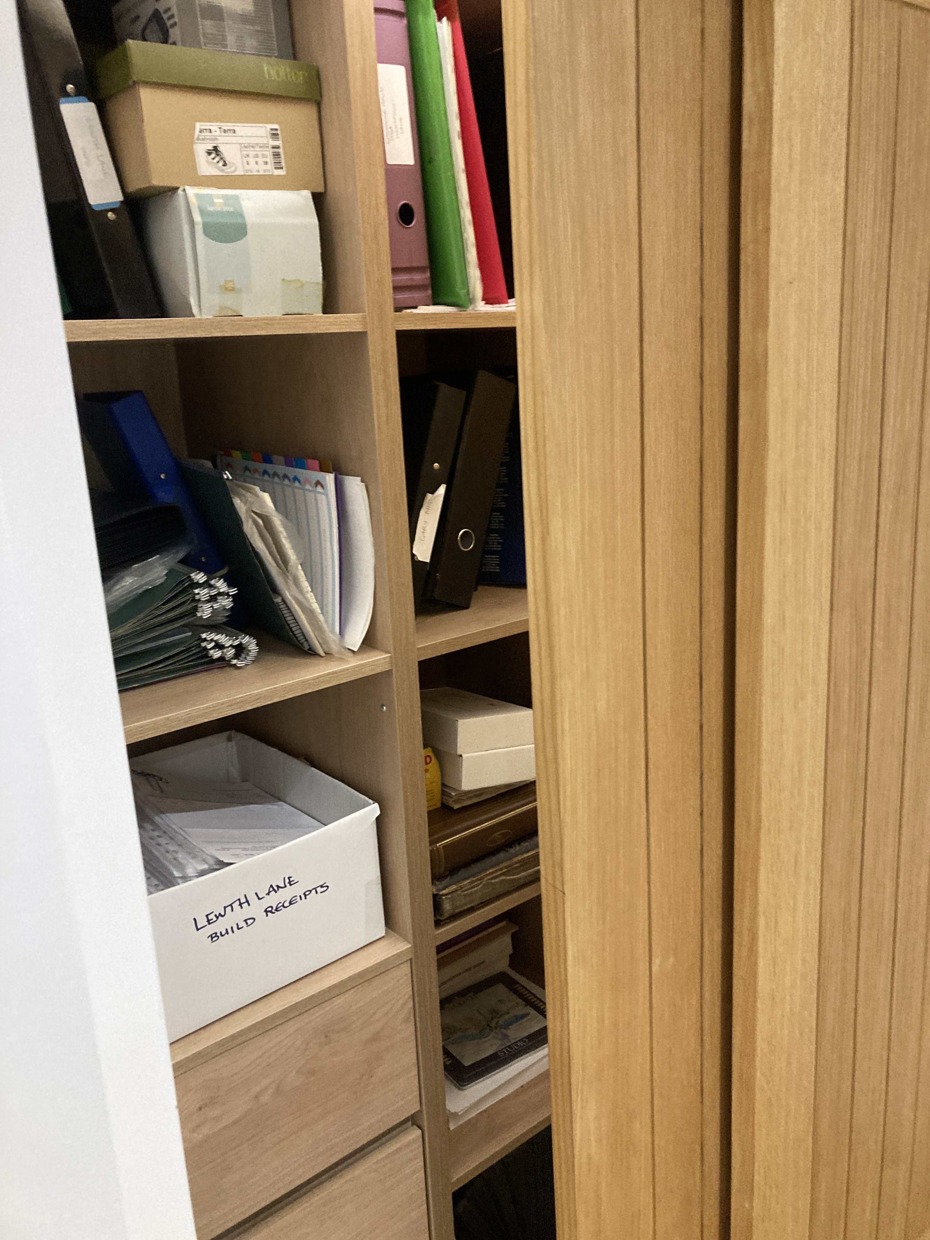

nod Posted October 13, 2025 Author Posted October 13, 2025 Just now, nod said: Pretty much all like this The one in our office shelves a drawers Bedrooms shelves and rail kits 1
Tony L Posted October 13, 2025 Posted October 13, 2025 Thanks for explaining your VAT reclaim, @nod. It's good to know they don't enforce the silly wardrobe rule, although a different inspector may have taken a different view.
nod Posted October 13, 2025 Author Posted October 13, 2025 53 minutes ago, Tony L said: Thanks for explaining your VAT reclaim, @nod. It's good to know they don't enforce the silly wardrobe rule, although a different inspector may have taken a different view. Our previous build showed them marked on the drawings Our recent build didn’t have any wardrobes shown and they still didn’t bother

nod Posted October 16, 2025 Author Posted October 16, 2025 I built them out of plasterboard and skimmed and bought the doors to match the rest of the house from Howdens The inserts are from Amazon
MoDo Posted October 16, 2025 Posted October 16, 2025 Thanks, that method probably helped your VAT claim too as individual components are easier to claim for as opposed to something HMRC might class as "furniture" which could be disallowed. Pretty sure doors of any sort are fine to claim for for example.
