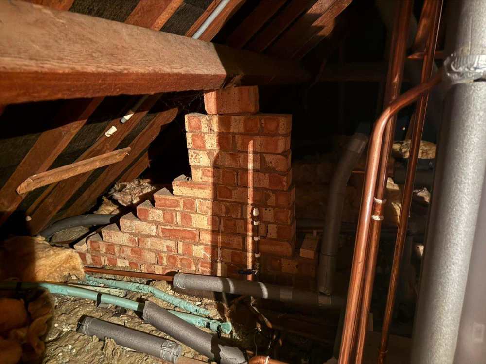

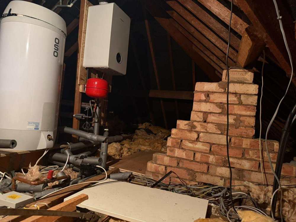

So the SE came and was rather interesting chat.
waiting for them to confirm but their initial thoughts were.
1. They think the ceiling down and the joists that are deflected need cutting out as they are done with and will never have a flat roof again without.
2. if you are doing that then they thought the new frame should go from internal wall to internal wall and ignore the wall plate as opposite the wall plate is only the timber with the joist hanger and the spans is large for it to sit on was initial impression.
The existing joists can then connect back in to the new frame which will support the ceiling.
not explained very well but will share the drawing when I get it.
I think Oso were thinking something to be knocked up quick, but with a ceiling down and new frame, joists being cut and connected to rectify the issues is what it is.

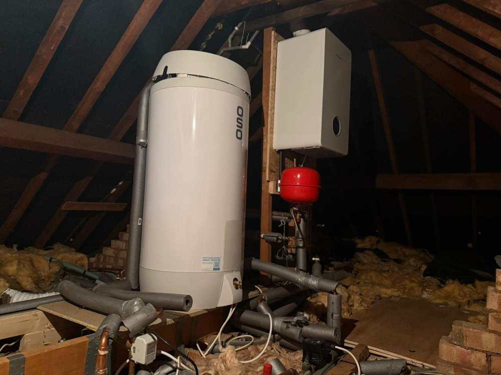

I also have to say your boiler shouldn't be up there and it should have been installed with proper loft boards across the access area as a minimum to allow for safe servicing and maintenance.
The sad thing about these sorts of things is my sister had an issue with a window company who dragged their feet as much as they could and it took 6 years and a court appearance (and the company didn't even turn up) to get the situation resolved. It wasn't just the company but also their lawyers that were scumbags.
I've been burned before and it's a horrible experience - you have my sympathies.
Hope you have legal insurance or some access to legal advice?
Boiler is fine up there, as long as all pipework lagged and a frost stat is installed (or OEM).
It’s better inside the heated envelope, all of this is, but if you want/need space and are happy to compromise then “up it goes”. ;)
A fixed ladder, fixed flooring and lighting is required for access and maintenance etc.
I disagree with you there Nick. Gas Safe updated its technical requirments back in 2024 and they read as follows:
Access and lighting
The homeowner should provide measures as a minimum for their own safety and so that gas engineers can work in a safe environment. There should be a permanent means of safe access to the appliance. For example, this could be a permanently fixed retractable ladder to enter and exit the loft, with a safety guard around the loft access, which should be secured to the building’s fabric. The strength and design of the ladder should be such as to maintain safety. There should also be adequate fixed lighting.
The flooring area from the loft access to the boiler should be sufficient to allow access for normal use, servicing and maintenance, and should be extended to under and around the boiler. Consideration shall be given to a guard in order to prevent contact between stored articles and the boiler, its flue and pipework.
If the floor is of combustible material and supports the boiler, a non-combustible insulating base at least 12mm thick should be directly under the boiler.
The chosen location in the loft/roof space must be able to support the boiler’s weight once filled with water.
https://registeredgasengineer.co.uk/technical/boilers-in-loft-spaces/
If a customer asked me to service or repair that boiler, I wouldn't go up there. It's a completely unsafe working space. Now, I've worked on boilers in pretty awkward lofts, taken a few and out & replaced one or two in the space, so I don't always insist on all the safety guards etc. but I do insist on proper boarding so I don't have to balance on joist or loose boards randomly chuck on the floor.

The last installation I did in a loft was actually to put in a UVC a few months ago and I spent 2.5 days building a completely new raised platform to 1, allow for very thick insulation upgrade over the existing joists, and 2, provide a proper solid, wide and safe access to the new cylinder from the loft hatch, 3, properly distribute the new loads across a wide area of the existing joists - the first part of the platform next to where the cylinder was to sit was anchored to the wall with a wall plate too. The platform was built with osb floor panels and with an additional layer of plywood under the cylinder. Then it had proper lighting and all wiring and plumbing was completely out of the way to remove any trip hazards and all fully lagged. I thought I had a photo but can't seem to find it unfortunately.
I tend to avoid loft installations like the plague but if there's absolutely no other choice then it's got to be properly boarded with safe access and I quote for this work or they can have someone else do it - otherwise I'm off tbh.
The last boiler installation job I did involving a loft was to take a bloody combi out of the loft and reinstate a system boiler and UVC so the customers could have proper showers for the first time in 8 years having previously been conned into how good combi would be - especially when it sprang a leak in the hot water heat exchanger and flooded the house over 3 floors.
3 hours ago, SimonD said:
That's what I said too. And if that's not there, the boiler shouldn't be up there - it's not safe, so it's not fine to be there. And regardless of this, I think it's poor practise to put boilers in the loft full stop.
Would you have installed it like that and would you work on it like that? I'll bet you a pint or two you wouldn't...😜
Never bet beer, because if you do, in 25 minutes time, you’ll have a string of pics of me, laying on my back, changing the diverter valve by touch alone.
And yes. We’re saying the same thing. I am a fan of putting all that stuff up in the attic though, if it means life can become more practical below it.
Not an A for efficiency, but some are happy to trade that for living space, which I’d take every day of the week.
