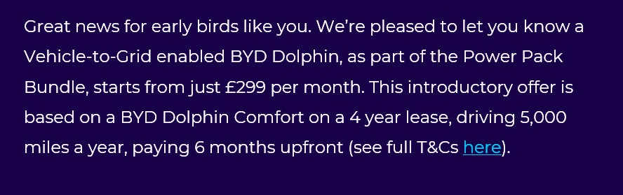

  • 2 weeks later...
well its live and they taking orders. Free charging on this tariff, assume including on the eletroverse network, .
Starting at £299 a month, Single phase bi directional wall charger is supplied.
