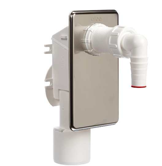

LaChab Posted June 17, 2025 Posted June 17, 2025 Hi, I'm trying to get my head round how to connect the washing machine (and TD, DW). I wondered if anyone has used one of these, or similar. https://www.amazon.co.uk/Mounted-Siphon-Washing-Machine-Chrome/dp/B00D6FCQO4/ref=asc_df_B00D6FCQO4?mcid=10ef8fd756793f09b624b4235a47ccce&tag=googshopuk-21&linkCode=df0&hvadid=696352102719&hvpos=&hvnetw=g&hvrand=10560092967412209591&hvpone=&hvptwo=&hvqmt=&hvdev=c&hvdvcmdl=&hvlocint=&hvlocphy=20339&hvtargid=pla-422507636596&psc=1&hvocijid=10560092967412209591-B00D6FCQO4-&hvexpln=0&gad_source=1 I think it might fit in the kickspace next to the appliance, along with the cold feed and 13a socket, which would be quite neat. BUT I'm worried about not using a conventional standpipe waste. And I can't understand where a standpipe would go, as the void in the back of diy kitchens is only 42mm, and I'd rather not remove the back of the unit. Advice badly needed!
Nickfromwales Posted June 17, 2025 Posted June 17, 2025 Install the upstand inside the unit, fixed to the back or side panel Needs to all be accessible imo.
LaChab Posted June 17, 2025 Author Posted June 17, 2025 Thanks @Nickfromwales Quite agree about accessibility, that's partly why I'm dubious about using the void. Would like to avoid cluttering up the cupboard / drawer unit if possible. What do you think about using one of those nozzles you referred to in that topic with a HepVo. Would that seem better than the Amazon thing? That would go under the kickspace.....
Nickfromwales Posted June 17, 2025 Posted June 17, 2025 5 hours ago, LaChab said: Thanks @Nickfromwales Quite agree about accessibility, that's partly why I'm dubious about using the void. Would like to avoid cluttering up the cupboard / drawer unit if possible. What do you think about using one of those nozzles you referred to in that topic with a HepVo. Would that seem better than the Amazon thing? That would go under the kickspace..... Hep trap will be ok, but would be my second choice tbh.

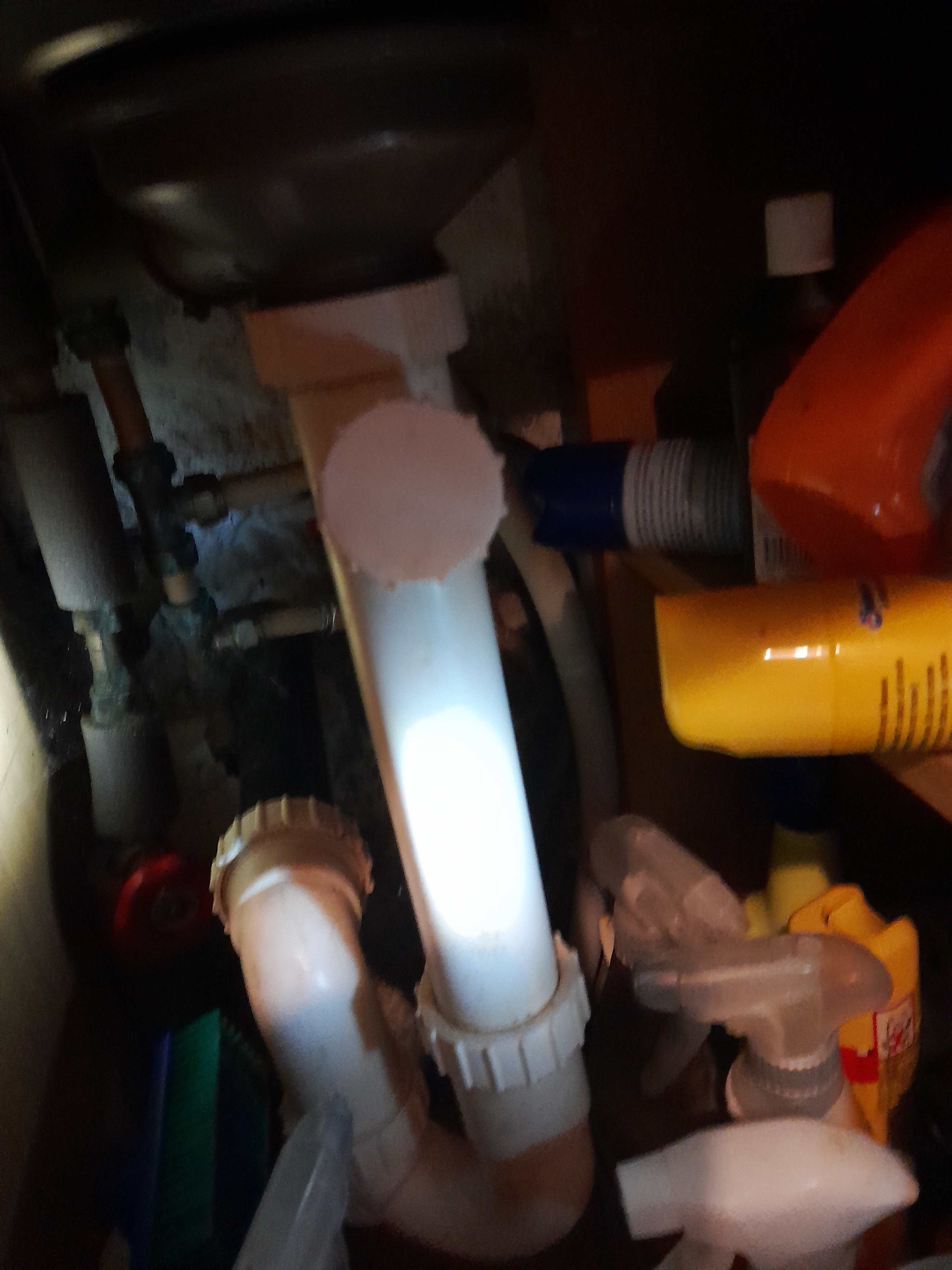

John Carroll Posted June 17, 2025 Posted June 17, 2025 (edited) Dom't know how far away your W/machine is from any sink but I have my Dish washer drain hose connected as shown below, the hose can be seen next to that yellow container on the right, the other waste discharge nozzle is blanked. Edited June 17, 2025 by John Carroll
Nickfromwales Posted June 17, 2025 Posted June 17, 2025 15 minutes ago, John Carroll said: Dom't know how far away your W/machine is from any sink but I have my Dish washer drain hose connected as shown below, the hose can be seen next to that yellow container on the right, the other waste discharge nozzle is blanked. That's a combination trap, which has the issue of the dreaded 'gurgling' when the appliance is pumping out. The ideal situation is, where the discharging water is the other side of the trapped water, so it is inaudible to the room.
LaChab Posted June 18, 2025 Author Posted June 18, 2025 @Nickfromwales Thanks, advice appreciated. @John Carroll Thanks for the suggestion. Those combined things do look interesting, and looking at Screwfix etc very widely used I think. Unfortunately no sink nearby, and also I'm going to fit connections for 3 appliances.
Nickfromwales Posted June 18, 2025 Posted June 18, 2025 1 hour ago, LaChab said: Those combined things do look interesting, and looking at Screwfix etc very widely used I think. You hear the water discharging with those, so I never use them nowadays.... Not so bad if they're in a utility room with the door closed, but horrible if it's an adjoining or open-plan kitchen / dining / living space afaic.

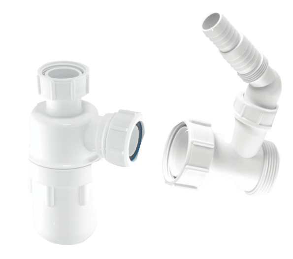

Nickfromwales Posted June 23, 2025 Posted June 23, 2025 45 minutes ago, Super_Paulie said: Are you saying a bottle trap under the kitchen sink, with I guess a spigot before it for the dishwasher/washing machine? I'll be plumbing up this week and I will indeed stand united if I can. I'm partial to a nice but of pipe action, so I'm hoping to not do a lash up. Yes. I don't fit (or avoid with a passion) the multi-component dual trap combination nonsense that a lot of mid range kitchen sink suppliers offer up. Instead, that all goes in the skip and I just fit 1x or 2x McAlpine bottle traps and end of subject. Bombproof. The pipework downstream of the traps gets a T cut in down as low as is practicable, with a 50mm spur of pipe in it and then the WM upstand connects to that.
S2D2 Posted June 23, 2025 Posted June 23, 2025 57 minutes ago, Nickfromwales said: Yes. I don't fit (or avoid with a passion) the multi-component dual trap combination nonsense that a lot of mid range kitchen sink suppliers offer up. Instead, that all goes in the skip and I just fit 1x or 2x McAlpine bottle traps and end of subject. Bombproof. The pipework downstream of the traps gets a T cut in down as low as is practicable, with a 50mm spur of pipe in it and then the WM upstand connects to that. Can the straight nozzle on the upstand you mentioned in the linked thread cause issues with the trap as it seems to be eliminating that source of air intake or is there a distance to the T where that's no longer a consideration? Or do the bottle traps have their own? I fitted an anti-syphon u bend to and existing combination trap and it eliminated most, but not all, of the noise. I think even that was a recommendation of yours so thanks for the ongoing input!

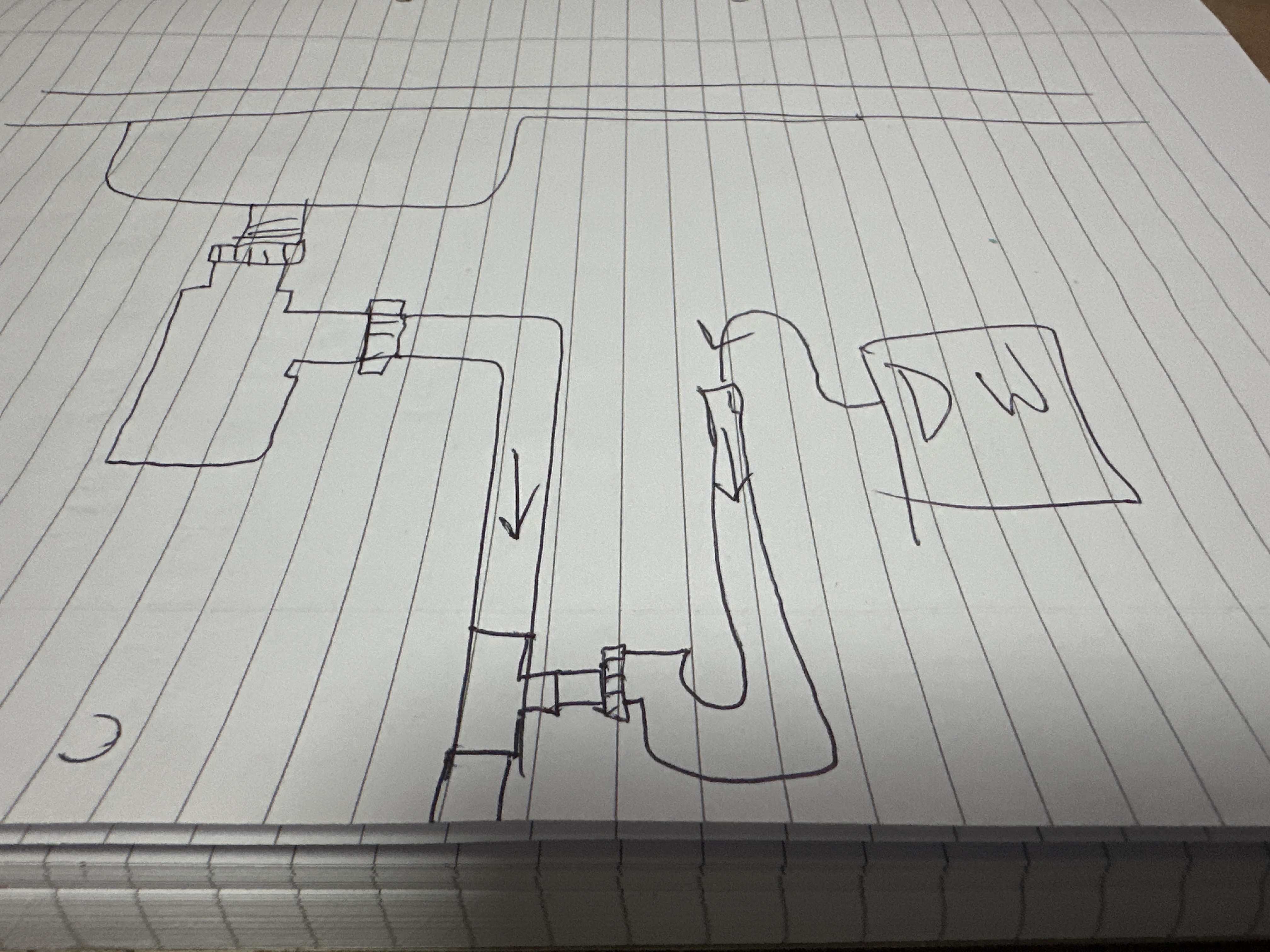

Super_Paulie Posted June 23, 2025 Posted June 23, 2025 (edited) 2 hours ago, Nickfromwales said: Yes. I don't fit (or avoid with a passion) the multi-component dual trap combination nonsense that a lot of mid range kitchen sink suppliers offer up. Instead, that all goes in the skip and I just fit 1x or 2x McAlpine bottle traps and end of subject. Bombproof. The pipework downstream of the traps gets a T cut in down as low as is practicable, with a 50mm spur of pipe in it and then the WM upstand connects to that. In my instance it's a dishwasher. I have a waste coming out directly from the wall so I have effectively got a straight pipe coming into the unit in the rear, back to front. Is the attached very crude image what you would suggest @Nickfromwales, with joining pipes obviously. Instead of the spigot I could make an upstand I guess but I wouldn't need that additional trap would I? Edit. Thinking about it this would syphon all the water from the trap wouldn't it as there is no air admittance. Edited June 23, 2025 by Super_Paulie
Nickfromwales Posted June 23, 2025 Posted June 23, 2025 58 minutes ago, S2D2 said: Can the straight nozzle on the upstand you mentioned in the linked thread cause issues with the trap as it seems to be eliminating that source of air intake or is there a distance to the T where that's no longer a consideration? Or do the bottle traps have their own? I fitted an anti-syphon u bend to and existing combination trap and it eliminated most, but not all, of the noise. I think even that was a recommendation of yours so thanks for the ongoing input! Traps do not create a source of air intake, an air admittance valve (AAV) does that A trap captures water to use to separate the stinky air from the foul pipework from the room air; you don't want stench from the stench pipe. Air admittance is required when falling water drops like 8' for a storey of a house, at 110mm, but absolutely zero requirement for that at a WM upstand. For eg, if you have a bungalow and the invert (the distance discharged water falls from output to horizontal) is <1300mm then even for a flushing WC there is no requirement for air admittance. For this instance the water dropping 600-700mm max from the upstand will never attract a vacuum so will never need any air admittance, so the focus here should be on reducing or eliminating the noise from the water entering the upstand, and DEFO to avoid the horrid gurgling water noise created by a combination sink water arrangement. It's 2025 folks......there's a better way. 1
Nickfromwales Posted June 23, 2025 Posted June 23, 2025 6 minutes ago, Super_Paulie said: In my instance it's a dishwasher. I have a waste coming out directly from the wall so I have effectively got a straight pipe coming into the unit in the rear, back to front. Is the attached very crude image what you would suggest @Nickfromwales, with joining pipes obviously. Instead of the spigot I could make an upstand I guess but I wouldn't need that additional trap would I? Edit. Thinking about it this would syphon all the water from the trap wouldn't it as there is no air admittance.
Nickfromwales Posted June 23, 2025 Posted June 23, 2025 The principal issue is having the appliance connect downstream of the sink trap. Just buy a regular 40mm compression T and insert the bit I linked to, on the horizontal pipework, immediately off the sink trap. Use the appliance hose to create your trap, as without the fall and a pipe at the bottom of the cabinet you cannot get the upstand / trap in this picture. Possibly use a waterless HepVo trap between the T and the adaptor, but something needs to stop back flow of stench from a soil stack into the appliance; if this pipework is open-ended and terminates at an external gulley then there is no 'stench' to speak of, so just the draught to deal with then.
Super_Paulie Posted June 23, 2025 Posted June 23, 2025 5 minutes ago, Nickfromwales said: Interesting. So it's a separate trap basically. I'll see if I can fit that in, it's just a 600 unit with the exit far left maybe 300 up, sink dead center. Sounds like I need to play with my pipe tomorrow.
Nickfromwales Posted June 23, 2025 Posted June 23, 2025 21 minutes ago, Super_Paulie said: Thinking about it this would syphon all the water from the trap wouldn't it as there is no air admittance. No. Not at all.

Super_Paulie Posted June 23, 2025 Posted June 23, 2025 So would this suffice? Id be happier if I didn't need that upstand under there, more room in the cupboard for my dangerous chemicals. However I could do it if I were to sacrifice the shelf.
Nickfromwales Posted June 23, 2025 Posted June 23, 2025 3 minutes ago, Super_Paulie said: So would this suffice? Id be happier if I didn't need that upstand under there, more room in the cupboard for my dangerous chemicals. However I could do it if I were to sacrifice the shelf. Ok. When you say would this suffice, the problem is what is going where here? The adaptor you show is supposed to go on top of the trap and connect to the waste outlet of the sink, hence you will get "the gurgle".
Nickfromwales Posted June 23, 2025 Posted June 23, 2025 19 minutes ago, Super_Paulie said: it's just a 600 unit with the exit far left maybe 300 up So, where the pipe enters the unit you have your T, and then carry on up to the sink bottle trap. You use the other branch of the T to connect a WM upstand to, ensuring it is to the side of the bowl of the sink and ends as high up as is possible.
Nickfromwales Posted June 23, 2025 Posted June 23, 2025 4 minutes ago, Nickfromwales said: Ok. When you say would this suffice, the problem is what is going where here? The adaptor you show is supposed to go on top of the trap and connect to the waste outlet of the sink, hence you will get "the gurgle". At this point you'd just stick with a single unit, a "combination trap".
