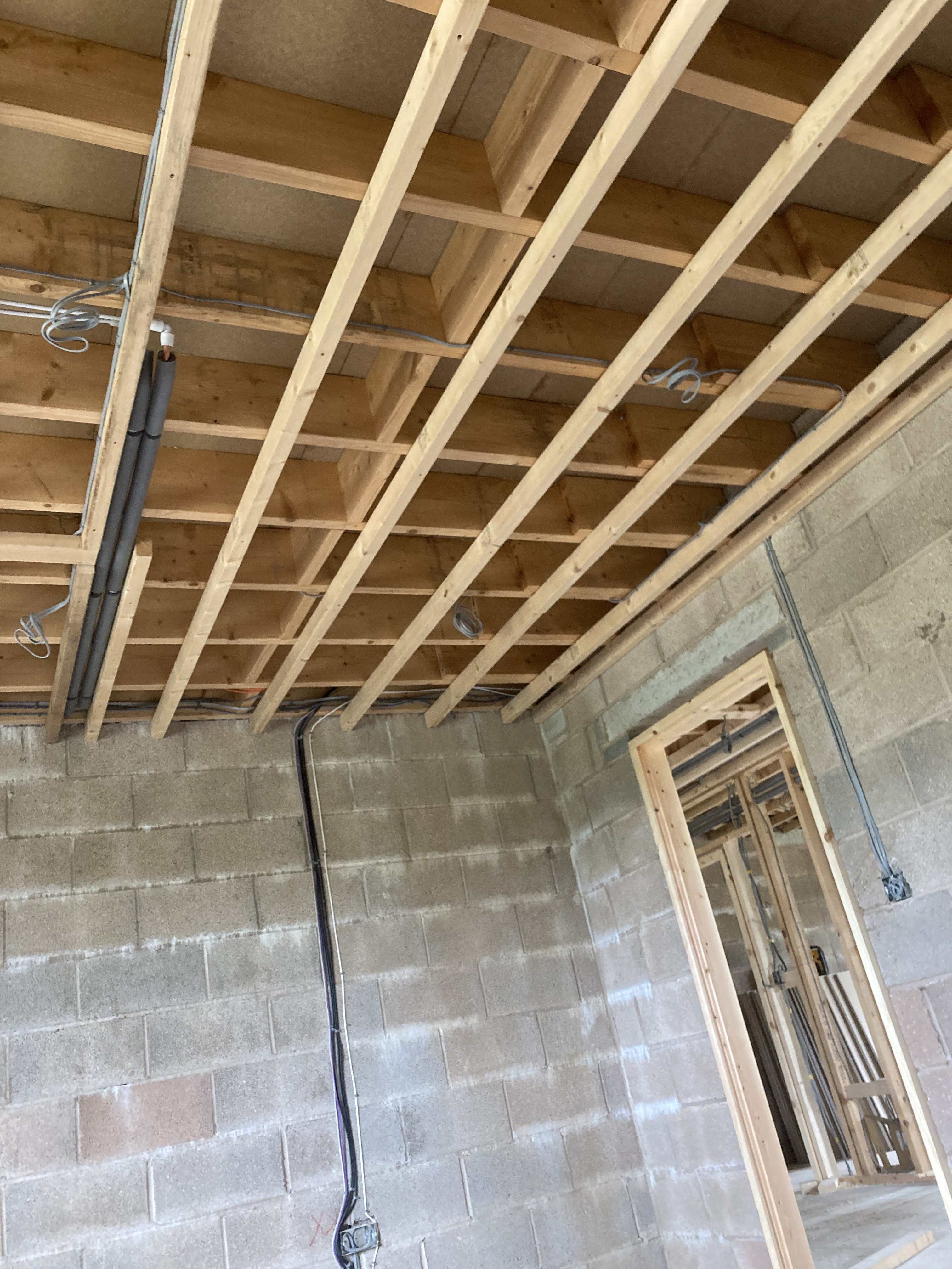

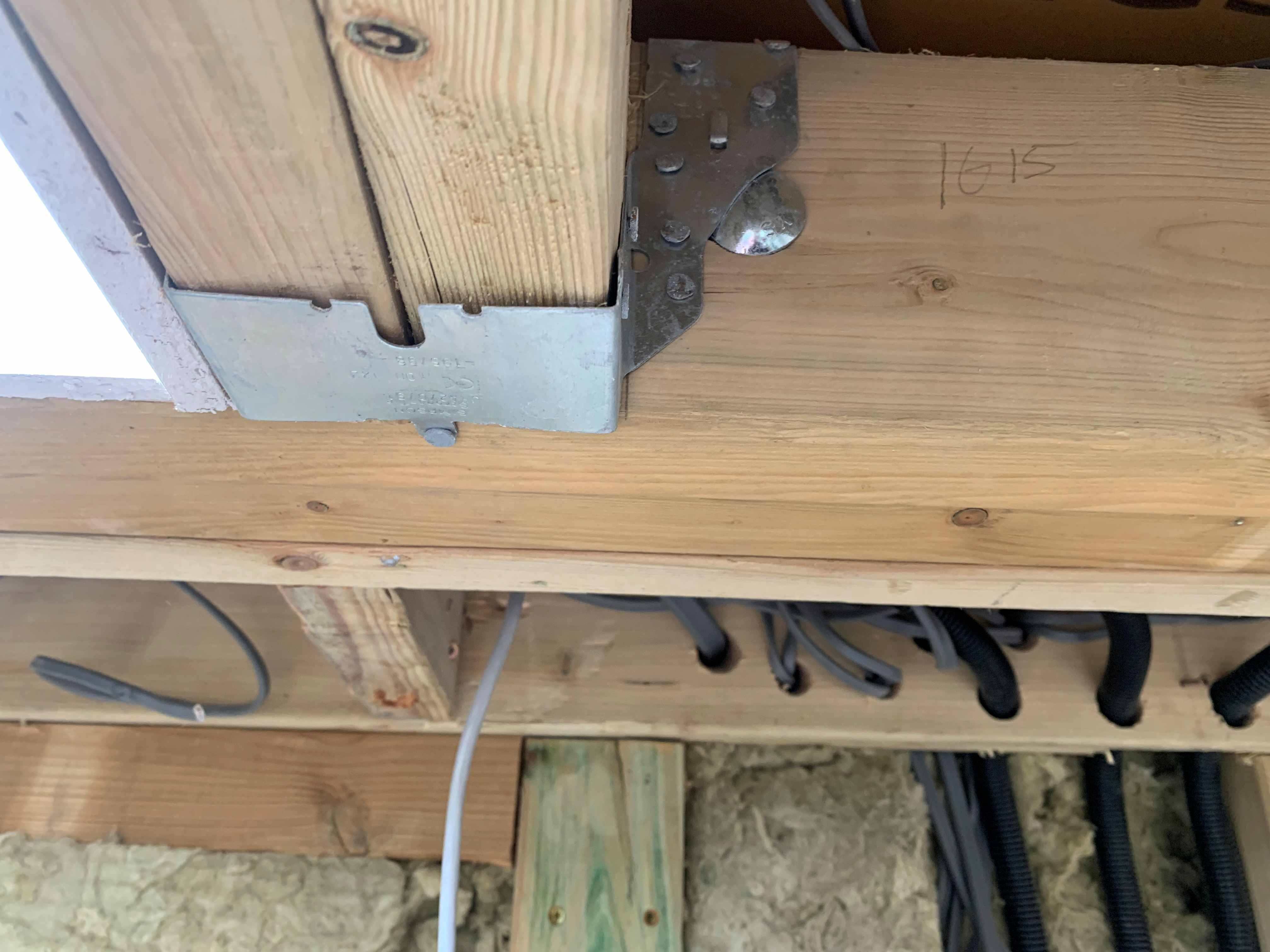

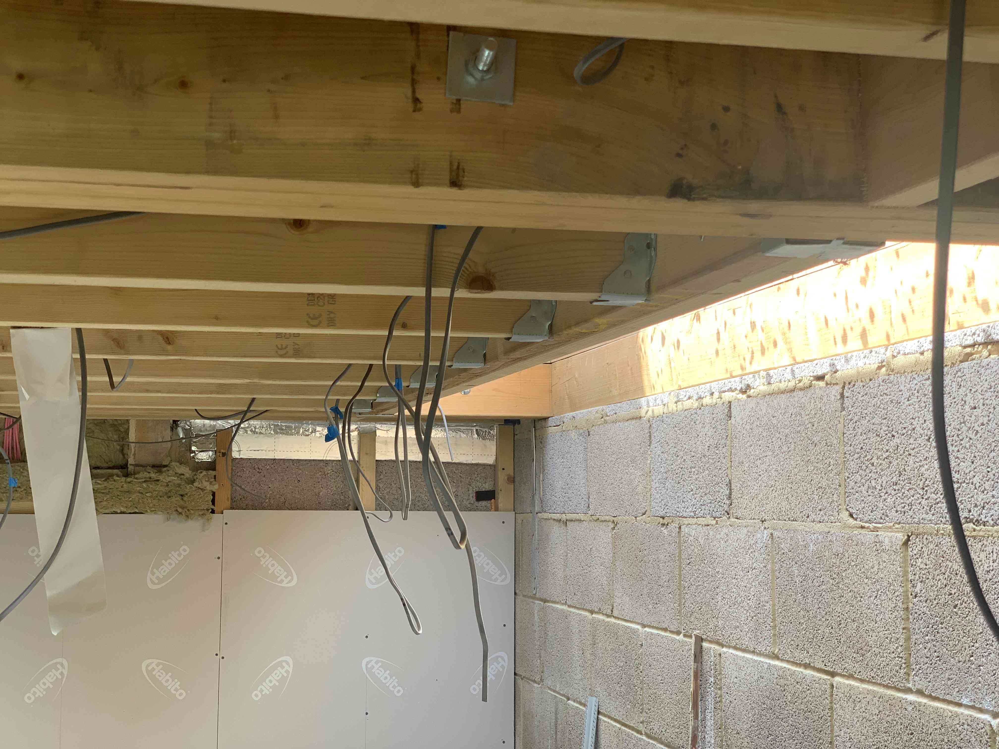

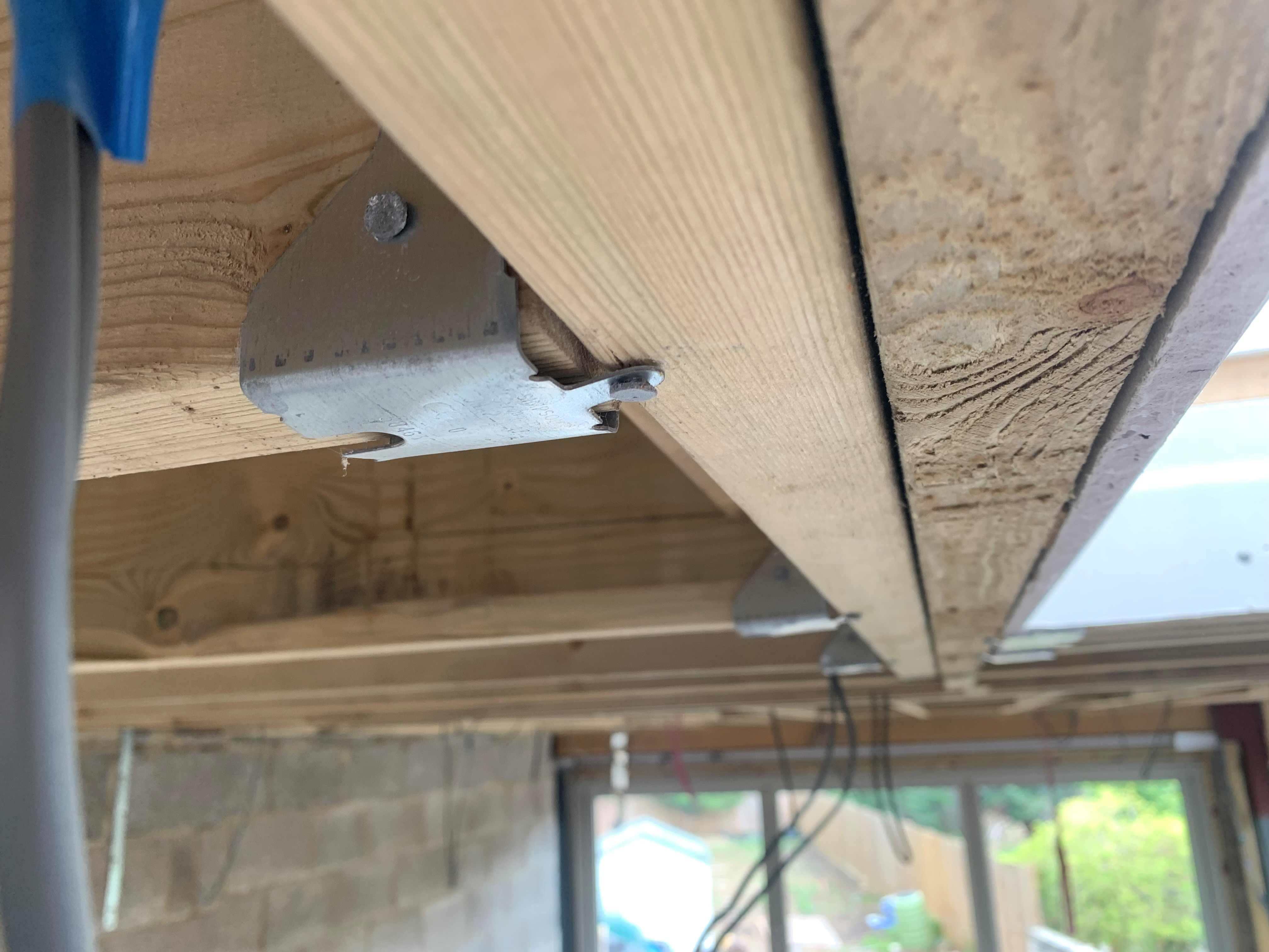

June 12, 20251 yr Will need to board the ceiling in the new extension soon. Some ceiling joists sit in joist hangars which therefore protrude down below the general level of the bottom of the ceiling joists. Also one or two joists not perfectly level in places with the rest of the timbers. When it is boarded is this likely to be a problem ? What can I do about it ?
June 12, 20251 yr 1 hour ago, Spinny said: Will need to board the ceiling in the new extension soon. Some ceiling joists sit in joist hangars which therefore protrude down below the general level of the bottom of the ceiling joists. Also one or two joists not perfectly level in places with the rest of the timbers. When it is boarded is this likely to be a problem ? What can I do about it ? Counterbattening your ceiling is what we are doing. Solves this problem, strengthens the floor above and mitigates any potential issues with plaster skim cracking as the floors settle. you can also shim under your counterbattens if not perfectly level. Edited June 12, 20251 yr by SBMS

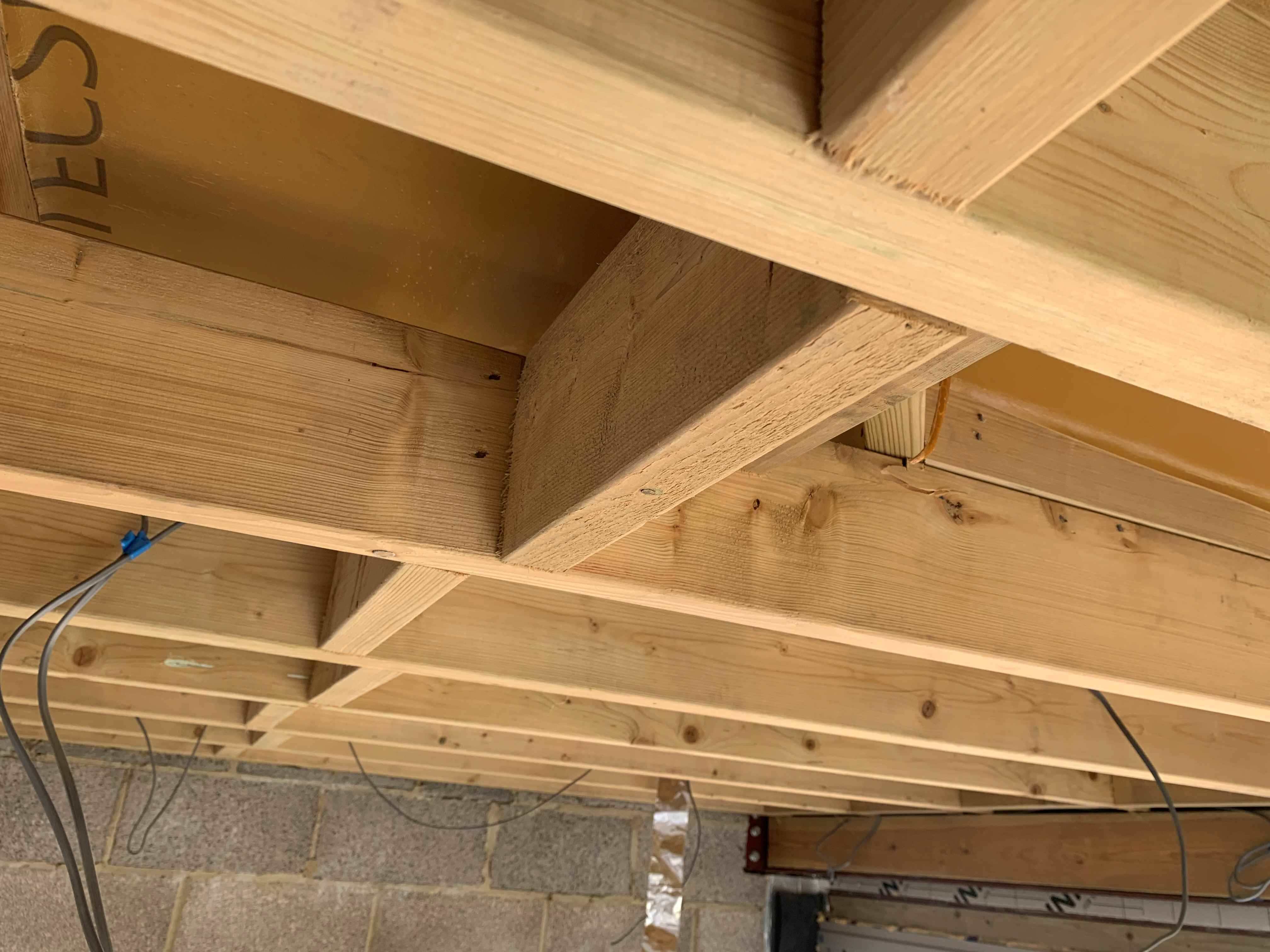

June 12, 20251 yr Author Have heard of counter battening but was never specified or part of our plan. We wanted the ceiling height to match the main house. We don't have any floor above, it is a single storey extension. Seems like quite significant extra work, cost, and time. Is there another way ? bash them up as tight as possible with a hammer ? and/or score out a bit of plasterboard behind them ? some judicious use of a multitool ? See photos
June 12, 20251 yr That dwang could be removed easily enough and put level, but by the time you've messed about doing that, hacking the back of the plasterboard to get it level, you might as well have just nailed up some simple cheap battens and be done. If you're going to get it plastered, that would cover a few sins, or maybe use insulation backed plasterboard which will conform better, but of course cost more.
June 12, 20251 yr 5 hours ago, Spinny said: Seems like quite significant extra work, cost, and time Hardly… a few 25mm tile battens, nail gun could have it done in a day? Much easier than faffing around compromising your hangers in my mind. Apparently it’s better for plastering - less likely to crack so I’ve been told. Is that true @nod?
June 12, 20251 yr 6 minutes ago, SBMS said: Hardly… a few 25mm tile battens, nail gun could have it done in a day? Much easier than faffing around compromising your hangers in my mind. Apparently it’s better for plastering - less likely to crack so I’ve been told. Is that true @nod? I used 3-1 on both ours It is better for plastering Gets over the hangers But also stops the floor above creeping The one I pictured today Is one we where asked to do to give a bit more depth
June 12, 20251 yr 6 hours ago, Spinny said: Is there another way ? There was (notching the timbers so that the hangers are flush) but, from where you are now, counter-battening is your best option.

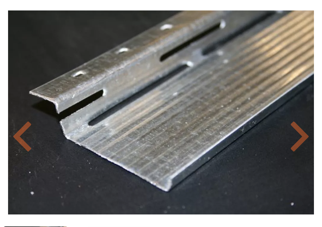

June 12, 20251 yr I fitted resilient bars, separates the plasterboard from the floor joists and supposedly helps with reducing noise. @nod will confirm? Noise not an issue if single storey but would get you under the hangers. Edited June 12, 20251 yr by JamesP

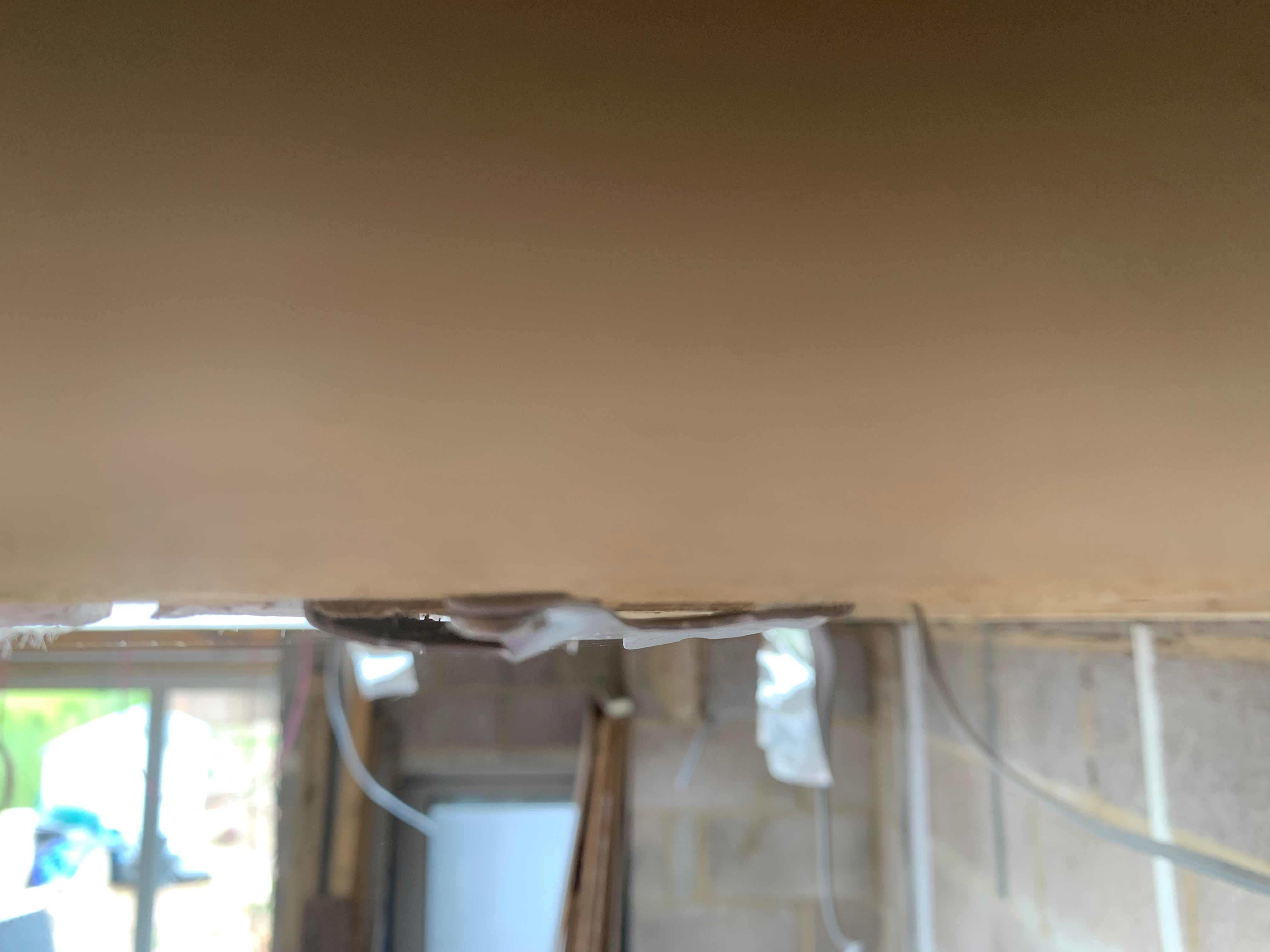

June 12, 20251 yr I had multiple brackets on JJI joists so I made cut outs in the plasterboard with the multi tool.

June 12, 20251 yr Author 27 minutes ago, Mike said: There was (notching the timbers so that the hangers are flush) but, from where you are now, counter-battening is your best option. The Builders Prj Manager took great care to ensure the joists could be notched over the steels to avoid the steels being proud of the joists. Strange to then completely ignore the hanger issue. (I suppose they are there because of the rooflights. I guess he had never done a build with rooflights before. (He was a former chef))
