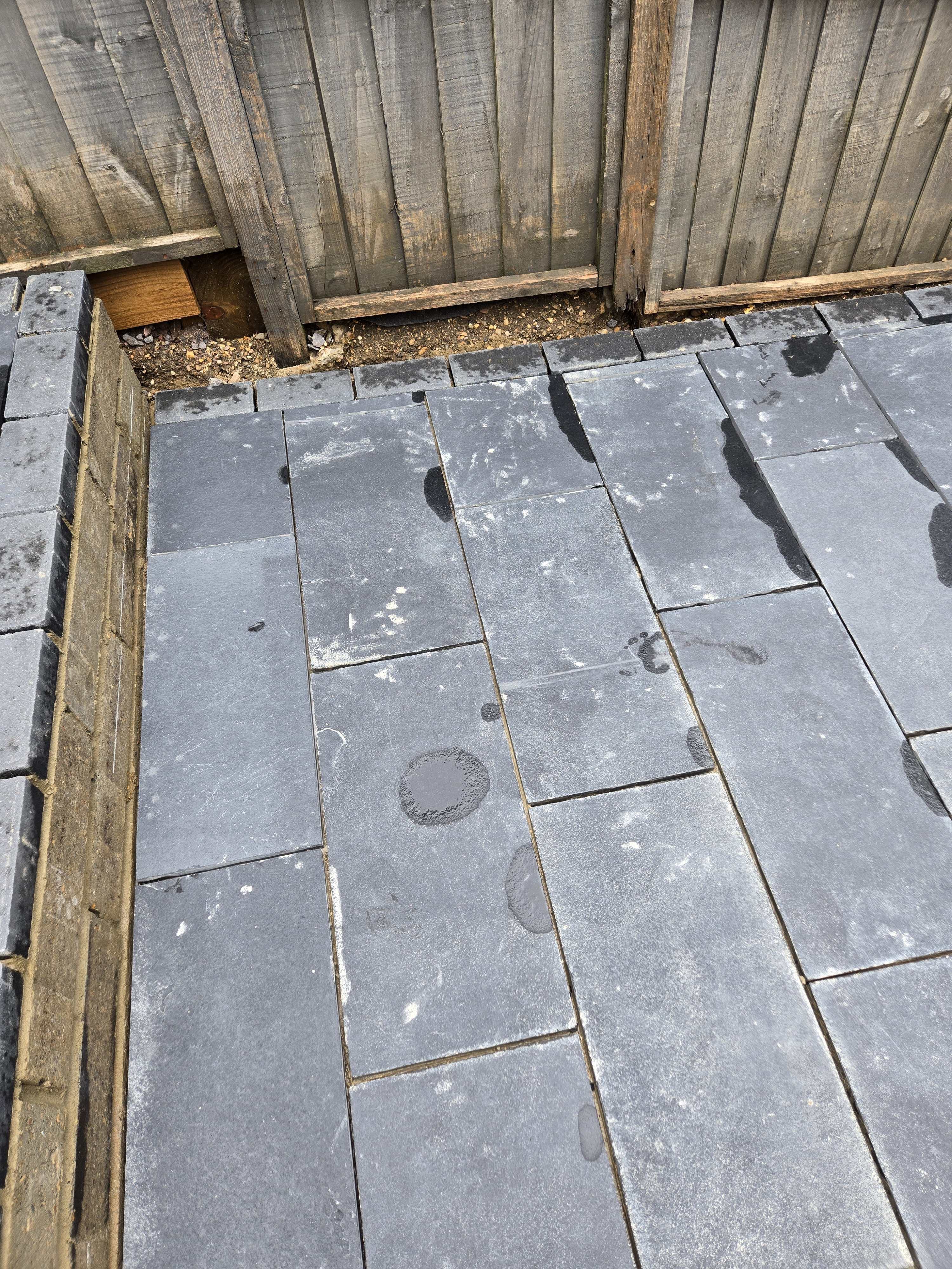

caddick Posted June 8, 2025 Posted June 8, 2025 (edited) I've installed a limestone patio on a compacted sub base with 40-50mm full mortar base. Happy with how the laying turned out but think I have messed up by not cleaning the slabs fully when laying. I have all these stain marks on the slabs. I have tried floorseal patio cleaner. Is there any recommendations for removing these stains? Edited June 8, 2025 by caddick
JohnMo Posted June 8, 2025 Posted June 8, 2025 Try just water and a cloth. The longer you leave the harder it will be to remove. The big splat, scrape of the worst first. You may have to gently scrape of what doesn't come off with water.
caddick Posted June 8, 2025 Author Posted June 8, 2025 I have tried to scrub it off already and used a plastic scraper, is there anything else I can do?
MikeSharp01 Posted June 8, 2025 Posted June 8, 2025 Are they grout stains? In which case might be worth getting a small bottle of concrete acid - but TRY IT ON A BIT OF SCRAP LIMESTONE BEFORE GOING FOR IT. LIMESTONE is remarkably reactive. Screwfix do something called eradicrete which might do it. 1
caddick Posted June 8, 2025 Author Posted June 8, 2025 I haven't pointed the patio yet, but I think they are mortar stains from laying the slabs. Thank you, I will get some of that and try it.

nod Posted June 8, 2025 Posted June 8, 2025 Carefully dab a small area with brick acid on a sponge Then wash away as soon as it starts to soften Or as Ian suggests Live with it
