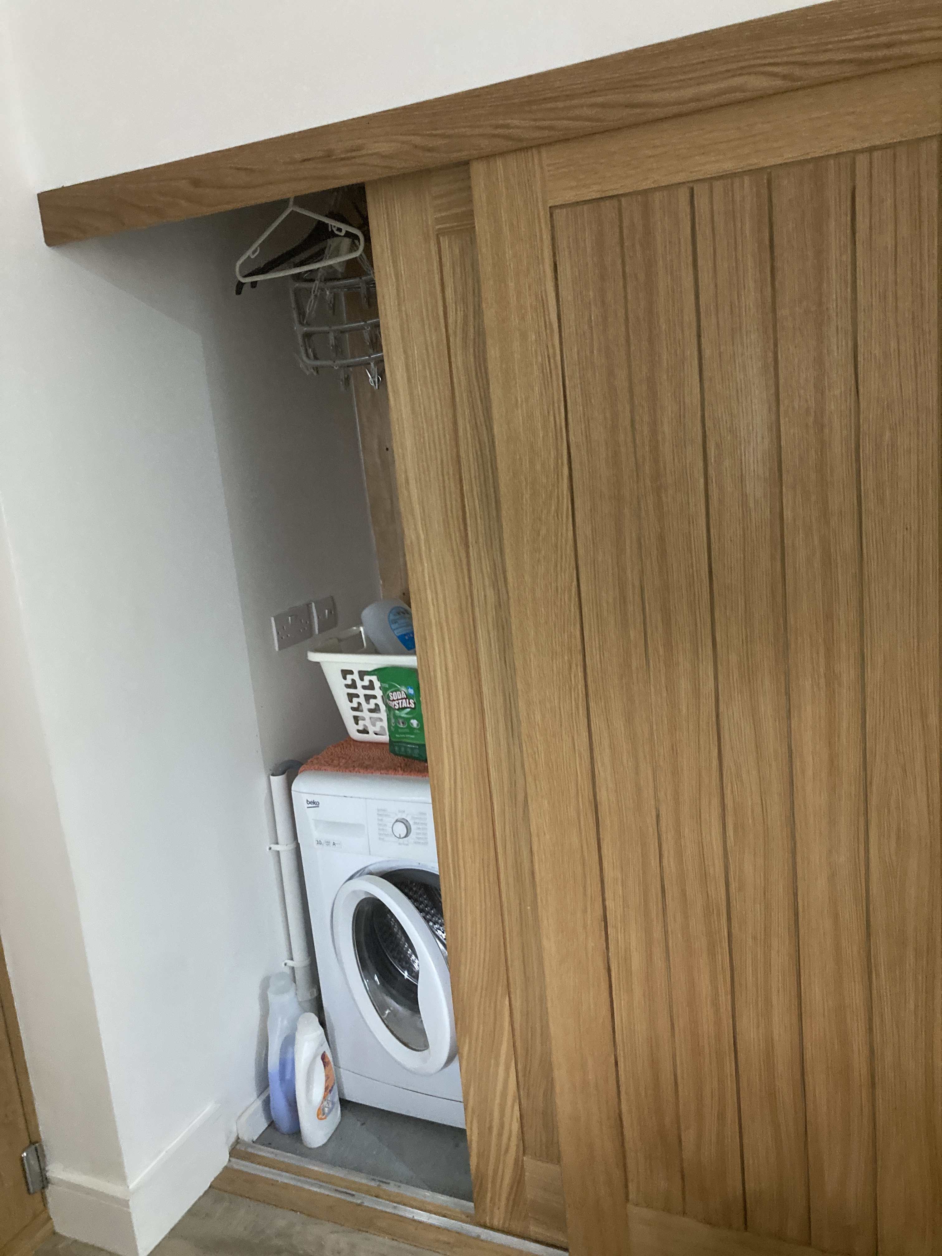

nod Posted Saturday at 08:37 Posted Saturday at 08:37 Hardly any of mass produced homes have sound insulation Other than the required pipe boxes and bath- toilet wall that connects to a living area Insulating between the floor and bedroom makes a little bit of difference and deadens the sound more than silence es it The only site that I do that really try is local Authority accommodation They tend to spec a MF gypliner ceiling and sound block board below the GF ceilings which really makes a difference Weve enclosed our washer 2
flanagaj Posted Saturday at 09:31 Author Posted Saturday at 09:31 50 minutes ago, nod said: Hardly any of mass produced homes have sound insulation Other than the required pipe boxes and bath- toilet wall that connects to a living area Insulating between the floor and bedroom makes a little bit of difference and deadens the sound more than silence es it The only site that I do that really try is local Authority accommodation They tend to spec a MF gypliner ceiling and sound block board below the GF ceilings which really makes a difference Weve enclosed our washer Enclosing the washing machine is a good idea. That is definitely something that we could also accomodate. With regards to ceiling / floor insulation. What is the general consensus to mitigate acoustic noise as best as possible. I did consider a block / beam upper floor, but having MVHR in the void below the floor would eat too much into ceiling heights. Therefore, it's posiweb joists. Interested to see a schematic of a decent spec first floor, showing the different layers.
