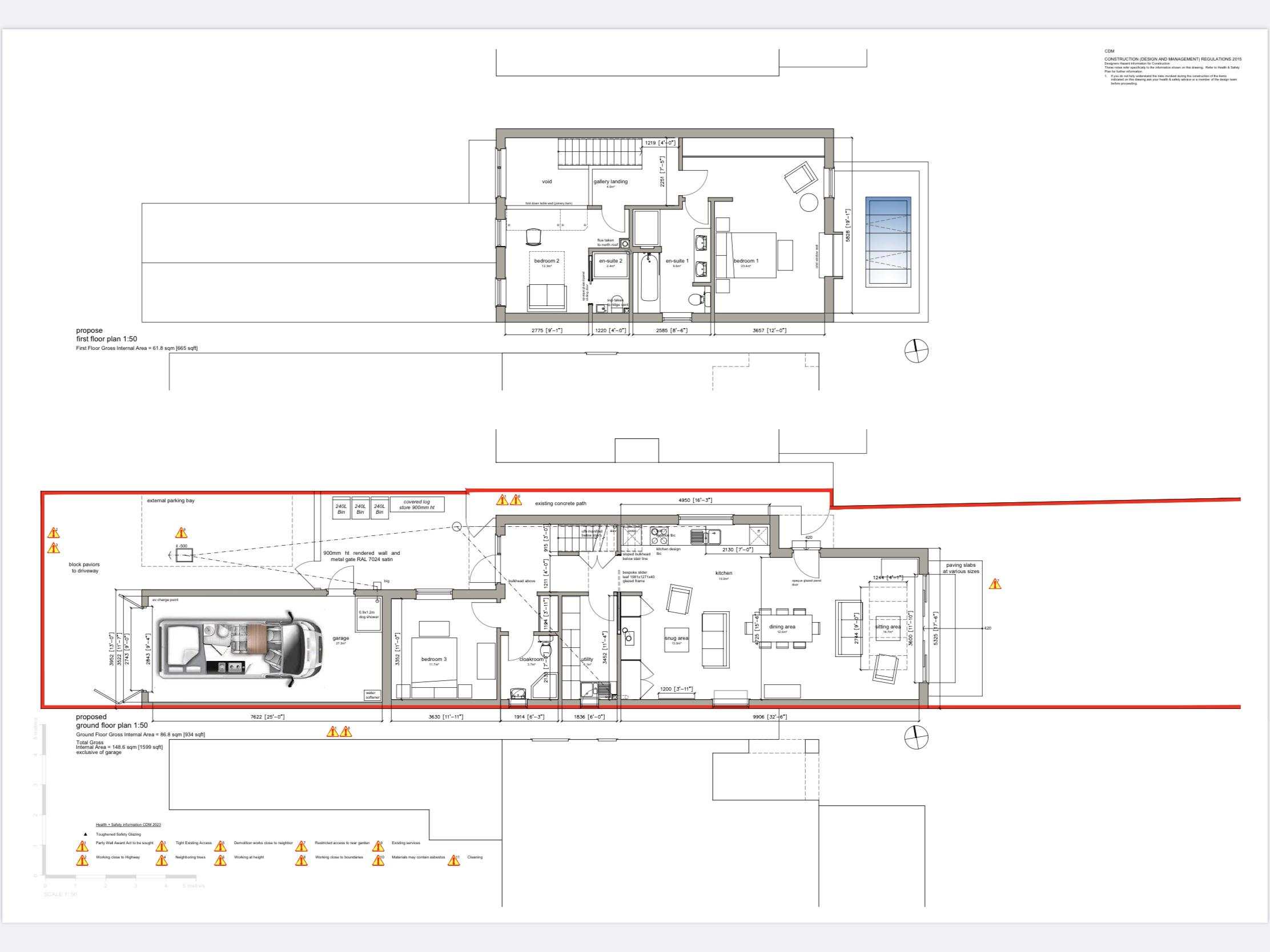

G and J Posted June 14, 2025 Posted June 14, 2025 Which means that none of our bedrooms require emergency escape windows as they are all directly connected with the front door via a landing, stairs and a hall. I've been worrying over nothing!
DevilDamo Posted June 14, 2025 Posted June 14, 2025 5 hours ago, G and J said: Which means that none of our bedrooms require emergency escape windows as they are all directly connected with the front door via a landing, stairs and a hall. I've been worrying over nothing! Is yours a single, two or three storey dwelling?
G and J Posted June 14, 2025 Posted June 14, 2025 Two storey, two beds upstairs, one down. Each with an egress window planned so we are covered anyway. It's wild (and feels random) how varying opinions are about such things. I kinda feel the need for a fire escape window should be pretty cut and dried. I’ve posted our plans on our blog. I’ll paste a link in a mo.
DevilDamo Posted June 14, 2025 Posted June 14, 2025 51 minutes ago, G and J said: Two storey, Which would have different requirements than a single storey (bungalow) dwelling. The number of storeys dictate the means of escape requirements.
