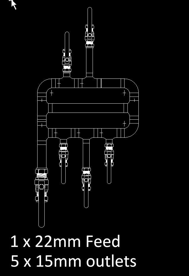

MikeSharp01 Posted May 20, 2025 Posted May 20, 2025 I have come up with a manifold (I need 2 one for hot and one for cold) that is fabricated from soldered copper. Before I put them into manufacture I thought I would seek the collective wisdom's view on the idea - what have I missed / got wrong / forgotten. It has single 22mm inlet two main runs leading to 15mm outputs with a central balancing support run. We have good water pressure, 3 Bar at this point and very good flow. See image below and let.

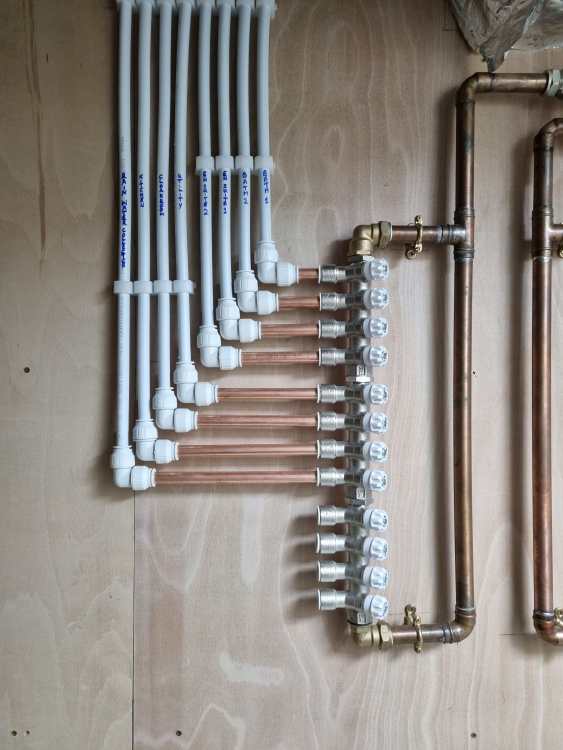

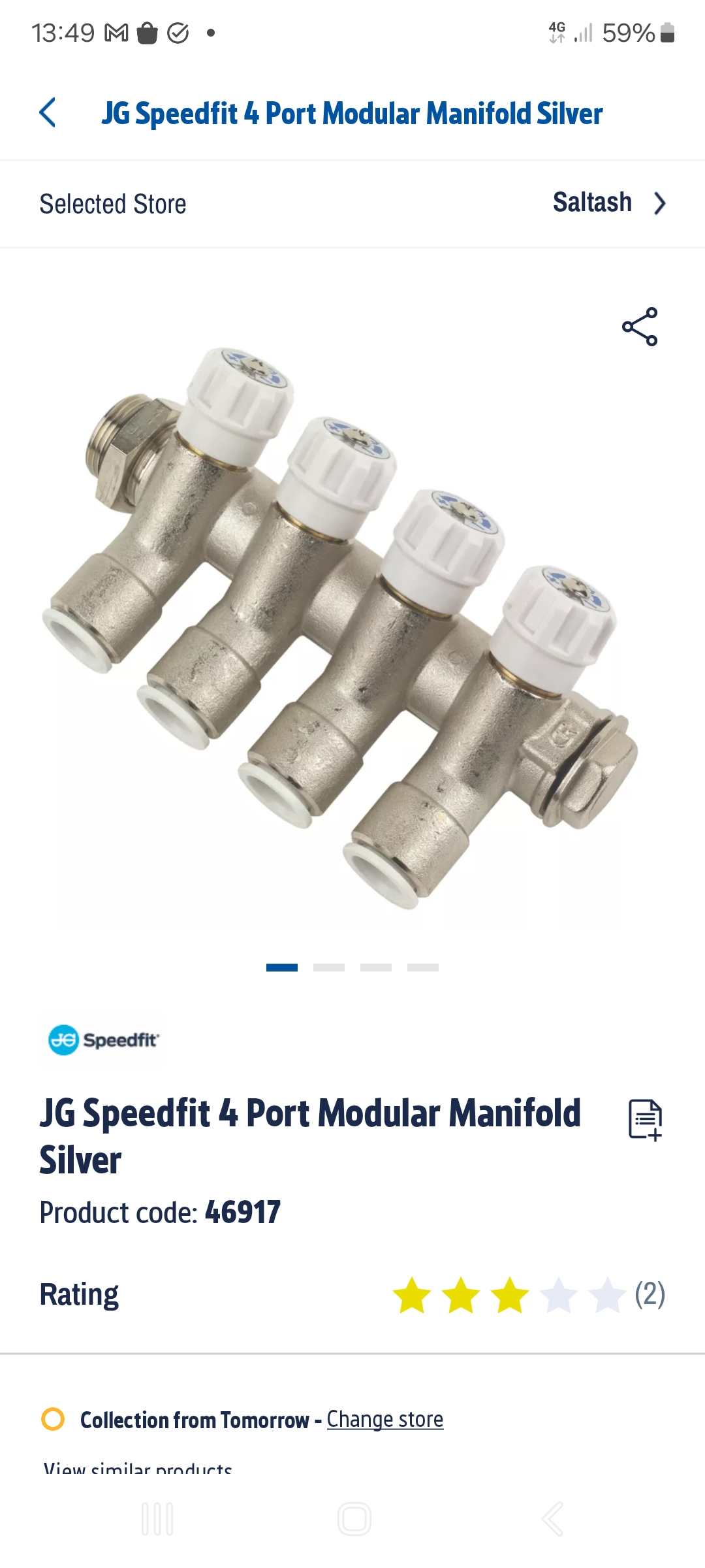

BotusBuild Posted May 20, 2025 Posted May 20, 2025 Something like this is what I put together, one for hot, one for cold Using these, although they were cheaper when I bought them. Have you thought about using push fit plastic to create this manifold?

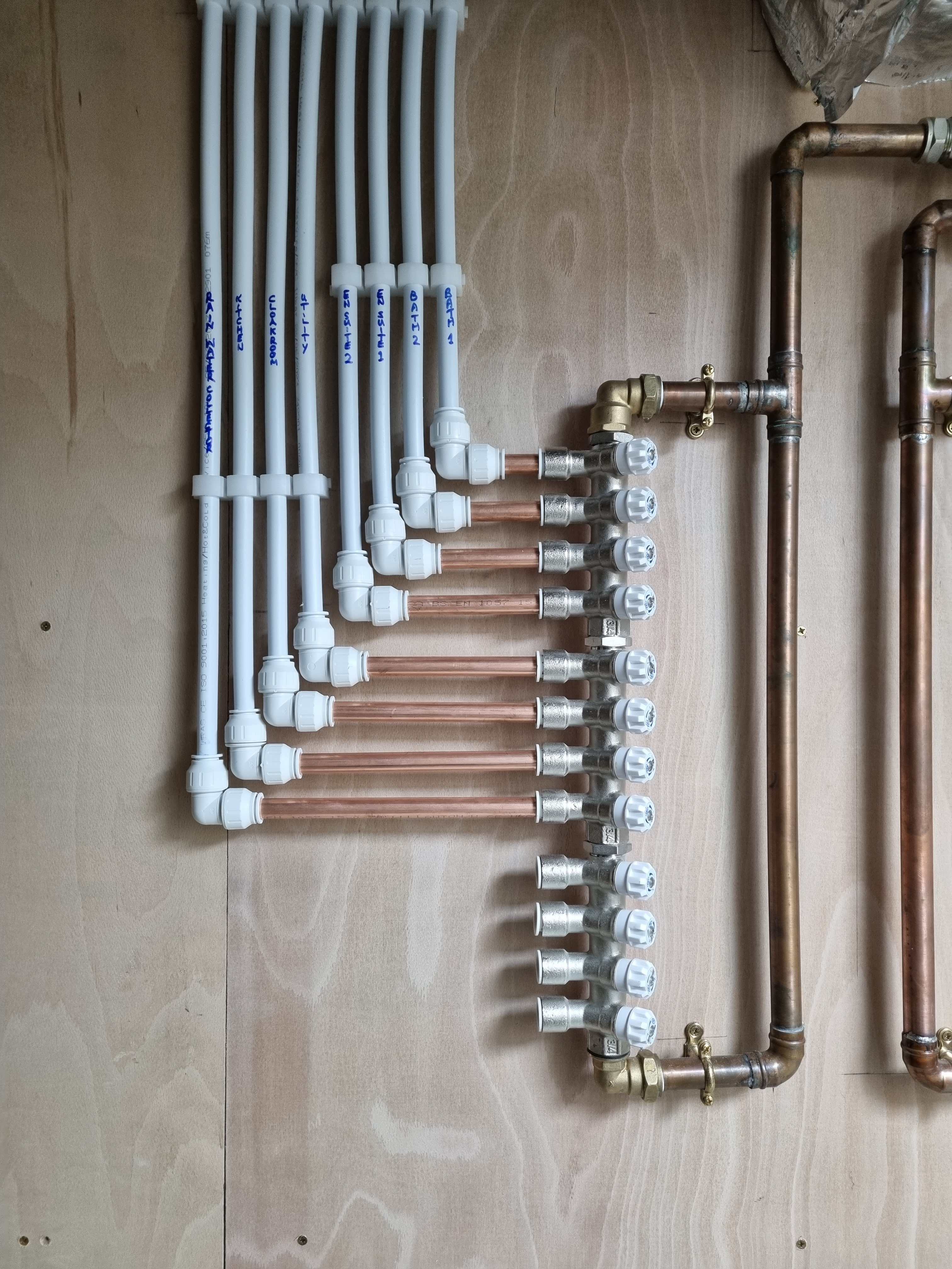

JohnMo Posted May 20, 2025 Posted May 20, 2025 This mine 2x 5 port (hot and cold), single feed, no flow issues.
MikeSharp01 Posted May 20, 2025 Author Posted May 20, 2025 25 minutes ago, JohnMo said: Why so complex? Well essentially because I want 2 pipes going up the wall and 3 pipes going down so I thought this was quite elegant in its way, the ball valves are full bore and fast to operate.

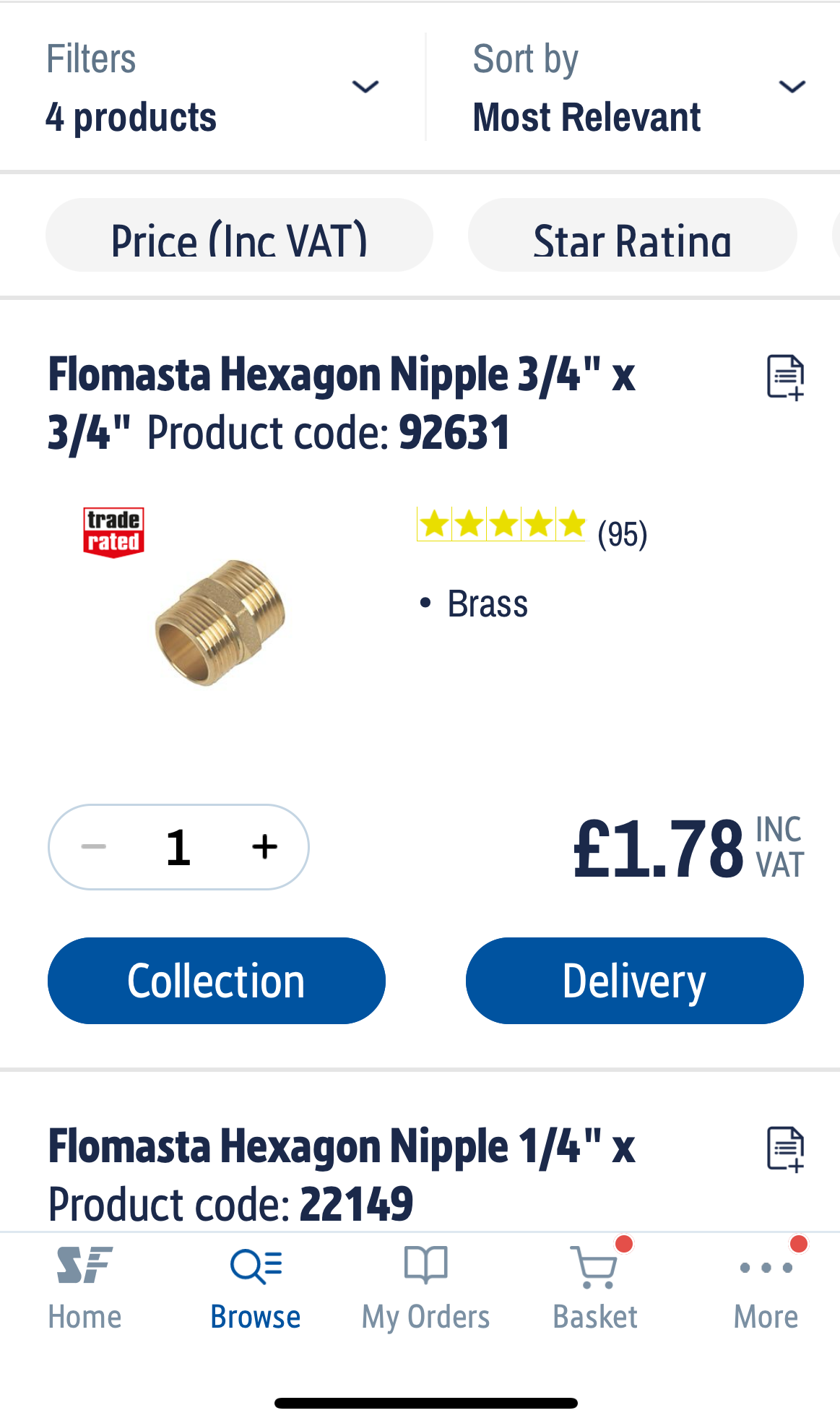

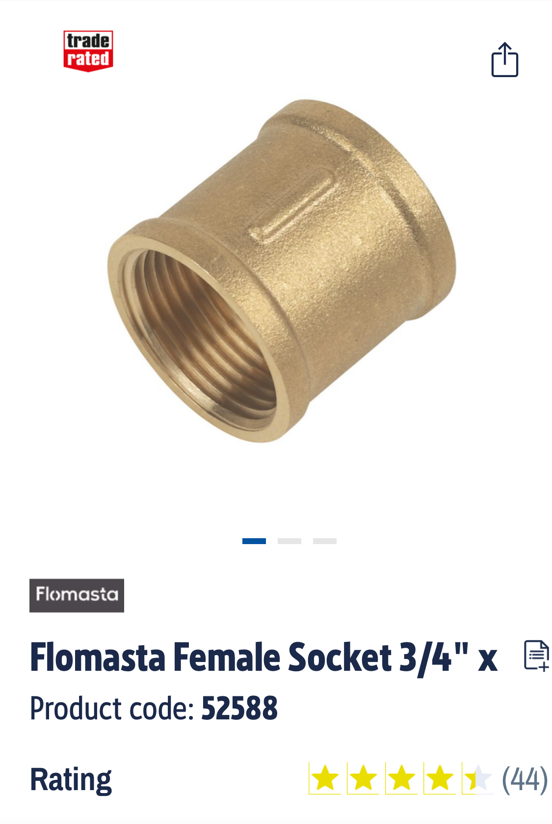

Nickfromwales Posted May 20, 2025 Posted May 20, 2025 53 minutes ago, MikeSharp01 said: Well essentially because I want 2 pipes going up the wall and 3 pipes going down so I thought this was quite elegant in its way, the ball valves are full bore and fast to operate. You can make up (or maybe buy) a union that reverses 3/4” male to a female (3/4” coupler) and then have 2x hep2o manifolds to the same thing, so the first facing up, and the second facing down; the hep units link male > female, and sit in the same direction, hence you’d need to rectify that so you could go male > male or female > female, whichever works better. Obvs you’d have an issue creating the looped feed to both ends, but tbh with good pressure and no 28mm pipework, I doubt there’s any need to create the looped feed. or which will allow you to flip the second one 180°
