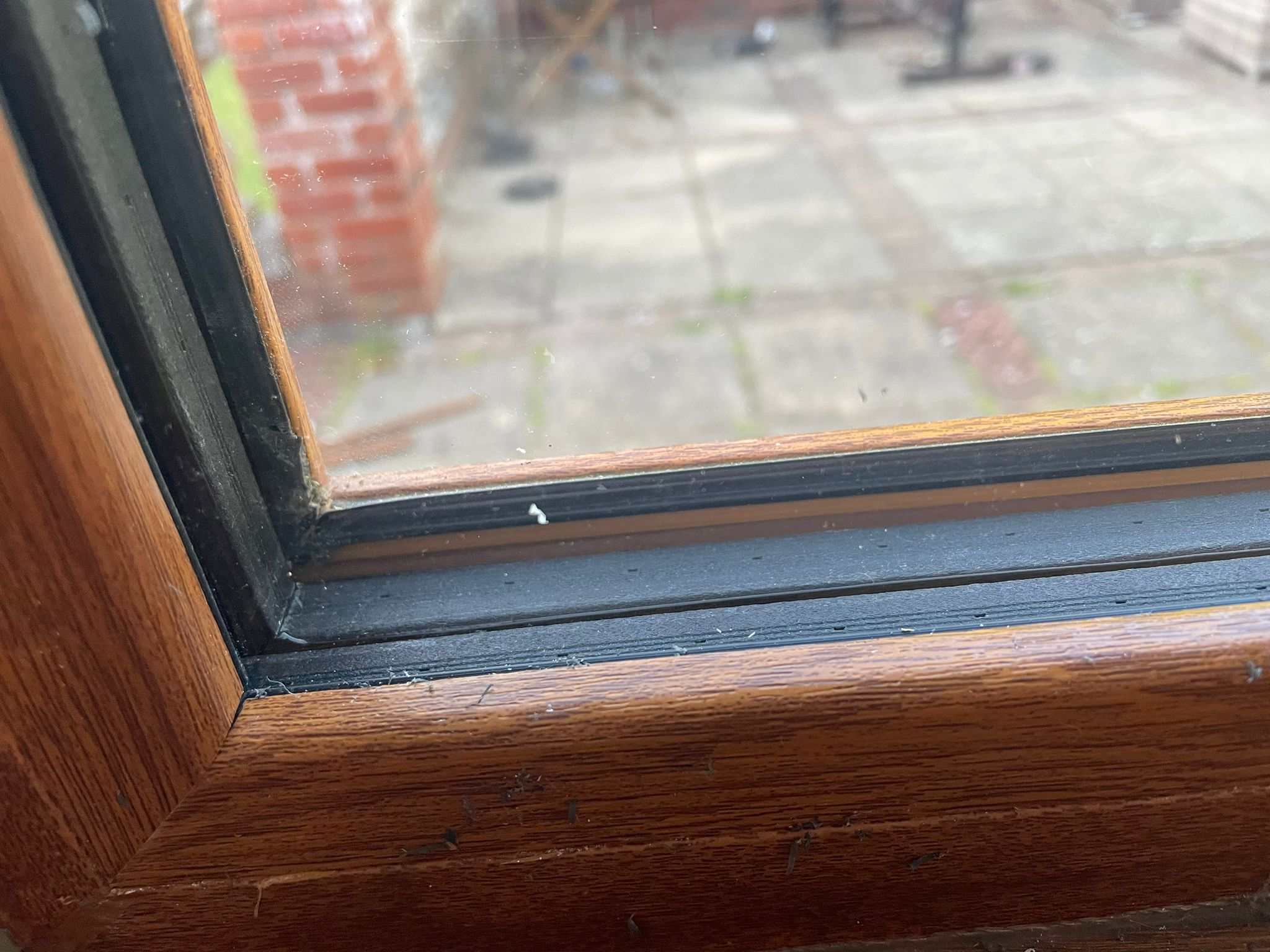

We've recently had all the glass upgraded in a rear extension from standard double glazed (1.3 U value) to high thermal performant triple glazed acoustic (0.675 U value) in a hope to improve the room's ability to retain heat.
It's been in a good few days now and frustratingly the room seems to be retaining heat worse than before!... i.e - It's dropping by more degrees over night than it did with the standard double glaze in previous.
Due to the huge difference in U value I started to think perhaps this could be down to a poor install? I'm not technical but took a closer look and found some things I wonder whether anyone on here would be able to confirm are a problem or not? list with images below.
  • The units appear to sit very low in the frames, much lower than the units previous did.
    • I'm wondering if they're not sat on packers?  If they're sat so low could there be a massive gap at the top allowing coldness?... and could this damage the units and frames too?

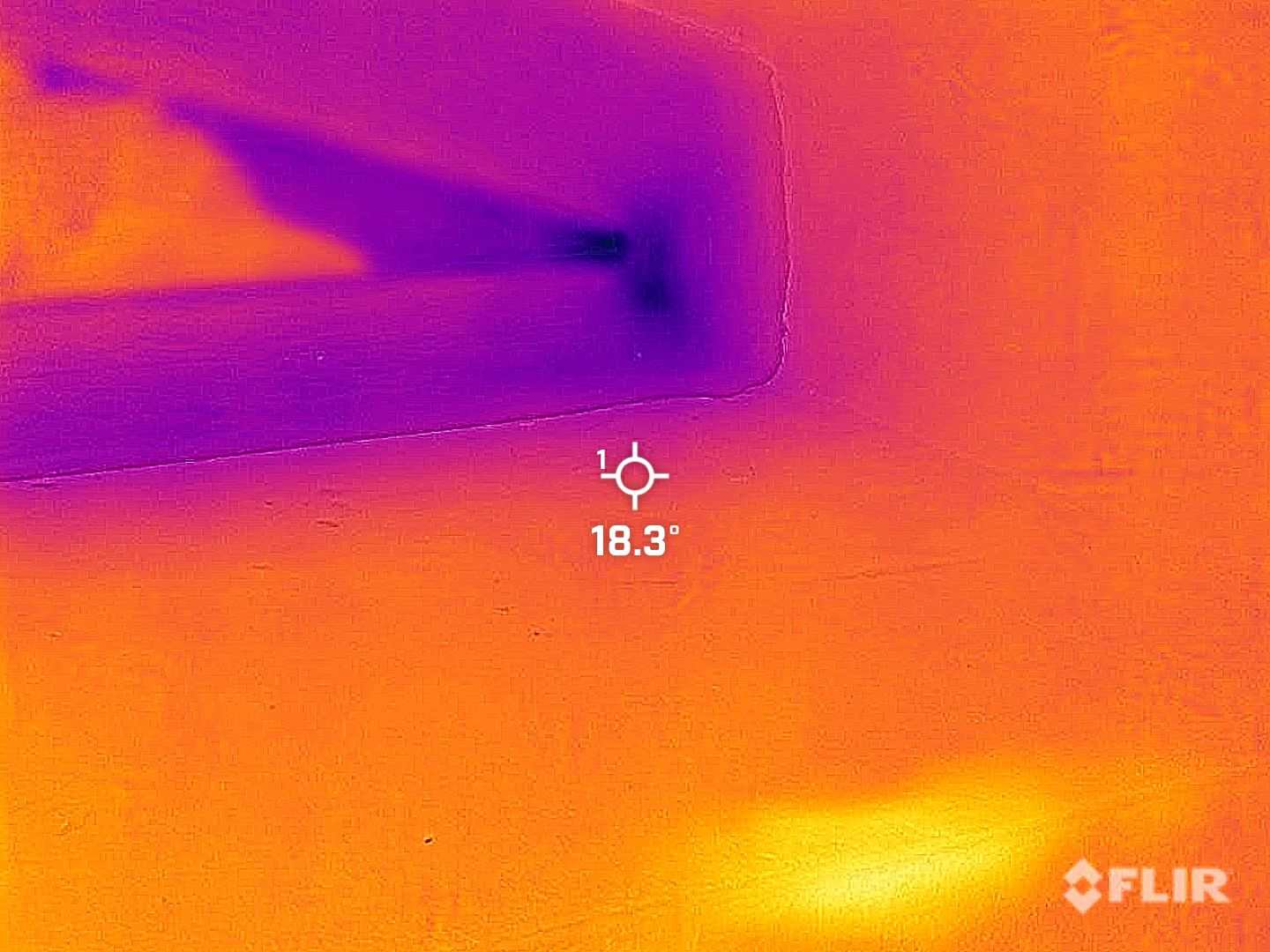

  • Some of the black unit framing is very visible on some of the windows.
    • If the unit is either fitted off-centre or if they've measured it wrong and made a unit too small, could this cause an issue?
    • The thermal cam did pick this up.

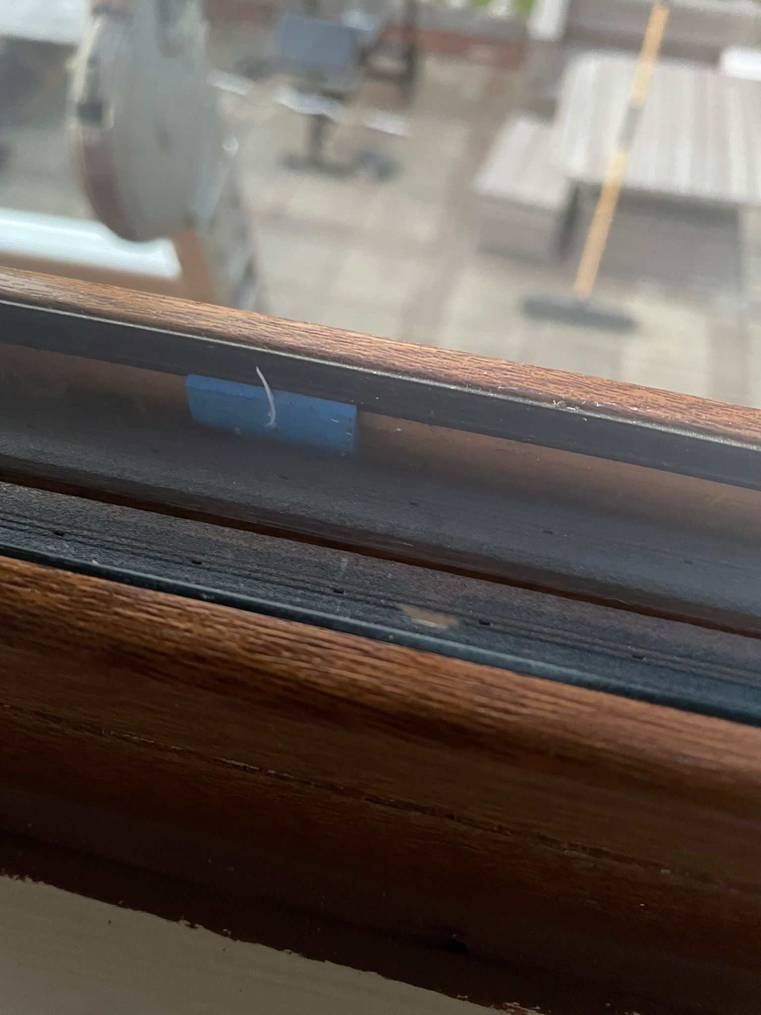

  • On one of the windows I can see they've put vertical packers between the glass and exterior frame
    • Again, could this be an issue letting draughts in? never seen this before, or is it fine to do this?

There's a couple of issues here tbh.
  1. It appears the glass is too big by about 3/5mm in width and height, when measuring, it would appear the have measured from bead to bead and not deducted anything and not said anything, take a bead off, and if the glass is to the frame, with no packers, that's exactly what they have done and I would be requesting they correct their mistake. Any movement and with the glass not being correctly packed, could cause the glass unit to fail.
  2. A double glazed unit will be 24, 26 or 28mm thickness, which consists usually of 2 x 4mm glass panes and 16, 18, 20mm spacer between the glass.  A triple glazed unit at 28mm thickness, isn't going to be much better than a modern 2g unit in all honesty.
  3. Blue packer / glazing foam transport as @dpmiller suggested, the size of packers are defined in colour coding as standard, blue is 5mm, if they have used a packer here but I would have preferred to see some glazing tape. The glass can be up directly against the frame without a packer or glazing tape but as long as the gasket meets the glass externally. Whether it is a packer or foam glazing protector, I suspect the gasket isn't meeting the frame.

  4. Movement in spacer, this ties into point 3, this packer of 5mm appears to be an attemp to pack the glass, so that internally you wouldn't see any difference but just a suspicion, is there a gap between the frame and glass externally? If yes, then it explains the movement in the glazing bead imho.

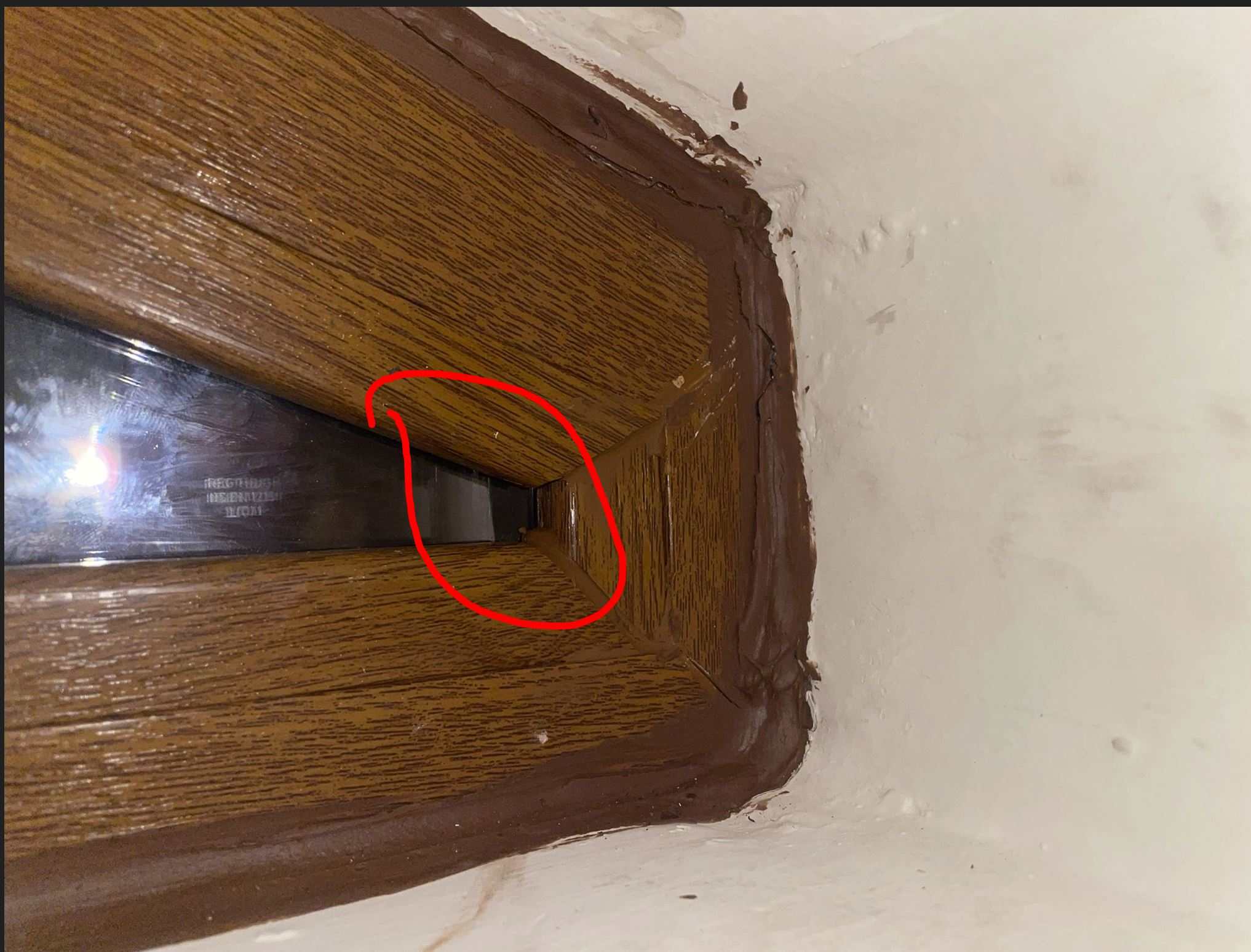

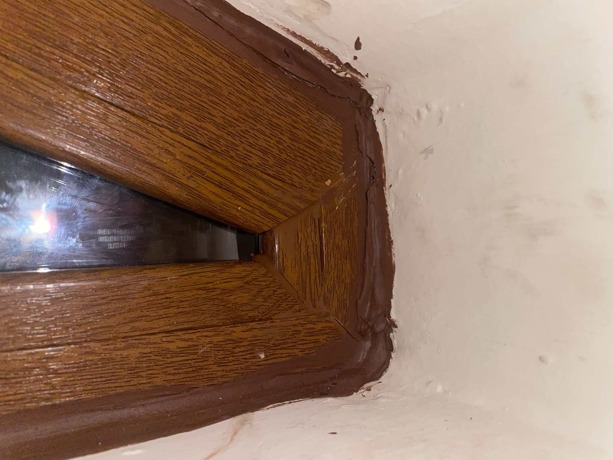

  5. On the small angle, they have cut the bead to short and filled with silicone.

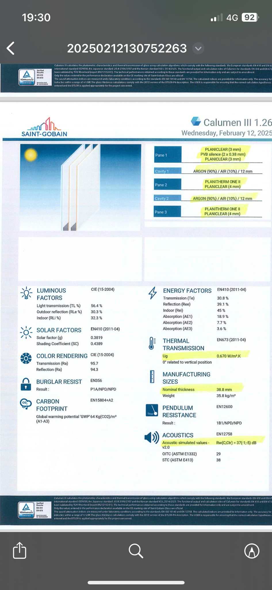

(0.675 U value)
Really?
I realise that's glazing only but even that seems low if it's a 28mm unit. Is it, or have they used a smaller bead to give you a bigger rebate? (I know you can do that with Rehau 'double glazing' frames, up to as wide as 44mm - although someone from GBF who has done so said the tiny bead is a real bu**er to get in and out).

Thanks, I should've mentioned at the top of the thread. These are 38.8mm units. The older double glazed were 28mm. They used lower profile triple glazed beading to accomodate.
make up of the triple glaze unit is 6.8mm lami at the front, 12mm cavity, 4mm planitherm one, 12mm cavity, 4mm planitherm one
Yeah, sorry I should've said in the thread at the top, these triple are 38.8mm thickness. Lower profile beads were used to accomodate the thicker units..... that's why im really shocked im not seeing an improvement here, original double glazed units were 28mm.
6.8/12/4/12/4
Spec sheet attached.

1. I hope not, I seem to recall the fitters on the day saying "there's a 20mm gap at the top" on one of the windows" which to my untrained ear sounded alot. I assumed they should overlap with the gaskets by 8-10mm?   i'm going to enlist someone independent and experienced with triple glazing to cast their eye over this.
2. Apologies, I should've laid this out in the thread. Original double glaze was 28mm. This acoustic triple is 38.8mm (6.8/12/4/12/4) The acoustic lami is on the outer and the two other pieces are planitherm one. Frames are deckeuninck 2500 type. We used a lower profile deceuninck bead to accomodate the thicker units. As recommended by deceuninck.
3. Not sure if gasket is meeting the frame, i'll need someone to confirm that. I think it is glazing foam as i found some of it on my drive that was identical in colour. Maybe it's been squished down loads.
4. same, not sure if gasket is meeting. But most of the beads are nice and tight, it's only a handful that have this much play in them, so confused at the inconsistency. Unless the glass hasn't gone in straight. I.e meets the top gasket but not the bottom one, etc.
5. Yeah so on this, I suspected as much, however I have noticed that shaped piece of glass has been either fitted off centre, or wonky. The shape is a triangle, but i can see the tip of the tringle of the unit is about 4-5mm offset to the left. So looks like maybe this piece is too small. I'll need someone to confirm this too.

Update on this one - Glazier returned, accepted there's a problem on point 1 and point 5
New piece of glass required for point 5, and will use bigger packers on the other.
