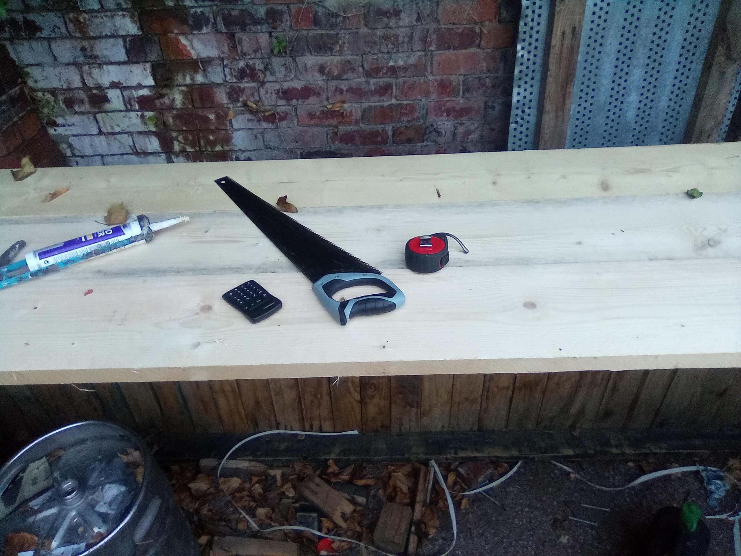

lord mud of the flyes Posted June 9 Author Posted June 9 14 hours ago, SteamyTea said: Various finished on scaffold planks. How do you get them to lock into each other?
SteamyTea Posted June 10 Posted June 10 5 hours ago, lord mud of the flyes said: How do you get them to lock into each other Think they were just PVA glued and clamped.
Onoff Posted June 10 Posted June 10 7 hours ago, lord mud of the flyes said: I just see photos of what it is like when its done, but no actual photos of it being done https://www.google.com/search?client=ms-android-motorola-rvo3&sca_esv=ba2fc44af14fa769&sxsrf=AE3TifNjjaYskm3X_Q1rdLG04dIu6CeBwQ:1749535608560&udm=2&fbs=AIIjpHyTFN8BbSyNXQ3oA-fn7H5NUrrIpQXg7ywPuzBdcoqHY9koTyP2YoWqyTioW_DKM8fobnJ8kSXcS-XenzerWcPYEnt5Dp_oGyUscMS1k34-PyVH9v9RTMDmwCCnRZ71tcE_ExHgZKxB6YZHBp2ZBdd6_ppUf3sKj9gimEVfd3oeMPDUPIhAJ9N0yYxy8EO4JYexJUDL5xp6Ay7m9Ho79V73SfPywo5QLXvZ2fTV53LiA79JZhI&q=biscuit+joining+scaffold+boards&sa=X&ved=2ahUKEwiImuGDmOaNAxWmzgIHHdFZFTcQtKgLegQIEhAB
Onoff Posted June 10 Posted June 10 https://www.ukworkshop.co.uk/threads/edge-joining-scaffold-boards.100370/
Onoff Posted June 10 Posted June 10 7 hours ago, lord mud of the flyes said: How do you get them to lock into each other? Many options: Biscuit joints or simply clamped - see my above two links. Or but a batten underneath and screw through.

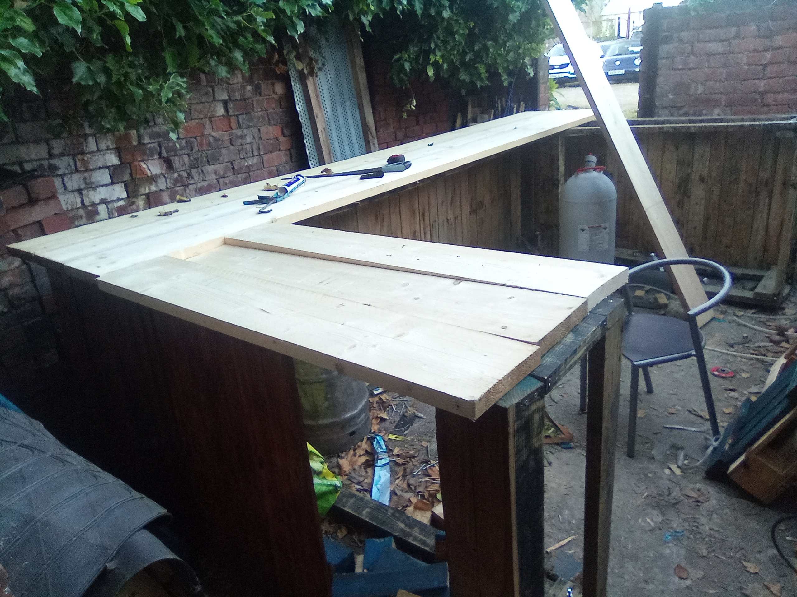

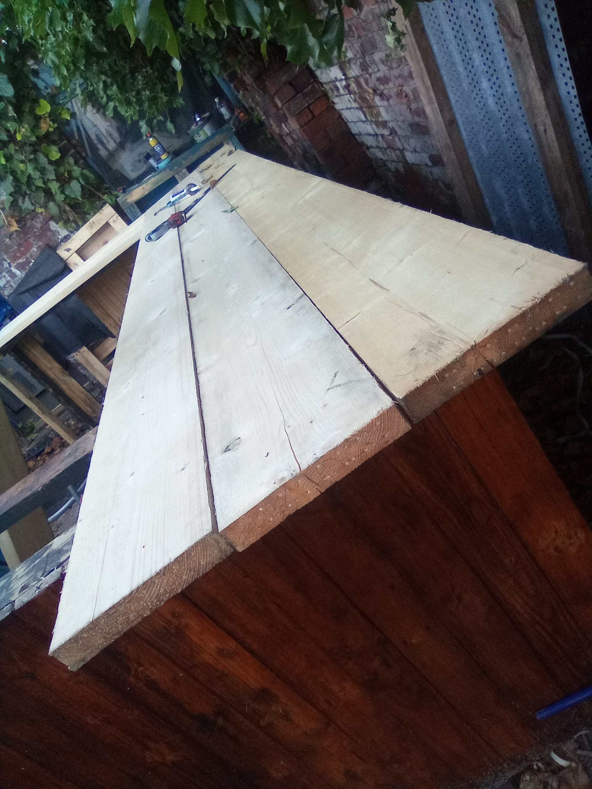

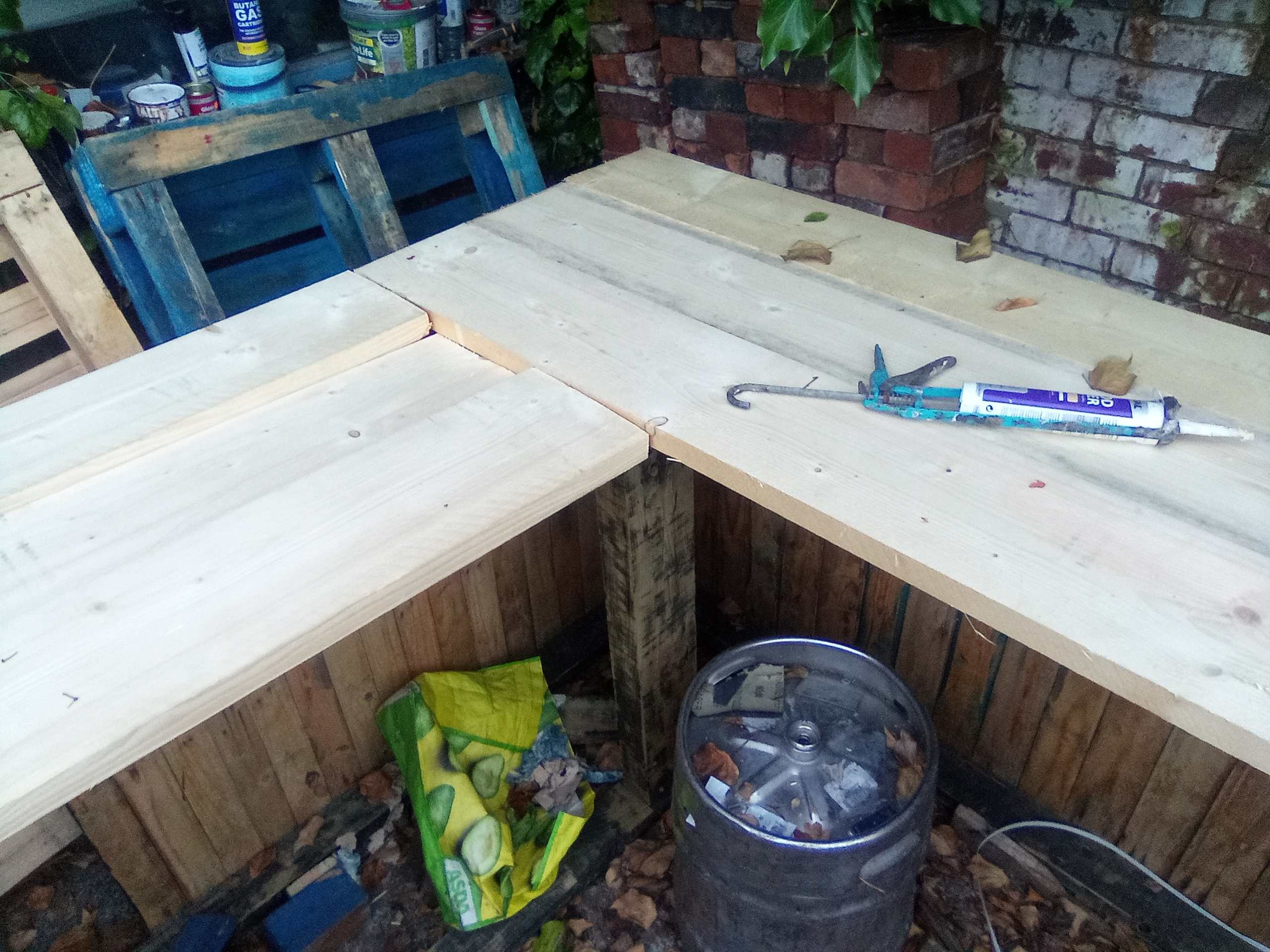

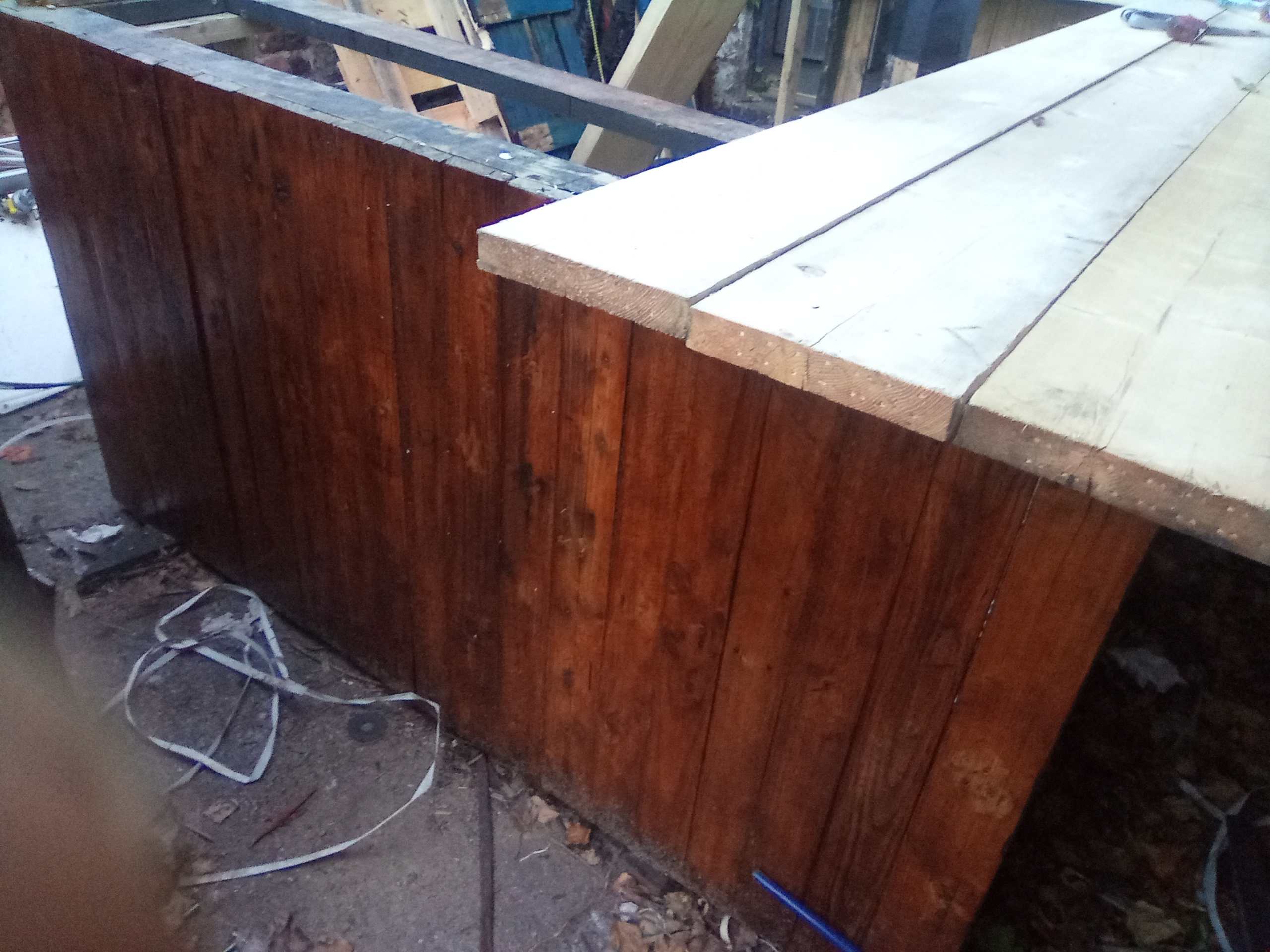

lord mud of the flyes Posted Saturday at 17:00 Author Posted Saturday at 17:00 (edited) So I bough 5x 13' scafolding boards (well they where 2" short of the 13' that they claimed!) Removed the metal platting on the ends Lined 3 up in a row at the front of the 12' long bar Cut 1 board into 3 pieces and placed it up at one of the corners of the bar So how can I join them together? I want to join them together and then dismantle and reassemble them as its a pop up bar. Is the "Biscuit Machine" no good for this, is the Biscuit Machine a perminent fixture? Some one surgested joining them with a place of metal underneigh, but not sure how this will work! Do you think coach bolts bolted to the frame will show up? The boards are new, do you think they need sanding or should I just paint them with the same stuff as the sides of the bar (Rustins stain, dark oak) Should I burn them first before painting? Edited Saturday at 17:03 by lord mud of the flyes
Onoff Posted Saturday at 17:05 Posted Saturday at 17:05 You could counter bore the tops a little and use coach bolts that would sit flush. Or just woodscrew through to a bit of timber running perpendicular and unscrew to dismantle.
lord mud of the flyes Posted Saturday at 17:10 Author Posted Saturday at 17:10 2 minutes ago, Onoff said: You could counter bore the tops a little and use coach bolts that would sit flush. Or just woodscrew through to a bit of timber running perpendicular and unscrew to dismantle. Would wood screws not show up and damage the threads that they have made in the wood from constant screwing and unscrewing?
Onoff Posted Saturday at 17:24 Posted Saturday at 17:24 11 minutes ago, lord mud of the flyes said: Would wood screws not show up and damage the threads that they have made in the wood from constant screwing and unscrewing? Depends how tight you do them up. You could use screw cups or as you said earlier, coach bolts. Do you really want to dismantle it into seperate boards?
lord mud of the flyes Posted Saturday at 17:58 Author Posted Saturday at 17:58 34 minutes ago, Onoff said: Do you really want to dismantle it into seperate boards? Yes it is a pop up bar and needs to be moved around in a van
