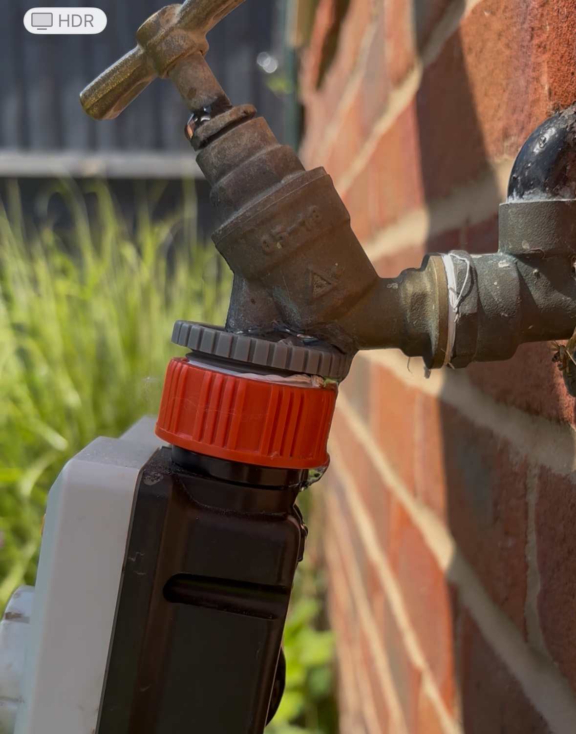

machtucker Posted May 11 Posted May 11 (edited) Good evening, I have an outside tap with a 3/4"thread. I'm trying to set up outside irrigation and the timer connector is 1". It comes with a 3/4" to 1" adapter which I thread on as far as it can go. The connector leaks and I initially thought i was a problem with the connector itself however on further inspection it appears the the connector is not screwing in far enough and mating with the washer/seal because it is hitting the underside of the tap (see picture). Is there a shallower adapter I could use? Seems to be a bit limiting if the tap is so poorly designed you can't use standard fittings? Any help would be appreciated. Many thanks, E Edited May 11 by machtucker
machtucker Posted May 11 Author Posted May 11 1 hour ago, dpmiller said: add another rubber washer Thanks I will try that

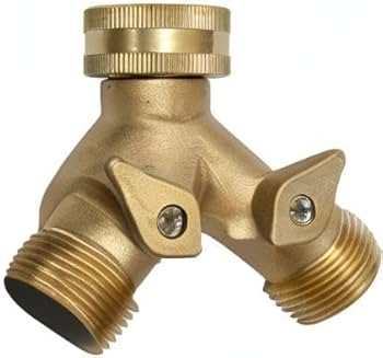

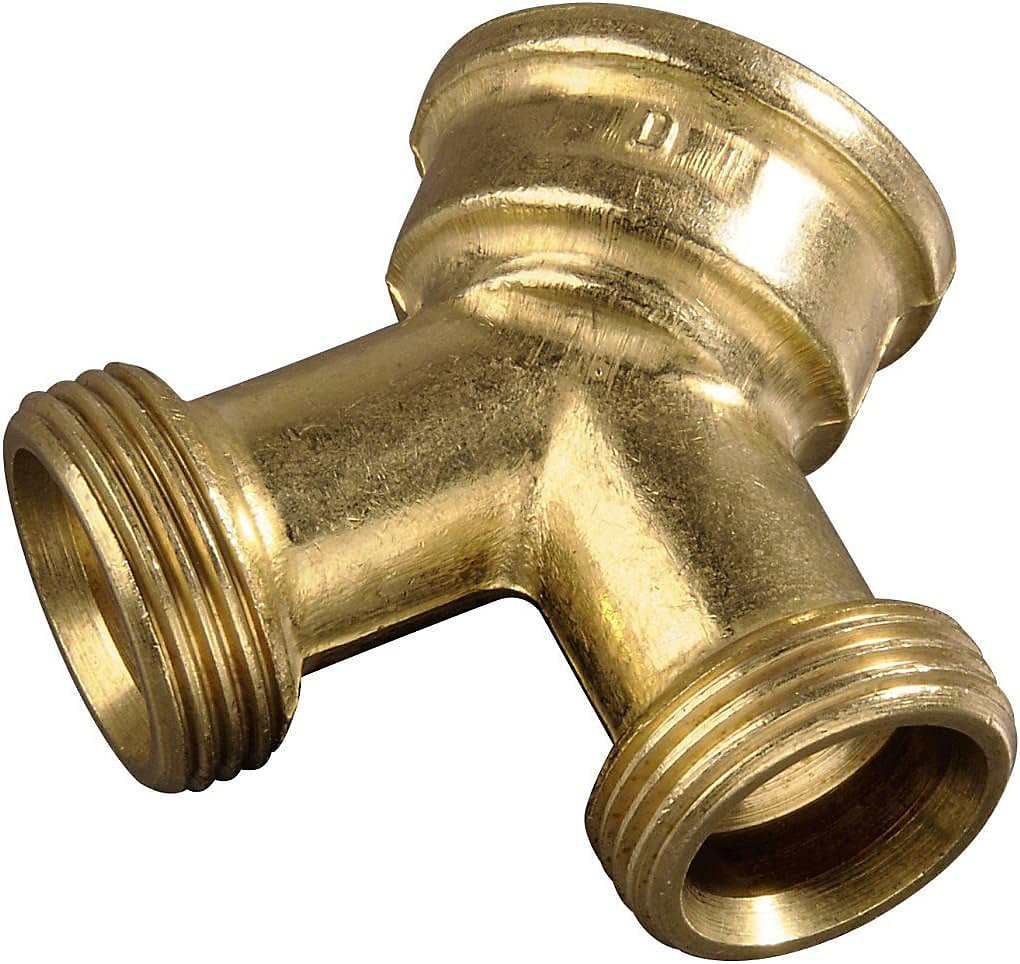

FuerteStu Posted May 11 Posted May 11 I've got an irrigation setup with similar timer. I used a splitter on mine, which allows me to still use the tap without disconnecting the system!
