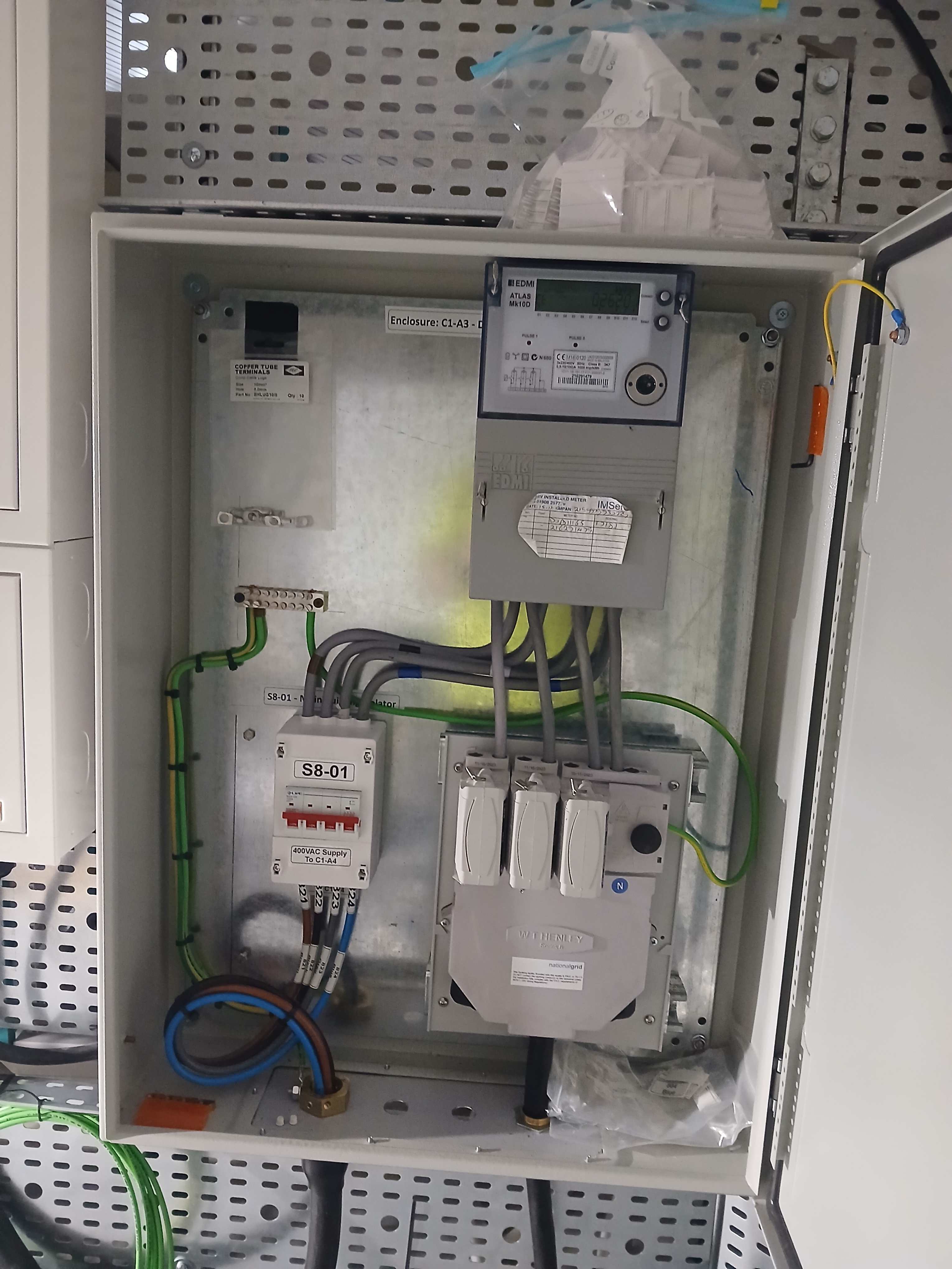

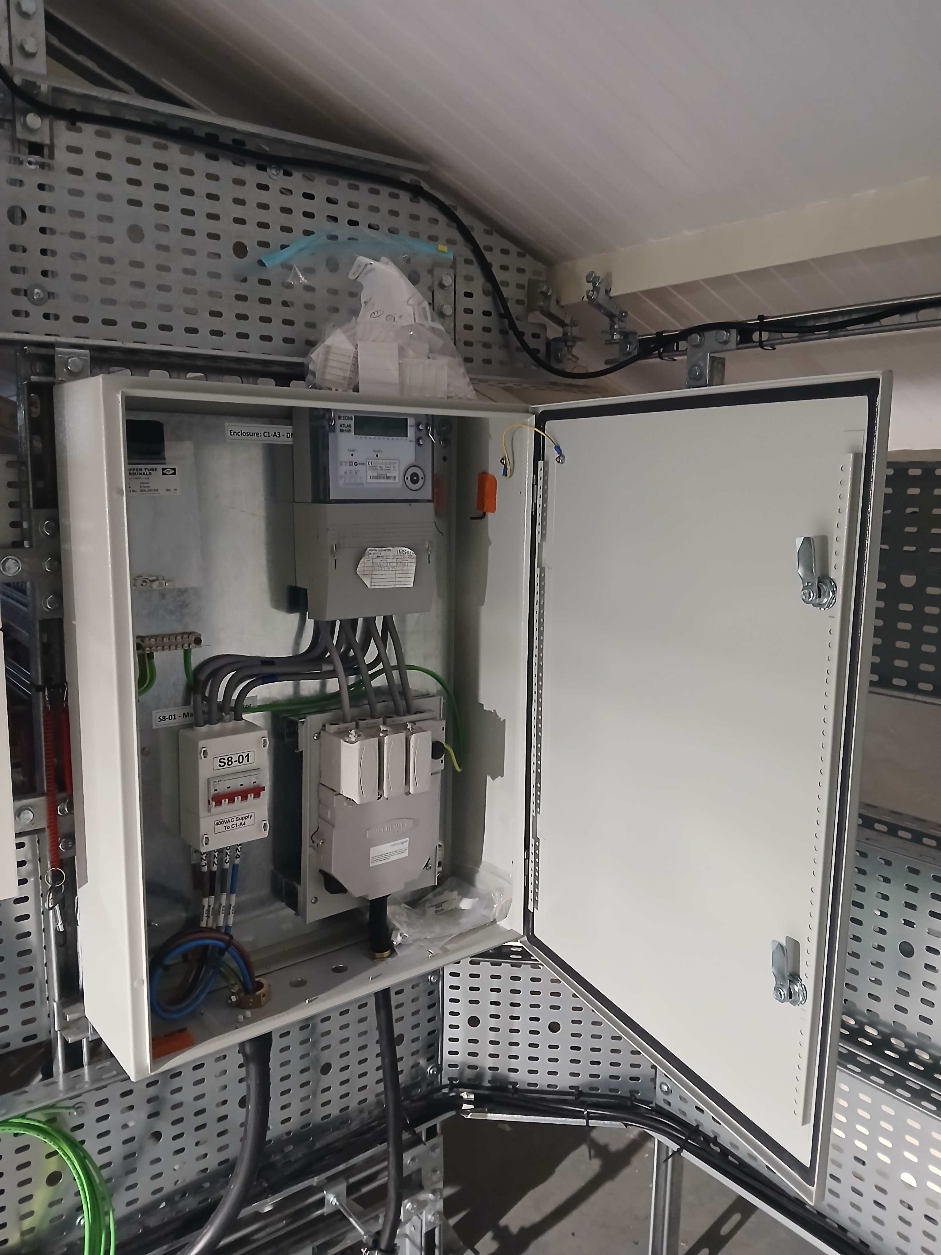

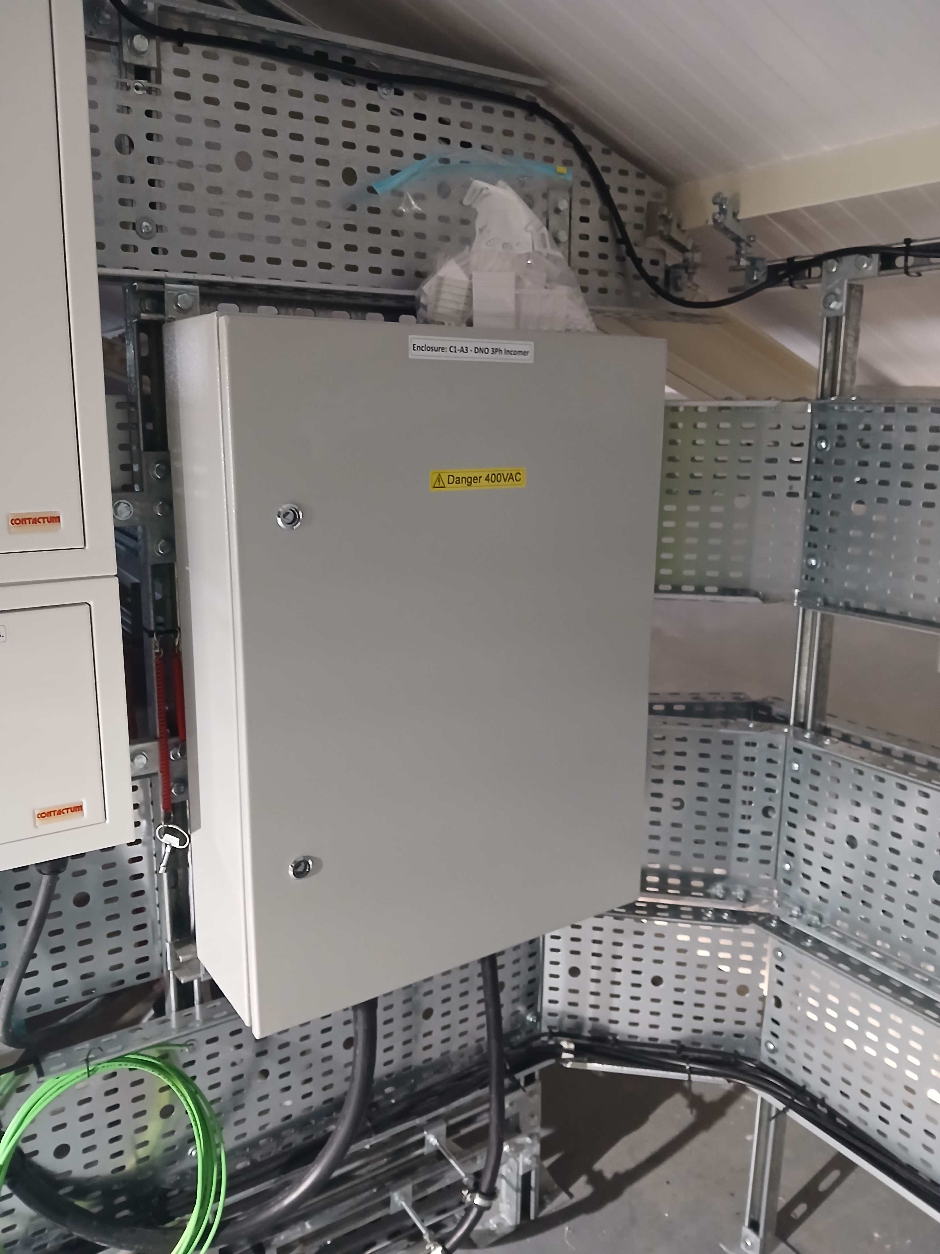

tuftythesquirrel Posted May 11 Posted May 11 Lets face it, the standard meter box is cr*p. A couple of years and the door hinges break, the door falls off and you can't replace it without smashing the old one to bits to get it off. Then you have to cut the back off the new one to fit it around the cut out. Even more problematic if it's recessed🤐. We have the cut out and meter in plant room, in an electrical enclosure, on Unistrut. I have an 3 phase old school RCAMY meter, due to be replaced with a (smaller) SMETS2 one. Will change the meter tails and put cable idents on when the new meter gets fitted. Am I the only one that labels every cable🤔 2
