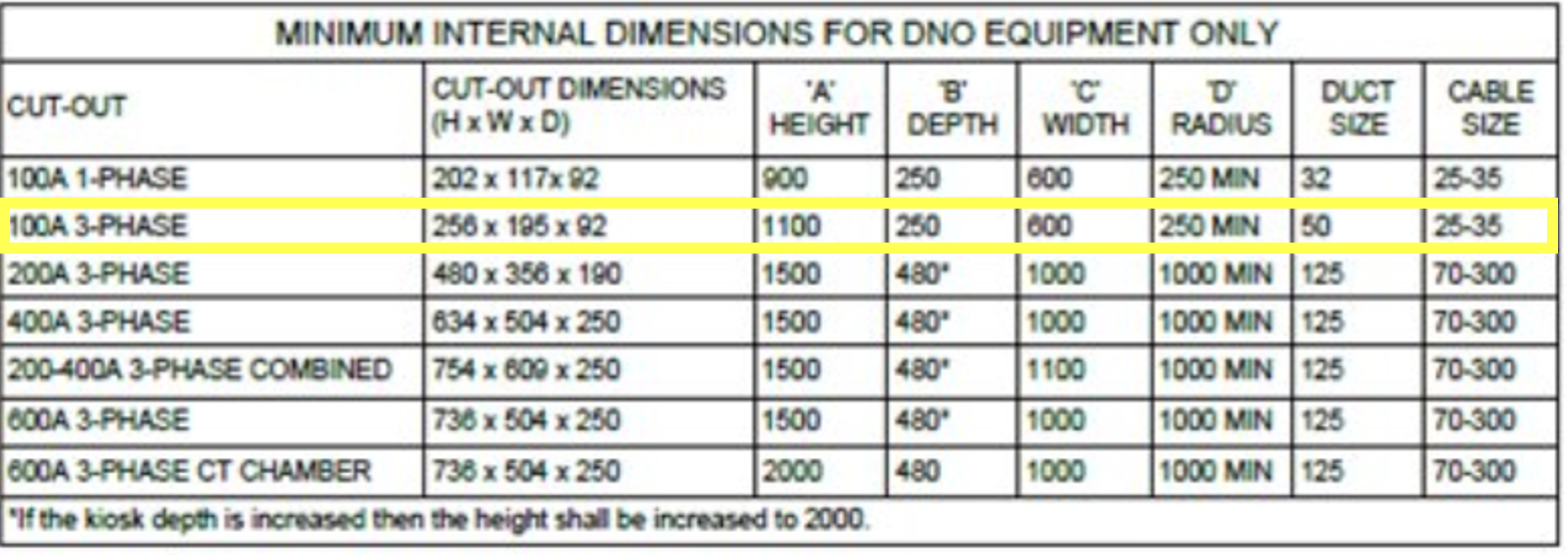

Can the DNO cutout be located inside?
This is what UK Power Networks specified for the connection kiosk:
UKPN required a much bigger box than needed.  Ours cost about £550 and was just for single phase. Useful storage though, all that unused space…

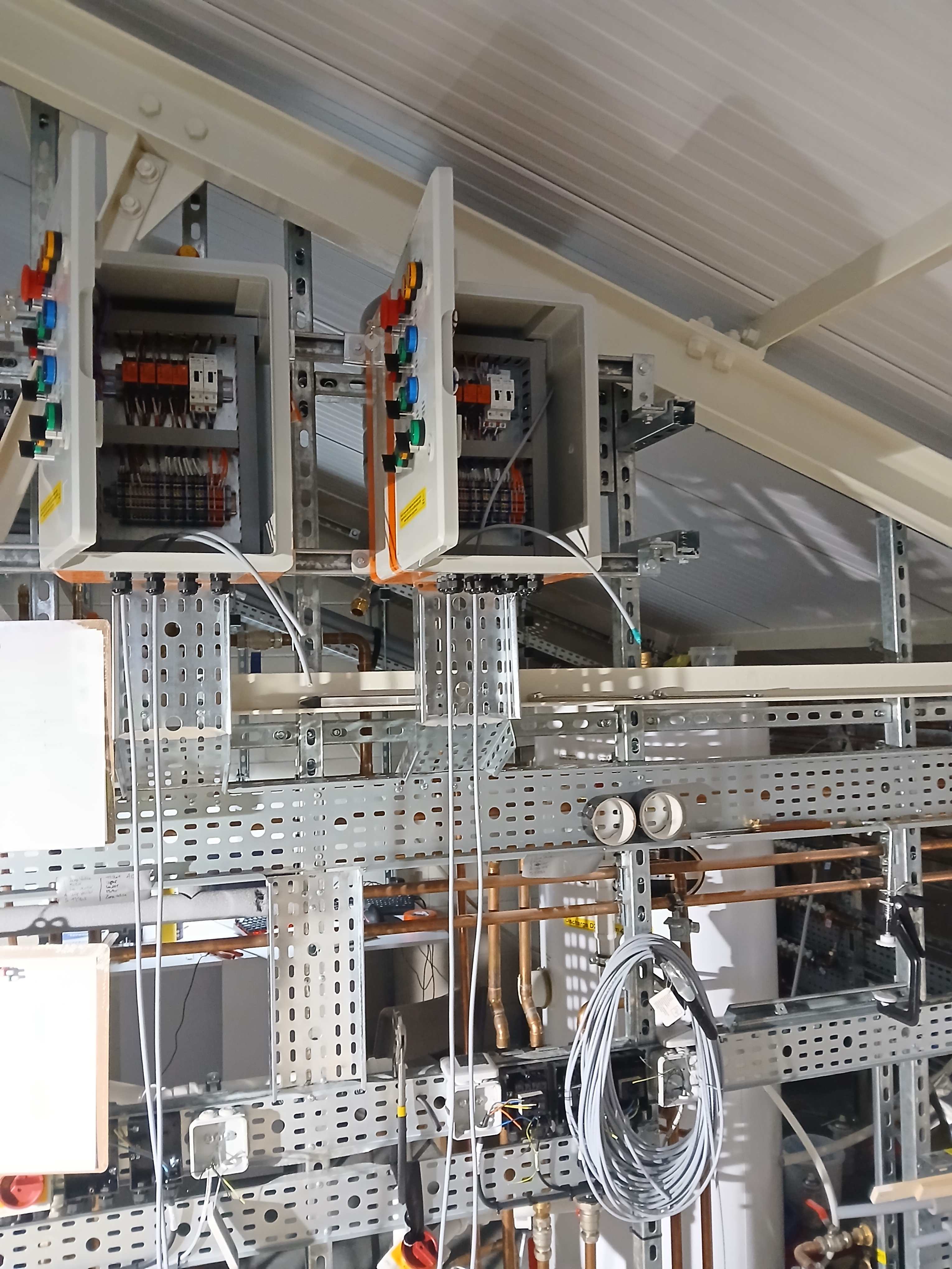

I recently tried to buy some tray and cable management, but @tuftythesquirrel had, apparently, bought the lot. 😌😜😜😜
@Nickfromwales Sorry about that, once I started I just sort of got hooked! Ended up doing the rest of the plant room and the open plan kitchen/diner (industrial coffee shop vibe, I am told). Fairly sure it’s back in stock now 👍
I thought we were close....but now I feel like I don't know you at all. You stole my OCD, and all the tray, the damage is done. 😭
