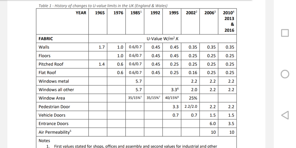

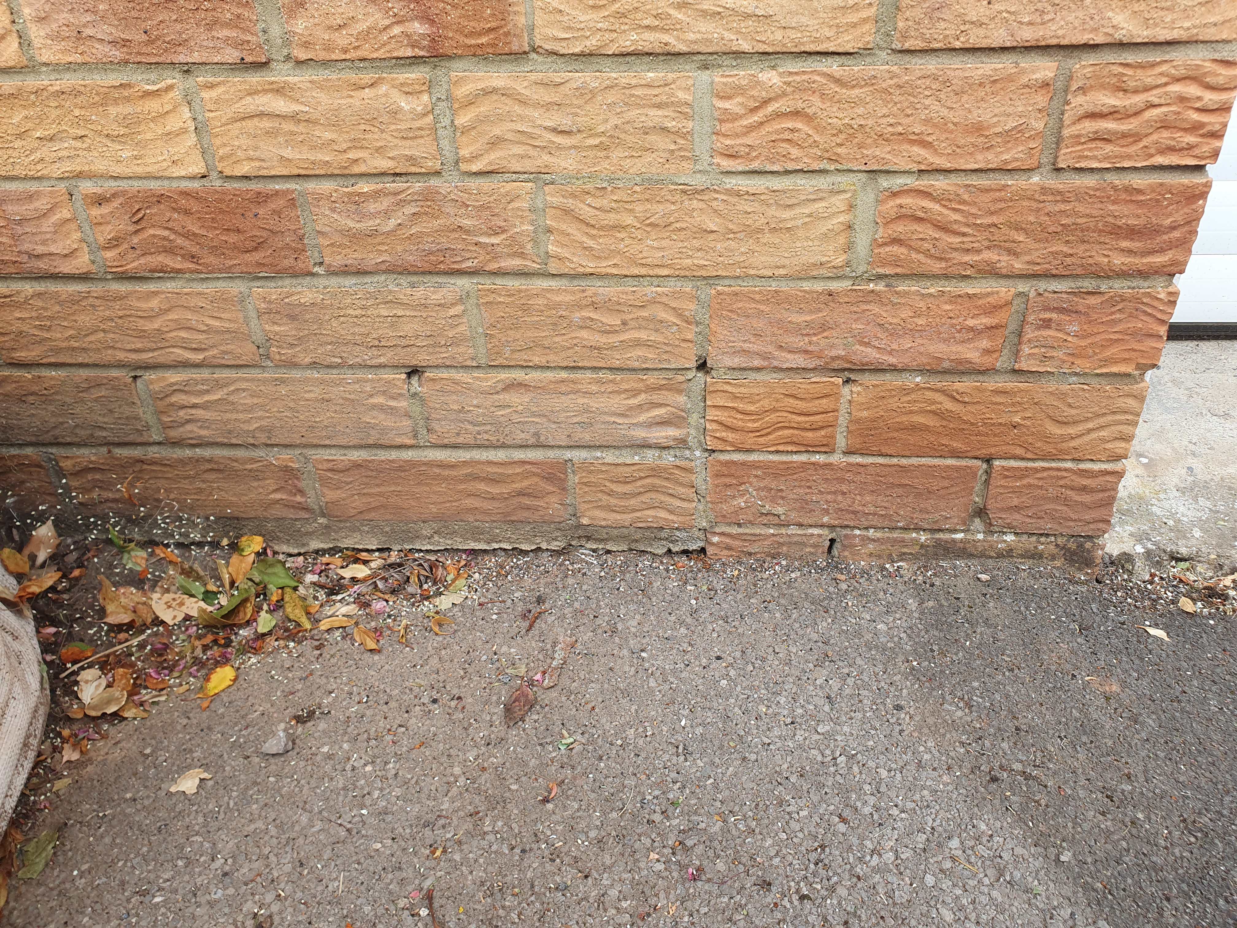

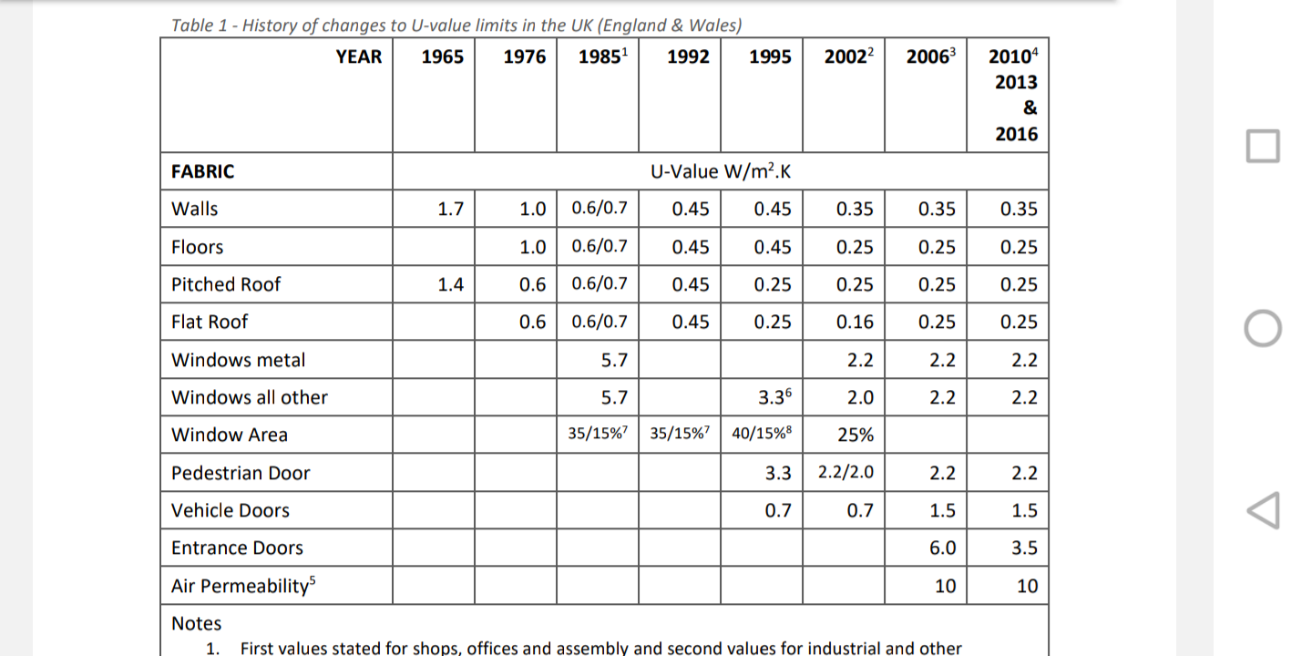

gambo Posted May 10, 2025 Author Posted May 10, 2025 Just a random thought, could it be that there is no insulation in my concrete in either of rooms (late 80s house) but the reason it feels cold in the garage conversion is due to cold bridging from either the other garage or driveway?
gambo Posted May 11, 2025 Author Posted May 11, 2025 That's a photo of bricks under window of the garage conversion
SteamyTea Posted May 11, 2025 Posted May 11, 2025 14 hours ago, gambo said: Just a random thought, could it be that there is no insulation in my concrete in either of rooms (late 80s house) A good thought. This is how insulation has changed over the decades.
