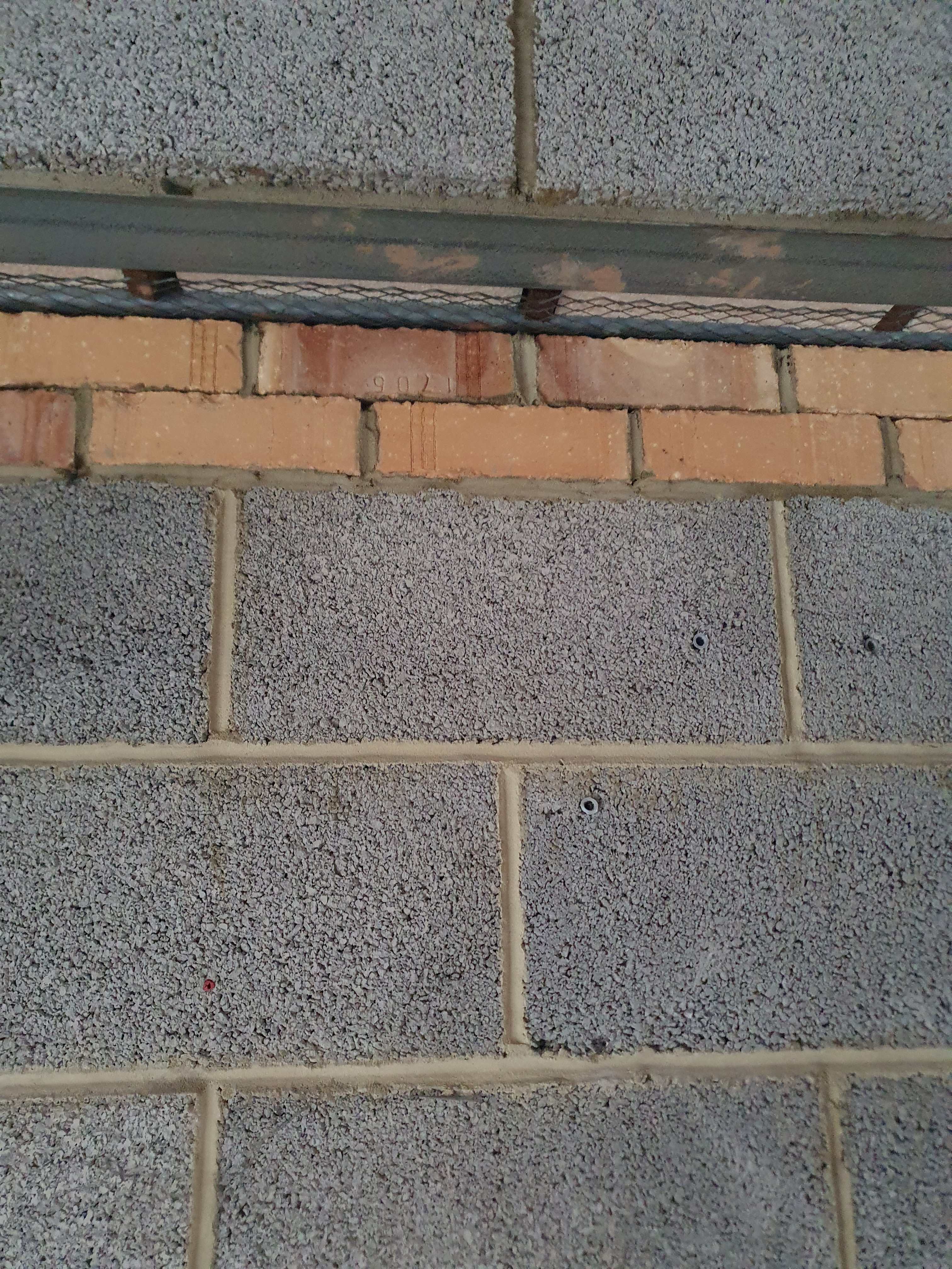

gambo Posted May 8 Author Posted May 8 Apart from the cold floor, how can I fix this room? There will be a lot of mess done in that room so I don't mind redoing some of the work but have no idea what the actual issues are. Regarding the floor, what am I looking for when drilling?
Nickfromwales Posted May 8 Posted May 8 15 minutes ago, gambo said: Apart from the cold floor, how can I fix this room? There will be a lot of mess done in that room so I don't mind redoing some of the work but have no idea what the actual issues are. Regarding the floor, what am I looking for when drilling? What is that a pic of? Looks a lot like a wall….?
gambo Posted May 8 Author Posted May 8 Yes, thats how the wall of that room looks like inside the garage.
Nickfromwales Posted May 8 Posted May 8 15 minutes ago, gambo said: Yes, thats how the wall of that room looks like inside the garage. That should all be dressed in with 2 layers of FR PB. Defo done off the radar!
gambo Posted May 8 Author Posted May 8 There is PB inside but I would be surprised if it was 2 layers or FR. So, is there any for-dummies description how such conversions should be done? I get that fire resistance is important so that's something I would rectify. What about floor? If it's just concrete on top of concrete shall I try to skim it and/or put VIP insulation +6mm cement board/plywood + engineered wood? What can LA say if I go for retrospective permission given it's 30yo?
