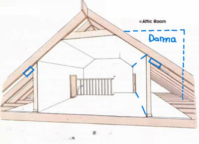

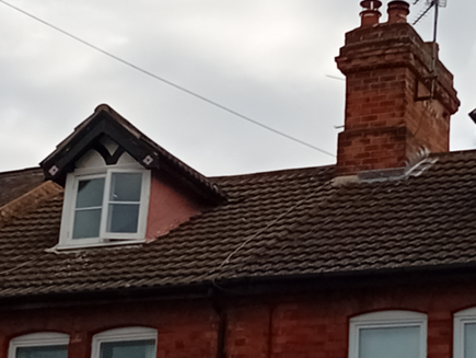

I plan re-slating the roof (currently large cement tile) on my mid-terrace victorian house & Building Control expect me at the same time to upgrade its thermal-element (insulation!) to meet their latest U-value requirements. I have only 75mm roof rafters; also, my (original,existing) attic room has an already limited height (pitched) ceiling so I'm already close to hitting my head as I enter the room from its stairs. A U-value calculation provided by Proctor Insulation suggests 60mm PIR between rafters then a further 65mm PIR + a VCL in 20mm cavity, ie totalling a basicallyunacceptable  additional 85mm on underside of the room's ceiling.
Can anyone suggest a way I could avoid my needing so much insulation on the internal side . . preferably without resorting to my having to add insulation above rafter, ie 'raising the roof' ? . . as this would be relatively impractical - since an adjoining neighbour's roof, 1 side, is 'integrated' with mine, our 2 roofs being as one . . . whilst a 'substantial' bonding gutter could be created at the perimeter with my neighbour to accommodate a higher roof/additional insulation, its likely expensive / might incur resistance from neighbour. Continues below:
              Existing attic room quite like this:                                                      Boundry of my roof runs down centre line of chimneys

I believe there is an exemption if its not practical to insulate to current standards. If really stuck I would try proposing something you find acceptable over the stairs an possibly thicker elsewhere?
Do you need the 20mm cavity for services? Perhaps look at insulated plasterboard for the inner layer saving 20mm? But check it includes a vapour barrier.
Various thicknesses...
