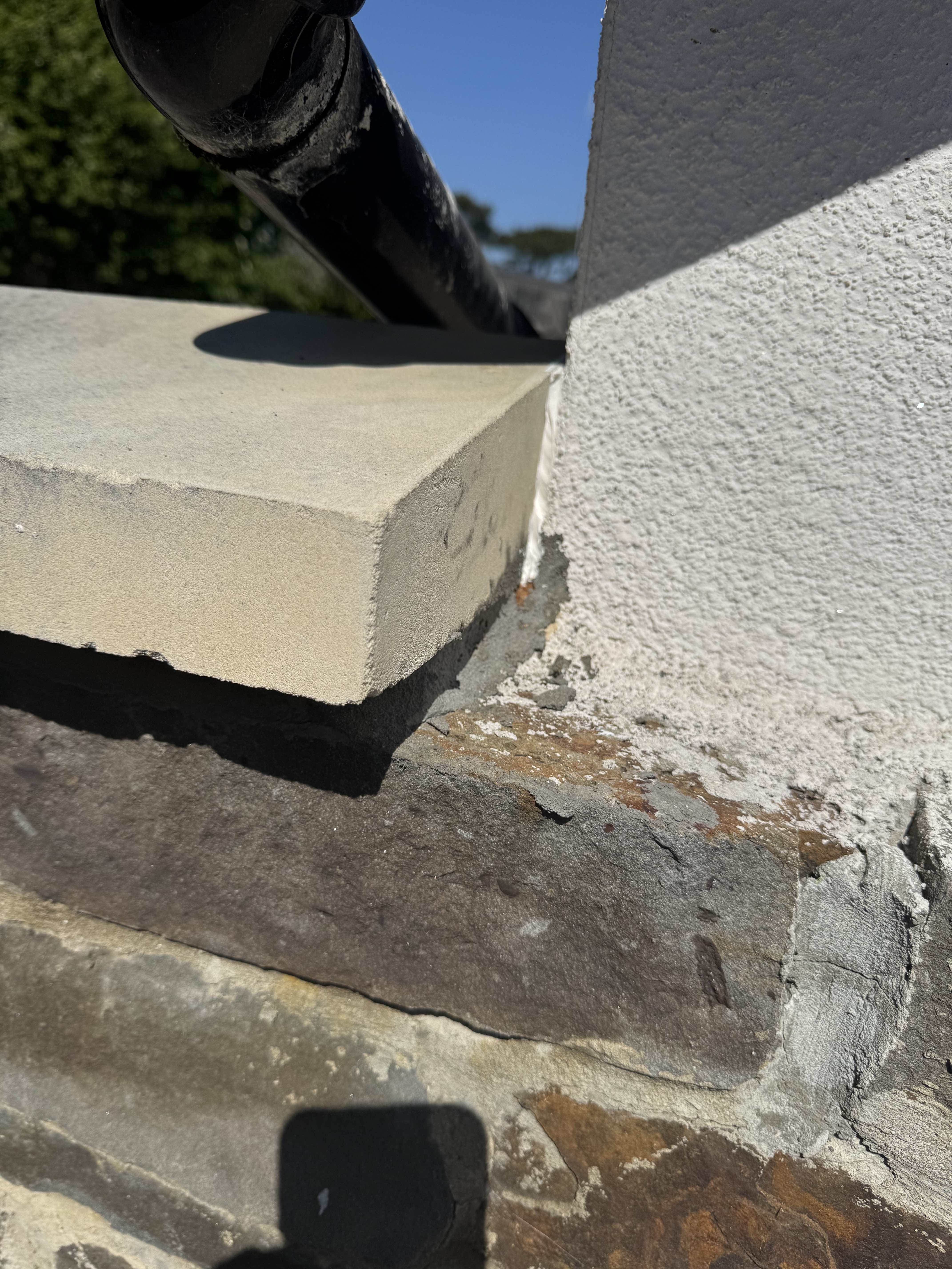

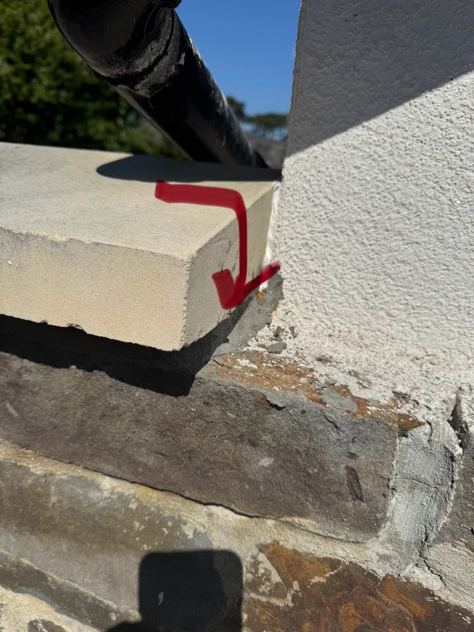

Pocster Posted April 30, 2025 Posted April 30, 2025 This is a question from my ‘that leak ‘ thread - but it’s a specific issue . I want to cap / flash the end of this twice weathered caping stone . Something malleable I guess ? . Want to completely cover it on the side and front edge . What’s best to use and how to apply it ?
Redbeard Posted April 30, 2025 Posted April 30, 2025 Lead, but do you think it's porous? If that were a cill I would not be expecting to have to clad it. What is the specific issue? (Sorry, perhaps have not read the 'that leak' thread closely enough).
Pocster Posted May 1, 2025 Author Posted May 1, 2025 10 hours ago, Redbeard said: Lead, but do you think it's porous? If that were a cill I would not be expecting to have to clad it. What is the specific issue? (Sorry, perhaps have not read the 'that leak' thread closely enough). I *think* rainwater is getting in under / around it . Have cemented any gaps I can find but would prefer a ‘cap’ to fully cover it and force water to run off it completely.

Pocster Posted May 1, 2025 Author Posted May 1, 2025 I hosed the other side of the coping but made sure some ran onto this side . It does seem to get across the drip channel . So I think I do need something covering this entire end and directing all water away .

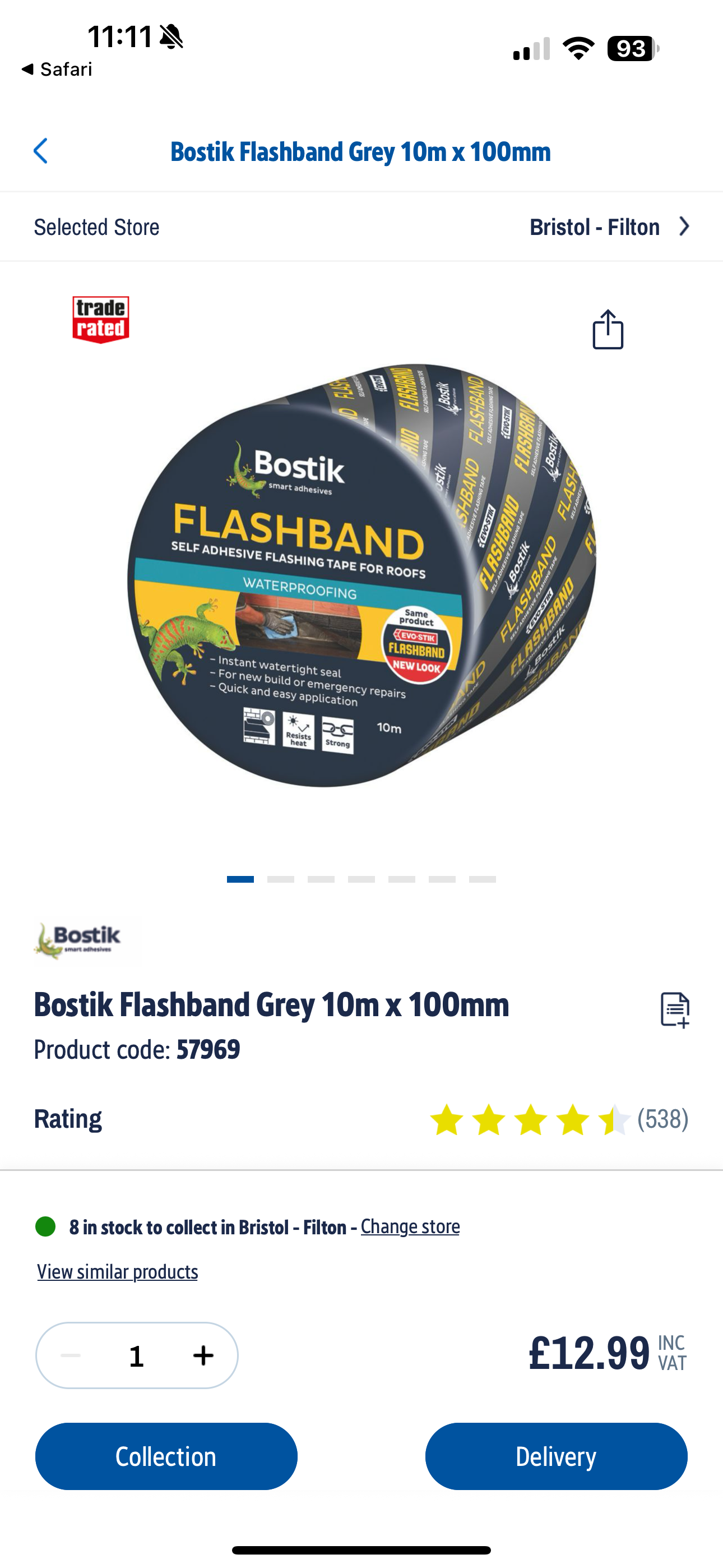

Redbeard Posted May 1, 2025 Posted May 1, 2025 Flashband or similar are good 'quick fixes'. They degrade fairly quickly, though TBF the last bit I used is still surviving in a 'second-hand' sort of way. The lead or alu could be 'permanent' (theft excluded!) 1

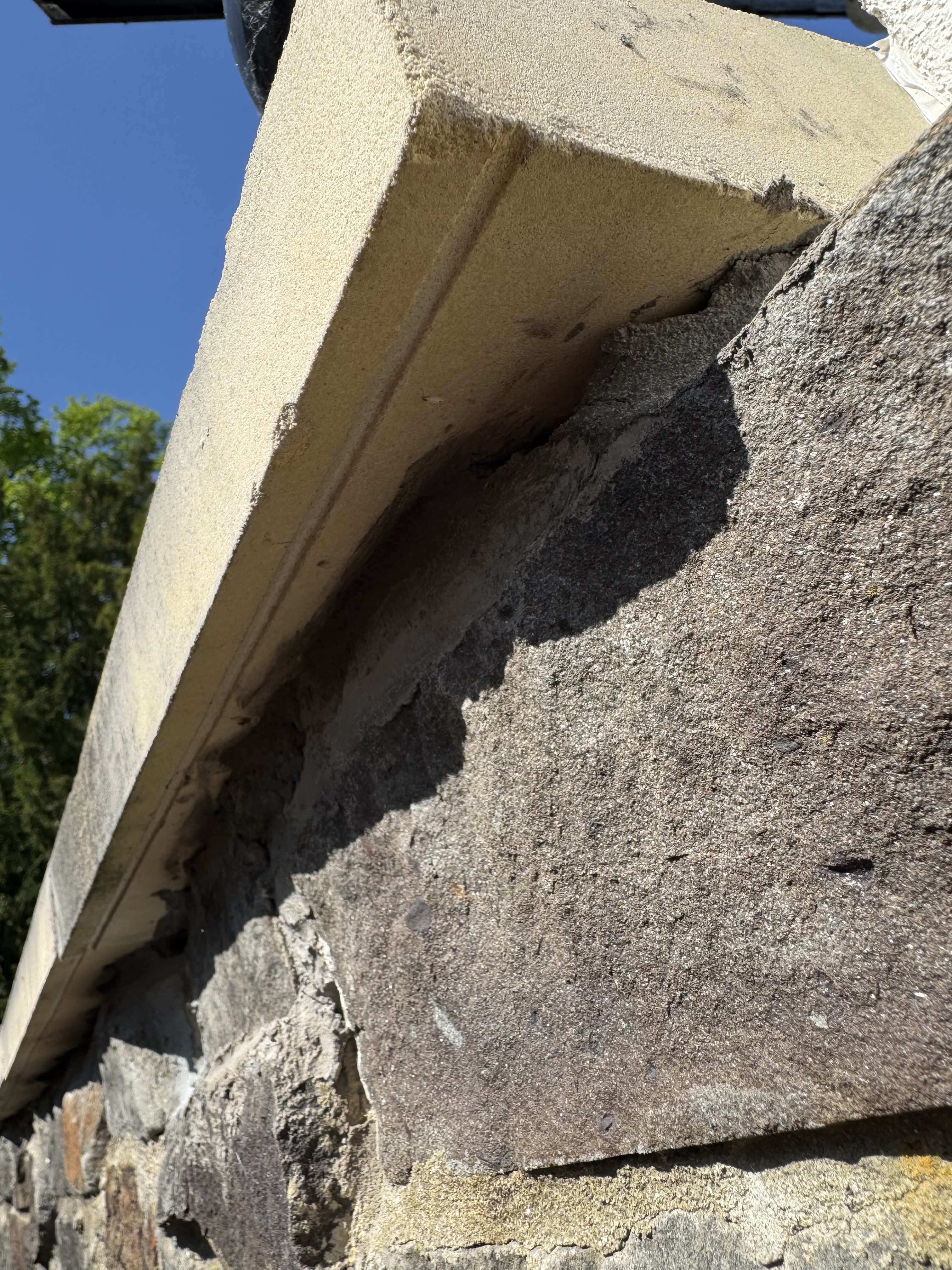

Big Jimbo Posted May 1, 2025 Posted May 1, 2025 Can you get a grinder in and make the drip channel, wider, and deeper ?
Pocster Posted May 1, 2025 Author Posted May 1, 2025 23 minutes ago, Big Jimbo said: Can you get a grinder in and make the drip channel, wider, and deeper ? I could do . Just assumed a ‘cap’ was better …
Big Jimbo Posted May 1, 2025 Posted May 1, 2025 The cap won't do any harm, but i'm not surprised that the water is crossing that drip strip. It looks very shallow, and narrow in that photo.
Pocster Posted May 1, 2025 Author Posted May 1, 2025 Just now, Big Jimbo said: The cap won't do any harm, but i'm not surprised that the water is crossing that drip strip. It looks very shallow, and narrow in that photo. Yeah - those copings were ‘ as supplied ‘ . I might deepen and widen the drip channel and cap the end . Too scared to not implement everything

bmj1 Posted May 1, 2025 Posted May 1, 2025 I have to say I agree: don't ruin it with the capping solution, get a grinder in and get that drip channel sorted !
Pocster Posted May 1, 2025 Author Posted May 1, 2025 (edited) 3 minutes ago, bmj1 said: I have to say I agree: don't ruin it with the capping solution, get a grinder in and get that drip channel sorted ! It’s at the end of the run and about 7ft up on a long skinny lane . So I’ll never see it . Just wanted a proper solution . Technically water could run over the side I.e bypass any drip channel , yeah ? Edited May 1, 2025 by Pocster
