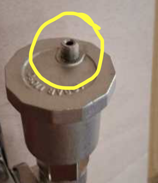

Nickfromwales Posted Wednesday at 08:00 Posted Wednesday at 08:00 55 minutes ago, Post and beam said: Not got this far yet. Only have the manifold and pipework. I am concerned that if the pressure falls further, or is considered too low now for whatever reason then can i still get the screed pour tomorrow. If not i need to call them off this morning. 27 minutes ago, Nickfromwales said: You’ve not answered about the cap on the bottle vent. Monsieur ?

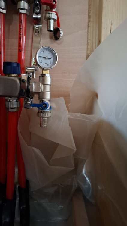

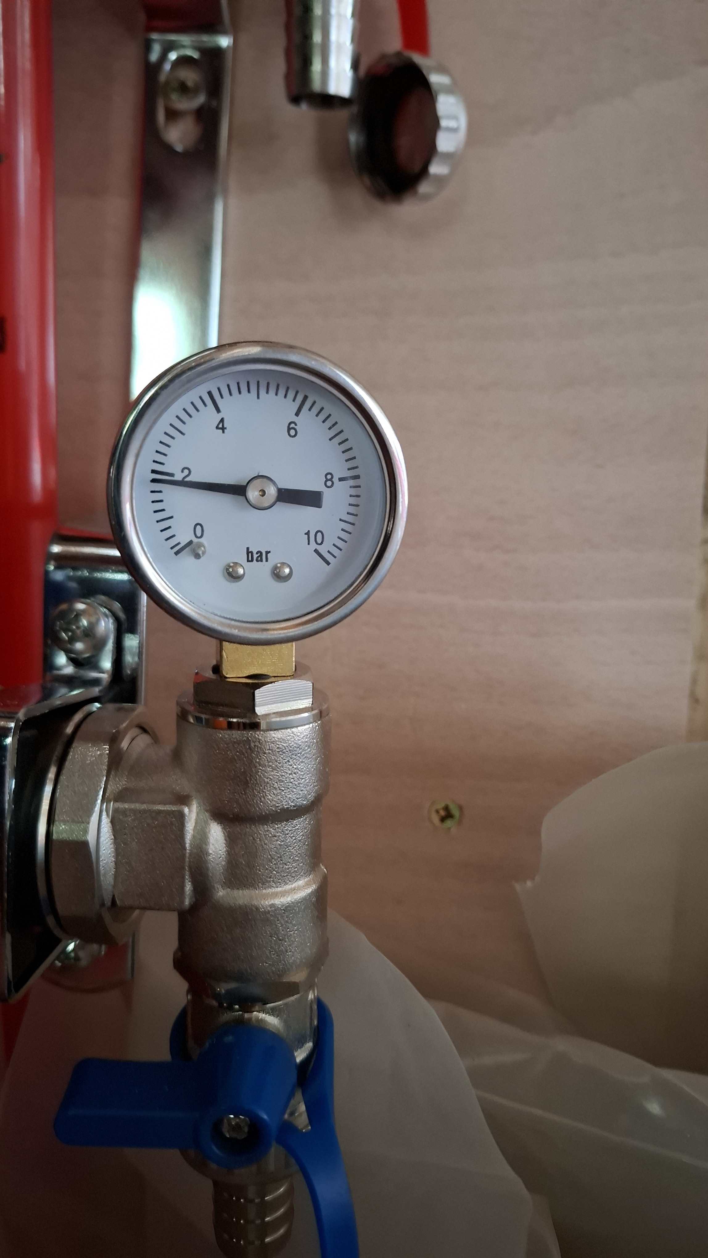

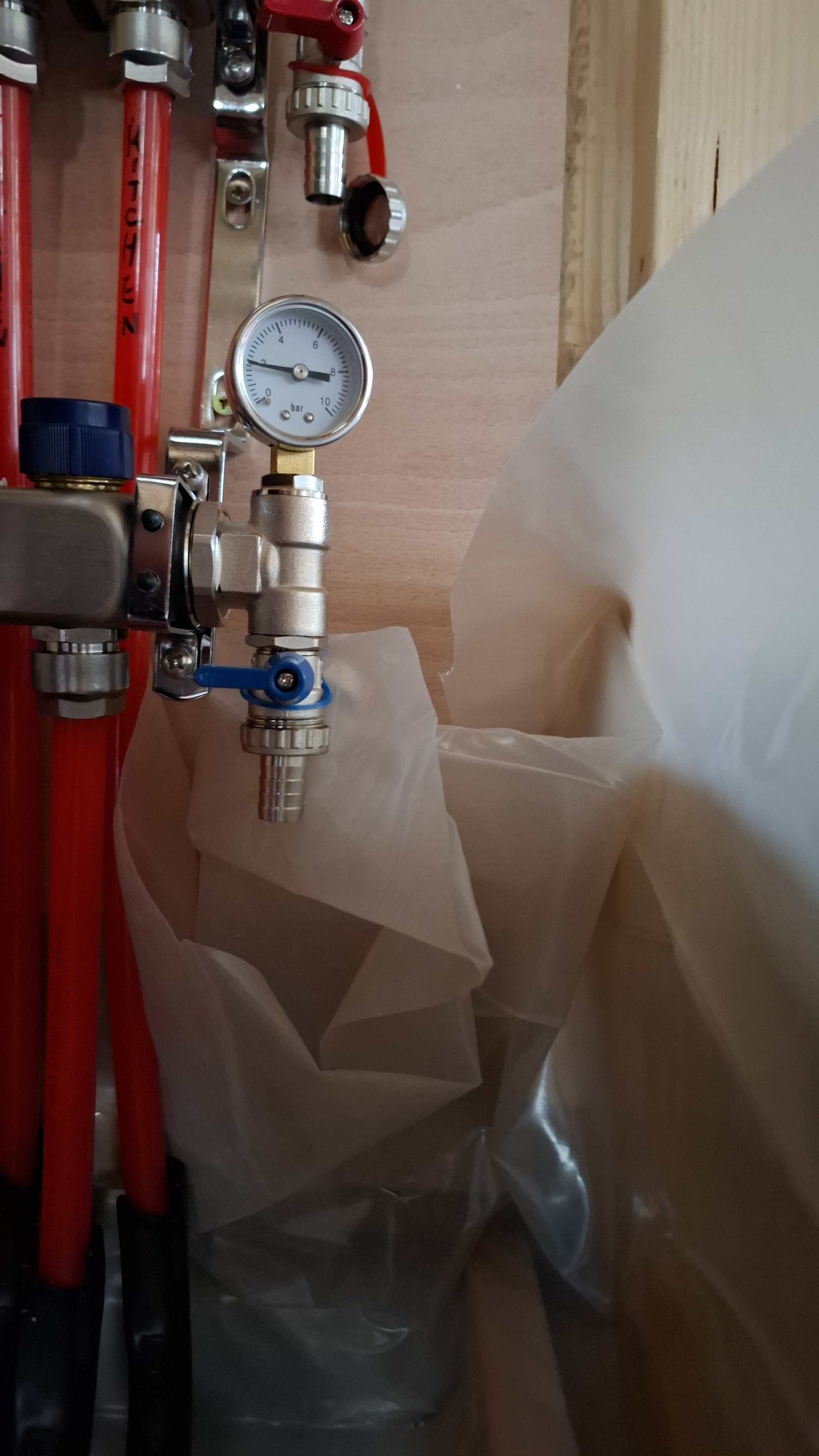

Post and beam Posted Wednesday at 09:21 Author Posted Wednesday at 09:21 This is the pressure today, very slightly up on the worrying lower figure yesterday. I dont think i have an issue do i? 1
JohnMo Posted Wednesday at 09:40 Posted Wednesday at 09:40 Pressure moves about with temperature change. You also get a drop in pressure as the air in the water comes out of suspension from the water. So you fill system, a while after you start to get a pressure drop (air coming out of suspension) then pressure moves about as ambient temp changes. Once water filled, the pipe will be almost impossible to crush.

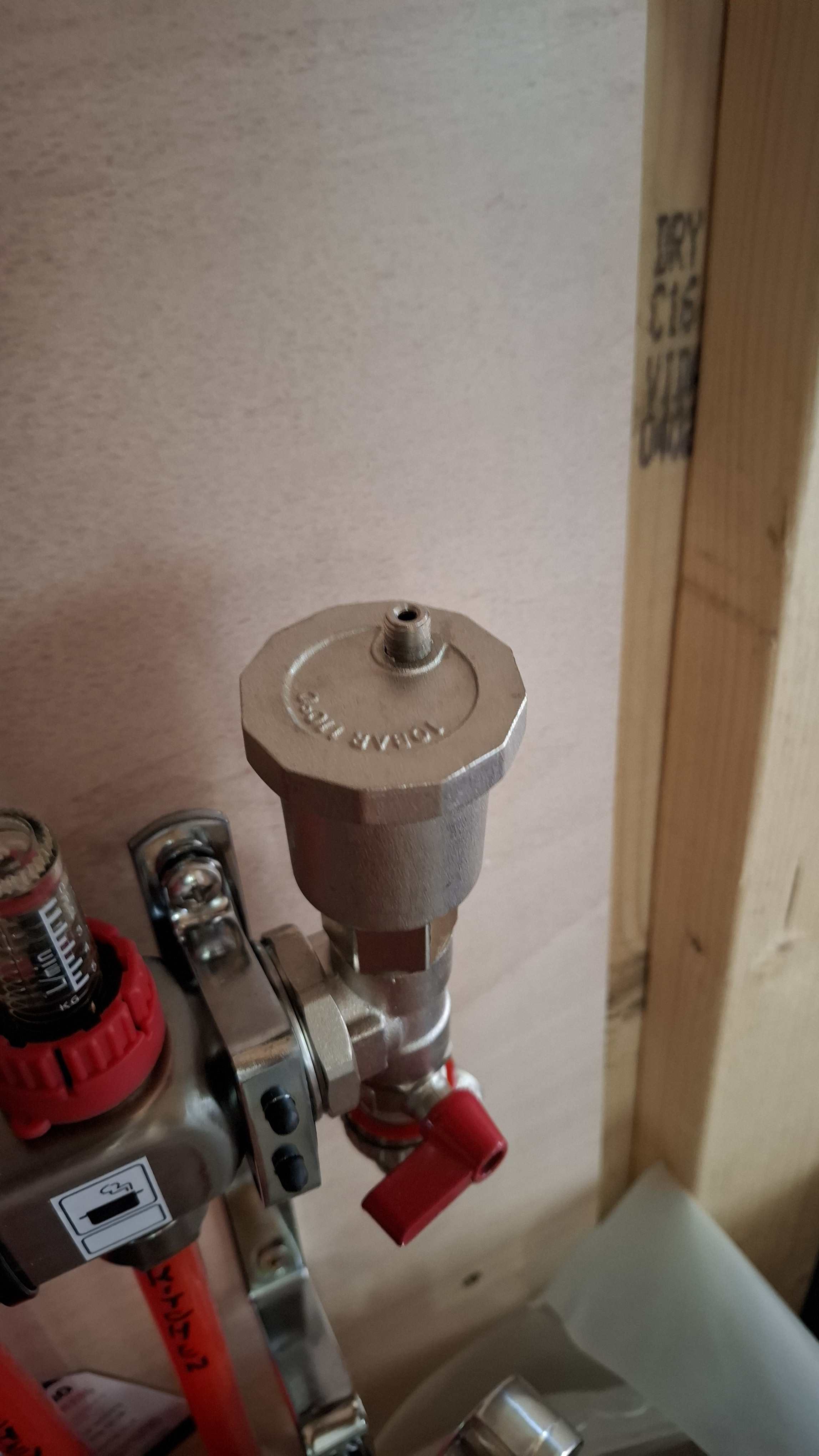

Nickfromwales Posted Wednesday at 09:52 Posted Wednesday at 09:52 28 minutes ago, Post and beam said: This is the pressure today, very slightly up on the worrying lower figure yesterday. I dont think i have an issue do i? Its just the water / pressure acclimatising, so no issue afaic. Theres supposed to be a duct cap on there to seal it off, when required, but also to prevent dust / crud getting in. The cap is only supposed to be opened until loose and then left in situ for life, vs removed completely. That vent would have come supplied with a metal cap, do you know where it is?
Post and beam Posted Wednesday at 10:21 Author Posted Wednesday at 10:21 Hi Nick, its there, i took it off to see what was inside and photographed it before i put it back on. 2 bar is good to screed over isn't it.
Nickfromwales Posted Wednesday at 10:24 Posted Wednesday at 10:24 2 minutes ago, Post and beam said: Hi Nick, its there, i took it off to see what was inside and photographed it before i put it back on. 2 bar is good to screed over isn't it. Cool. 👌. Yes, anything north of 1bar is ample.

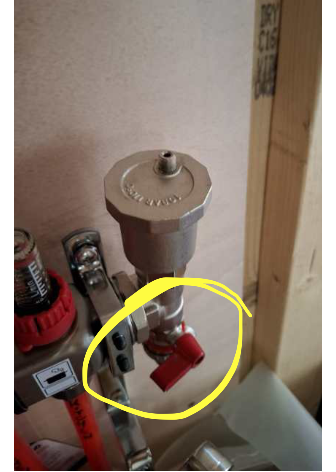

Post and beam Posted Wednesday at 21:52 Author Posted Wednesday at 21:52 I dont actually know what to 'open' to release pressure. Apologies for my ignorance
Nickfromwales Posted Wednesday at 21:57 Posted Wednesday at 21:57 3 minutes ago, Post and beam said: I dont actually know what to 'open' to release pressure. Apologies for my ignorance There may be a dust cap on that, but there’s your ‘drain’ point. Only apologise when you’ve done something wrong 😜.
