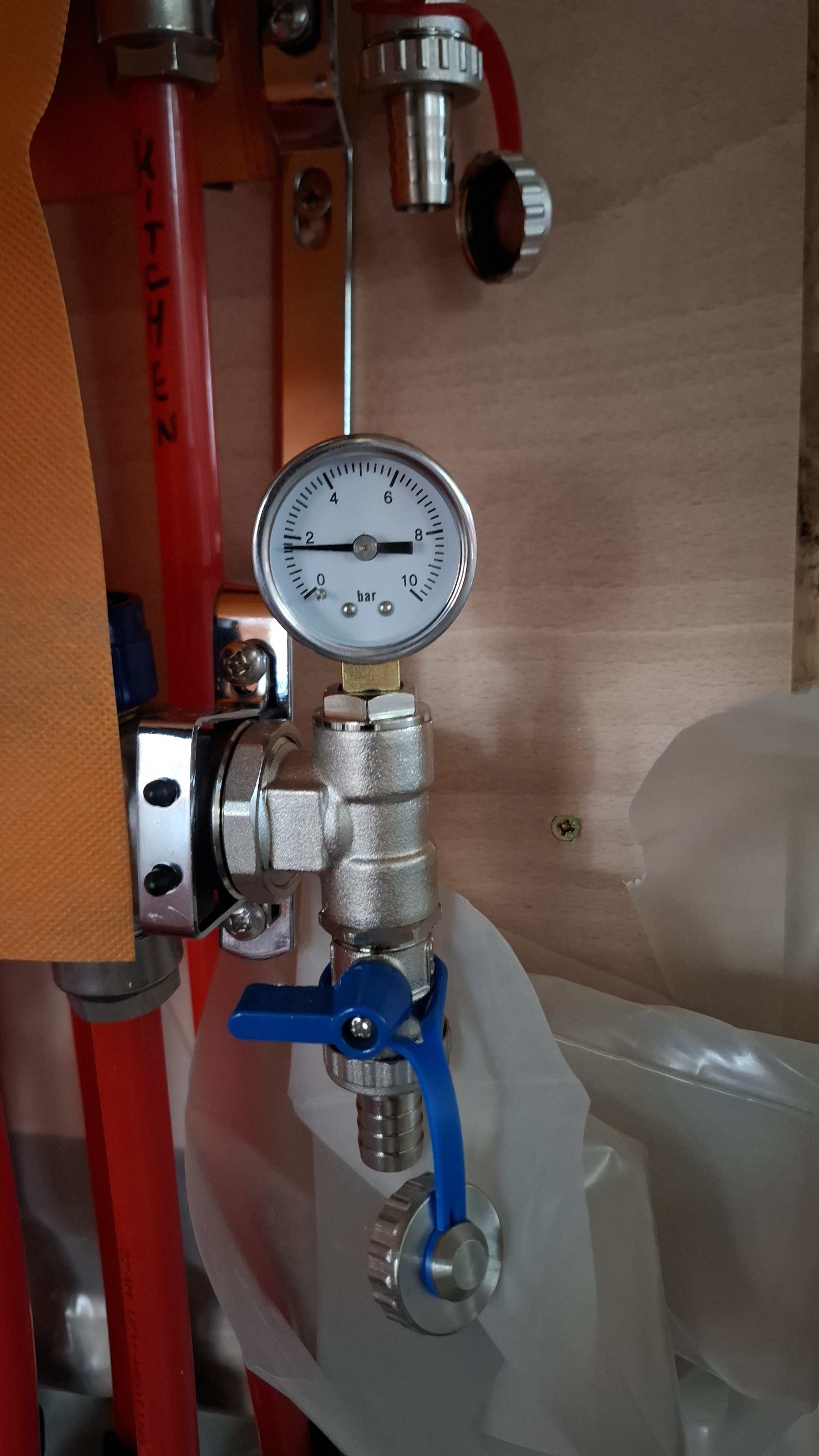

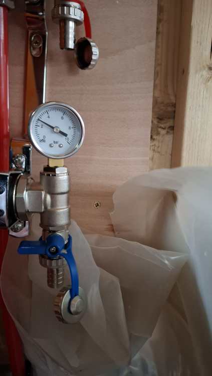

Post and beam Posted April 22, 2025 Posted April 22, 2025 I had the UFH pipes laid today, screed on thursday. So i thought i would do the sensible thing and take a picture of the pressure reading as soon as it was signed off. I had occassion to check it again 6 hours later and was very suprised and more than a little concerned to see the difference. And yet there is zero sign of a leak anywhere of course, everything is fine. I had imagined that ' make sure it maintains pressure' meant the same pressure. Yes , i know that temperature can make a difference and atmospherics but thats quite a percentage change in a few hours.

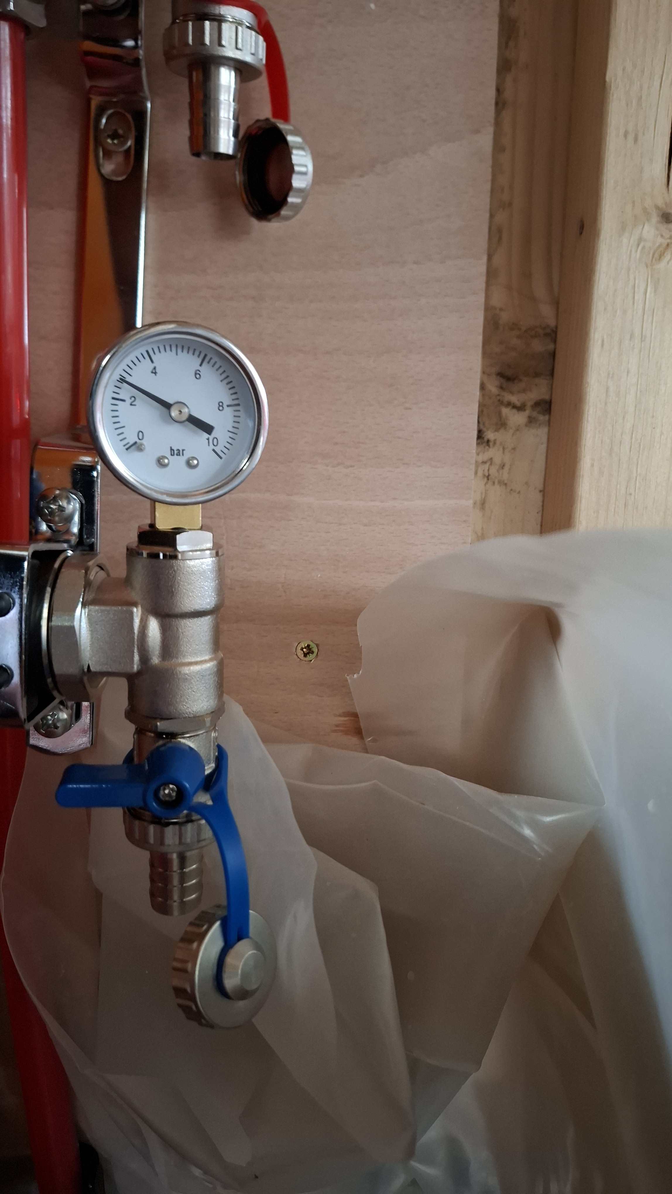

Nickfromwales Posted April 22, 2025 Posted April 22, 2025 9 minutes ago, Post and beam said: Nick i haven't touched anything That's the best reply any stranger can offer to a random guy on the internet at this time of night. Is the cap on the automatic air vent open or closed? It's the thing that looks like the air cap on a car tyre. Can we have a better pic of the whole manifold?
Post and beam Posted April 22, 2025 Author Posted April 22, 2025 1 minute ago, Nickfromwales said: Can we have a better pic of the whole manifold? I will check when i am on site tomorroe and take a picture. assuming i may not be able to get the installers back to site before the screeders arrive and also that there is in fact a problem. Can i resolve this myself ?
Nickfromwales Posted April 22, 2025 Posted April 22, 2025 2 minutes ago, Post and beam said: I will check when i am on site tomorroe and take a picture. assuming i may not be able to get the installers back to site before the screeders arrive and also that there is in fact a problem. Can i resolve this myself ? Let's be sure there's an actual problem first The biggest "oops" here will be a wet test done and then somebody simply forgot to pinch off the cap on the AAV. The air in the loops then rises to the manifold rail and ejects itself, resulting in a drop in pressure. If you had a significant leak there would be zero pressure on the gauge right now.

Conor Posted April 23, 2025 Posted April 23, 2025 If you've no expansion vessel, the slightest change in temperature or air escaping can make a huge difference to the pressure. Don't worry about it.
Bonner Posted April 23, 2025 Posted April 23, 2025 I agree, nothing to worry about here. Most likely a slight weep in a joint (if anything) and there shouldn’t be any joints in the screed! You might find the pressure shoots up after the screed is poured due to chemical reaction.
Post and beam Posted April 23, 2025 Author Posted April 23, 2025 59 minutes ago, Conor said: If you've no expansion vessel Not got this far yet. Only have the manifold and pipework. I am concerned that if the pressure falls further, or is considered too low now for whatever reason then can i still get the screed pour tomorrow. If not i need to call them off this morning.
Nickfromwales Posted April 23, 2025 Posted April 23, 2025 Has it been wet or dry tested? Have the loops been purged through, eg so all the air got blasted out? You’ve not answered about the cap on the bottle vent.

Nickfromwales Posted April 23, 2025 Posted April 23, 2025 1 hour ago, Bonner said: You might find the pressure shoots up after the screed is poured due to chemical reaction Yup. Ideally you should be opening a pipe to atmosphere immediately prior to the screed going down, as when you’ve got a gauge installed it will usually meet its maker when the pressure exceeds its max set point and the needle snaps off. If you need it all pressurised for the pour then you can just accept the cost of a replacement gauge if that happens, a tenner or two at most.

crispy_wafer Posted April 23, 2025 Posted April 23, 2025 keep them pressurised, but when it's walkable, just release some pressure as the heat from curing will cause what nick says.

Nickfromwales Posted April 23, 2025 Posted April 23, 2025 10 minutes ago, G and J said: Well in all my years I’ve never fitted an UFH manifold with a pressure gauge on it! Me neither, I always take out the pressure gauge and fit a second bottle vent in the hole. 2 minutes ago, G and J said: So it’s a good idea to maintain access to the manifold during the pour? Or extend a bit of push fit plastic pipe from the manifold to where you can access it without going full on Billy Elliot, with the gauge on the end of that, and a 1/4 turn tap to bleed off the rising pressure as the concrete cures.
crispy_wafer Posted April 23, 2025 Posted April 23, 2025 Just now, G and J said: So it’s a good idea to maintain access to the manifold during the pour? Mine was accessible, but then I was in with the screeders with my wellies on taking pictures and videos of the pour slopping around in it. It was only after a few hours when I went to have a look at my screed did I clock that the temperature had risen and I ought to check the ufh to double check we hadnt done any damage noticed the gauge was now at a higher bar number than I'd left it, so I cracked it a touch to relieve some pressure from the system.
