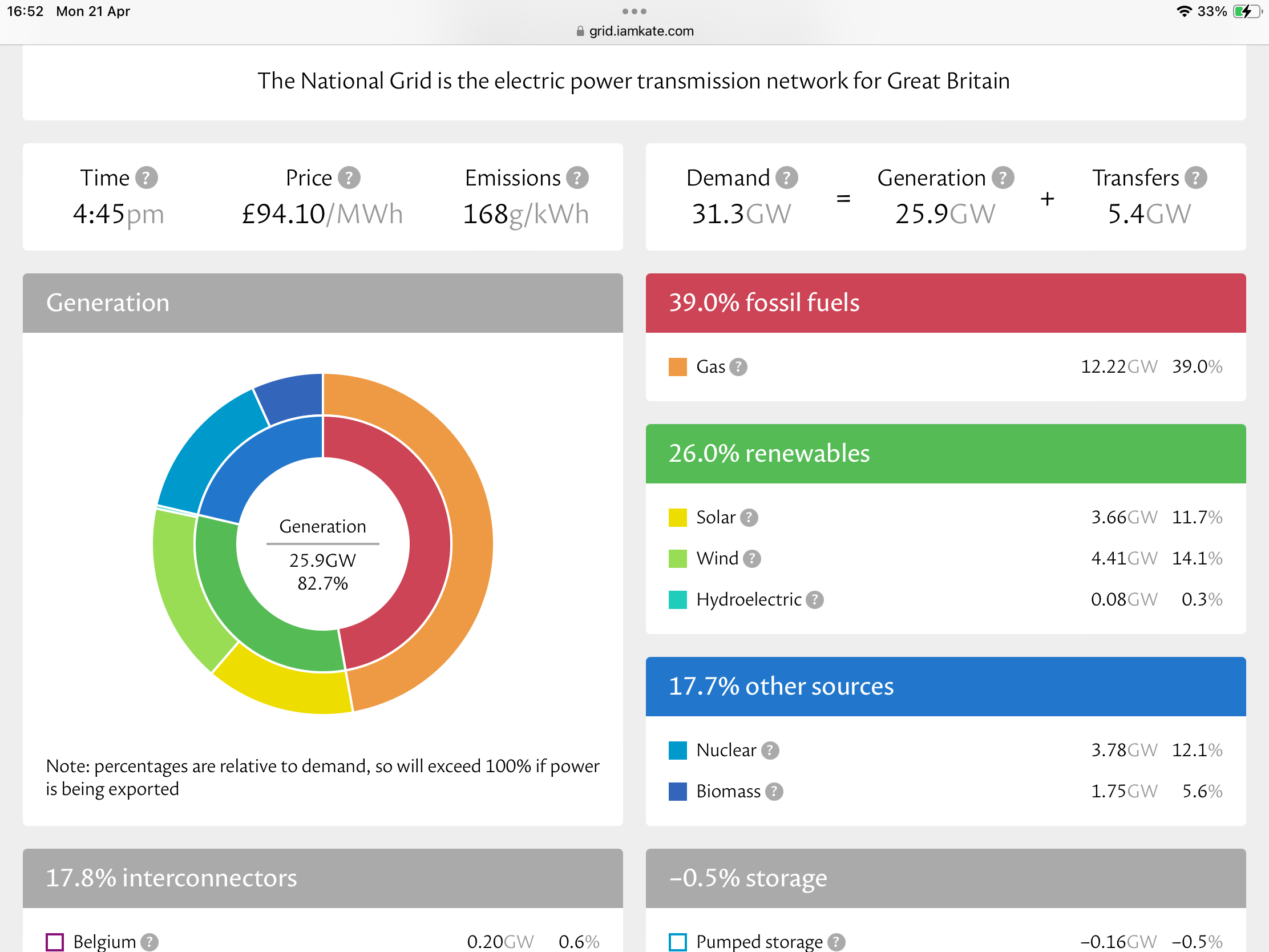

Nick Laslett Posted April 21 Posted April 21 (edited) 36 minutes ago, G and J said: In reality the sensible choice was to give up on an ASHP and fit a gas boiler, but, as a matter of principle, we wanted no gas. So instead we are shelling out on an expensive pipe, and accepting slightly higher running costs. We think it is still ecologically better than a gas boiler. @G and J, if you are already on mains gas? Then there is no shame in fitting a gas boiler. Gas is the cleanest of the fossil fuels. Most of our electricity comes from gas. So even if you have an ASHP, you are using gas most of the time. Burning gas locally is more efficient than burning gas at the power station. By building a well insulated, airtight house you are already making a long term commitment to the environment. Your personal carbon footprint from using a tiny amount of gas for your domestic hot water and heating, in comparison is insignificant. This calculator is a useful tool for modelling these choices. https://students.open.ac.uk/candc/carbon_calculator/ If your situation allowed for you to easily fit an ASHP, then it would be different. But there are millions of dwelling in the UK, where fitting an ASHP will be a real challenge. Just my thoughts on this topic specific to your situation, I don’t want to upset anybody. There are far worse things than a brand new high efficiency weather compensation driven gas boiler for the environment. Edited April 21 by Nick Laslett 1

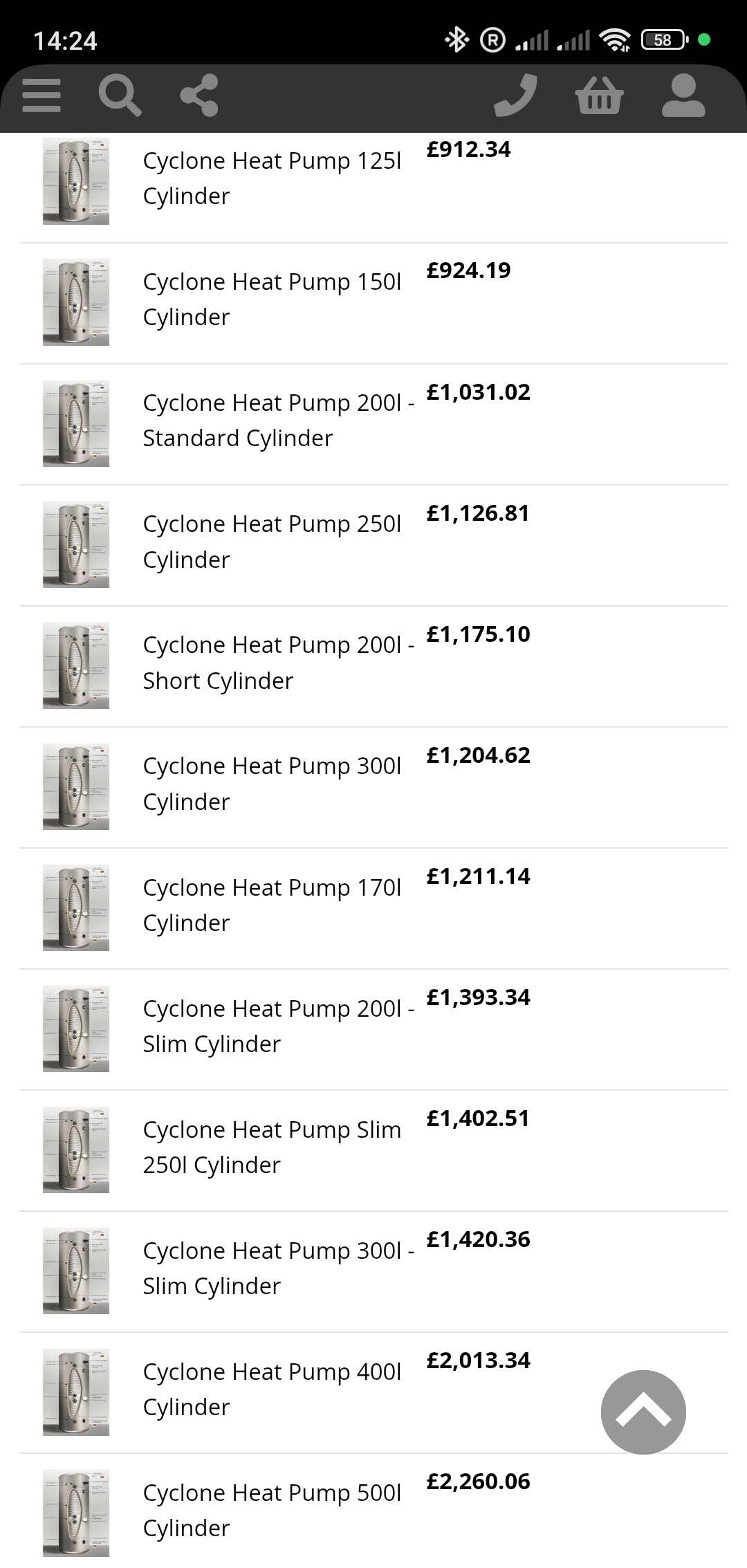

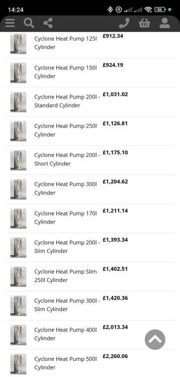

G and J Posted April 21 Author Posted April 21 Oh we did have mains gas. Paid £1.7k to have it removed. Going electric only feels right, for the warm fuzzy doing the right thing internal feeling kinda reason. Just need to work the choices that follow that. I’ve read a good few instances of moderately extended pipe work for ASHPs appearing to work ok, so we’ve gone for it. Just need to find the right ASHP and cylinder now.
JohnMo Posted April 21 Posted April 21 3 minutes ago, G and J said: right ASHP and cylinder now Buying at full price, I would go Panasonic monobloc and just go to City Plumbing or Cylinder2Go (you get a discount )for the cylinder. Then you just need an UFH manifold. Next job - do your pressure drop calculation assume a 100m long UFH loop and then use your pipe length to sort out primary feed pipe sizes. You want to be getting around 1.4m³/h flow rate (assuming 6kW), to keep UFH and cylinder happy.
G and J Posted April 21 Author Posted April 21 4 minutes ago, JohnMo said: Buying at full price, I would go Panasonic monobloc and just go to City Plumbing or Cylinder2Go (you get a discount )for the cylinder. Then you just need an UFH manifold. Next job - do your pressure drop calculation assume a 100m long UFH loop and then use your pipe length to sort out primary feed pipe sizes. You want to be getting around 1.4m³/h flow rate (assuming 6kW), to keep UFH and cylinder happy. Looking at 5kW as our heat loss at -2.3C is 2.5kW. (Does that mean I want to achieve 1.17m3/h flow rate or doesn’t it scale like that?). I presume I need to calculate the number of linear 100m loops we need to calculate the full UFH flow resistance. Again, I presume one dimensions Fiordland the UFH and simply assume the cylinder will be ok when the system switches over to DHW.

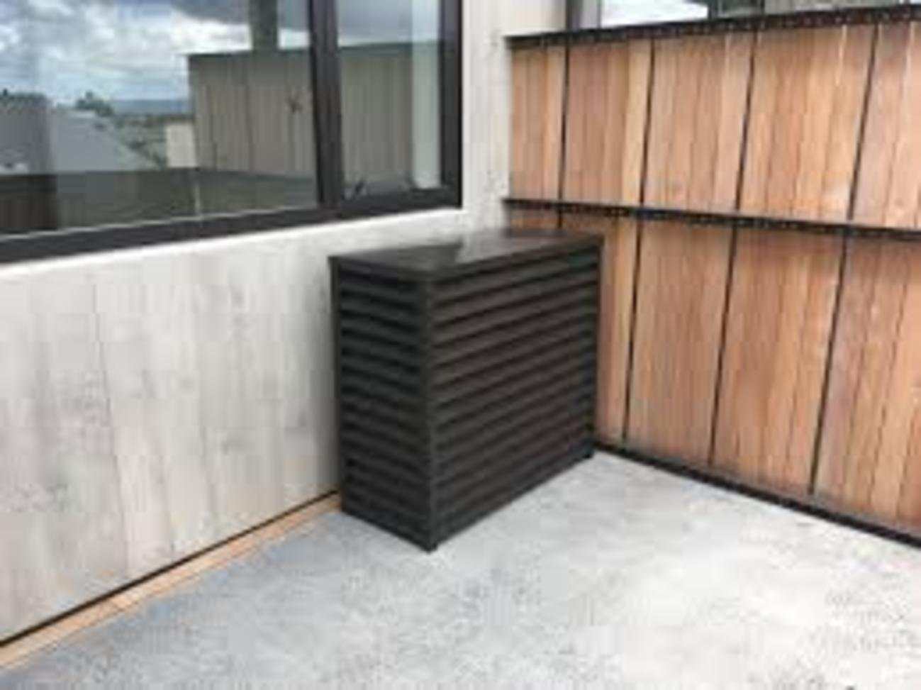

Iceverge Posted April 21 Posted April 21 3 hours ago, G and J said: could go right by the front door I doubt anyone would even notice it if you put one of these fancy covers over the top. 3 hours ago, G and J said: Or it could go near the road and impede a parking space Mounted high on a wall? 3 hours ago, G and J said: In reality the sensible choice was to give up on an ASHP and fit a gas boiler, but, as a matter of principle, we wanted no gas. One bill, no gas standing charge, no prospect of gas leaks, solar driven cooling. No need for a gas registered plumber to tinker if you need to. There's lots to like. Principles are good I suppose but be careful of dieing on any particular hill. As someone who pours a chunk of concrete regularly, flies often, has lots of kids, farms beef and occasionally looses patience with stuff and sets it on fire in the yard, I'm all for principles. Principles prevent environmentally savvy types drowning me in my own juices for the good of the planet.
