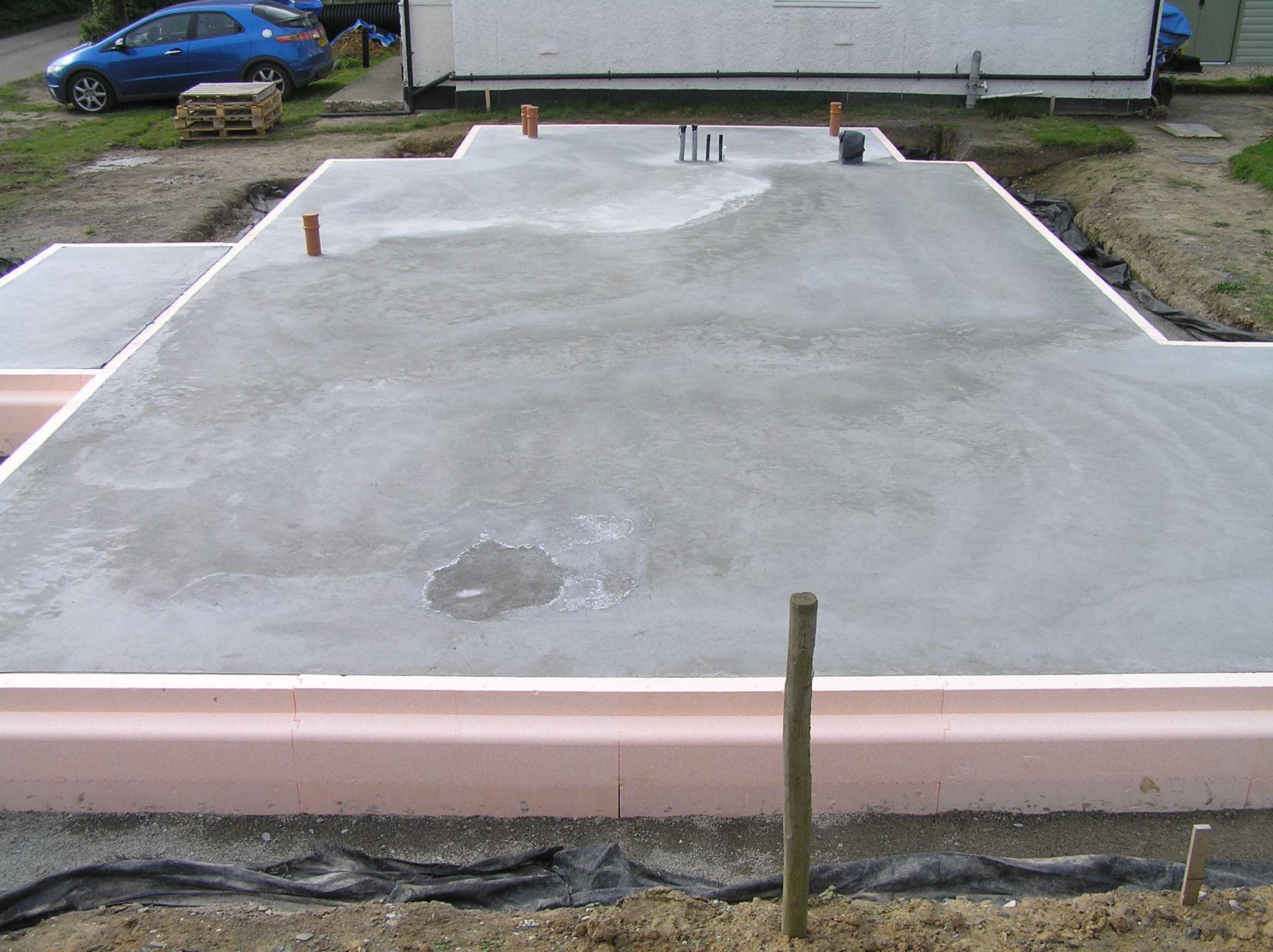

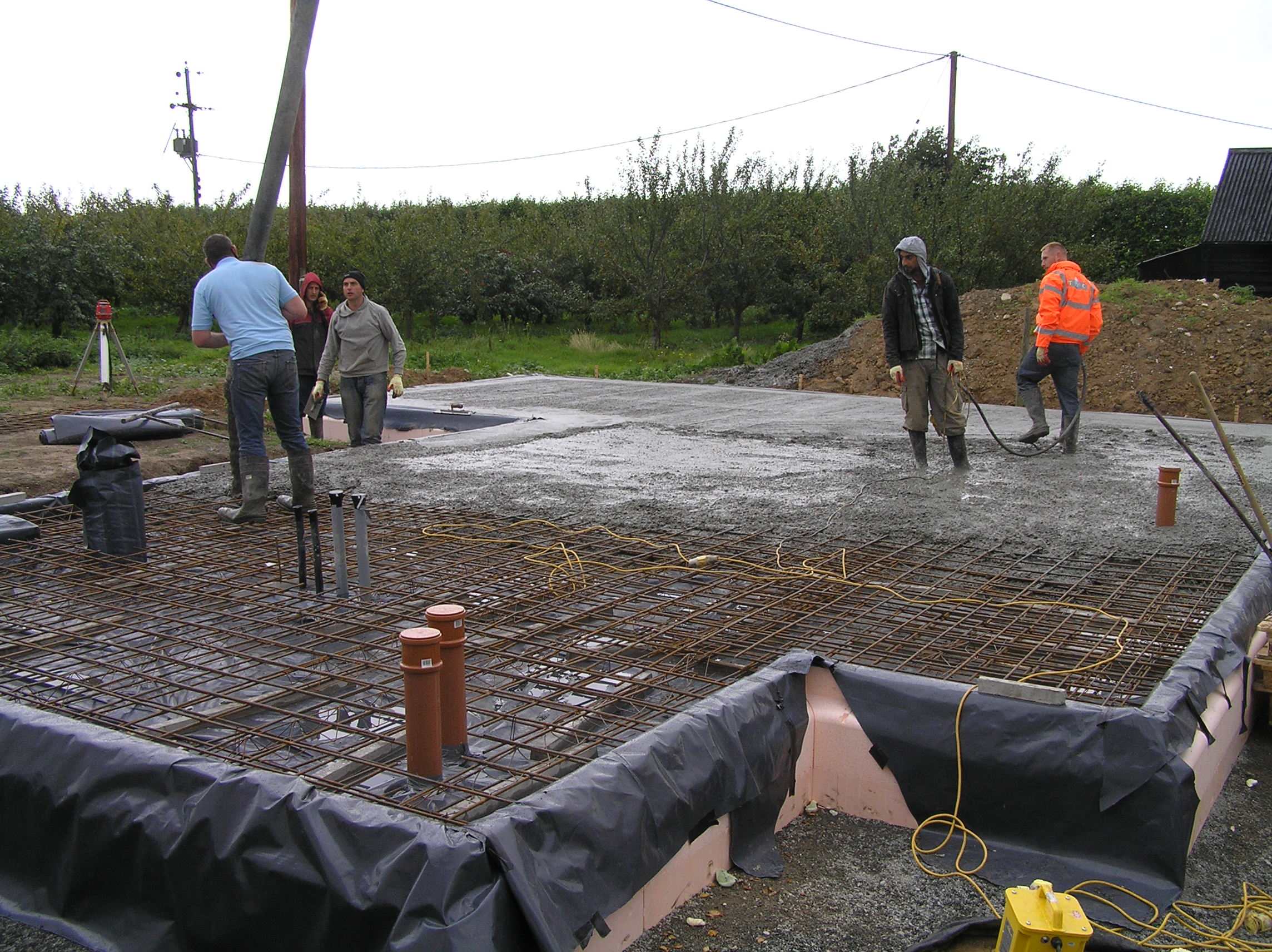

@HanleeHouse I had an insulated raft foundation and all the 110mm soil pipes had long radius bends with feet and came up through the insulation and were around 0.5m above concrete level. That is except for the downstairs wet room shower waste where the 110mm pipe finished around 150mm below concrete level and was surrounded by a large block of polystyrene which finished above the concrete level. This enabled me to remove the polystyrene after the concrete had set and adjust the pipe length for the sunken shower waste. All the pipes had AAVs which were hidden behind false walls as the upstairs rooms had vaulted ceilings. We had our own STP and didn't have a vent on the house but on the STP.

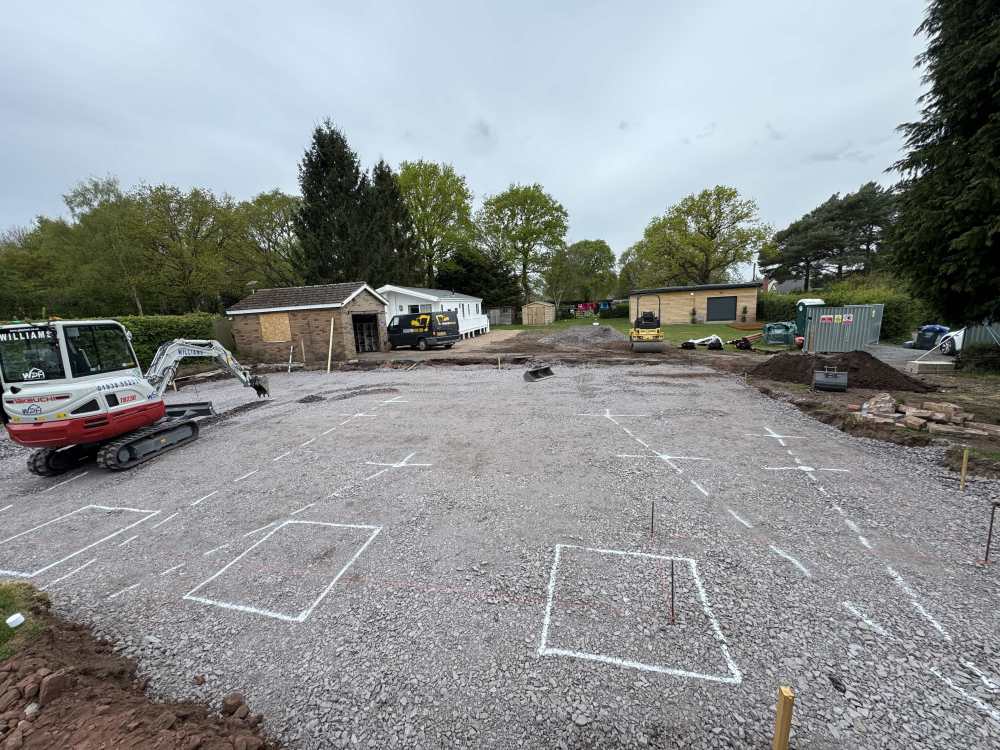

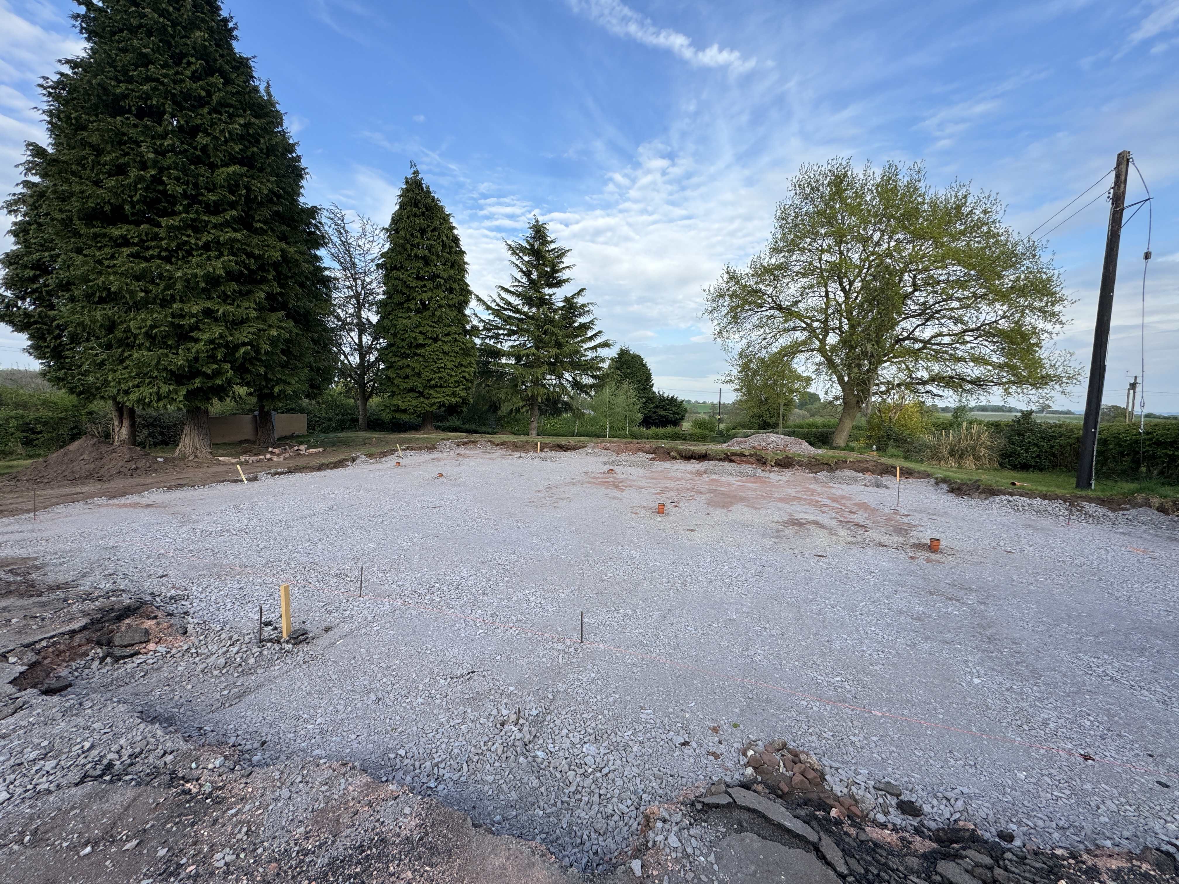

Hi All,
I drew myself a plan and laid the drainage. Ready to finish levelling and just need to add the water & electric ducts.
IMG_1970.thumb.JPG.222275eb147f40b7096ca625743fb82e.JPGIMG_1959.thumb.JPG.06ab7df8603546516615d5217bf7440c.JPG
When I get to the stage of laying the DPM over the EPS, what's the best practice for laying the DPM around the penetrations? Tape? Liquid DPM? Should I be using foam filler around any gaps too? Is there any recommended EPS friendly foam filler?
Appreciate your help guys. Learning on the go!
Cheers

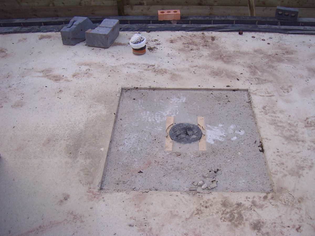

My effort 10+ years ago with the wet room style vertical trap gaffer taped. Had a board of MDF set 20mm lower from memory
