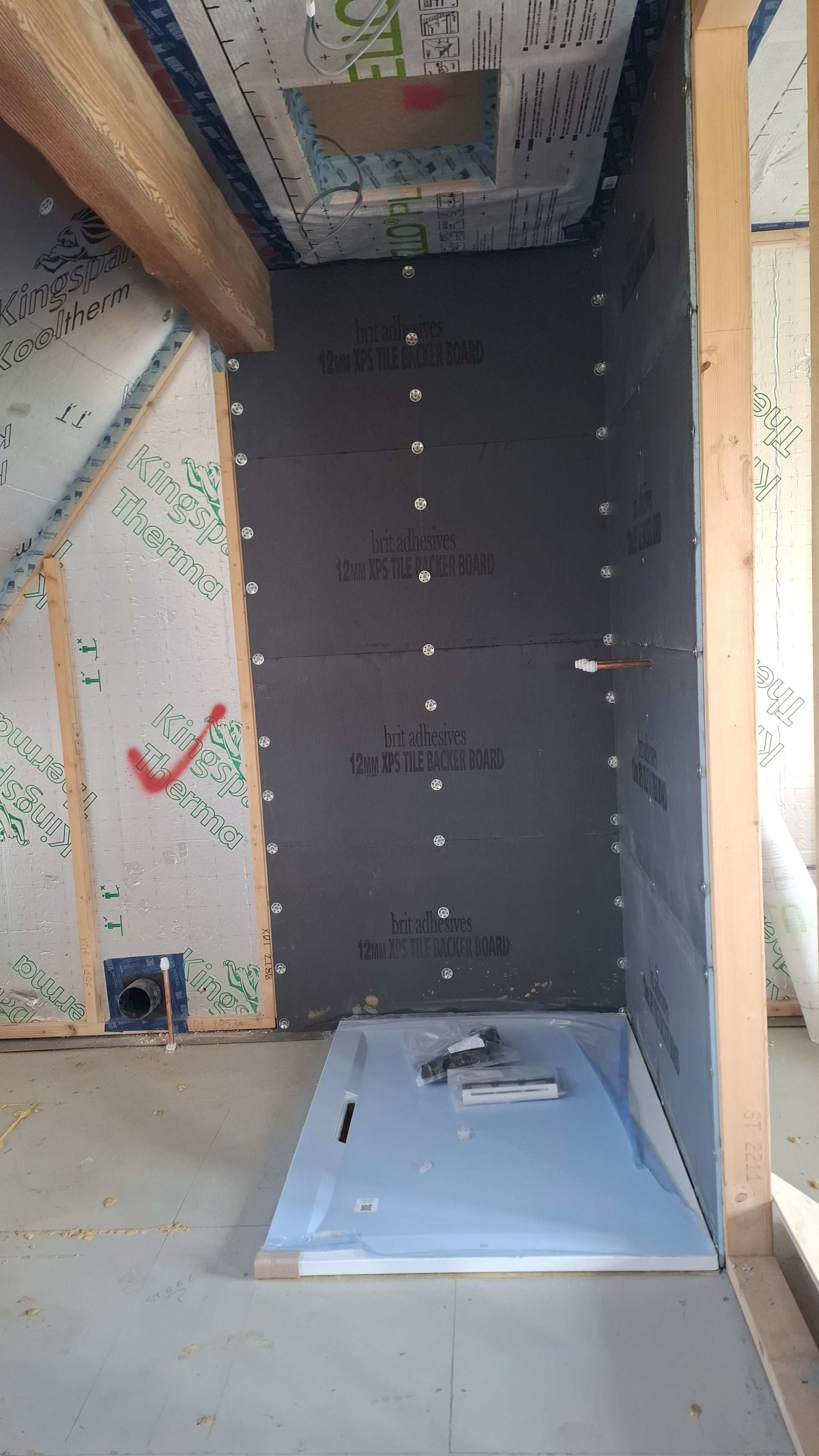

Post and beam Posted March 30 Posted March 30 Is it acceptable to have the bathroom extract within the footprint of the shower cubicle? The side panels will not go all the way to the ceiling so i cannot imagine its a major problem.
JohnMo Posted March 30 Posted March 30 Two of three of ours are in shower footprint at ceiling level. Zero issues. The other one would have been above shower, but we changed the layout and it ended up above the bath instead. You will get plenty of contributions to this question, including you should never ever do it. Good luck!
Post and beam Posted March 30 Author Posted March 30 On 30/03/2025 at 20:32, JohnMo said: we changed the layout Expand For the same reason we now have this issue. The bath was going to be across the end wall that you see.

Mike Posted March 30 Posted March 30 Zehnder's recommendation is that it should be close to, but not directly over, the shower. No reason given, but my guess is that it's not about the functioning of the MVHR unit, but rather that the air being drawn past the person showering could, in some circumstances, feel uncomfortably cool. For example if you don't have a good shower screen & door in place.

Nickfromwales Posted March 31 Posted March 31 On 30/03/2025 at 22:26, Mike said: Zehnder's recommendation is that it should be close to, but not directly over, the shower. No reason given, but my guess is that it's not about the functioning of the MVHR unit, but rather that the air being drawn past the person showering could, in some circumstances, feel uncomfortably cool. For example if you don't have a good shower screen & door in place. Expand If under a warm / hot shower I doubt MVHR on boost would give you any discomfort in an open room. Cant really understand any other rationale for positioning MVHR vents, other than to be as far (diagonally) opposite the door as is possible; to move the most amount of air through the room. Maybe avoid steel vents and go for a powder coated aluminium if in the shower / steam zone, but I’ve not seen these affected by rust tbf as the constant airflow seems to rid the system of moisture anyways.

Post and beam Posted March 31 Author Posted March 31 On 31/03/2025 at 07:59, Nickfromwales said: as far (diagonally) opposite the door as is possible Expand The WC will be at that far end of the bathroom and is the opposite end to the door so thats settled. grill is going in that airtight box above. Thanks guys 1
