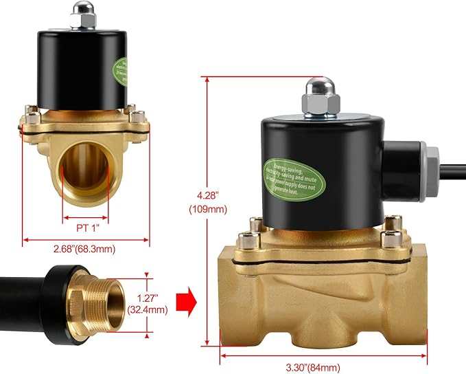

Adsibob Posted March 20, 2025 Posted March 20, 2025 (edited) Our BCO made us get a Fire Safety Report. The Fire Safety Engineer required us to install a sprinkler system on the ground floor of our house. This was because we had an open plan downstairs which meant the kitchen was open to the staircase AND we were doing a loft conversion. The spinkler company, iMist, made us install a Priority Demand Valve (PDV) on our incoming water main so that in the event of a power cut, the sprinkler system's tank is given priority. This is really annoying as although we've only had one power cut in the 3 years we have lived at the property, for the 6 hours or so that the power was off we had no hot or cold water in the house (I moaned about it on this Forum and I think @ProDave or @Nickfromwales and others agreed is was ridiculous plumbing situation). I complained to iMist and they shrugged their shoulders and said that's the law and I cannot break it. Turns out that they may have been wrong as they are now saying something different, but that is the subject of another post... So we've lived with this PDV and apart from that power cut no problems, until... yesterday morning it melted! There was an unpleasant chemical burning smell and no water in the house. I checked the fuseboard and the circuit on which the Priority Demand Valve is wired had tripped. I tried to put the circuit back on but it refused. Further investigation led me to realise the priority demand valve itself had malfunctioned. All the plastic sheathing around the bit that connects the electrical cable to the solonoid valve had melted. So the problem I had was that there was no water in the house and no way to easily fix it without a replacement PDV, as there is no bypass plumbed in, presumably to comply with the fire regs or imist's requirements in that they don't want you to be able to bypass this piece of "safety kit" which ironically in our situation could have caused a fire! Nobody is accepting any blame of course, but it was very unsatisfactory as there is no way to bypass that valve, this being apparently a requirement of the fire safety regs. The PDV is this cheap crappy unit made in China: https://www.amazon.co.uk/dp/B071NW44B1?ref_=ppx_hzod_title_dt_b_fed_asin_title_0_0 I had no idea a proper solonoid valve costs over a £100, so incredible they can make any profit on the mere £30 asking price. Luckily I managed to got the foreman from our original build back and he has rigged a temporary fix, by disconnecting the melted wiring and removing a spring from inside the PDV so it is now permanently open rather than permanently closed. There is a tap that enables us to empty the pipe it's fitted on, so no huge mess of water, though it's not clear to me that there won't be a huge mess when we actually remove and replace it. Anyway, my two questions for the Forum are: Is there a really good quality PDV (which when powered is open, but when power is lost is closed) which has the same 84mm (3.30") dimension as shown here: Is this actually safe, even in a non-chinese crap brand? The design seems flawed, in that it is constantly being powered to resist almost 4 bars of pressure, 365 days a year? Seems nuts to me! Although the water passing through it is cold, it sits about 30cm below our boiler, in a boxed in cabinet, so it must get pretty warm in there. Is this an acceptable fire risk??? The gas pipe feeding the boiler is also very nearby. I just can't believe this thing melted the way it did. The noxious smell could be smelt in the bathroom directly above, although that's perhaps not that surprising given all the water risers go from that area up to the bathroom and beyond, so the wall that houses those risers providers for plenty of space for the smell to travel through. Edited March 20, 2025 by Adsibob

Adsibob Posted March 21, 2025 Author Posted March 21, 2025 (edited) 1 hour ago, Nickfromwales said: Not sure about iMist, but 2 companies I have used have NOT specified a PVD. I wish I had gone with those two companies. Just to clarify: I am not considering changing systems. I want to keep the imist, just either take the PDV out altogether (with imist’s consent… it seems they may be amenable to this); or I want to install the best PDV money can buy (within reason) so that this never happens again. So that I can decide which route to go, grateful if anyone who knows plumbing fittings could let me know which PDV manufacturers are best Edited March 21, 2025 by Adsibob

Adsibob Posted March 21, 2025 Author Posted March 21, 2025 (edited) 4 hours ago, Nickfromwales said: The beauty of the mist system is that it consumes very little water to do the same job, vs sprinklers, so even if you were running the bath the mist system should still function. So apparently, after a helpful call with imist today, the minimum requirement for the water supply is 14 litre per minute, which I just meet. I can only remove the PDV altogether if I have 25 lpm, which I definitely don’t have and never will have - we have already got Thames Water to increase our flow rates at a crazy price of c. £2k! As an alternative they are happy for me to swap out the PDV with one that only draws power to close, rather than the inverse which I have now, ie draws power to open. They are sending me a suggestion for such a PDV. In the meantime they have advised me to decommission the imist pump until this is sorted because the swapping in and out of valves can cause a sudden pressure influx into the pump which can cause a false trigger 😱 luckily that is apparently very easy to do, so they’ve said I can do it myself and are sending me a doc explaining how. Let’s see… Edited March 21, 2025 by Adsibob

Adsibob Posted March 21, 2025 Author Posted March 21, 2025 imist have recommended this PDV instead: https://www.mmcwebshop.com/products/f59dc1f60e/35372000007965040 it’s 3/4 BSP, is that going to be compatible with my pipework, which is compatible with the dimensions of the PDV shown in the image in my OP, sorry I’m being really daft.
sharpener Posted March 22, 2025 Posted March 22, 2025 (edited) On 20/03/2025 at 15:53, Adsibob said: The design seems flawed, in that it is constantly being powered to resist almost 4 bars of pressure, 365 days a year? Seems nuts to me! The suggested replacement looks very similar in design to the 1/2 in pilot-operated solenoid valves in our rainwater supply system. They are energised 24/7 and have worked for years. One turns on the rainwater provided the tank is not empty and the other shuts off the mains water against the incoming mains pressure. So I think the concept is sound. I have on one occasion in 17 years had to dismantle one valve and clean the pilot orifice which was a bit tricky. Edited March 22, 2025 by sharpener
Adsibob Posted March 22, 2025 Author Posted March 22, 2025 (edited) Thanks @sharpener. Another reason for preferring the “normally open” version is that in the event of a power cut it will stay open I believe, thereby making sure we don’t lose power and running water at the same time. I found a 1” version of the one recommended by imist https://www.mmcwebshop.com/products/a0e1dbe8f9/35372000019718077 so have gone with that. It cost 7 times the price of the cheapo made in China crap my builder originally installed so hopefully will last a lot longer than the 2.75 year life we got out of the cheapo one. Edited March 22, 2025 by Adsibob
