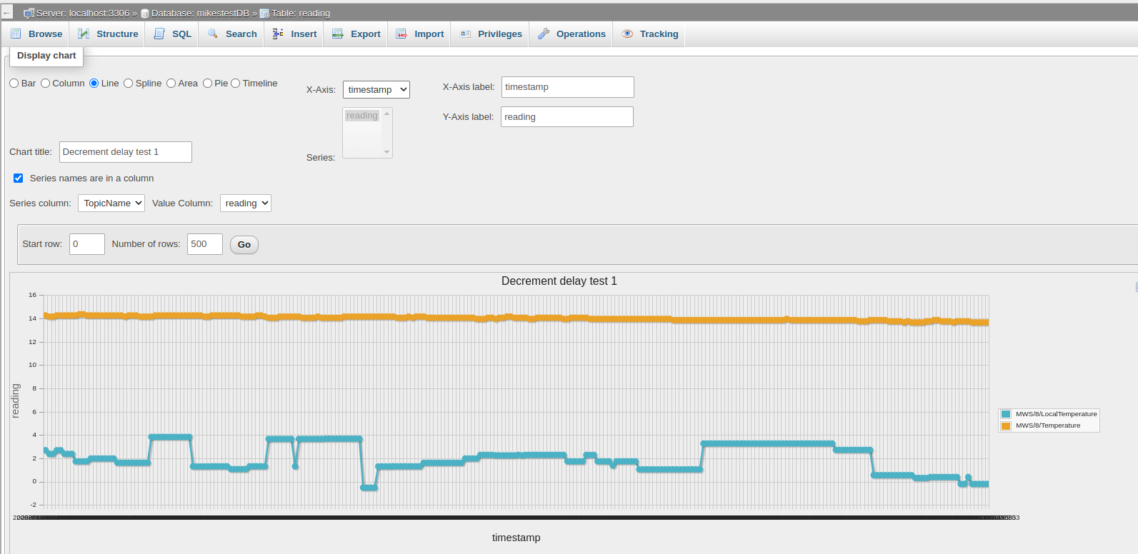

MikeSharp01 Posted March 15, 2025 Posted March 15, 2025 On Thursday I managed to get the temperature and humidity loggers running in the house and I now have my first scraps of data. The house has no heating running yet so all the heat going in is me working, solar gain and a tiny bit from the logger power supply. I am wondering if the decrement delay is what I should expect, here is the data from midnight last evening to now, (10:46) so about 11 hours. The upper trend is the internal temperature and the lower one the outside temperature derived from the local weather station, about 1 mile from the house. I hope to have my own external one up and running but my PoE scheme out there seems to have a problem. It broadly shows that the temperature started at midnight at about 14.2 and has come down to 13.7 over 11 hours with an outside temperature around 2 ish. Still more analysis to do but should I be happy with that rate of decline? Not sure what i can do if I am not but there are a couple of colder bridges that will be done when the MVHR Inlet and Extracts are fully fitted and there is only plasterboard on about 30% of the walls so far.
SteamyTea Posted March 15, 2025 Posted March 15, 2025 Assuming your definition of decrement decay is t.K-1 you have to slice (bin) by the ΔT or bin by the OATs (internal temperature does not have enough variation). Work out the time between 1K variations, then plot them. This should produce a natural logarithmic curve i.e. the greater the ΔT, the shorter the time to change. The problem seems to be, when I look at my data, is that it regressed to zero (ideal would be zero i.e. no inputs, no temperature change). I find it better to look at temperature distribution over a fixed time period, then look at the most likely variation. Maybe when I get home I may look at my data and play with it a bit.

MikeSharp01 Posted March 15, 2025 Author Posted March 15, 2025 4 minutes ago, TerryE said: Mike, I can't recall. Are you using HomeAssistant and do you have Zigbee? No home assistant as yet but will have when the house is finished, we do have a zigbee gateway available and zwave. I will have a look at the old posts. I suppose my concern was how fast it dropped against the delta. We have, will have, fibre cement tile cladding on the outside, 8t, which will add some heat capacity as will the rest of the plasterboard on the inside 4+t. I need to do some more modelling now I have some data to play with along the lines you and @SteamyTea suggest to get a picture of the losses so I can verify potential control schemes - probably very simple ones.

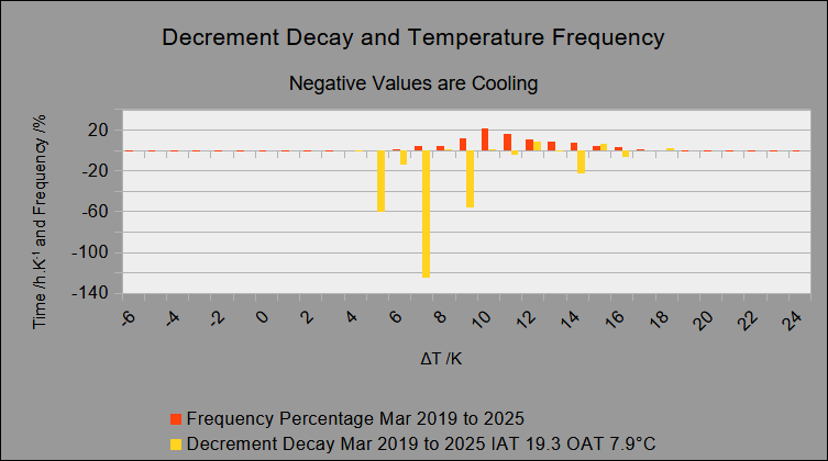

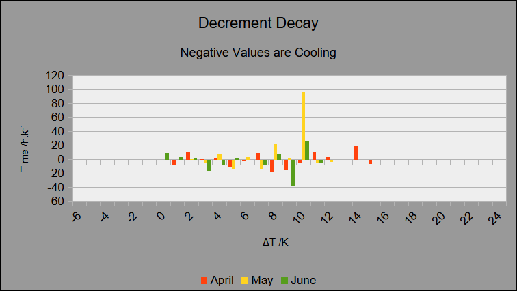

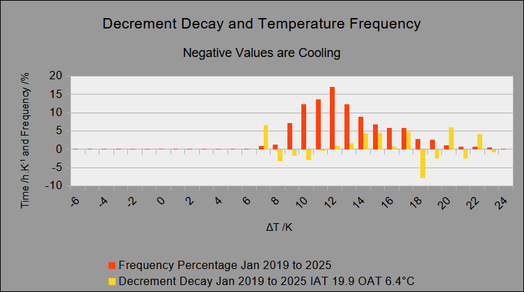

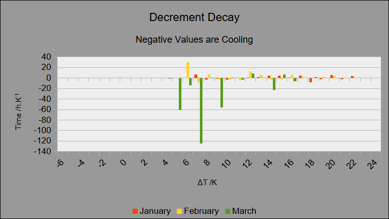

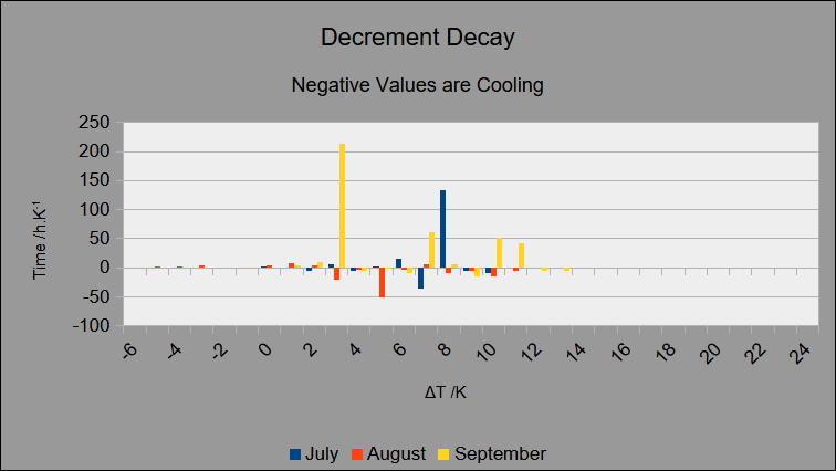

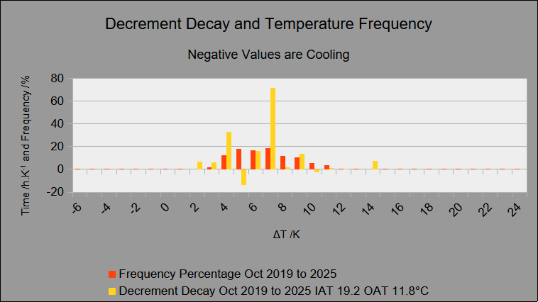

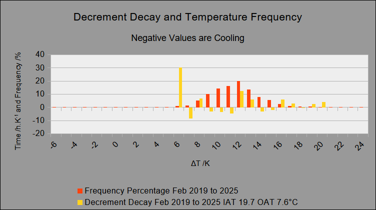

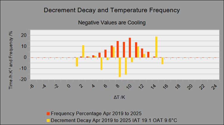

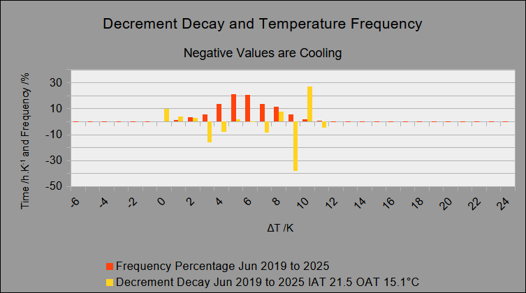

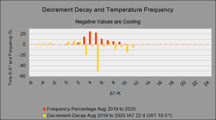

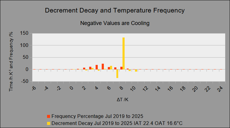

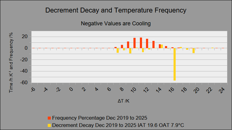

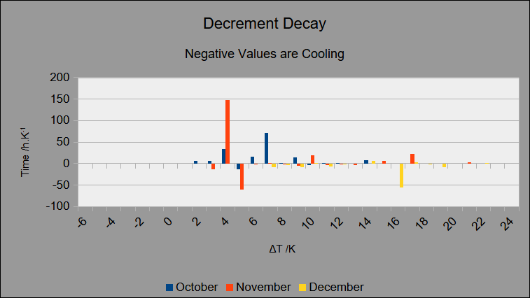

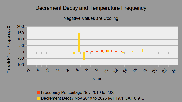

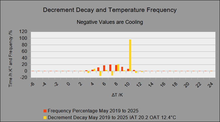

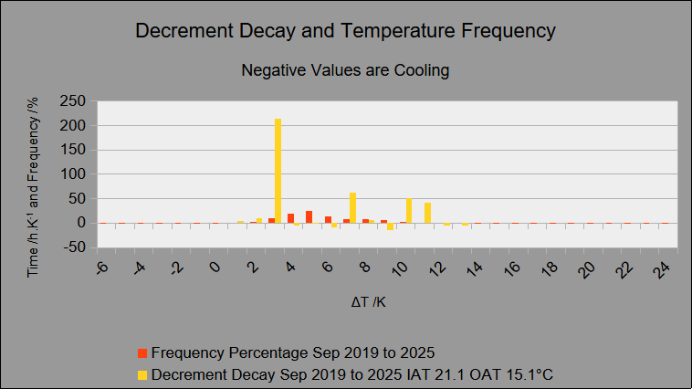

SteamyTea Posted March 15, 2025 Posted March 15, 2025 Right Knocked up the basic data, grouped it by ΔT to show the hours it takes to change by 1K. I have created 4 charts to split the year up, generally the April, May, June, July, August and September have no heating on. Usually I turn the heating on some time in November and it goes off sometime in March. The data spans the years 2019 up to 2025, so 6 years. I will create some charts that show the frequency of the ΔTs, but they will almost certainly be monthly or they will be very busy (LibreOffice Calc is not as fast for chart making as MSO Excel). Note that the y-axis scale changes wildly. Generally, as expected, the greater the ΔT, the faster the temperature changes. I suspect that the anomalies are when the heating is turned on and off, which in itself is useful to know.
SteamyTea Posted March 15, 2025 Posted March 15, 2025 Right Here are the more interesting charts, Decrement Decay, Frequency that they occur, grouped monthly. As I suspected, the large variations are at the extremes, so don't really matter that much. Where there are large variations in the middle of the distribution, the decrement decay is still quite large i.e. April taking 15 hours to drop 1K when the mean IAT is 19.1°C. It is also worth remembering that my house is small, terraced and timber framed. So not an ideal form thermally (it is basically a corridor), and it has disproportionally high window area, at each end. I also have E7 storage heaters (modified to be only on for up to 4 hours), so a maximum of 16.8 kWh.day-1, but usually half that. I am not really sure if it is worth looking at hourly data (these charts are based on 6 hourly means so I could split them into heating input times and daylight times, but then when, on average, the decay is several hours, not really important for 1K temperature difference. My internal temperatures are stable enough, and since the latest improvement (fixed the draughty door and added secondary glazing onto the double glazing), I seem to be using less energy anyway (may have a look as it is only a matter of comparing charts, but tonight).
MikeSharp01 Posted March 15, 2025 Author Posted March 15, 2025 35 minutes ago, SteamyTea said: Right Here are the more interesting charts, Decrement Decay, Frequency that they occur, grouped monthly. As I suspected, the large variations are at the extremes, so don't really matter that much. Where there are large variations in the middle of the distribution, the decrement decay is still quite large i.e. April taking 15 hours to drop 1K when the mean IAT is 19.1°C. It is also worth remembering that my house is small, terraced and timber framed. So not an ideal form thermally (it is basically a corridor), and it has disproportionally high window area, at each end. I also have E7 storage heaters (modified to be only on for up to 4 hours), so a maximum of 16.8 kWh.day-1, but usually half that. I am not really sure if it is worth looking at hourly data (these charts are based on 6 hourly means so I could split them into heating input times and daylight times, but then when, on average, the decay is several hours, not really important for 1K temperature difference. My internal temperatures are stable enough, and since the latest improvement (fixed the draughty door and added secondary glazing onto the double glazing), I seem to be using less energy anyway (may have a look as it is only a matter of comparing charts, but tonight). That is useful stuff, I will need another glass of wine to get my head around this little lot. Thanks for putting it together.
