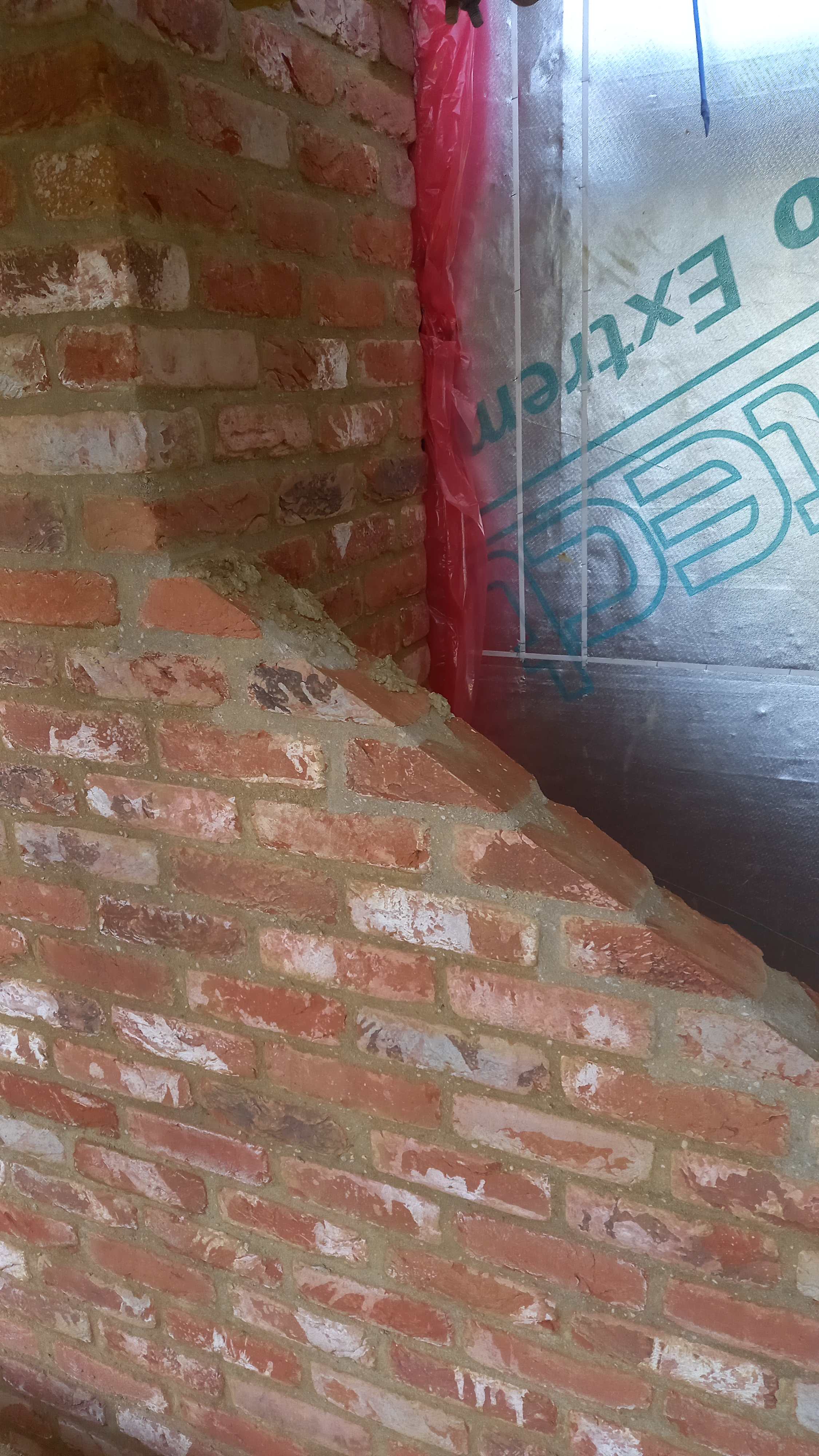

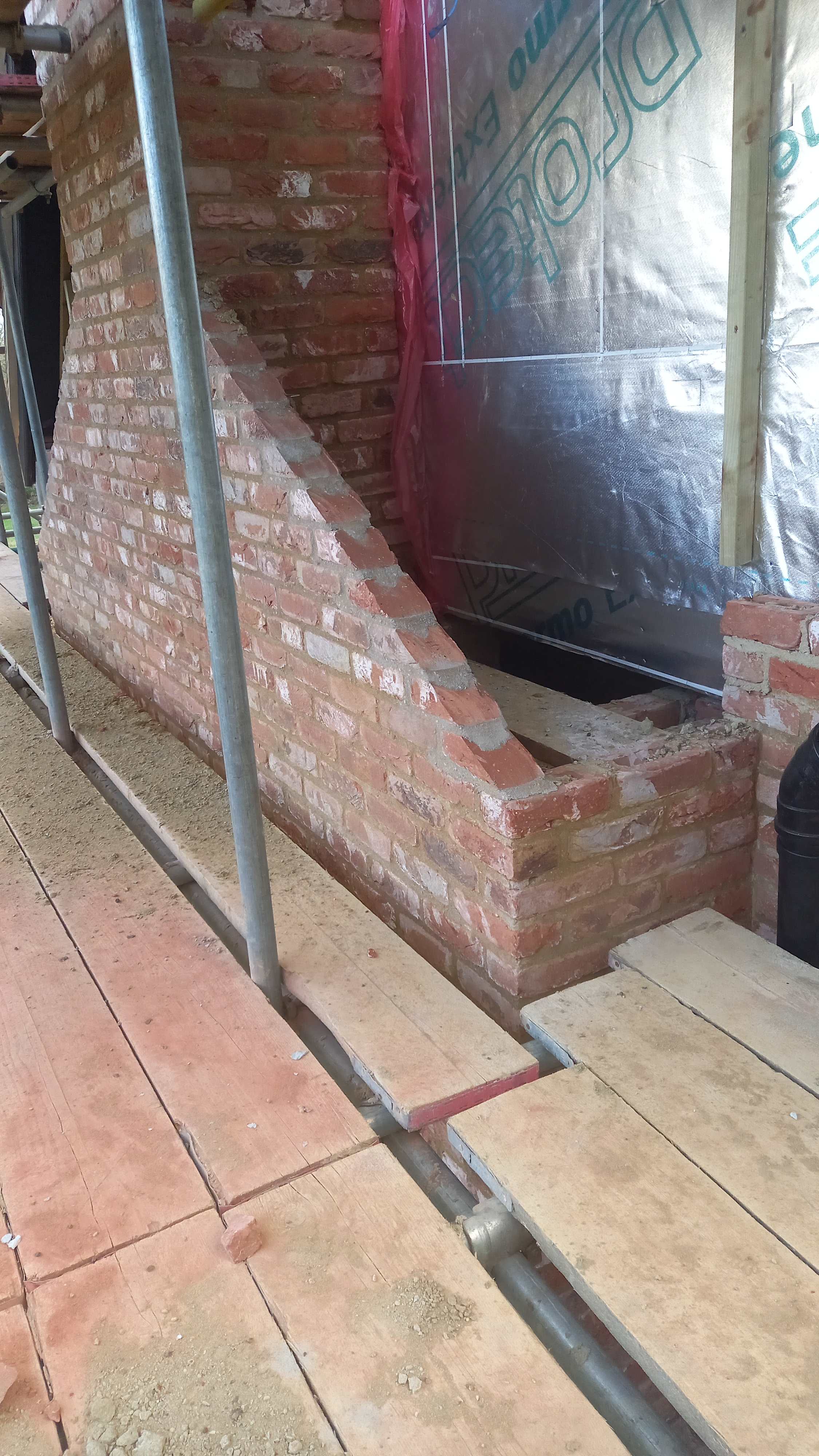

Post and beam Posted March 12, 2025 Posted March 12, 2025 I need to construct a frame i guess onto the knee of my chimney. Roofer wont do 'chippy stuff' and the Brickie doesn't know either. Its too small a job apparently, to get a chippy in to do it. So i need to learn what and how. Can i lay a piece of 4 x 2 onto the slope of the knee with a corresponding piece on the inner SIP panel face such that Battens can be installed across just like the main roof? All help and knowledegable comments gratefully absorbed as allways guys Thanks in advance keith
Nickfromwales Posted March 12, 2025 Posted March 12, 2025 In a nutshell, yes, as you describe. Needs to be treated timber, and you defo do NOT want to be drilling and fixing into the diminished section of the bricks or you'll crack / break them out most prob. You want to be drilling at 90 degrees to the timber and have the holes placed so that the drill is impacting just below each mortar line, eg into the meatiest part of each brick and NOT into the 'tail'. Cut that counter batten off and tape up the holes, then install the wall plate to match the timber atop the bricks, and the rest is history. Roofer should be able to batten and membrane etc from there, after you've changed his nappy...... Can't see any lead or other flashing? What's going to sort the break between the roof and the bricks?

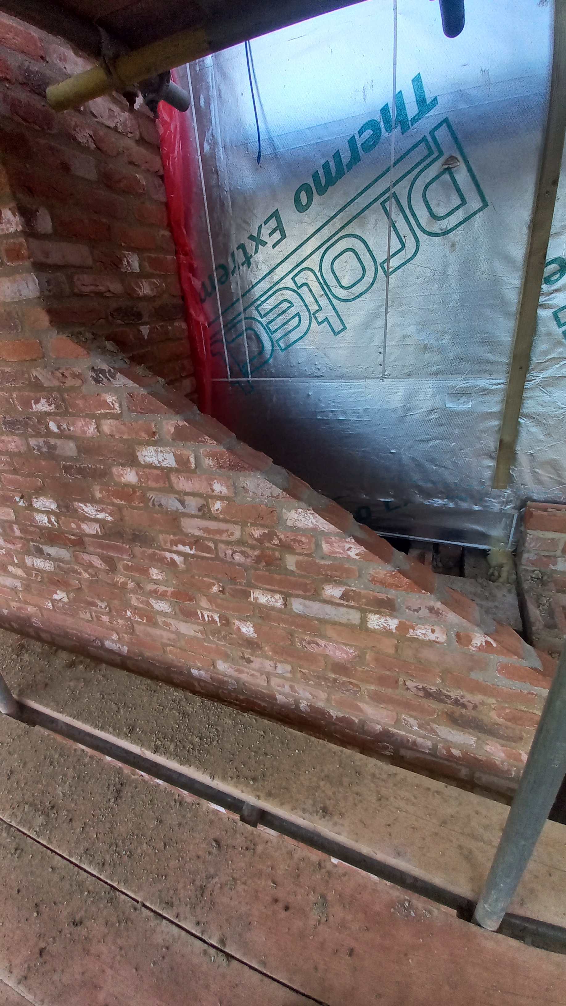

Post and beam Posted March 13, 2025 Author Posted March 13, 2025 12 hours ago, Nickfromwales said: Can't see any lead or other flashing? What's going to sort the break between the roof and the bricks? Hi Nick, The upper half of the gable end will be Hardie weatherboard. I think i need to fix some kind of batten to the SIPs panels (to the studs within) that the lead can be dressed over. Then the hardie can sit over that.
Nickfromwales Posted March 13, 2025 Posted March 13, 2025 45 minutes ago, Post and beam said: Hi Nick, The upper half of the gable end will be Hardie weatherboard. I think i need to fix some kind of batten to the SIPs panels (to the studs within) that the lead can be dressed over. Then the hardie can sit over that. Needs a decent bit of thought and some robust methodology then tbh. The lead should already be in the brickwork of the chimney, should it not? Who’s coordinating this?

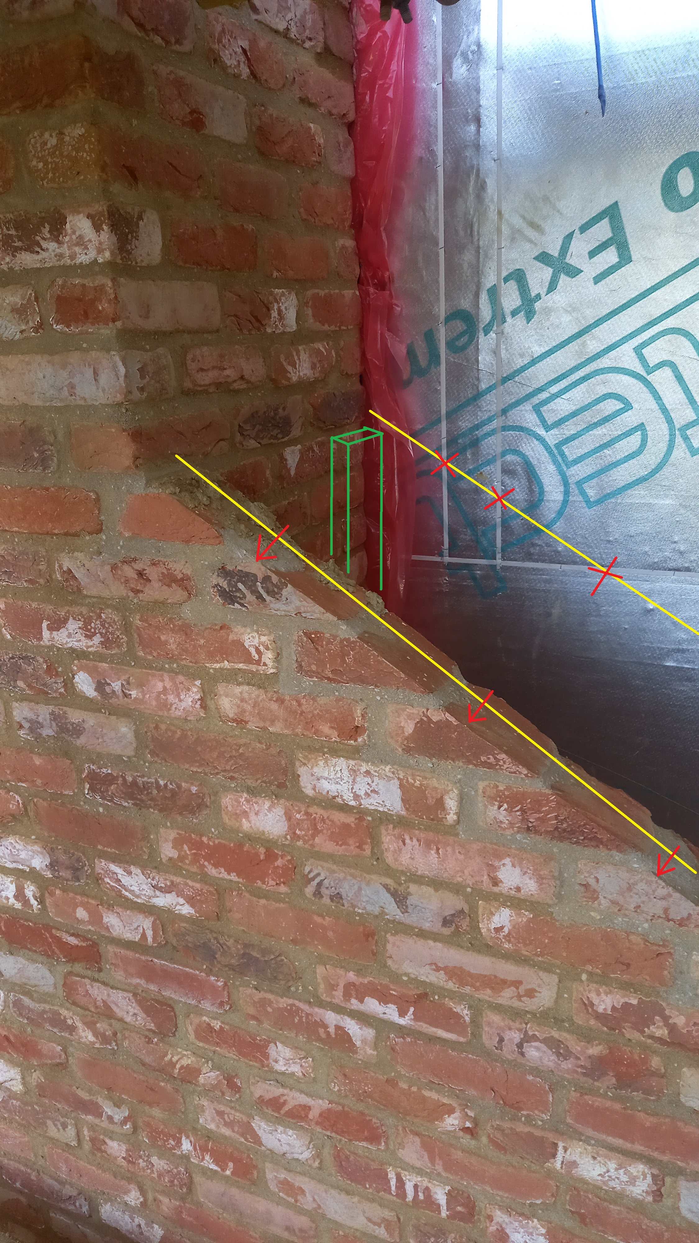

Post and beam Posted March 14, 2025 Author Posted March 14, 2025 I am thinking something like this to start. Yellow lines represent 4 x 2. Screwed to the studs within the SIP's plus anymore lower down. Green line represents a vertical length of 4 x 2 screwed to the chimney bricks as support. Something to run horizontally across the top at an appropriate point. That should do it for strength?
Russell griffiths Posted March 14, 2025 Posted March 14, 2025 26 minutes ago, Post and beam said: I am thinking something like this to start. Yellow lines represent 4 x 2. Screwed to the studs within the SIP's plus anymore lower down. Green line represents a vertical length of 4 x 2 screwed to the chimney bricks as support. Something to run horizontally across the top at an appropriate point. That should do it for strength? Not really, that’s all a bit wrong are you after building the timber work to support the roof tiles ? if you are then we need a bit of clarity on what you want to achieve will you have a barge board running up the outside of the brickwork, or will you just over sale the tiles and have a cemented fillet, or dry verge. what roof covering is going on this ? will it have a soffit and facia at the lowest point, or just facia. need a sketch reall on what the final goal will be then I can guide you as to how to frame it up.
Post and beam Posted March 14, 2025 Author Posted March 14, 2025 1 hour ago, Russell griffiths said: that’s all a bit wrong Thats why this forum is soo good. Thanks. # Yes trying to provide a stable platform for the roof tiles. Clay tiles as per the main roof. # No barge board on this little piece, slight overhang and muck to tidy and seal the edge. # No soffit or facia. The main house is open eaves. # As its such a small area i was expecting to overhang the tiles at the bottom edge and let the rain drip into fresh air. Thanks again keith

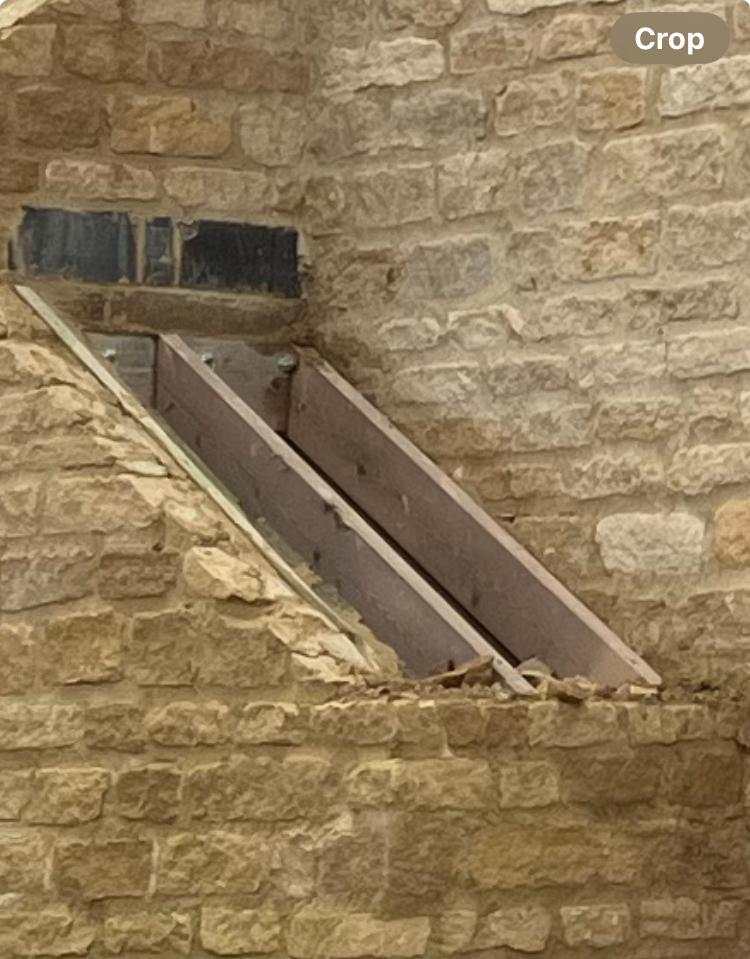

Russell griffiths Posted March 14, 2025 Posted March 14, 2025 It’s going to be hard to explain you need a rafter fixed into the sips panel like you said, the top end of this rafter will fit flat up against the a ledger board that needs fixing to the side of the c————— sod it I will try to find some pictures.
Russell griffiths Posted March 14, 2025 Posted March 14, 2025 does that help, the bottom of the rafter is supported on a timber fixed on the inside as the roof tiles in this instance don’t have any rafter tails on show. if this helps you need to do a mock up to see how you want the rafters to finish and how you want the tiles to sit over the brickwork.
Post and beam Posted March 15, 2025 Author Posted March 15, 2025 Hi Russell, it helps hugely actualy. It shows lines, end detail and the 'proudness' of the forward most piece of timber relative to the stonework.
