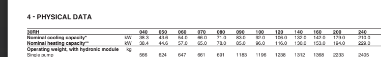

I've looked up the datasheet for your heatpump. The first thing that jumps out at min is the min flow rate of 1lp/s. I don't see you you can achieve this through UFH loops in  a normal domestic setting. You'd be needing around 10km of loops across 40+ individual loops. Is this what you have?

It is an old one, think installed around 2006/7. Plain 3 phase, with no inverter. It is a Carrier 30RH-060-B0358-PEE. She is certainly a big old beast.
13426_IOM_12_2008_30RH_LR.pdf

I've looked up the datasheet for your heatpump. The first thing that jumps out at min is the min flow rate of 1lp/s. I don't see you you can achieve this through UFH loops in  a normal domestic setting. You'd be needing around 3.5-5km of loops. Is this what you have?
I don't think my floor is quite that big. I guess that is the reason the tank is there.
