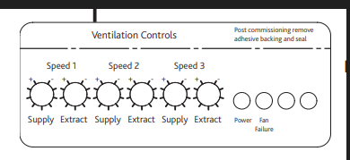

NewbieJ Posted February 28, 2025 Author Posted February 28, 2025 Inside of the cover it has 6 dials which adjust the speed at which the fans rotate.

Nickfromwales Posted March 1, 2025 Posted March 1, 2025 20 hours ago, NewbieJ said: Inside of the cover it has 6 dials which adjust the speed at which the fans rotate. This is mostly for commissioning the correct flow rates to the spaces served by the unit. Not seen one like that before, so the unit must have (I assume) 3 fans or more. Can you post a link to the actual user / installation manual if possible, please? A bit tricky to pin down the exact instructions for the unit, seems to be a few different offerings. FYI, I would expect (hope) that if doing active heating or cooling, the fan speeds would increase to convey additional volume of air (and heat energy) as at trickle rate the usefulness of those functions would be borderline pathetic. Do you have a pic of the display saying which mode it is in? Does it mention heating and cooling specifically, and can you leave it in max cooling for an hour then go to max heating for an hour, to test these functions at the air inlets?
JohnMo Posted March 1, 2025 Posted March 1, 2025 1 hour ago, Nickfromwales said: Not seen one like that before, so the unit must have (I assume) 3 fans or more. Looks pretty similar to Titon units, but they only have 4 potentiometers. Setback speed is just a calculation. So speed one (assume a setback speed) one pot for extract and one for supply fan. Then same for normal and boost. So just two fans and adjustable flow rates for each speed of the fans. I would leave these settings well alone. Look for a duct heater upstream or downstream of MVHR unit. Switch it off does it fix the issue?

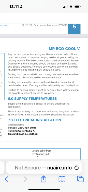

JohnMo Posted March 1, 2025 Posted March 1, 2025 The unit may have a cooling module. Which I assume is a small heat pump. You can adjust the set point at which this operates, factory set point is 23. But if altered from this say to 20, and the extract air is 21, then cooling mode will run continuously. Worth a look. hybrid_cooling_brochure_1_.pdf
Mike Posted March 1, 2025 Posted March 1, 2025 5 minutes ago, JohnMo said: The unit may have a cooling module And, in addition to the set point question, the User Guide also indicates that there's a manual switch to select either summer or winter mode, and that "Selecting “Summer Mode” means that the MVHR will target a lower internal temperature during the warmer months." If it's currently running in Summer Mode it would be fighting against the heating system, which may also explain the power usage.

NewbieJ Posted March 2, 2025 Author Posted March 2, 2025 On 01/03/2025 at 10:41, Nickfromwales said: This is mostly for commissioning the correct flow rates to the spaces served by the unit. Not seen one like that before, so the unit must have (I assume) 3 fans or more. Can you post a link to the actual user / installation manual if possible, please? A bit tricky to pin down the exact instructions for the unit, seems to be a few different offerings. FYI, I would expect (hope) that if doing active heating or cooling, the fan speeds would increase to convey additional volume of air (and heat energy) as at trickle rate the usefulness of those functions would be borderline pathetic. Do you have a pic of the display saying which mode it is in? Does it mention heating and cooling specifically, and can you leave it in max cooling for an hour then go to max heating for an hour, to test these functions at the air inlets? Thanks Nick. Yes, there is 3 sets of fan, the first one is the usual mode. the other 2 are boost mode. One is connect to the bathroom, and the 3rd one is in the kitchen. There is a thermostat at the wall that is connect to it, which has a Summer mode and Winter mode that can be switched on and off. My understanding is that when Summer mode is on, the cooling will kick in when the temperature reach the set point. On the other hand, if the Winter mode is selected, this will switch on the heat recovery mode. Please find the user guide and installation manual below for your information. MRXBOXAB-ECO5-AECV.pdf MRXBOX-ECO5-AECV User Guide.pdf 1

NewbieJ Posted March 2, 2025 Author Posted March 2, 2025 9 hours ago, JohnMo said: The unit may have a cooling module. Which I assume is a small heat pump. You can adjust the set point at which this operates, factory set point is 23. But if altered from this say to 20, and the extract air is 21, then cooling mode will run continuously. Worth a look. hybrid_cooling_brochure_1_.pdf 9.3 MB · 1 download Thanks John, I switch to winter mode, so the cooling mode in theory if working correctly, it should not kick in. All very strange.
Mike Posted March 2, 2025 Posted March 2, 2025 (edited) 1 hour ago, NewbieJ said: there is 3 sets of fan, the first one is the usual mode. the other 2 are boost mode. There will only be one pair of fans (one for supply, the other for extract), but they can both run at 3 different speeds. Speed 1 is for when the house is empty, 2 is for normal use, and speed 3 for boost. The installer should have set the dials to move the correct amount of air for each of these speeds to suit the design, which takes into account the layout of your flat. Presumably you have a controller that can switch between all 3 speeds, as well as between summer & winter - so 6 possible settings. If you can measure how many Watts it uses in each of these 6 settings, then that may provide us with some clues. Edited March 2, 2025 by Mike
