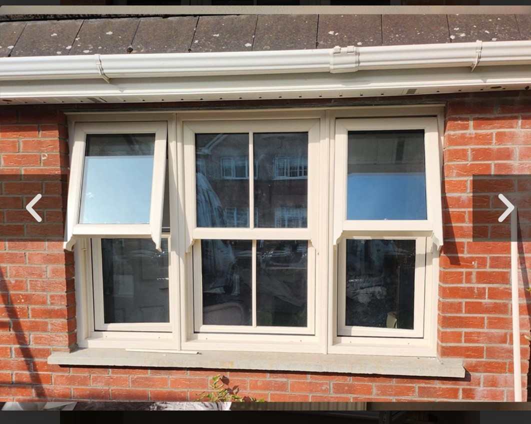

lizzieuk1 Posted March 5, 2025 Author Posted March 5, 2025 5 minutes ago, Nickfromwales said: I think for Georgian style the glazed units just come pre fitted with the bars? Found these and I think the may do 3g so will enquire.

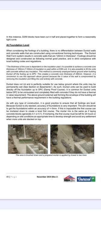

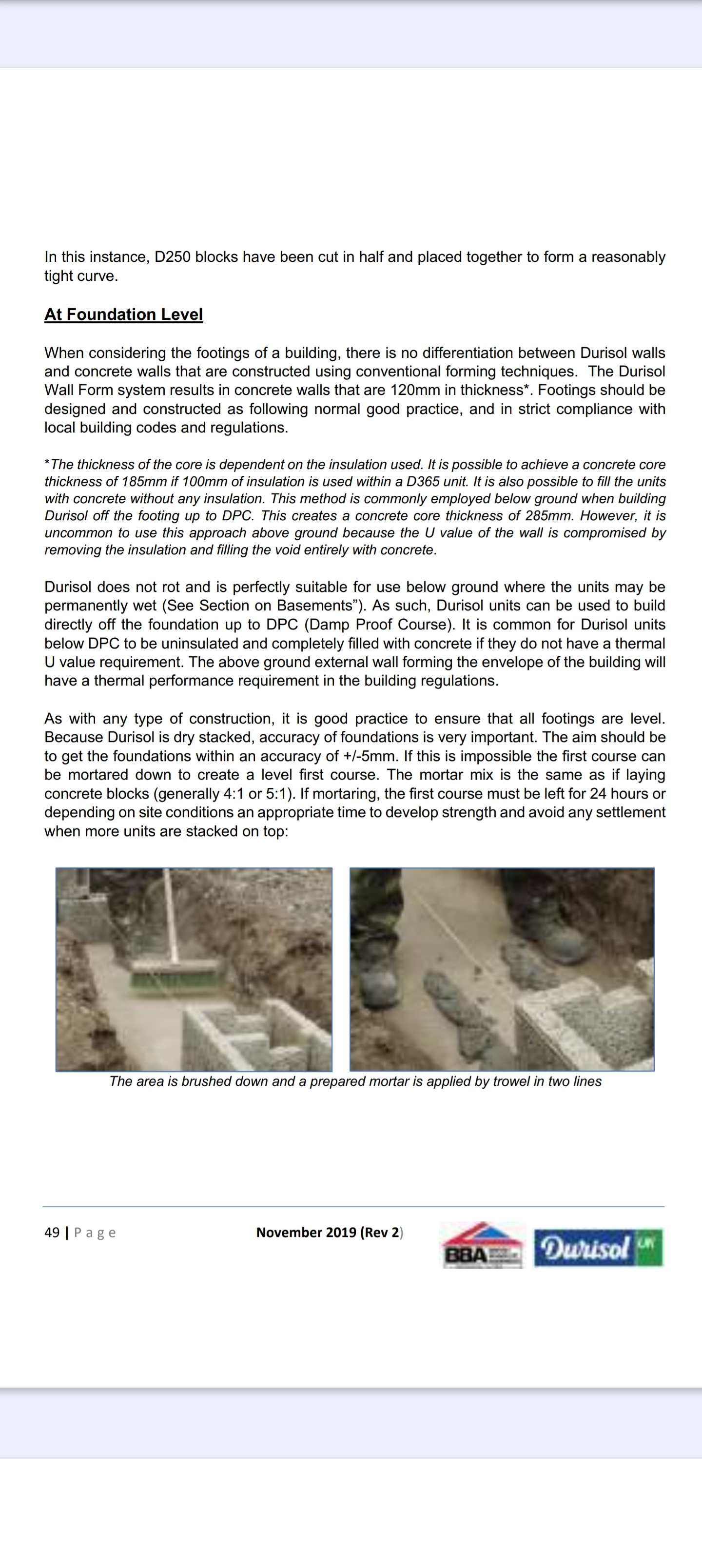

Nickfromwales Posted March 10, 2025 Posted March 10, 2025 5 hours ago, Iceverge said: What about strip foundations and ICF rising walls? Do you really want a woodcrete ICF block under DPM and rising up? EPS is fine, done this before very successfully, but I'm not so sure that's a good idea with WC.
Iceverge Posted March 10, 2025 Posted March 10, 2025 Internet thinks woodcrete would be fine underground........ I was thinking of EPS however, it will perform every bit as well as an insulated raft as a foundation provided you get your thresholds right.
JohnMo Posted March 10, 2025 Posted March 10, 2025 16 minutes ago, Iceverge said: Internet thinks woodcrete would be fine underground........ I was thinking of EPS however, it will perform every bit as well as an insulated raft as a foundation provided you get your thresholds right. Durisol install manual says 1
Nickfromwales Posted March 10, 2025 Posted March 10, 2025 11 minutes ago, JohnMo said: Durisol install manual says Did you install any below grade?
